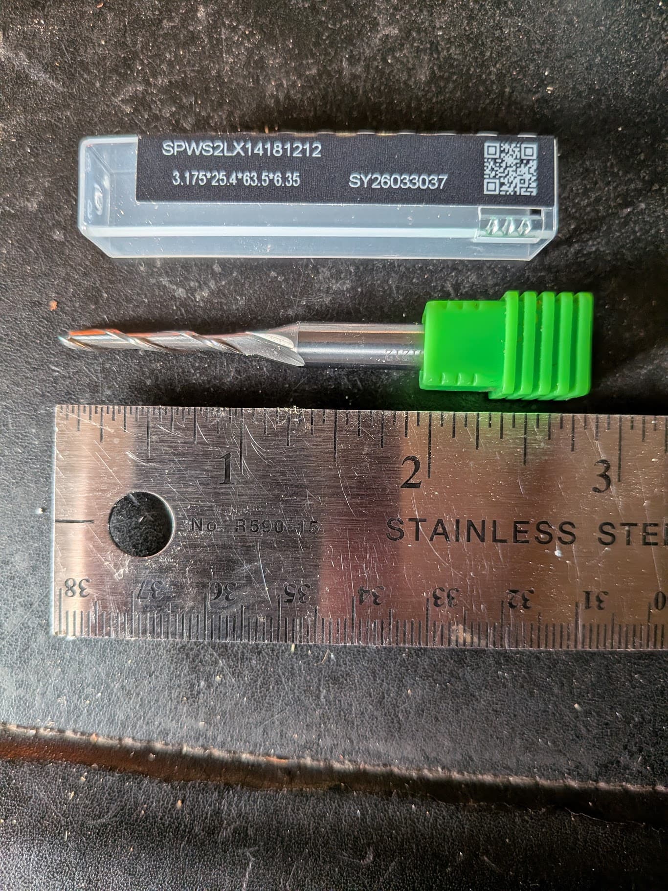

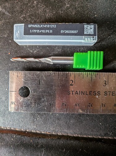

I am making a sign where I need to pocket with a 1/8 Endmill, but the pocket is 1/2" deep. What Endmill is on the market that is longer than the one that comes with the shapeoko? I don’t trust that that one will get the job done.
I needed one now…so I bought this from Amazon. SHARPRO 1/8 Router Bit 1/4 Shank, Spiral Upcut Router bit, 1/4 Inch CNC Router Bits, Up Cut Spiral Router Bits 1/4 Shank,Solid Carbide Router Bits 1/4, Ideal for Wood Inlay, Plunge Plastic - Amazon.com I don’t have much history on the bit (I have only used it a couple of times) but it worked well for my purpose.
The #102 has a 1/2" cutting flute length, so, so long as the Sweepy won’t interfere it should do the job so long as setting zero relative to the stock is done with accuracy/precision.
For a long-reach 1/8" tool, the Precise Bits folks have some options:
including some ball-nose tools which I wish I could find a project which warranted:
Ages ago, I bought a 1/8" Garr Tools long reach endmill (two actually, which was good since I snapped one just moving the machine around by hand) which has worked well when I’ve had occasion to use it.
What’s the old saying? Something like “Buy one tool and it might break. Buy two tools and one will break. Buy three tools and you’ll never break any of them.”
I buy my tools from precise bits in packs of 10 so I’m not sure how that math plays out for me in the long run :sweat_smile:
