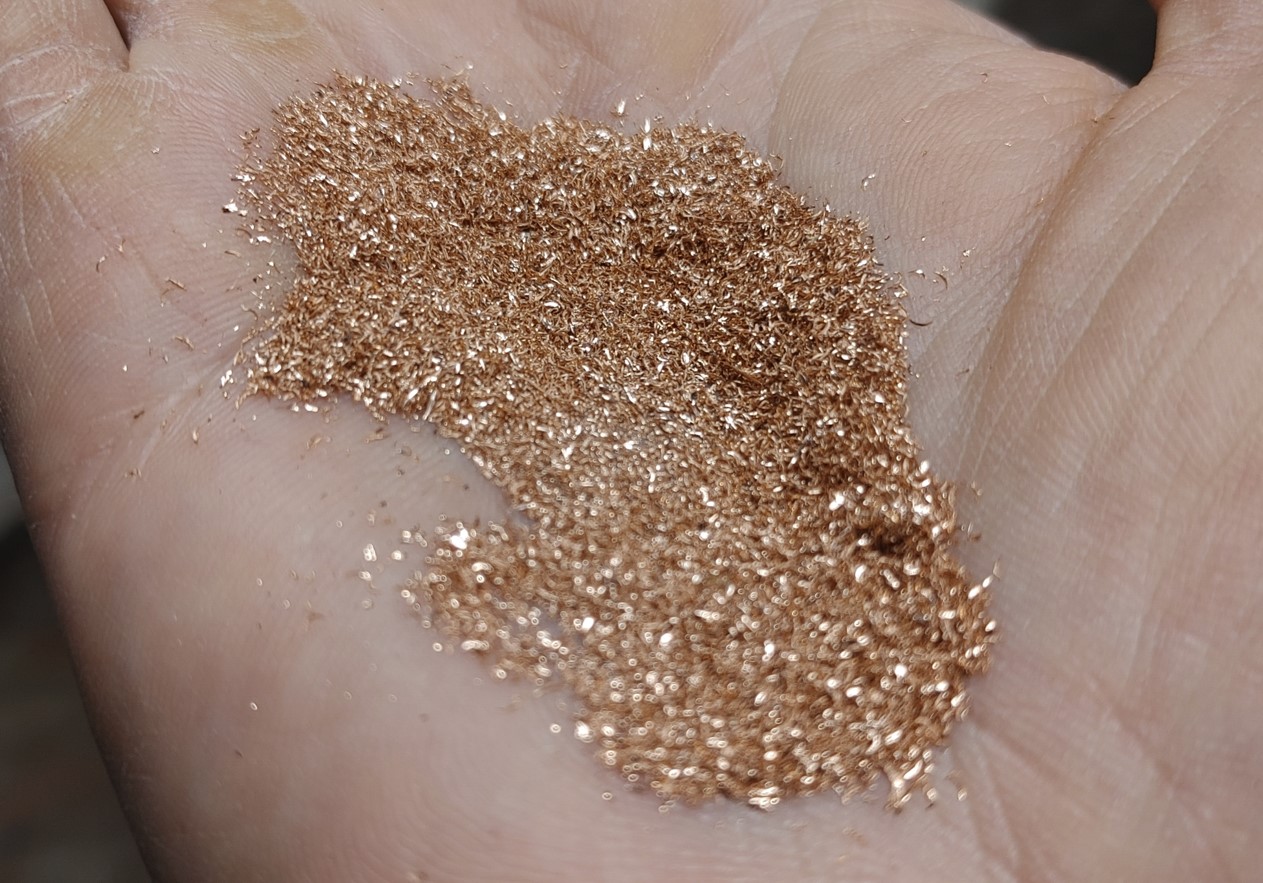

I’ve cut a decent amount of copper.
  1. Try to find a machinable alloy.
  2. Use a new single flute end mill
  3. SHALLOW depth of cut HIGH feed rate
  4. Try to avoid channeling
You want chips, but “micro chips”.
No need for coolant, air blast or vacuum unless you’re going very deep into a pocket.
I was doing super low DOC and around 65 IPM. I don’t have the file anymore but probably around 0.005" DOC on a 1/8" end mill maybe even less. I cut for like 7-9 hours straight on the same end mill. Here’s what the chips look like.
