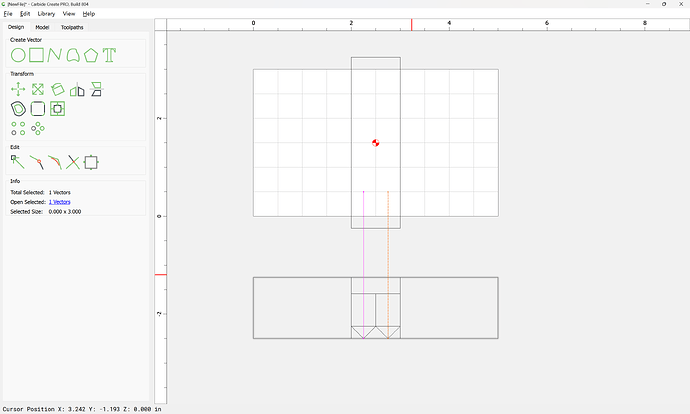

Can someone run through the process of creating a deep V groove with out getting squared off sides when using a bit like the #301 90 degree v bit - I know I’m missing somthing and it’s probably obvious but I’m having a problem visualising a solution.
Essentially I want to create a mitre in a thick piece, thicker than the depth of the edge on the cutter before it gets to the straight edges, if that makes sense…
veeee

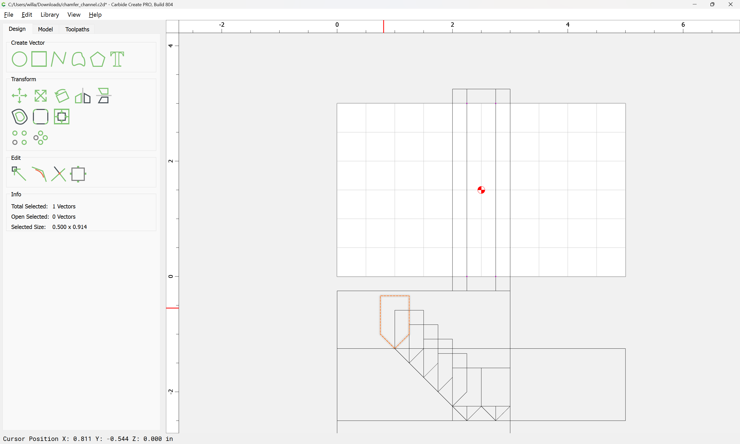

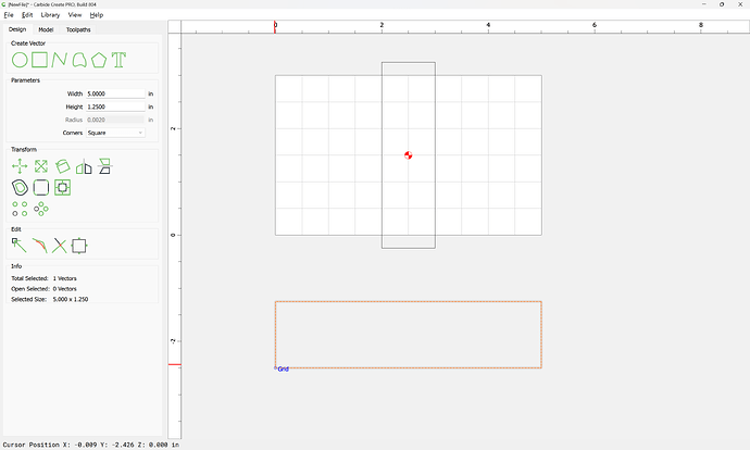

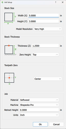

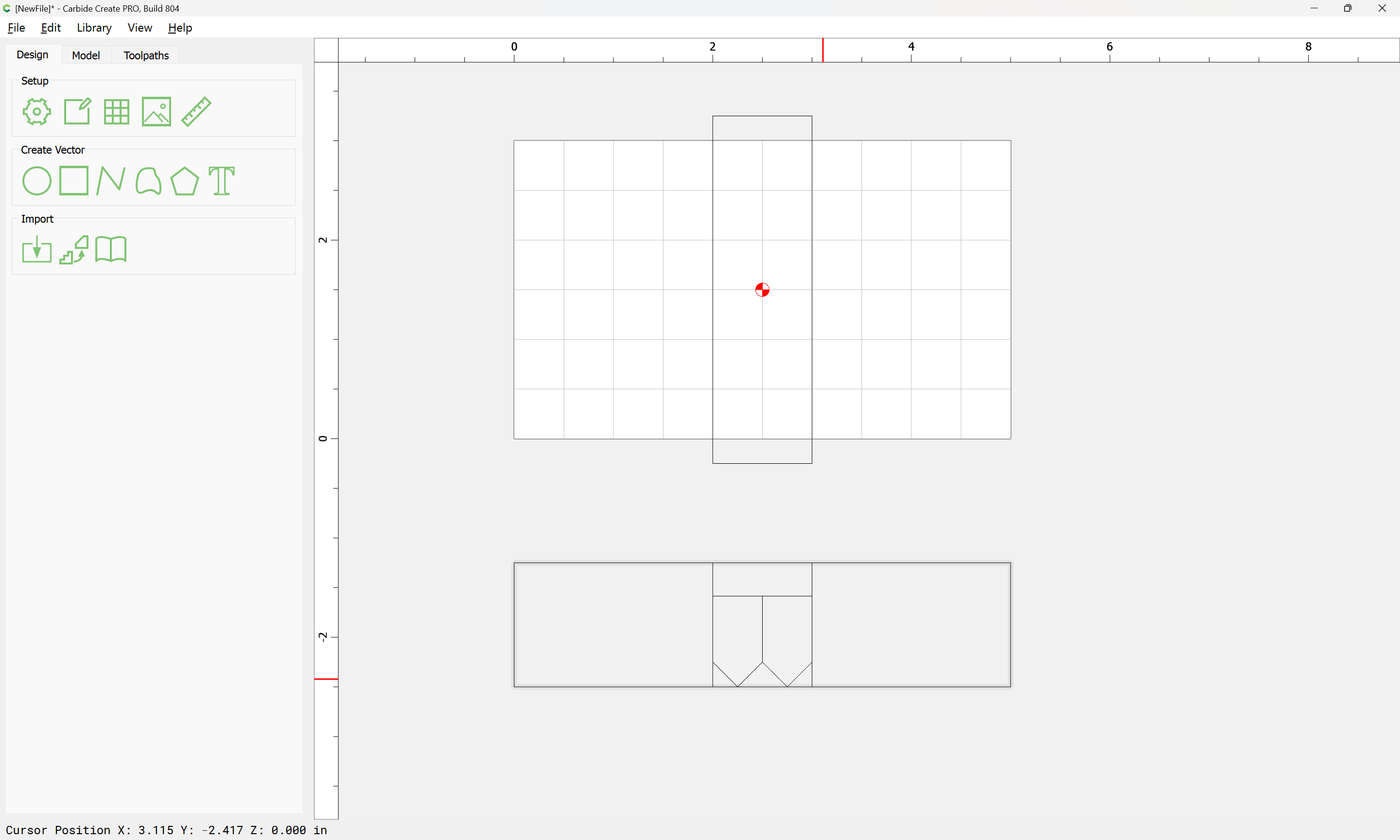

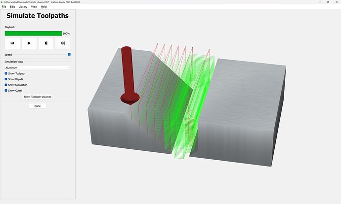

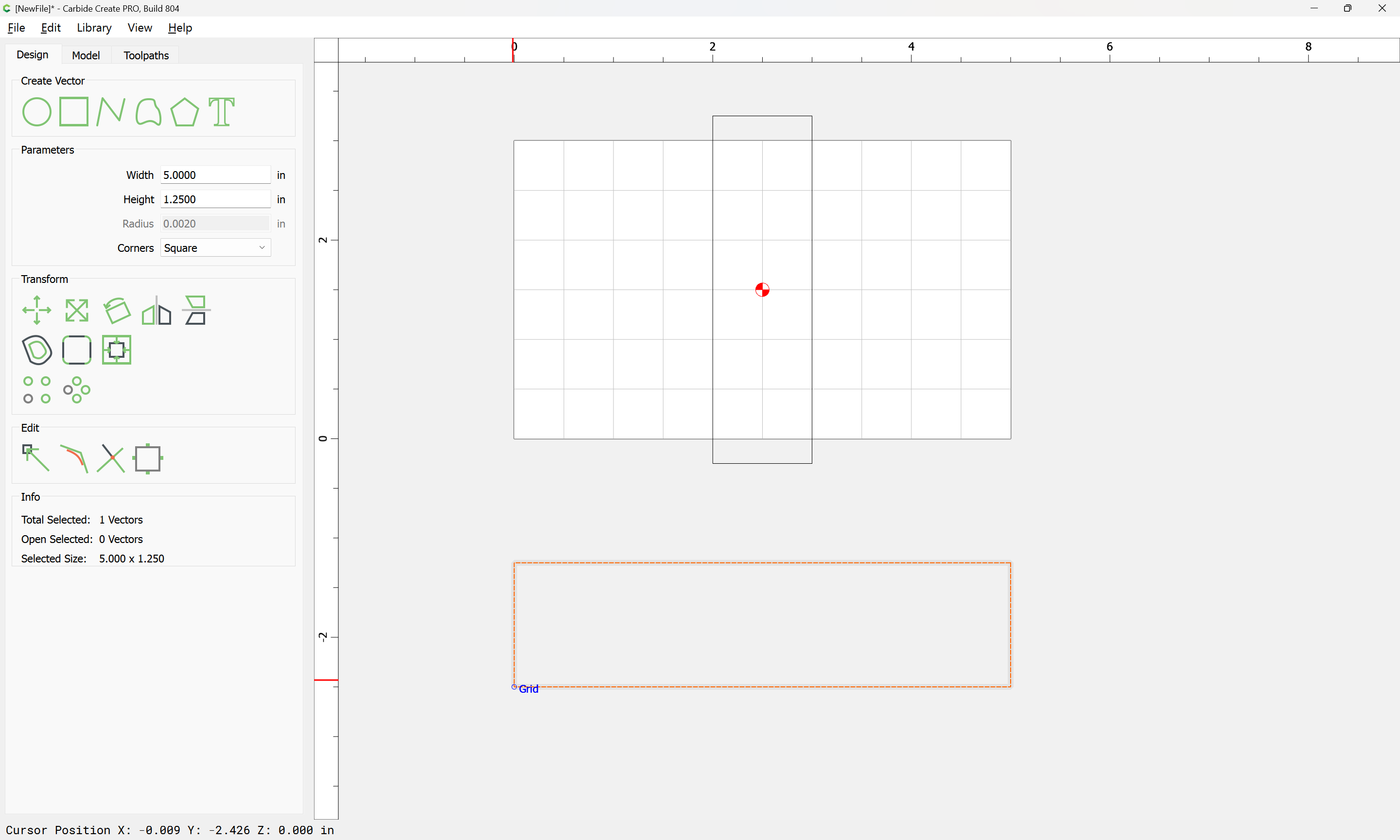

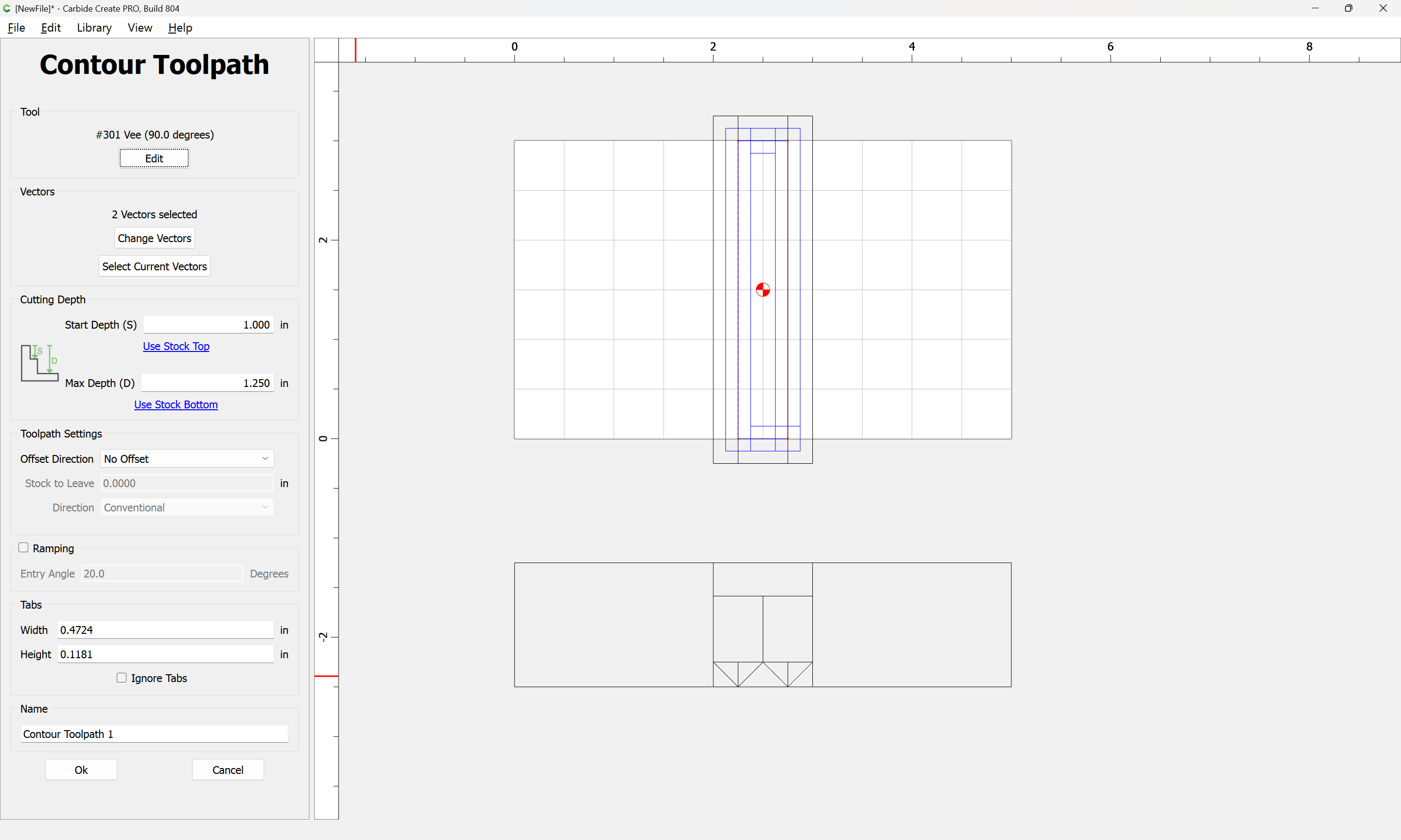

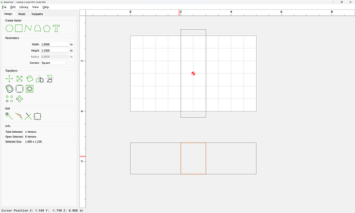

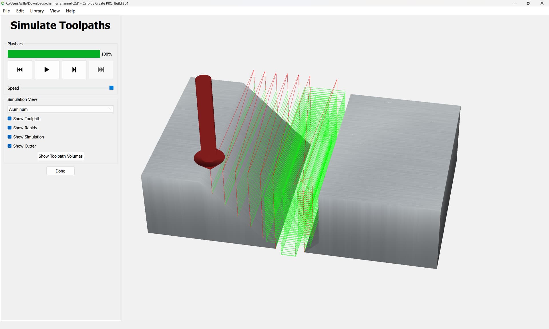

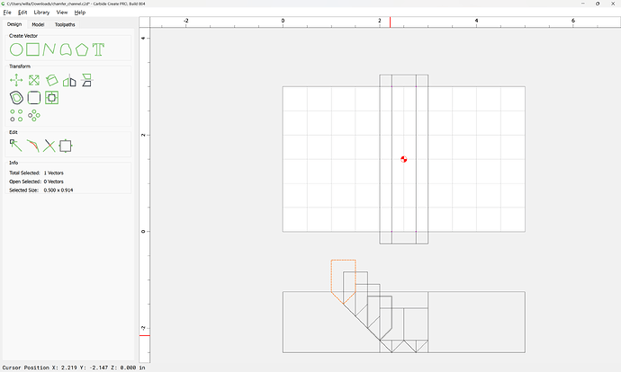

Start with a suitably thick piece of stock:
Draw the geometry you want:
(Note that it projects at the top and bottom by greater than tool radius at each end)

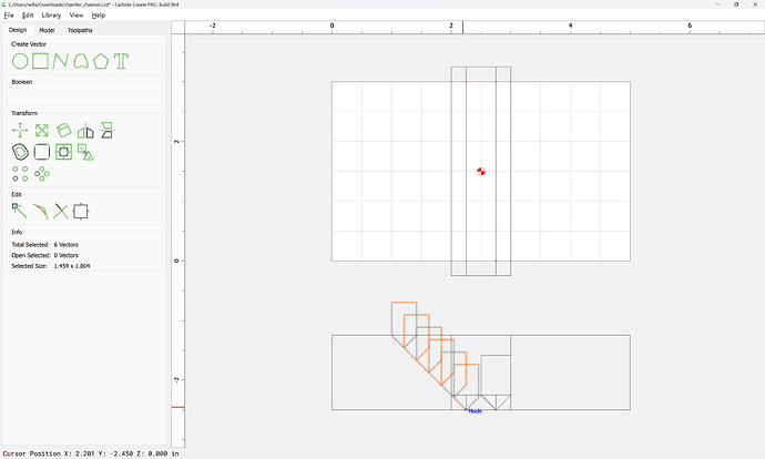

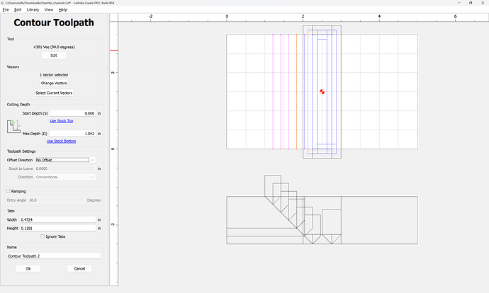

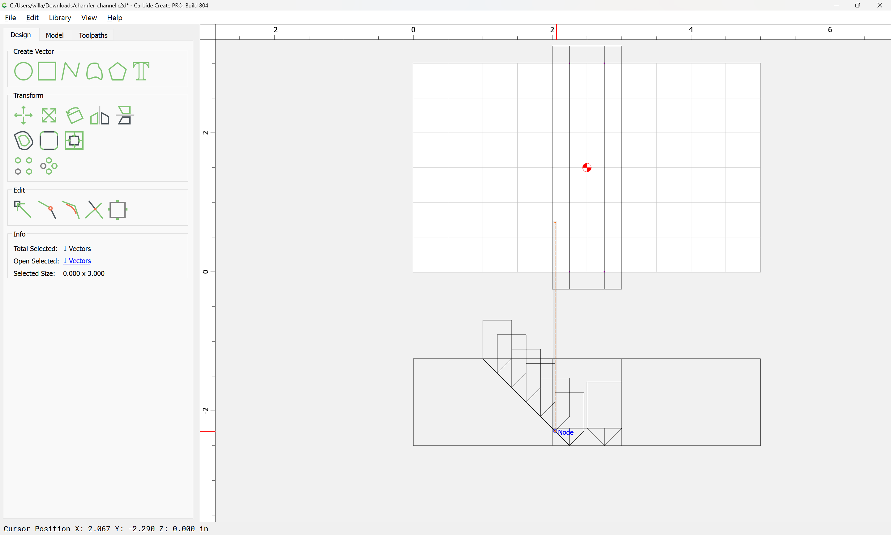

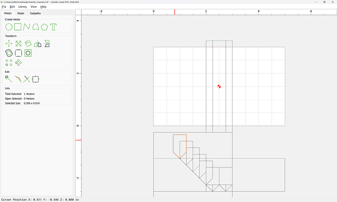

Draw the cut in profile:

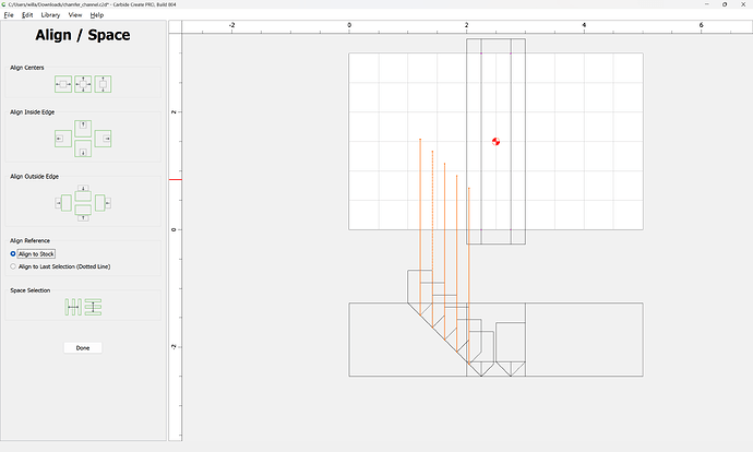

(Note that you will need to ensure that the tool has an adequate cutting flute length — a “Long Reach Endmill”)

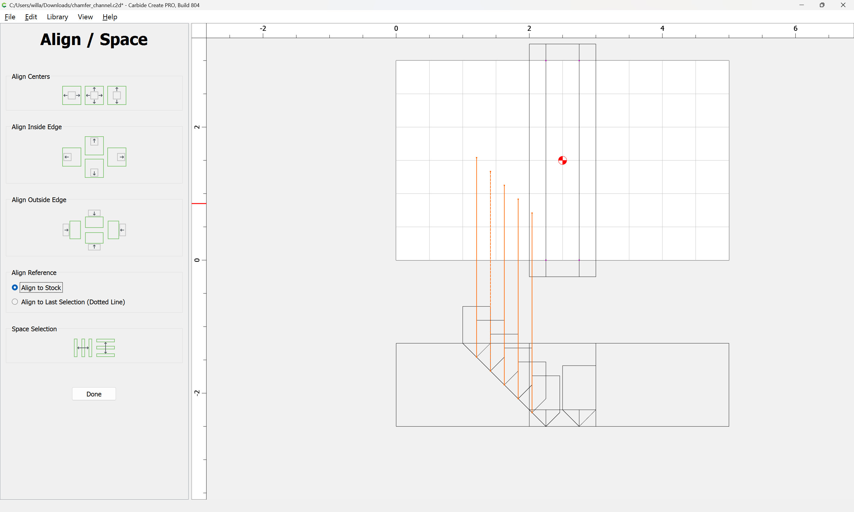

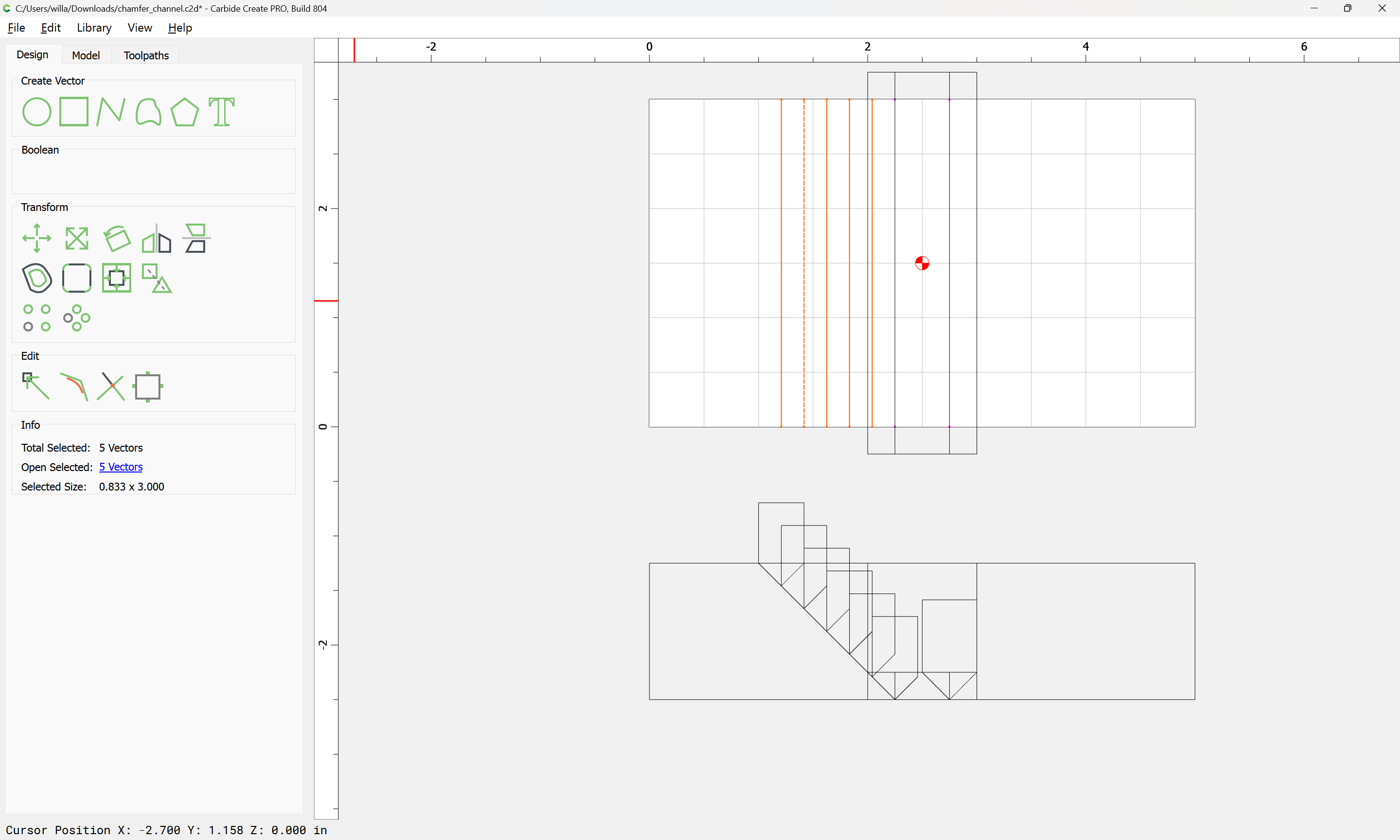

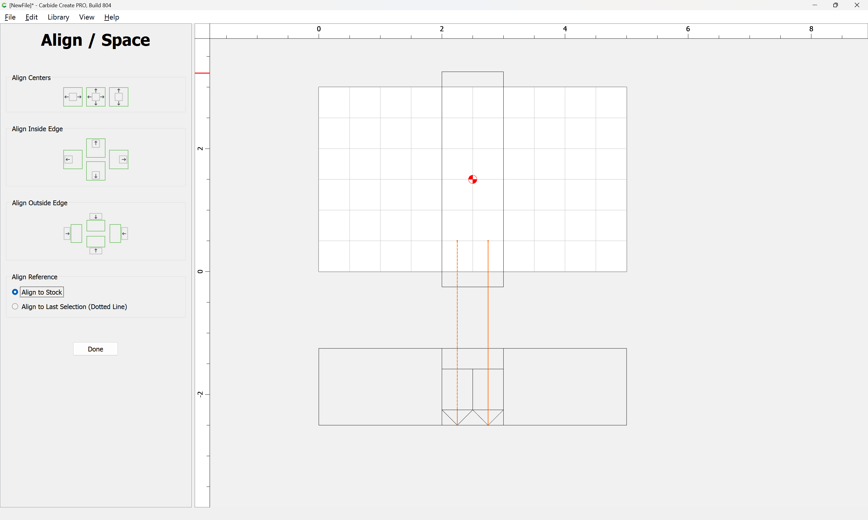

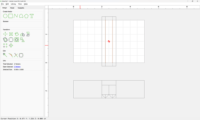

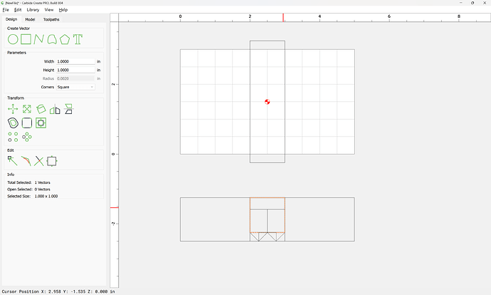

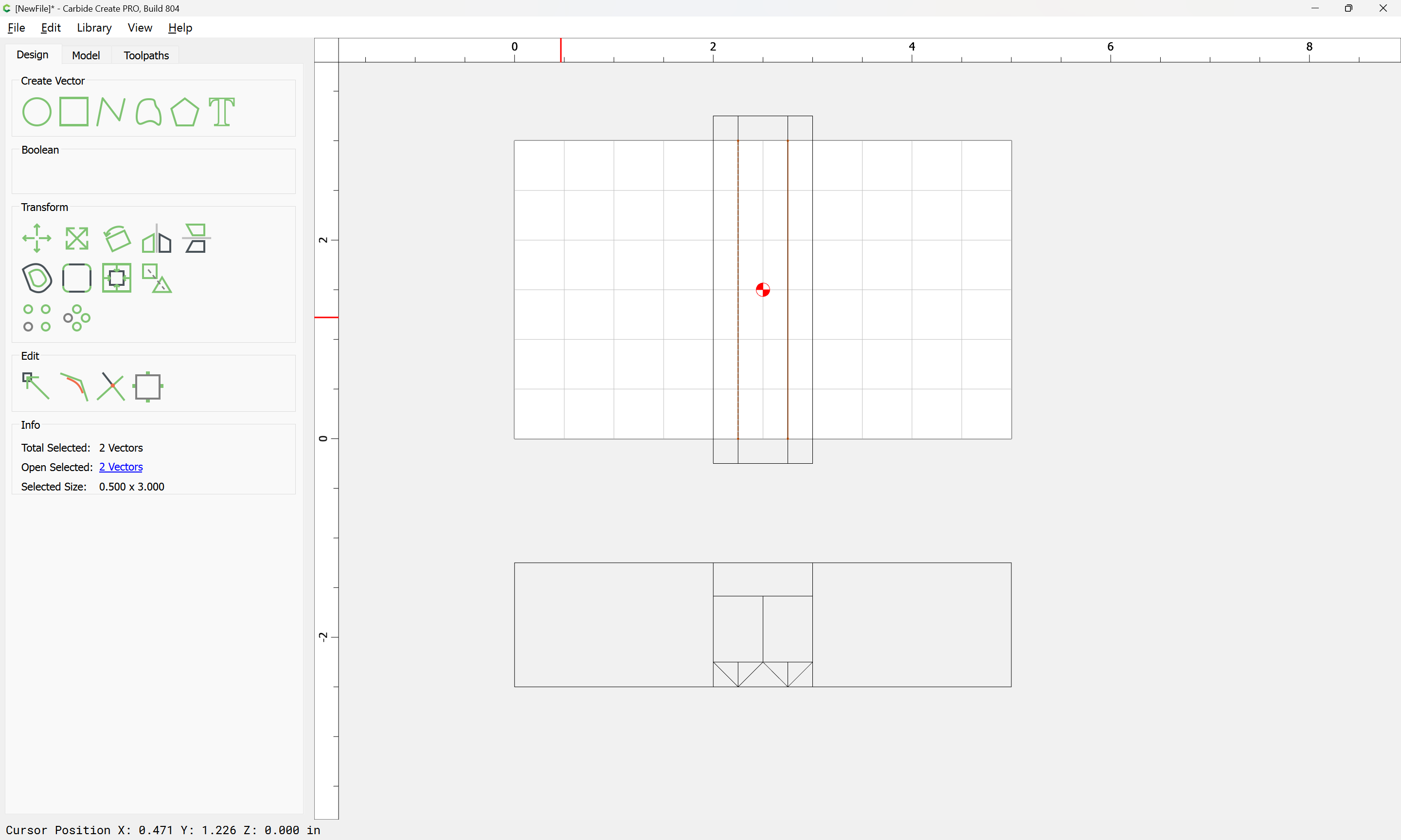

Draw a pair of lines centered on the tool outline:
and align them with the stock:

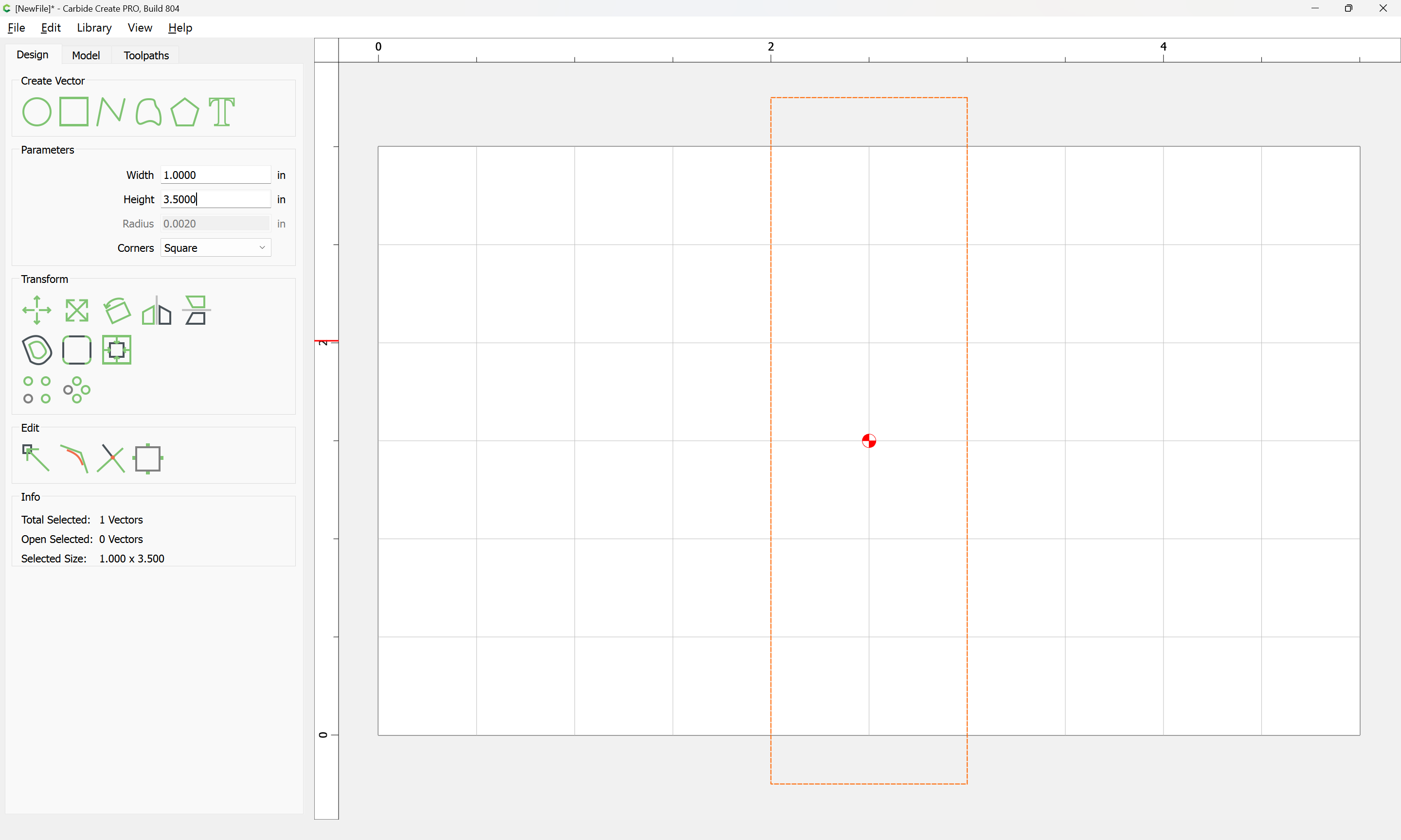

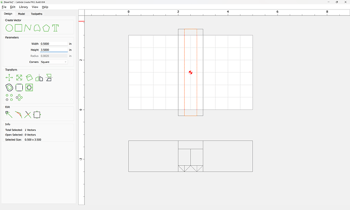

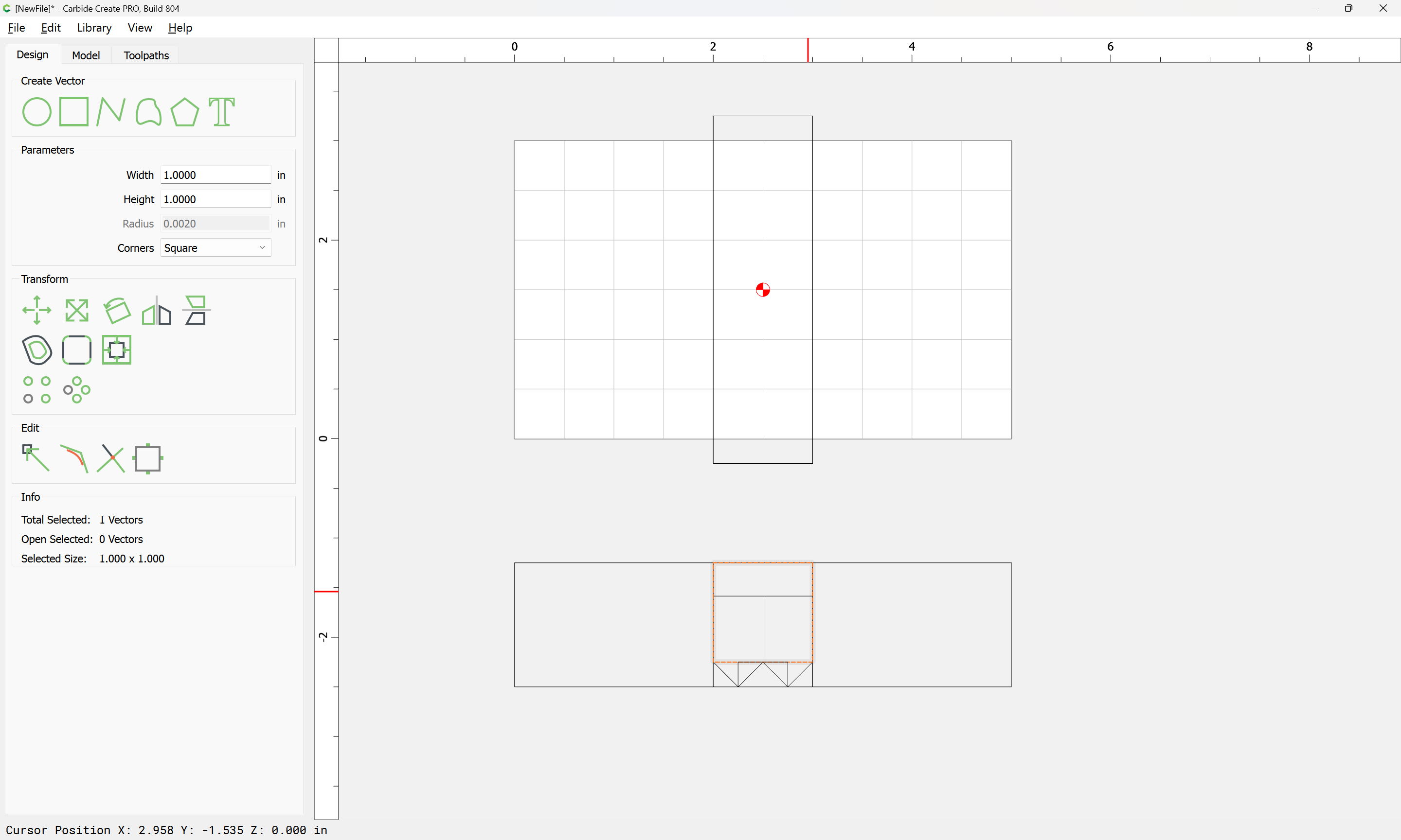

and draw a rectangle for the central channel:

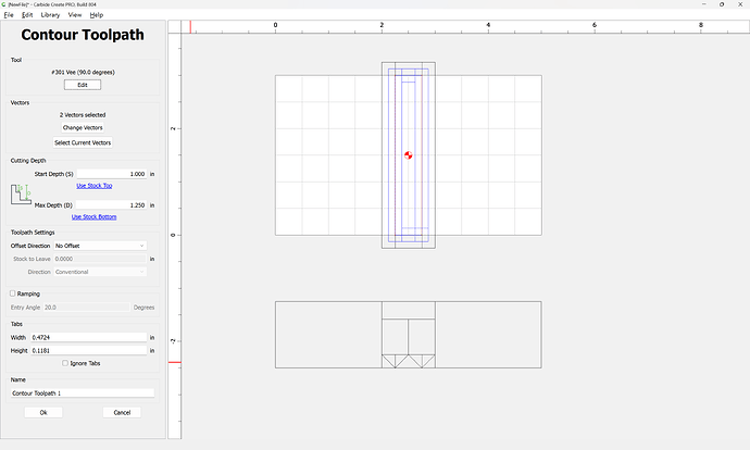

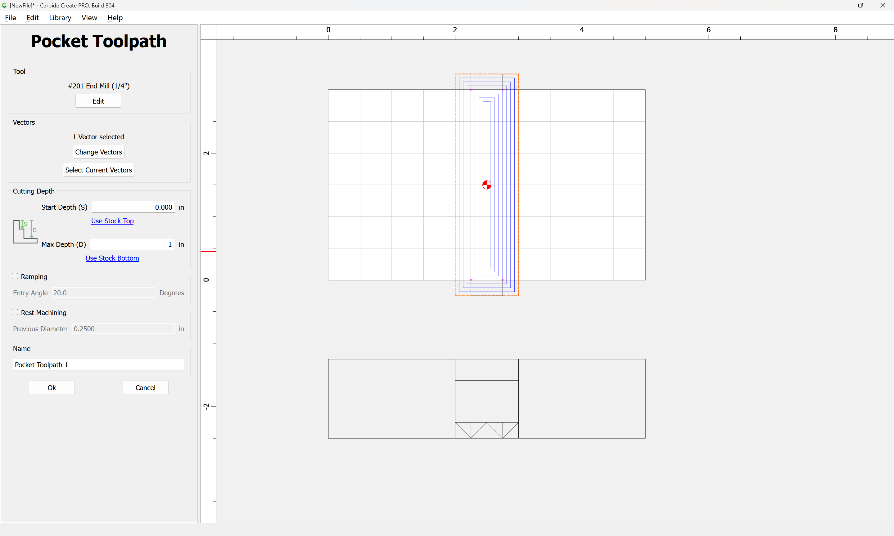

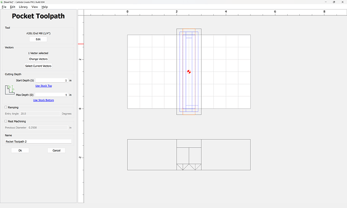

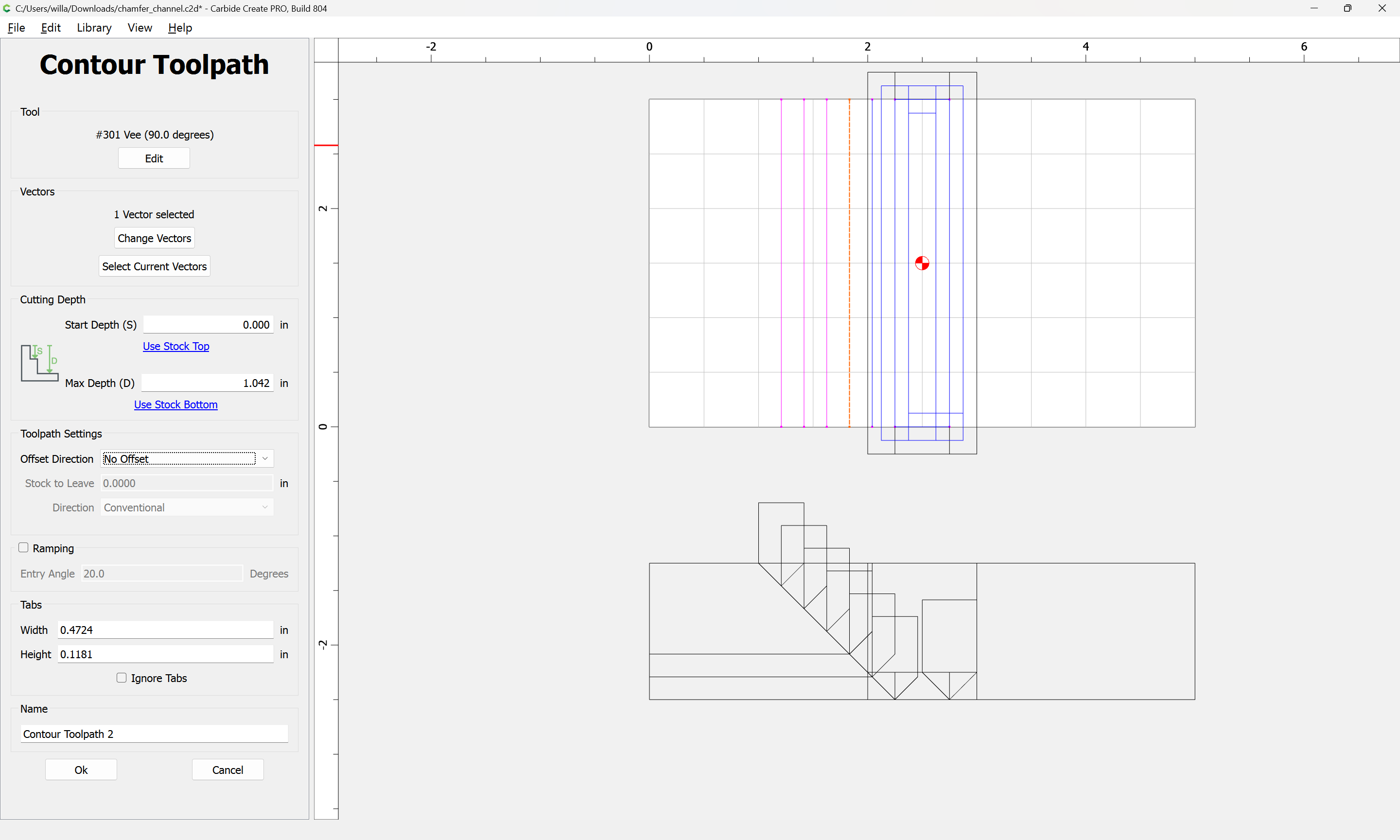

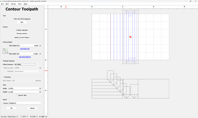

Then assign toolpaths:
Large rectangle
Inner rectangle
Lines
Attached as a v8 file:
chamfer_channel.c2d (52 KB)
If you need to cut an angle longer than the length of the cutting flutes you will need additional lines — draw/position them in the profile and assign cuts to a suitable depth.

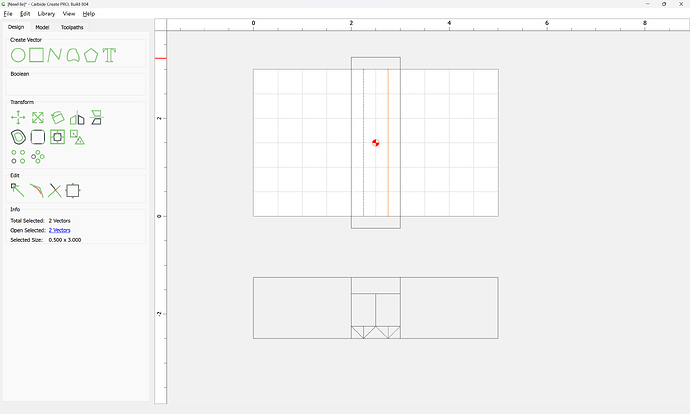

EDIT: To finish this and answer the actual question:

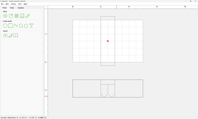

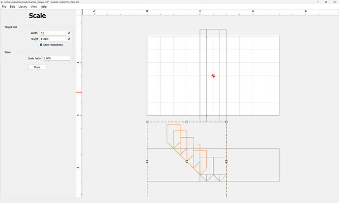

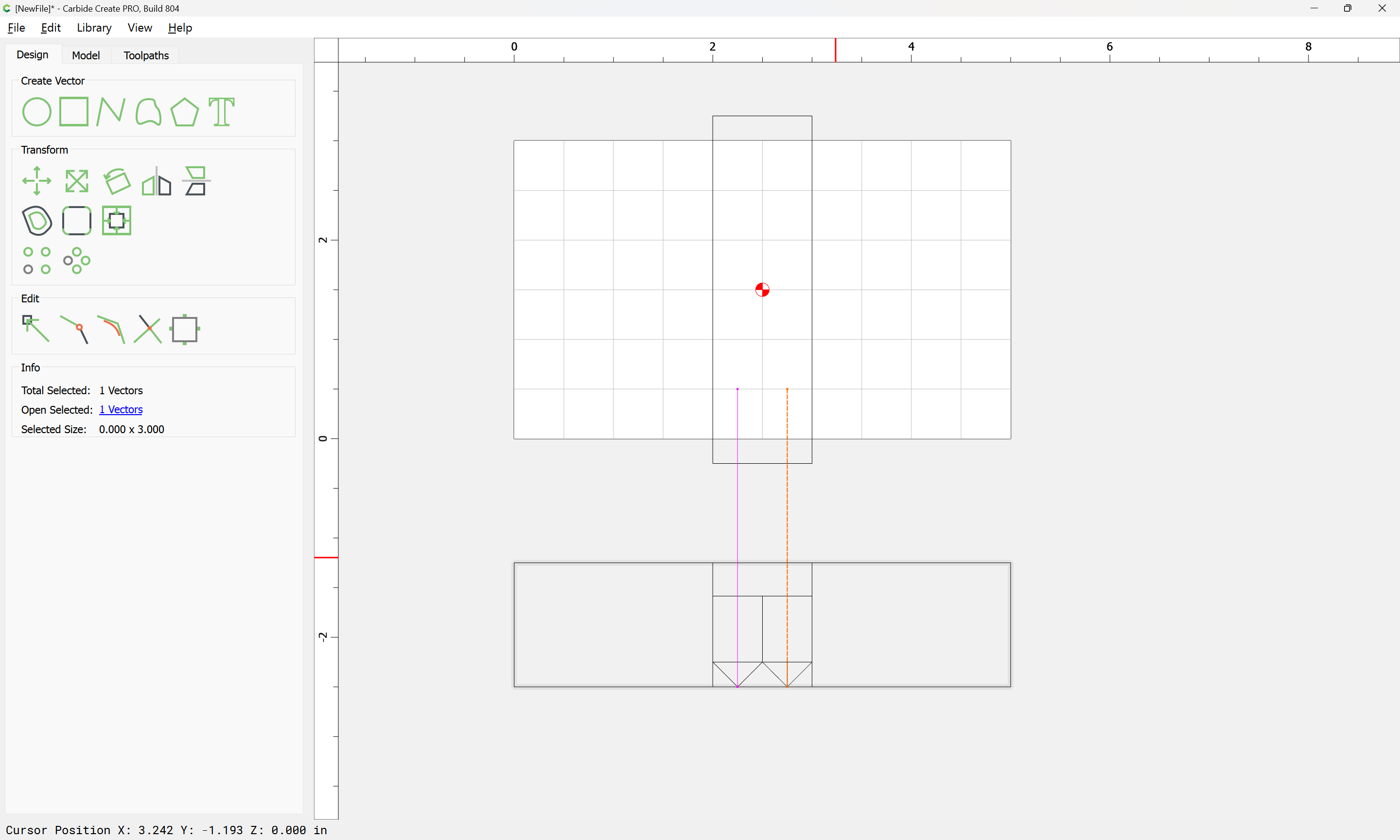

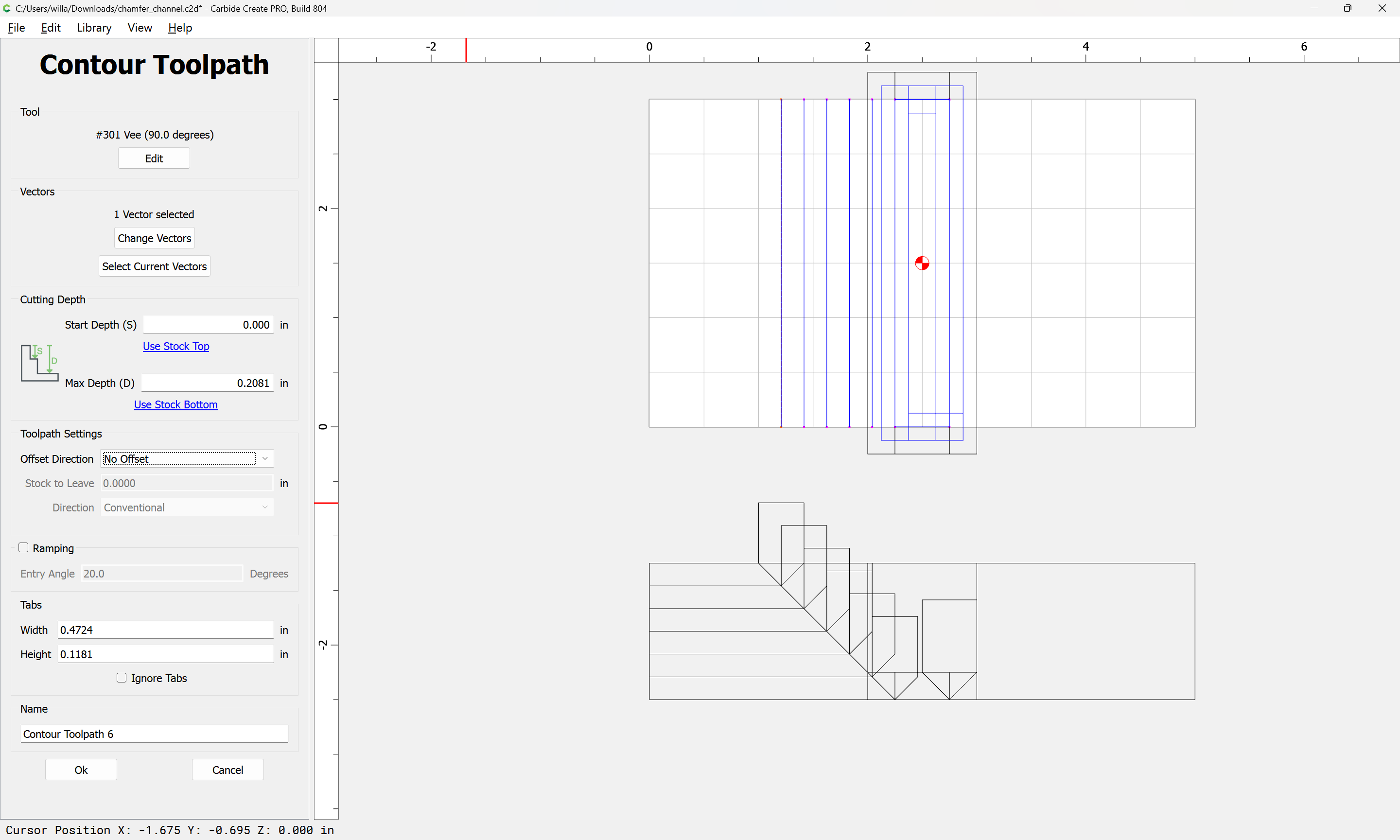

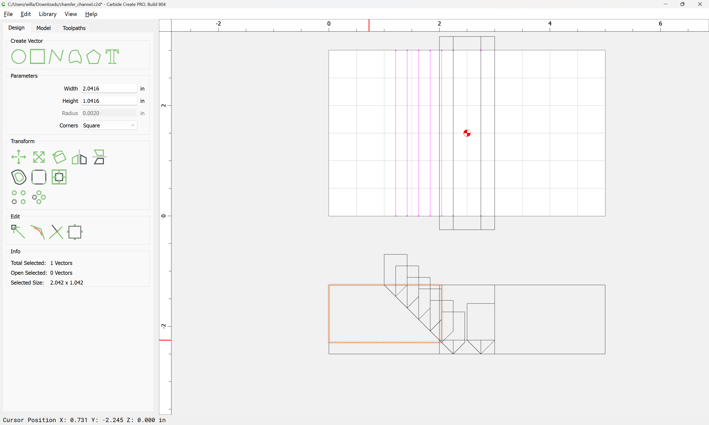

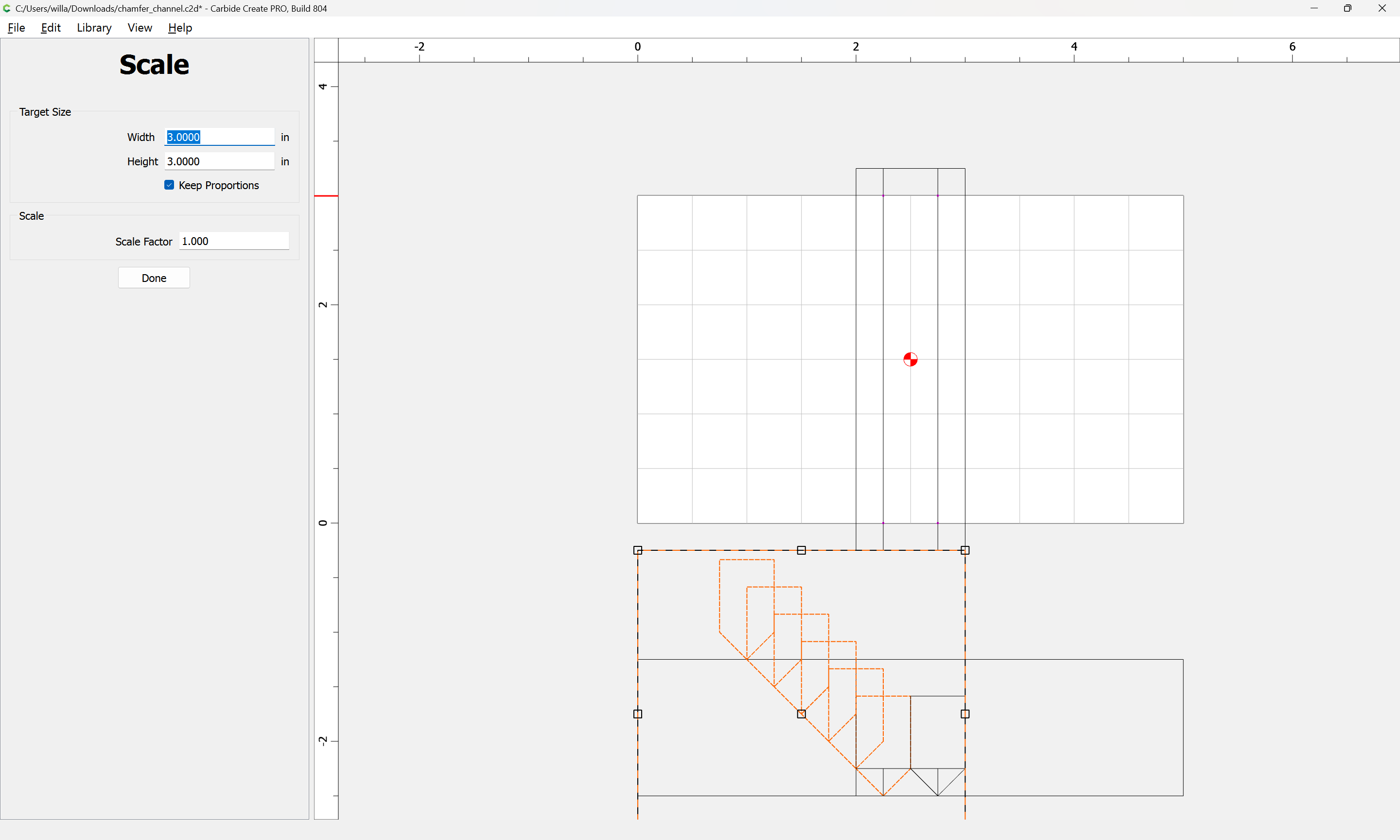

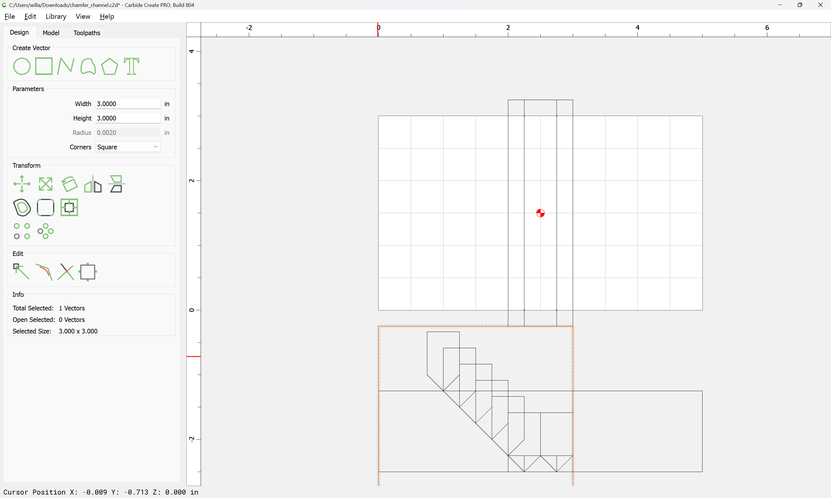

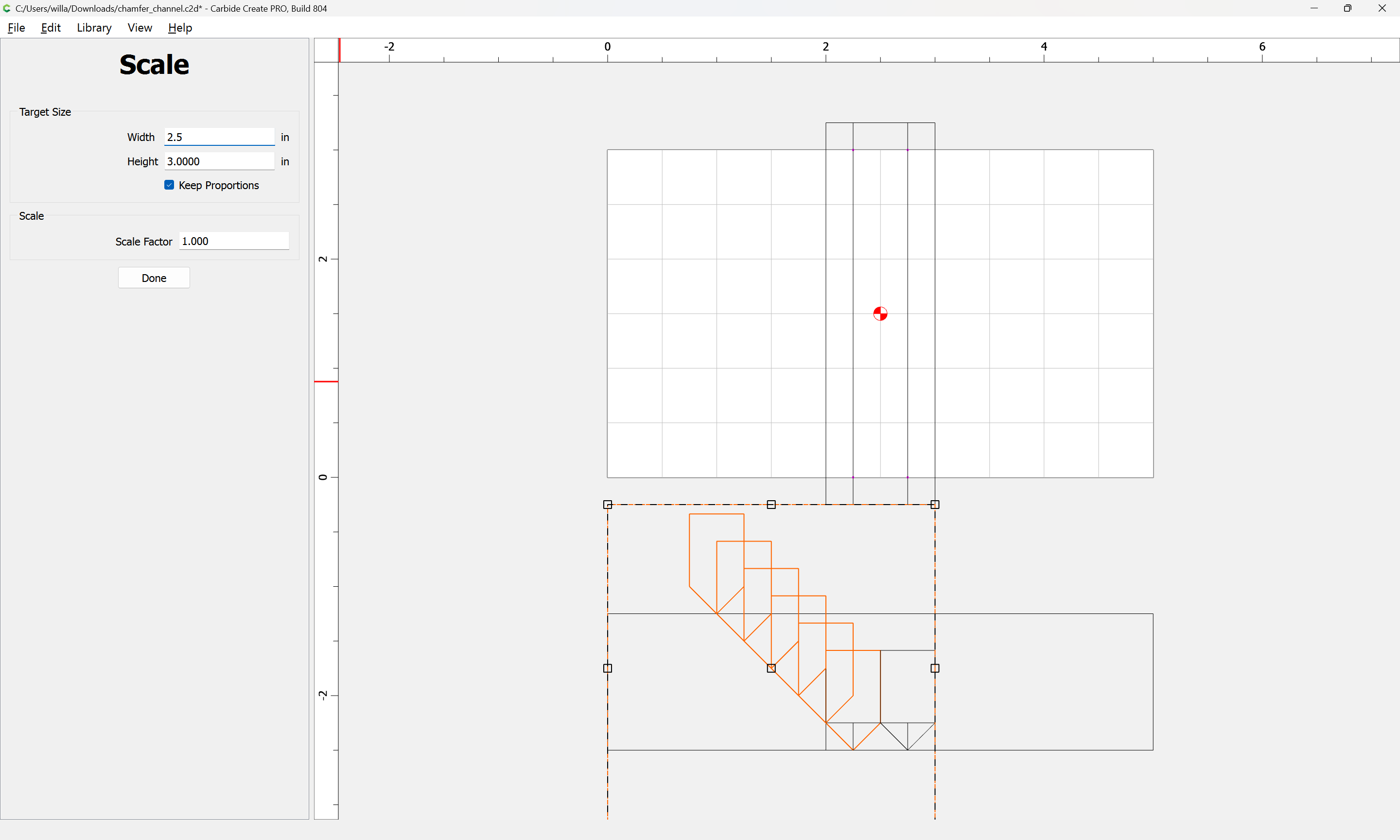

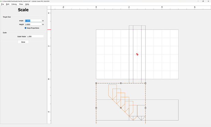

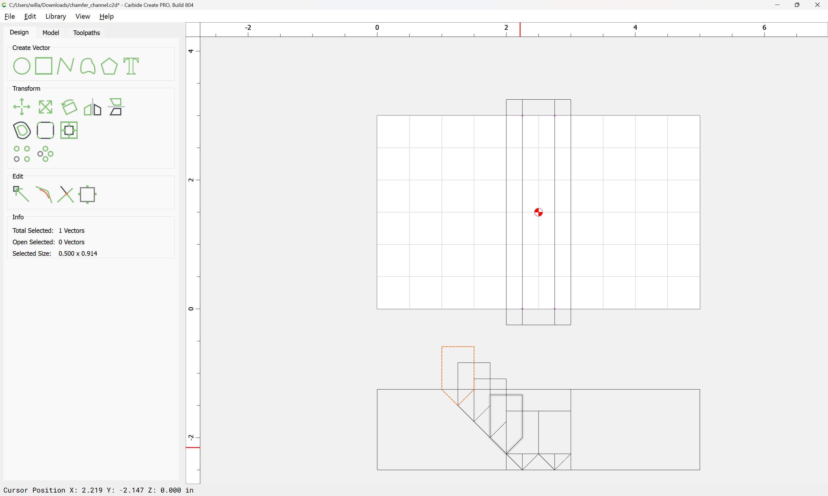

Draw the balance of the cut in profile:

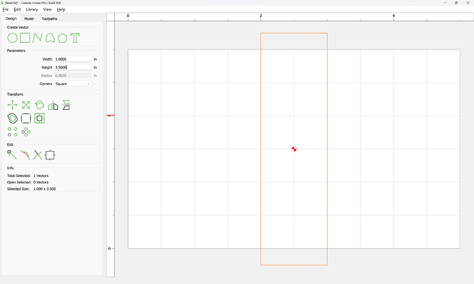

Since things fit perfectly, it is probably best to add one more:

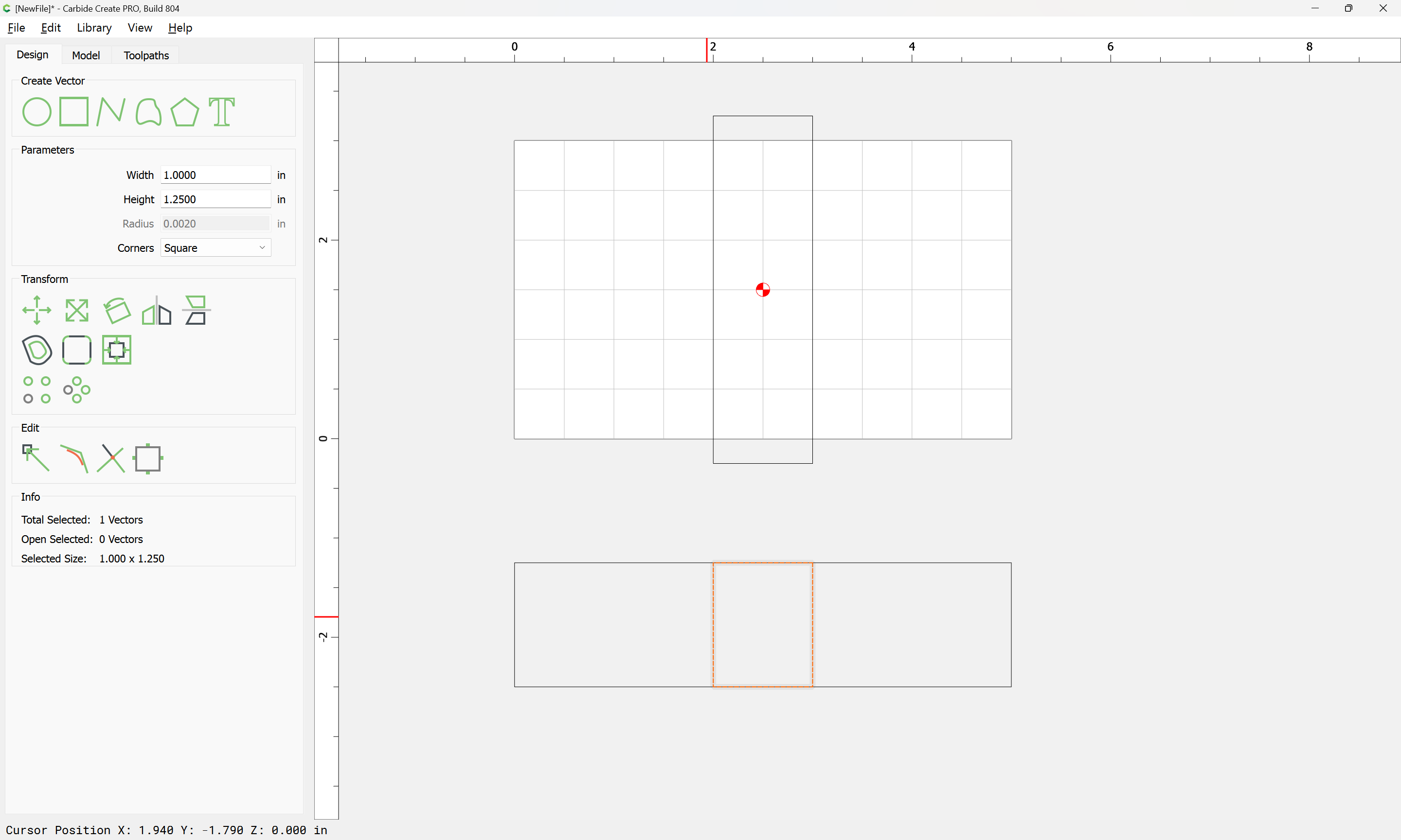

and draw in a box twice as large as necessary:
Then draw in lines:
and align them:
Then measure for each:
and assign a toolpath:
and repeat for the balance:
v8 version:
miter_v8.c2d (64 KB)

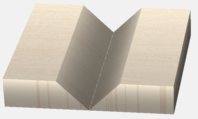

Thanks for the response, so essentially I need to do a series of cut->move right->stepdown->cuts and then do the same from the other direction.
Something like that.
The big thing is, you can draw the cut in profile to get dimensions (or do the trigonometry):

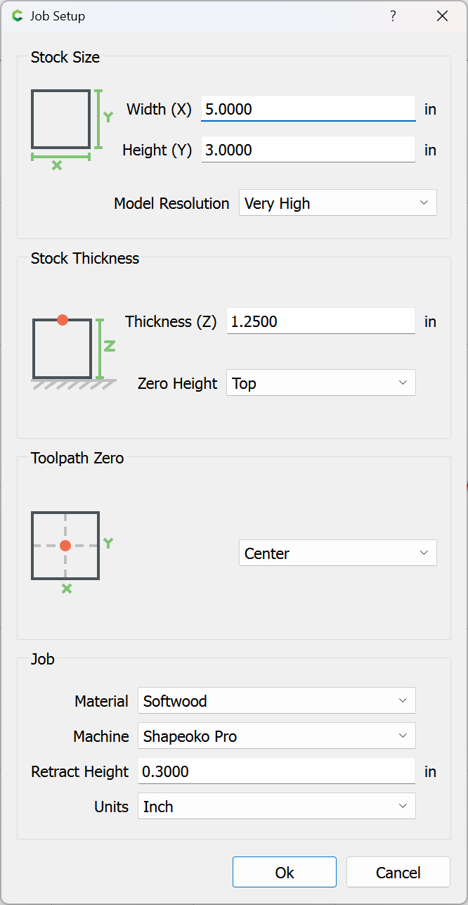

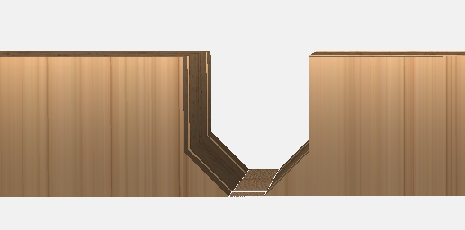

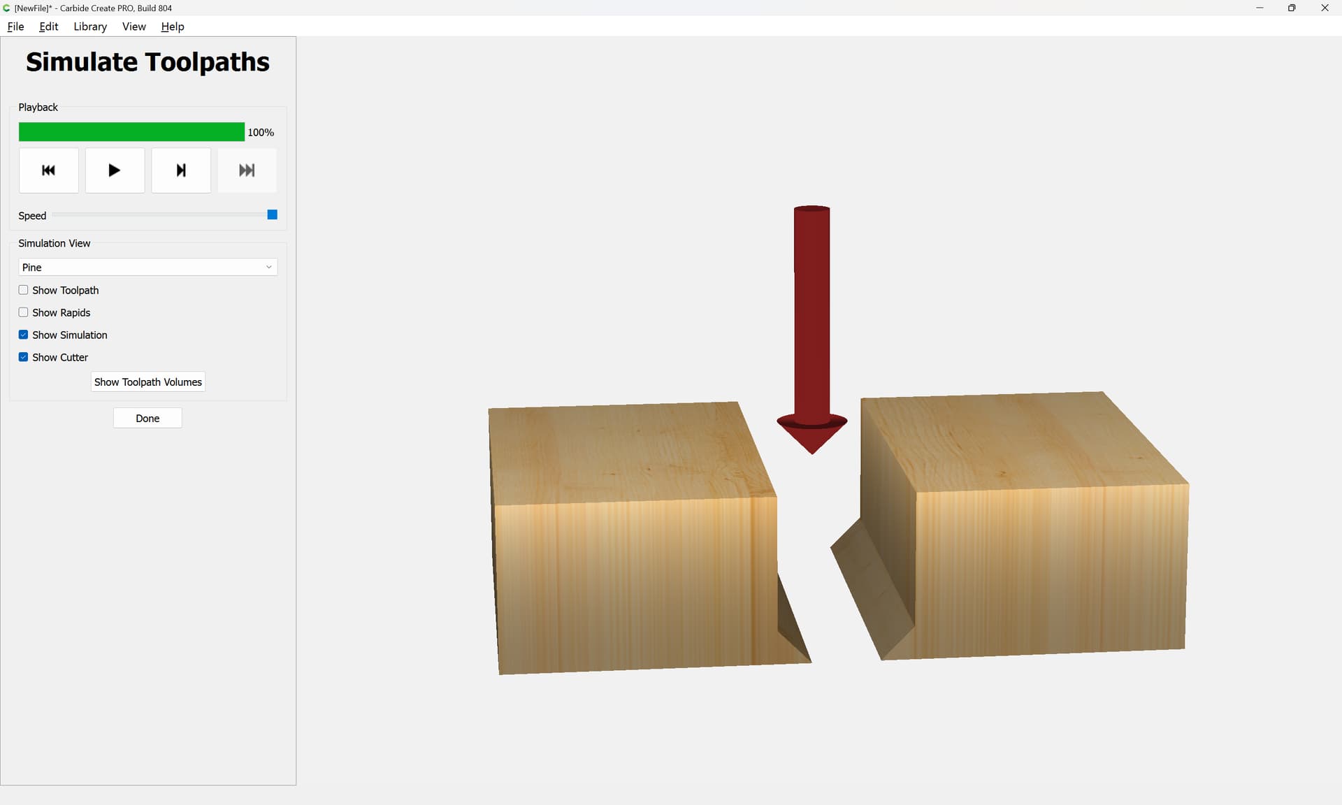

Is this what you’re looking for? (3/4" stock)

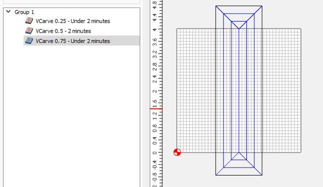

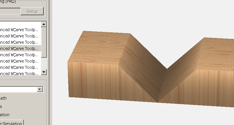

Lie like hell!!! :smiley: Create a 90° Vee that’s at least 1 1/2" diameter, then do a series of V-carves (without clearing) at your desired cut depths. (I went 0.25, 0.50, 0.75)
Then load your 1/2" 90° Vee & let 'er rip.
OIC, see:
Oh wow yes, that seems perfect. Thank you.
