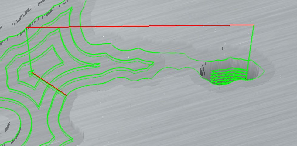

Deep Plunge at start of pocket
I’m trying to do a pocket cut but at the start of the cut the tool is plunging straight to end depth which is then too deep to mill.
Checking in the simulation in Carbide Create (running it slow) I can see that it does the same there. I have attached a screenshot of the paused simulation where you can see the deep pocket to the top right and the other partial pockets as expected to the left.
Does anyone have any thoughts on this?
Thanks

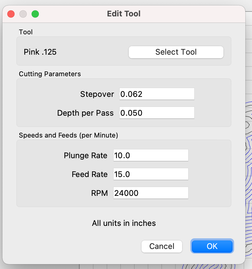

What tooling are you using? With what settings?

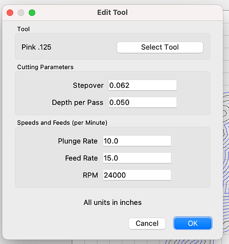

Thank you very much for your help. Please see attached screenshot of tool settings and Carbide Create file.
westray-tray.c2d (384 KB)

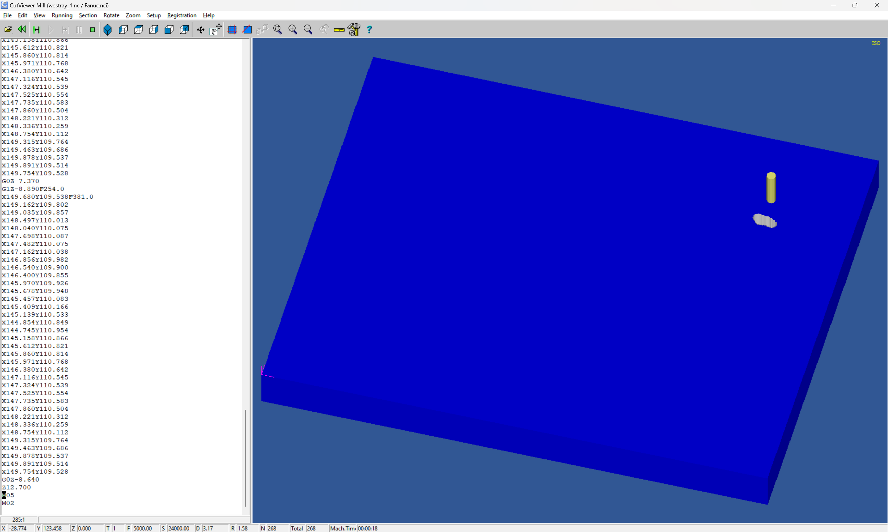

Confirmed:
The first ~285 lines make this cut:
It does step down by the Depth per Pass setting:
Z12.700
G1Z-1.270F254.0
X149.680Y109.538F381.0
G0Z-1.020
G1Z-2.540F254.0

In operation it ‘appears’ to just plunge down to the depth and then try to move/machine off to the left with the tool still at full depth and I have to stop the machine as it is clearly laboured and I fear a broken cutter, or worse.
Could it be a stopover problem as it tries to move to the next area?
Thanks
I have had programs that this occurred. As if it was randomly going to finish depth at random spots. I was spitting bricks.
The programs I had this occur in did finish correctly. Sometimes like a drunken sailor, I know where the ship is, just trying to get there.
I really don’t see anything wrong with the tool paths.
CC wants that first little pocket cut starting at z-.075 to a depth of z-.350, line 203 in the g-code. At line 249 z comes out of that pocket to your specified retract height of .500, moves x to a new location then starts a new cut at z-.075. Sounds good to me. The only thing that could possibly go wrong would be for the tool bit to pull out of the collet a bit and you not getting the full .500 clearance between the tool and the work piece. That’ll mess things up in a hurry, especially if the bit pulled out further than the retract height.
