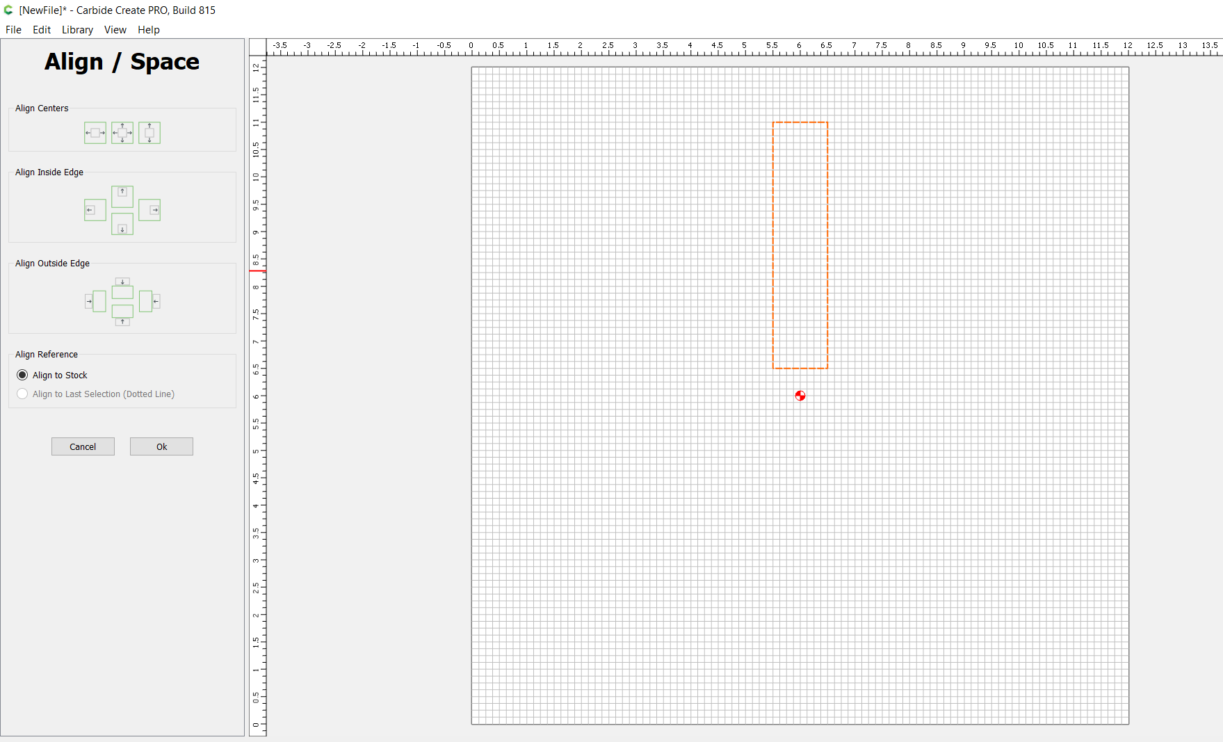

These captures will show it better:

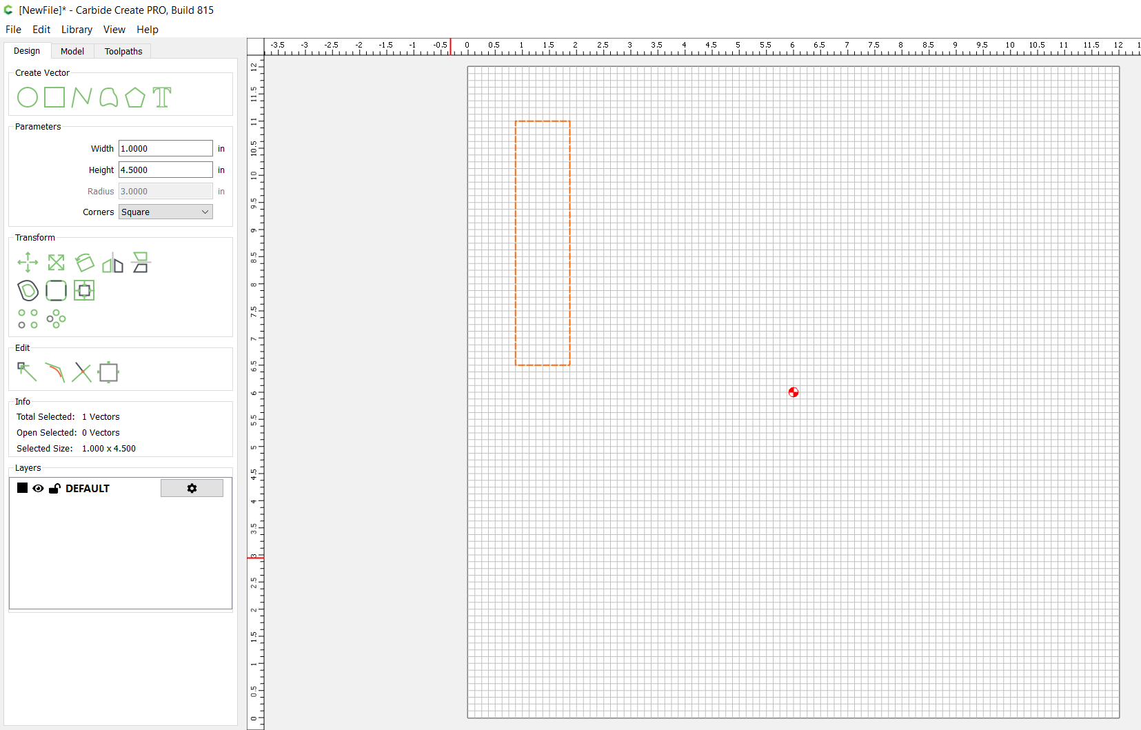

Place the object clearly off center:

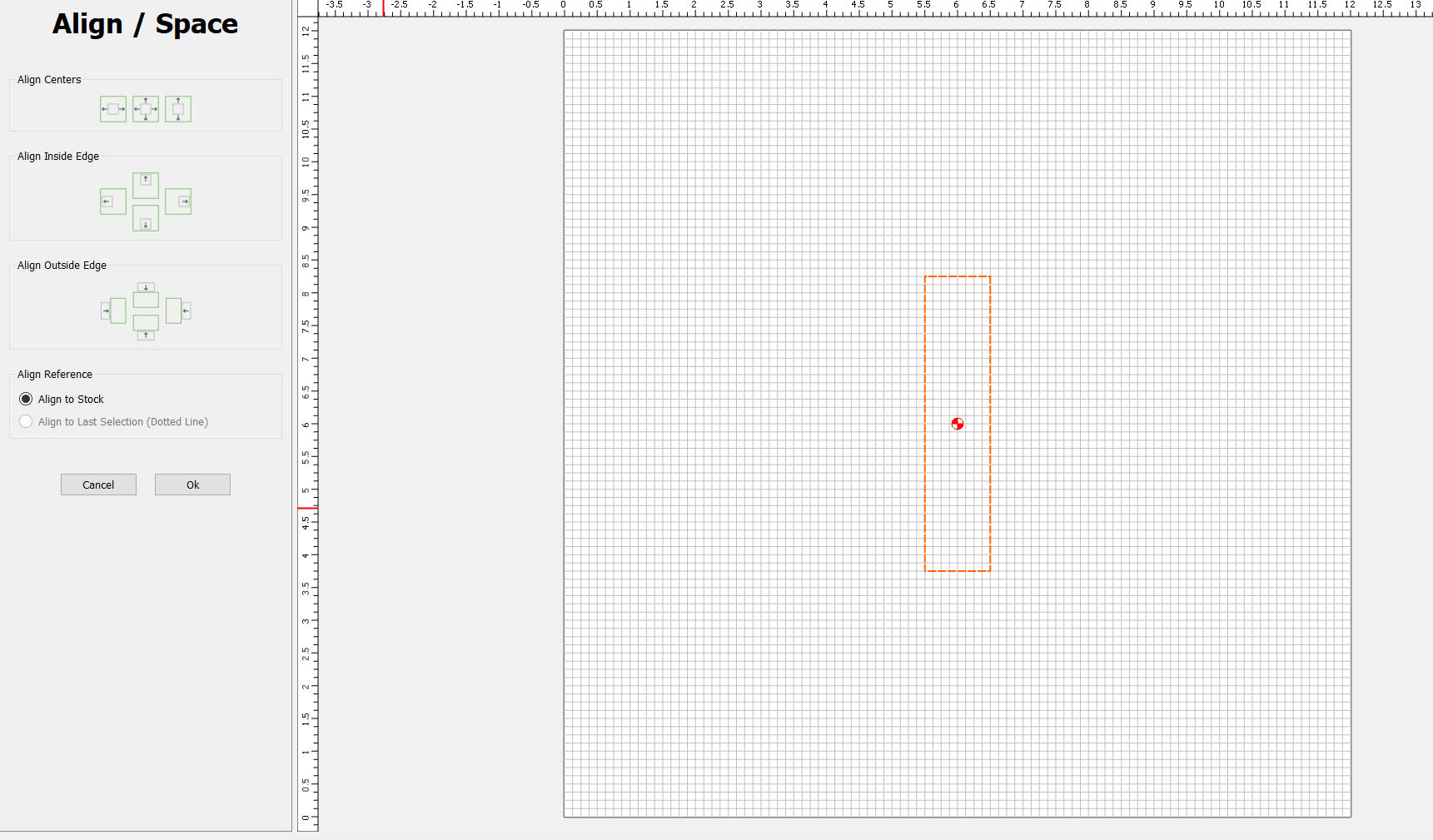

Now, Center Center
(that’s what’s supposed to happen)
Now, bottom align
Note that “X” is where it was when you first created the object
Now His Left/Right Center
Note that “Y” is now at the original spot as well.
So when you use the Align/Space dialog in this version, the original position of the object is getting used in the objects where only one axis is being changed.
