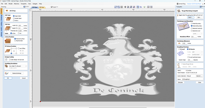

Depth of cut when using Vectric Aspire
OMG, I’m having the same issue!!! I’m utilizing Vectric Aspire to create and then import the file to Carbide Motion and I’m having my stock thickness increased. It has to be a bug in both programs. I currently have a support ticked in with Carbide to help figure out the problem.

You probably already checked this but you can configure the zero to be either top of stock or top of spoil board (bottom of stock). Having these set differently in the design software and motion can put the cut either above or below the stock

I have it set to the top of the stock in Vectric Aspire, but I don’t see where I would set the top of the stock in Carbide Motion as I looked for it. Is their such a setting?

This would depend on where you set zero relative to the stock as described in:
I’m at work so I can’t look at my Vcarve Desktop, but looking at the Vectric tutorials reminded me that there are TWO places in the vectric software to indicate top or bottom. There is in the initial job setup (on left hand side of the screen), and in the toolpaths page(s)(right hand side) when you set up the toolpath. Check both places. (I’m not sure the behavior if they conflict but might be a clue)

Yea, I have both set up correctly.
The only other thing I can think of (and I am not an expert, but have used Vcarve Desktop) is what postprocessor are you using? Could there be something in that configuration? You are working with support, and I saw your question over on the Vectric forum. So you are accessing the experts.

Yea we checked the postprocessor and I’m using the correct one. So after a few days back and forth with support, we found that my Shapeoko is set up correctly and I need to use Carbide Create for a couple simple carves to see if there is any thing weird that happens. Not thrilled about the suggestion but what can I do since they have no clue.
