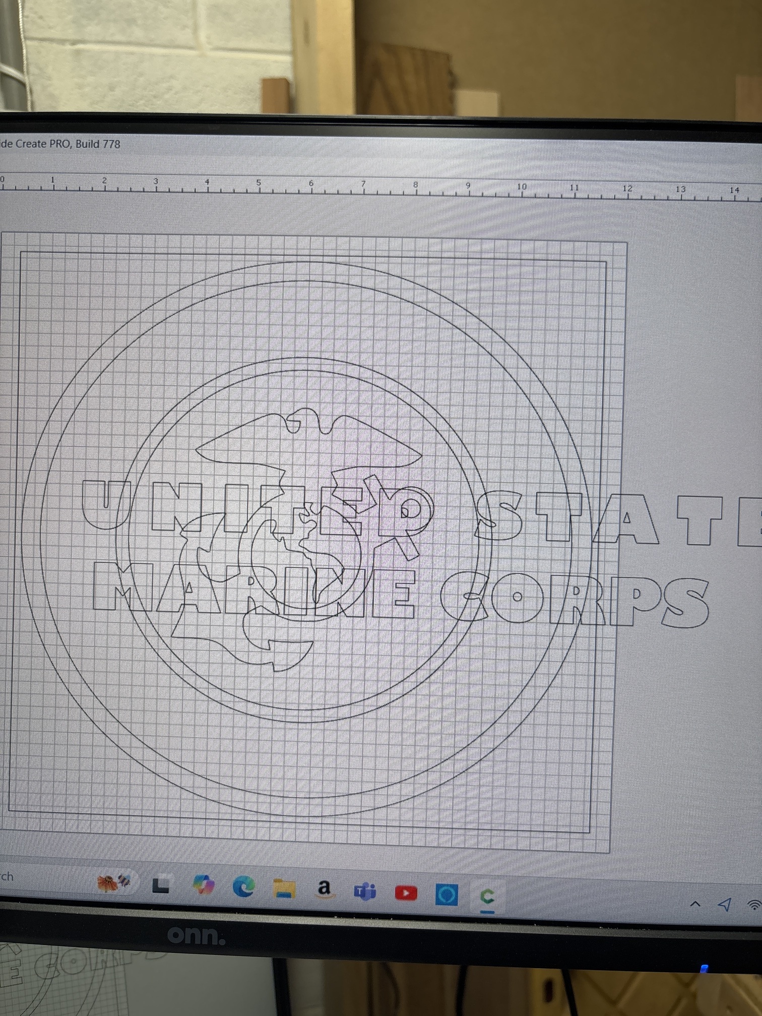

Has anyone experienced the software in Carbide create change a design without being in design mode. I did a design with “ UNITED STATES MARINE CORPS” arched around a circle. Cut the design in bamx. Finished the cut, reopened the file and the words were now STRAIGHT across the design. This happened twice today with the same design. Attached is a photo of the design. The words should be arched inside the inner circle
Usually this is caused by creating a file in one version, saving it, then opening it in an older version which doesn’t support the feature in question.
If that’s not it, upload the file and we will look into it with you.
I’ve had this happen with text placed on an arc. It may not happen the very next time you open the file but it does occur and can confirm within the same version of cc.
To remedy, when I am happy with my text on the arc, I convert to curves.
If you can upload a file which was saved with that feature enabled, but which when opened doesn’t have it, we will do our best to look into it with you.
