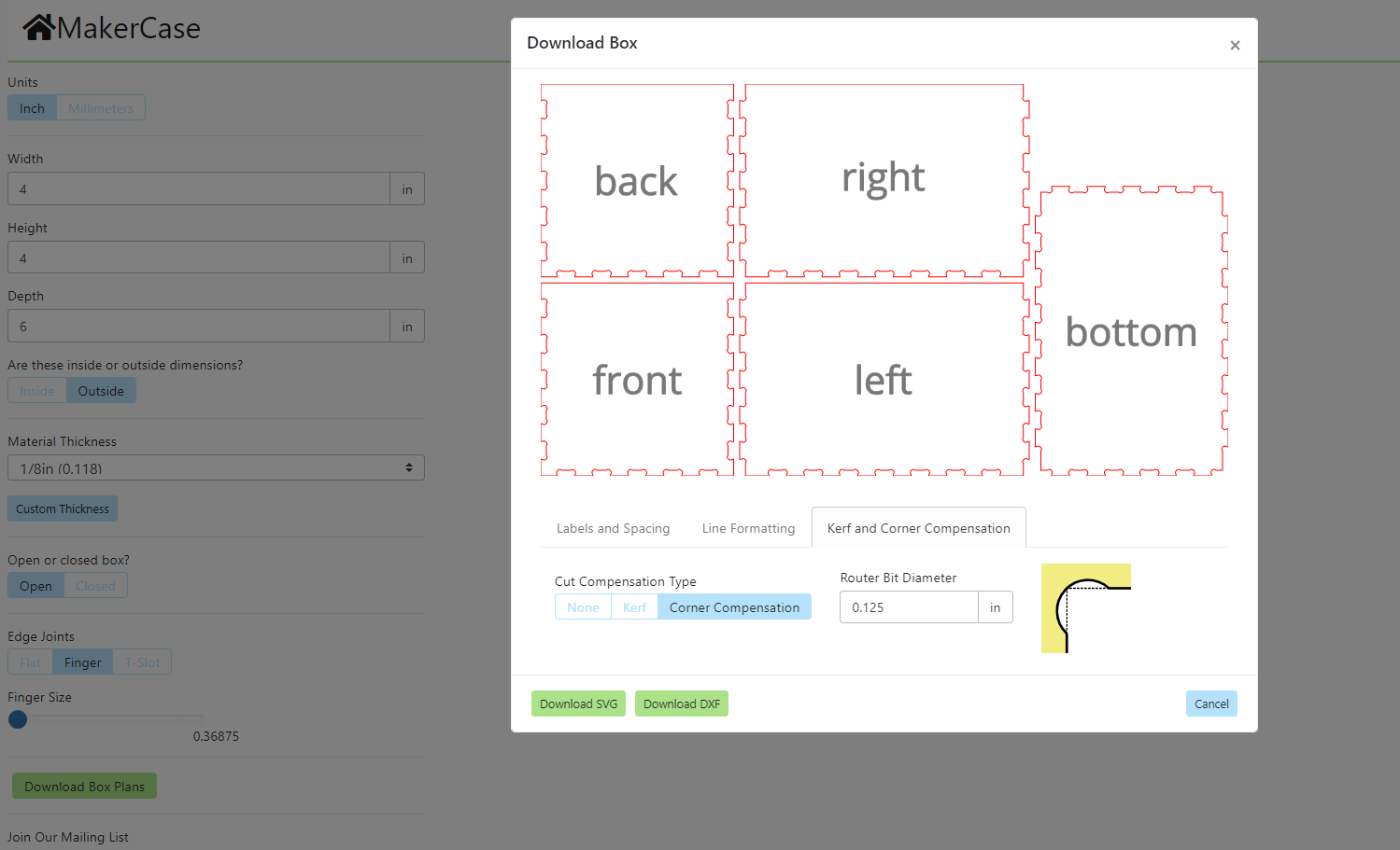

what about using the boxmaker’s corner compensation option?
Is that new? I haven’t looked at boxmaker in a long time, but I don’t remember that.
I use an extension in Inkscape for laser cut boxes, but I may take another look. For irregular stuff, I just use Fusion, but it’s not quick.
I don’t like that because it leaves an obvious void — might be okay with a small endmill though.

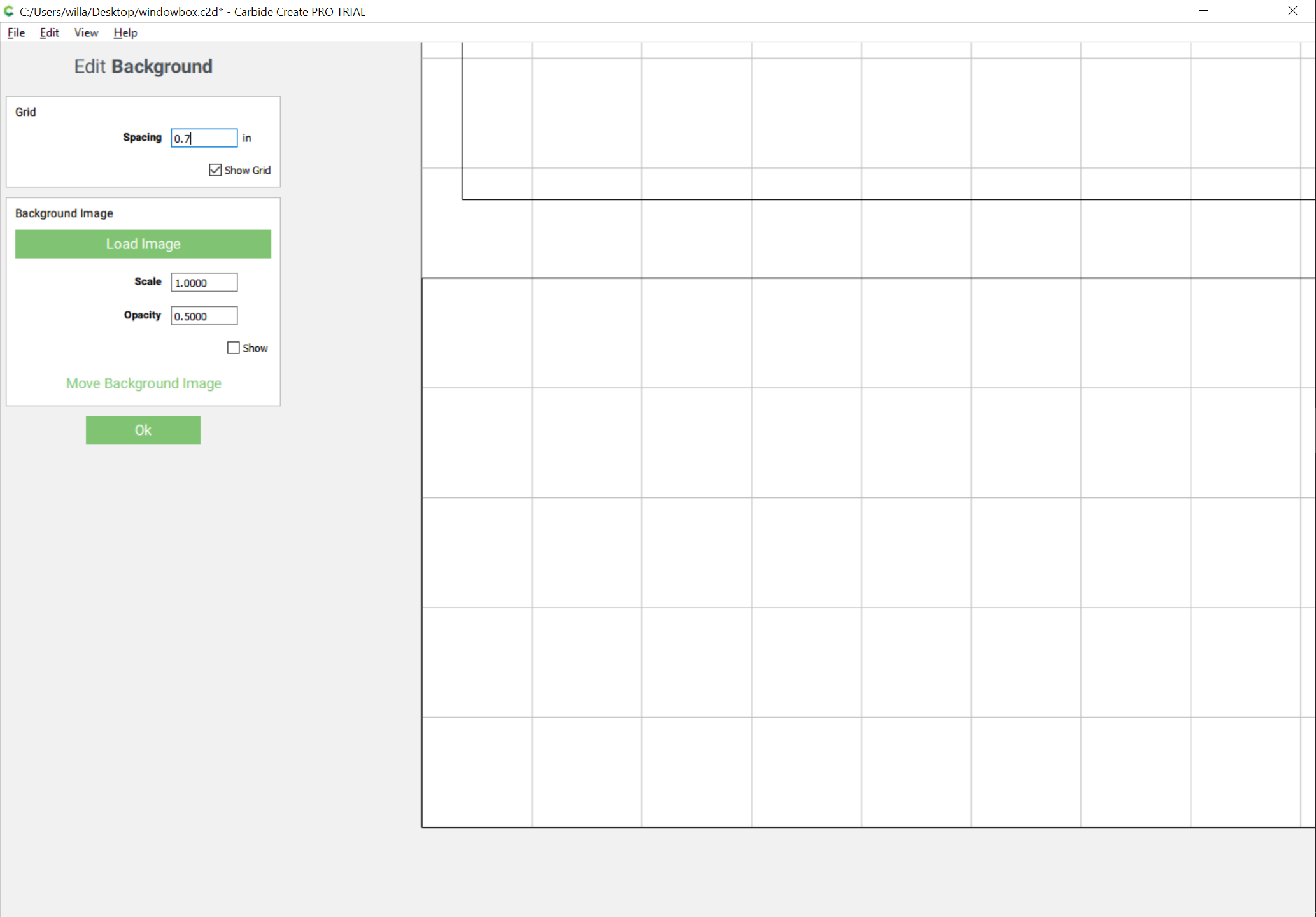

Given stock 3.5" wide, and wanting to make a square box which is 22.75" on a side, this should be easily drawn up, and should be able to be cut from an 8’ long board easily sourced from a home center.
Begin by setting the stock size to accommodate all 4 boards:
Note that since we are using a 1/4" endmill it will be necessary to add a sacrificial spacer so that we can cut the side boards shorter, so we adjust the file a bit:
The top and bottom boards will be the plain ones with the blind fingerjoints, while the middle two boards need to by shorter by the 6.5mm material left to hide the joinery, so we switch to metric, select each board in turn, and reduce it by 13mm:
Next up is drawing the fingers — 5 seems a reasonable number, and nicely divides into 3.5:
and we draw in a rectangle for the side–side spacing (0.768in. is a reasonable approximation of 19.5mm):
Select the rabbets for the half-blind fingerjoints and apply a suitable radius to aid in previewing:
We actually want these to be separate pockets, which slightly overcut the board ends, so we adjust their sizing/placement appropriately:
we can then assign a 13mm deep toolpath:
— it’s then just a matter of drawing in the geometry to relieve the fingerjoints.
One consideration is if the boards will be 24" (or so), we should set the stock width to match:
