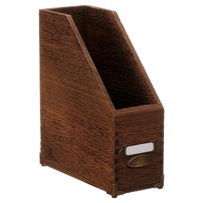

There are a number of commercial options:
So there is certainly precedent for wooden boxes — we’ll try for an inexpensive material, since this is going to be a fairly large project (sorry Nomad owners) — Luan Plywood is available at most home centers, usually as underlayment, a bit of care should allow one to pick out a sheet in good shape which can be cut up to fit on the bed:
