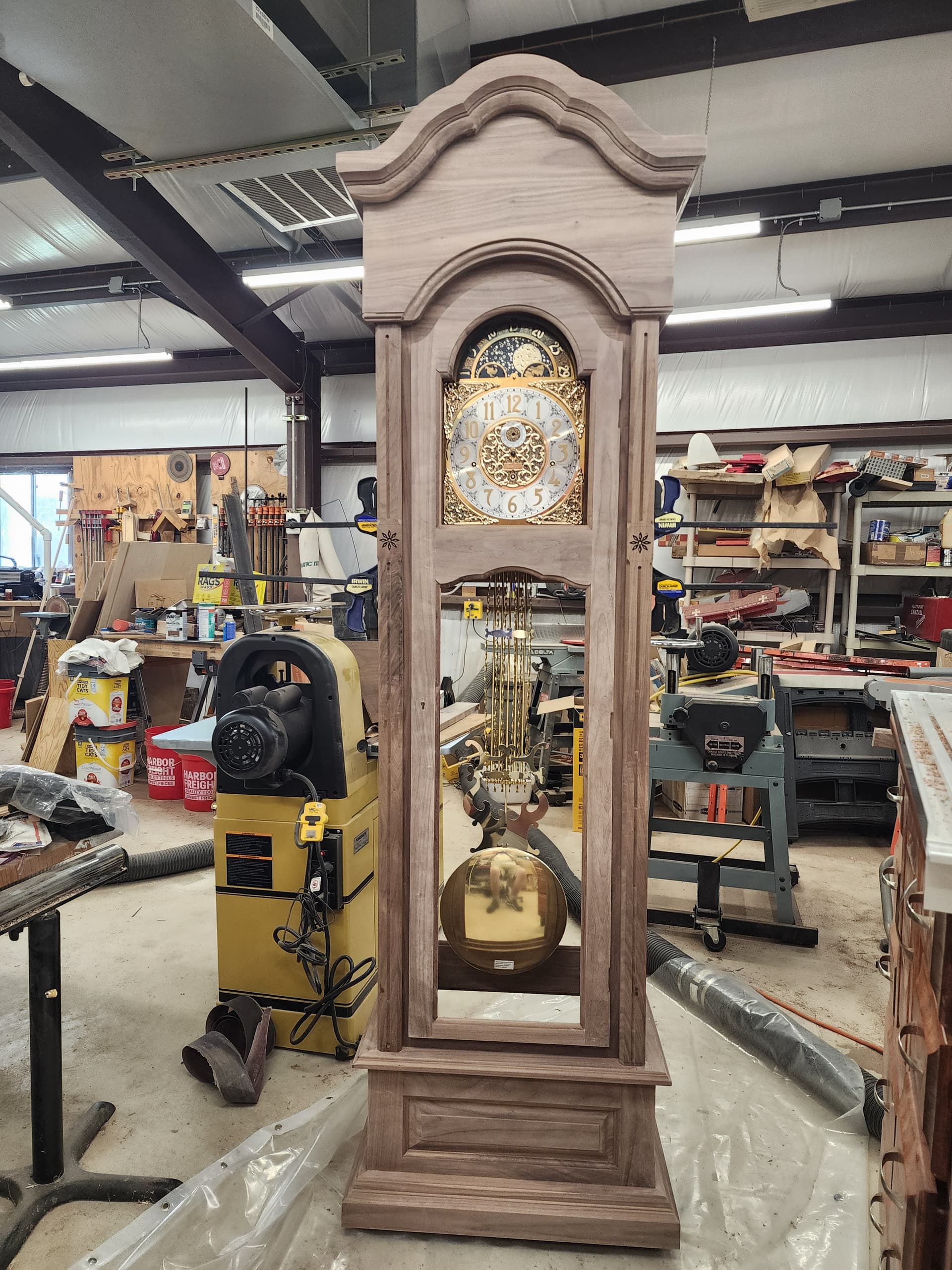

I made a design on CC and put it on 2 pieces of 1 7/8" wide X 56" long Walnut. Attached it to clock cabinet and it worked. Used a .062 end mill on Shapeoko Pro 4 XXL.

Wow that is a nice looking clock. I have made a lot of clocks over the years but nothing compared to your clock. Great work. I have priced those clock movements and they are quite expensive. Not to mention the walnut is quite expensive. You spent some money on this project but it looks great.
What are you going to finish it with?
Danish oil dark walnut. I’ve finished some of the extraneous parts and they look great. Once fully cured I will spray it with oil based poly.
The movement is a Kieninger KSU 93 CM cable driven with a twisted lyre pendulum.
