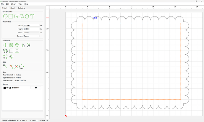

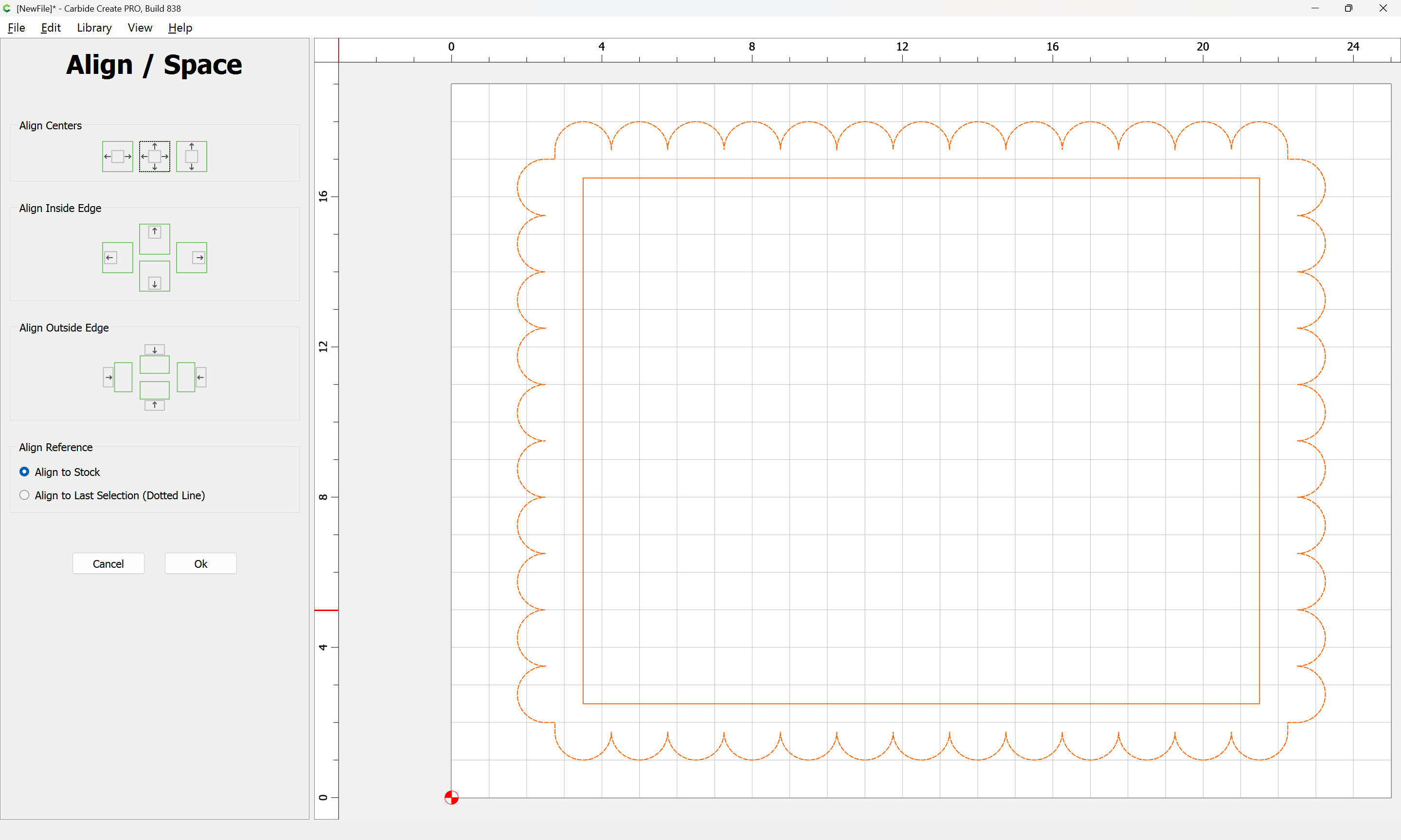

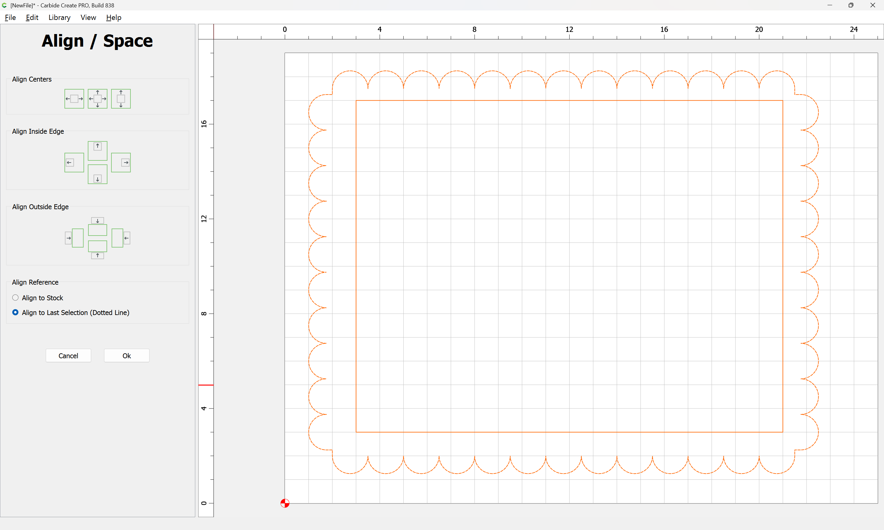

Then draw in a rectangle for the opening:

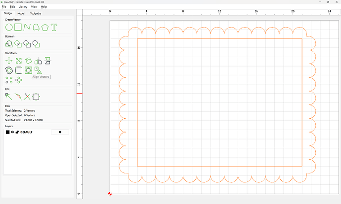

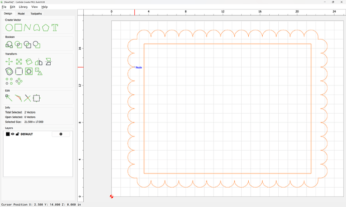

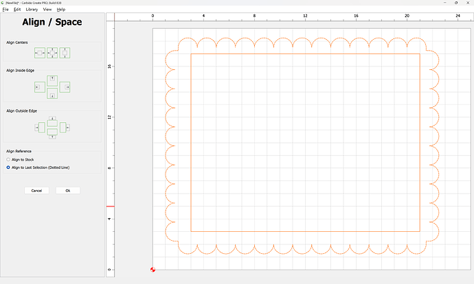

and center it:

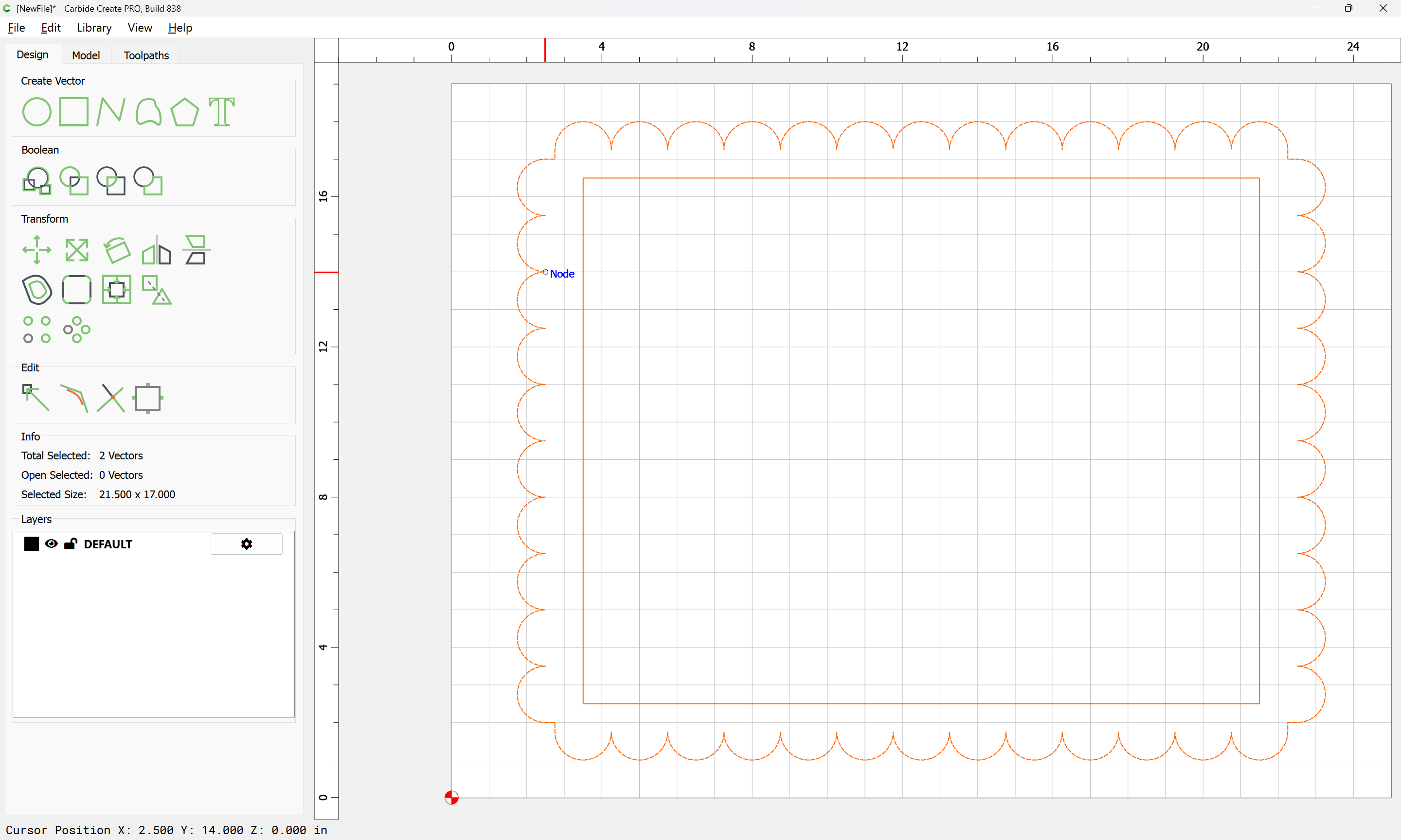

OK

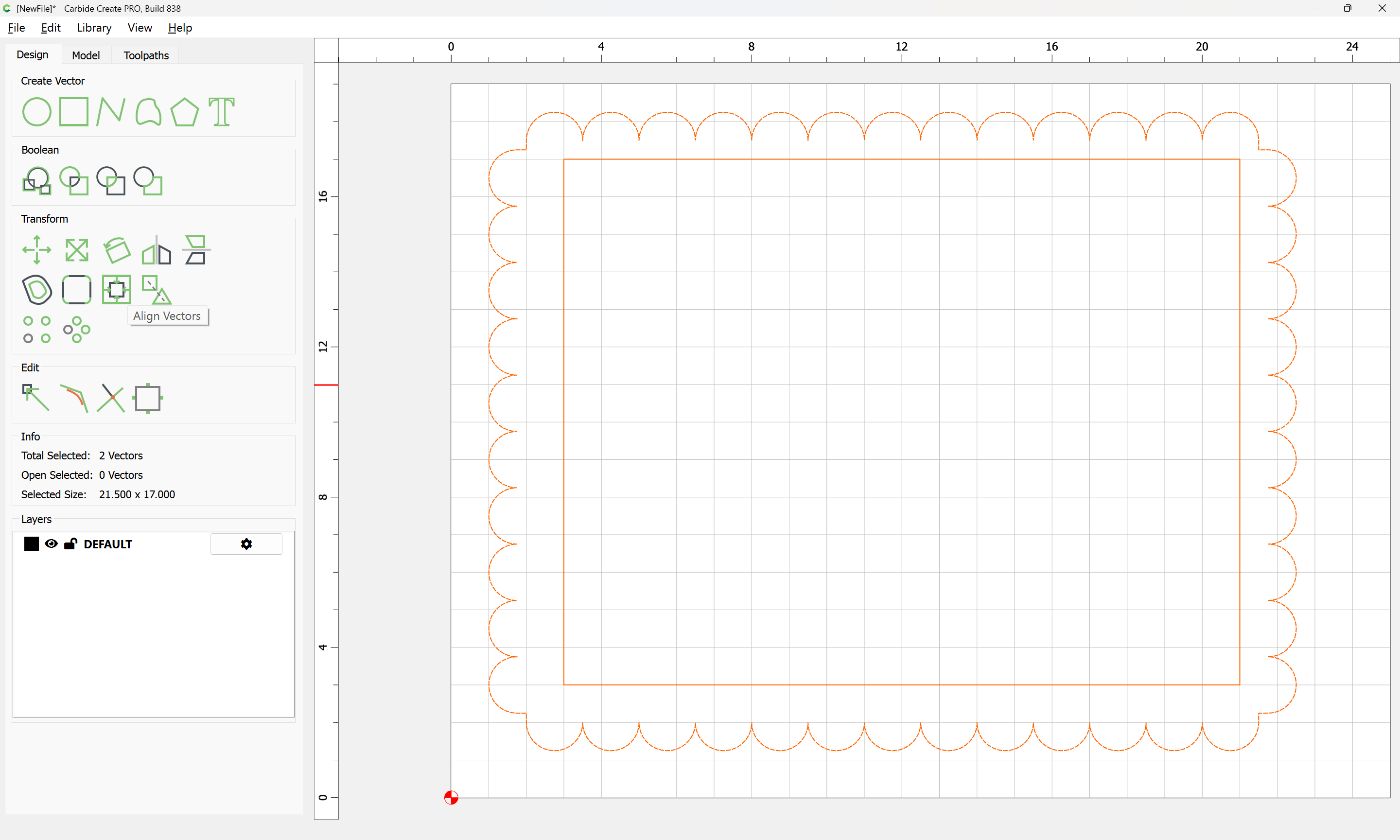

Then set up toolpaths — this will probably need the use of a Roundover tool:
