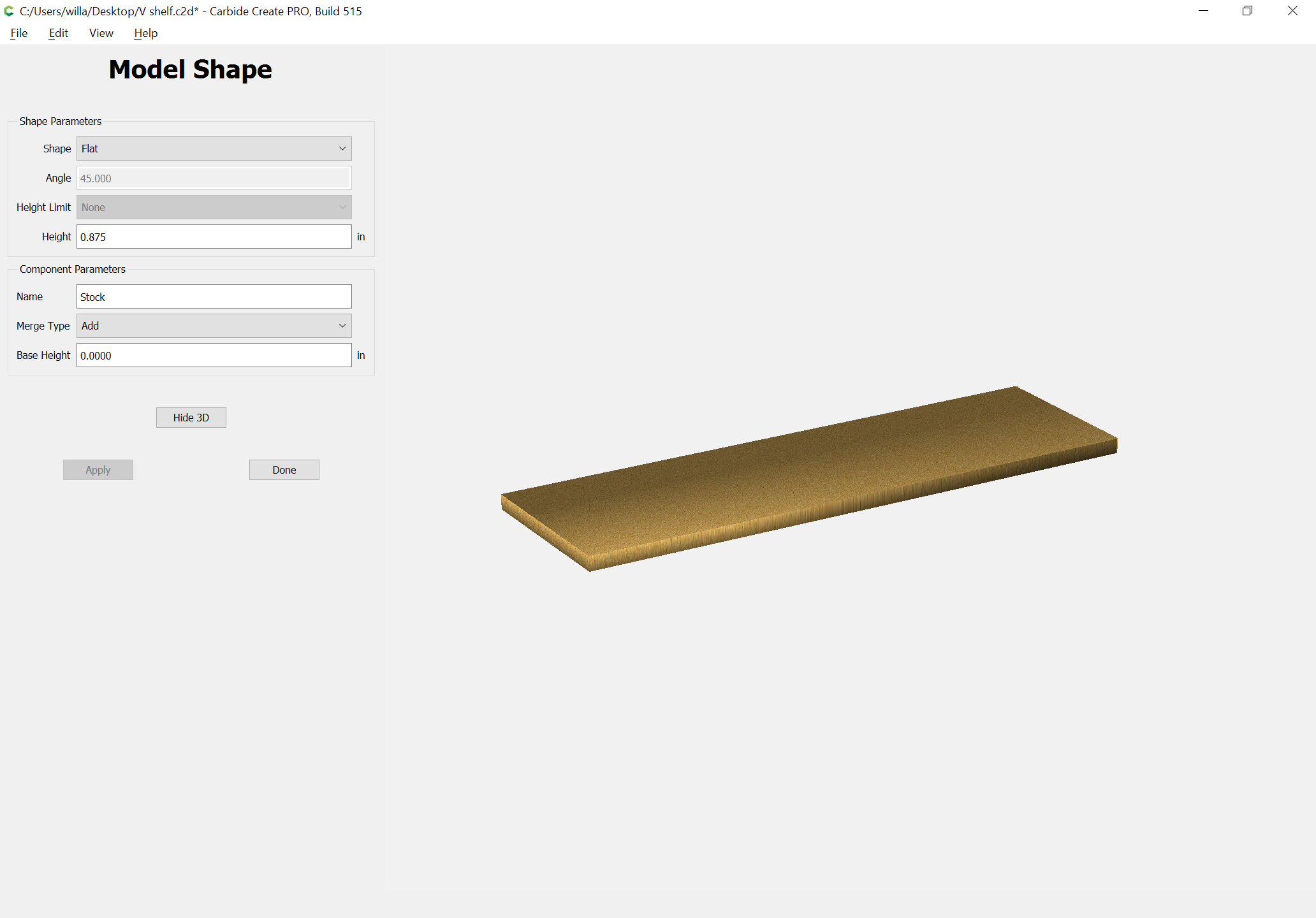

Working a design from Facebook:
First set things up:
bottom left. 0.875 thickness down to 0.25 at the ends. 1/4 ball or flat EM.
Start by drawing a rectangle to extrude the stock (which needs to be twice as tall as desired, as does the stock size):
Draw in a rectangle which defines where we want the curve:
(it needs to be significantly taller than the stock area)
then double it in size horizontally and reposition it in alignment with the original:
then model it as a subtraction:
Repeat for the other side:
Then draw in geometry to subtract the extra:
V shelf.c2d (2.1 MB)
