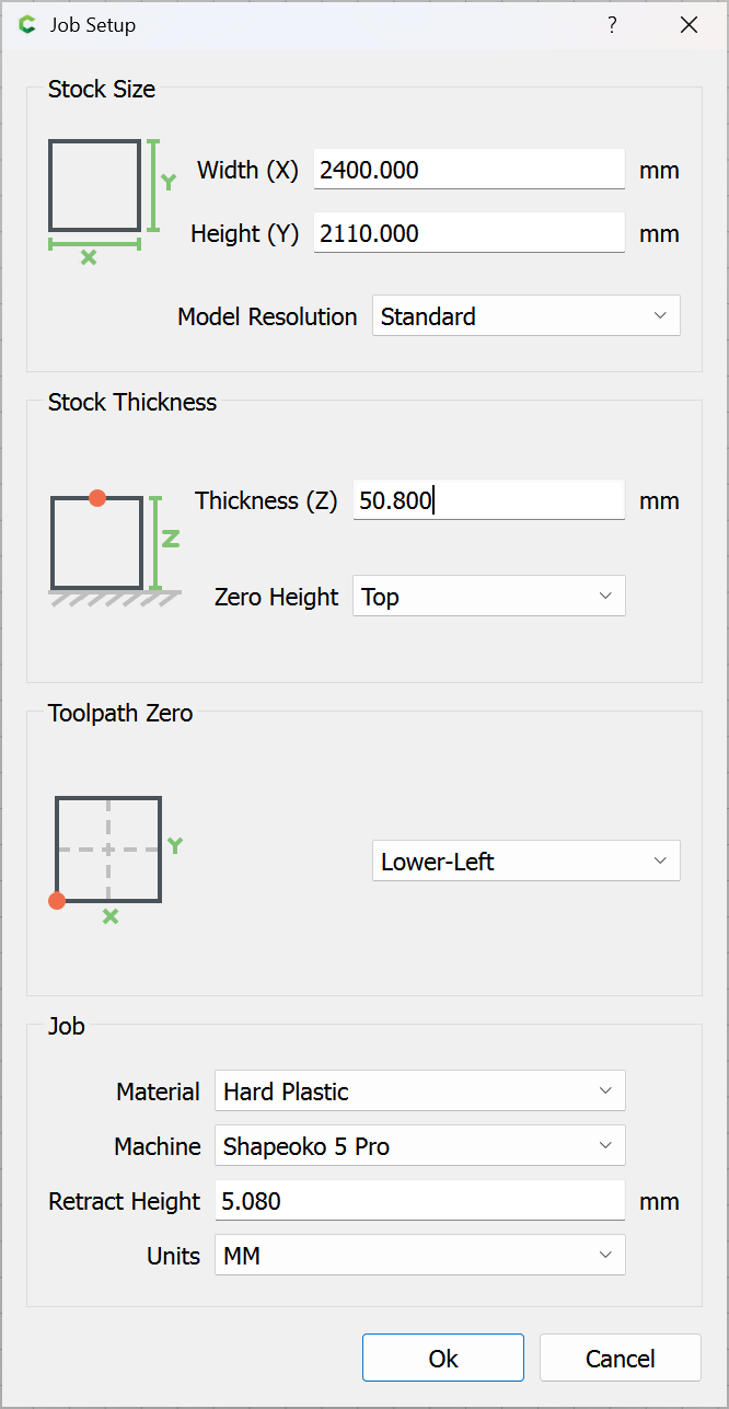

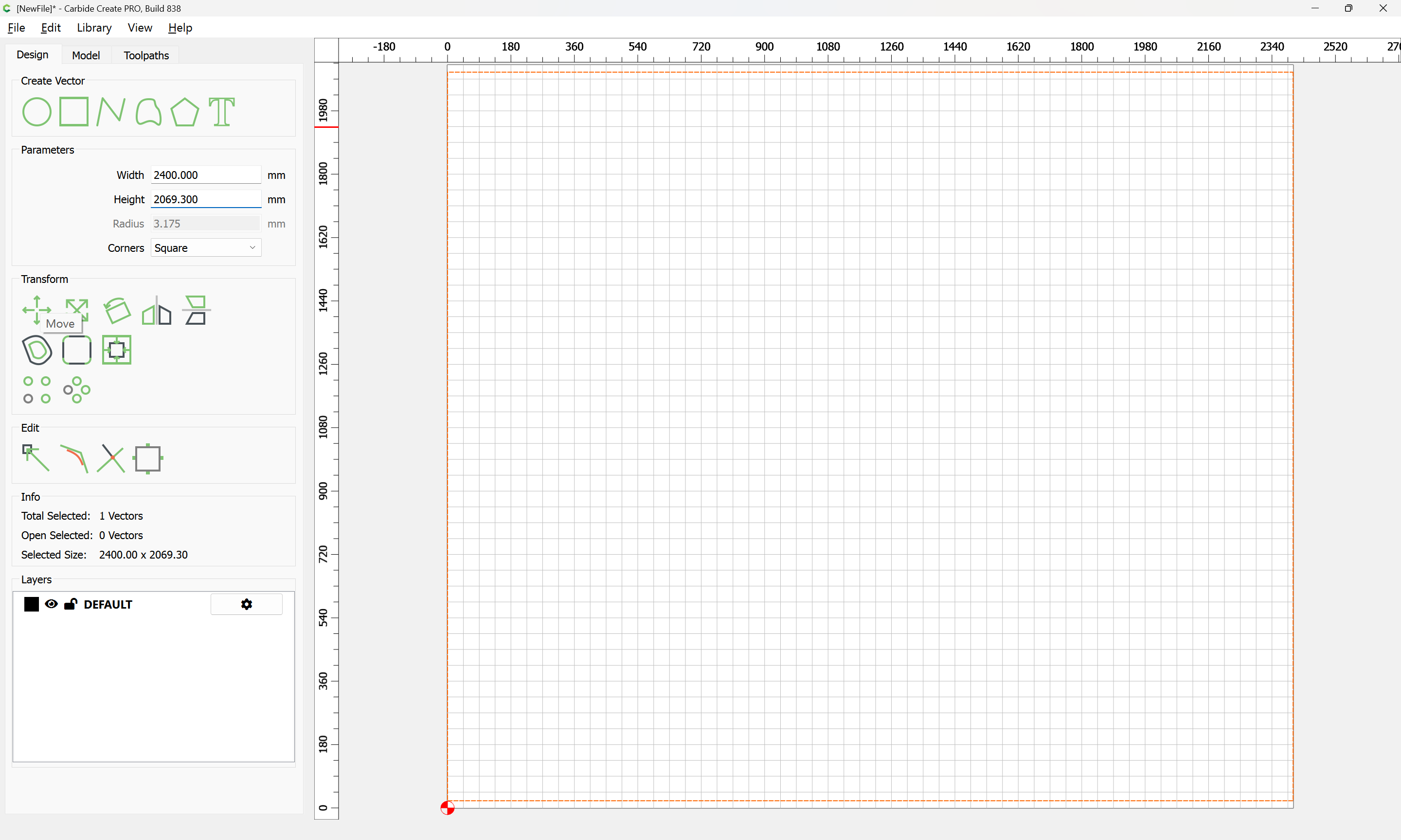

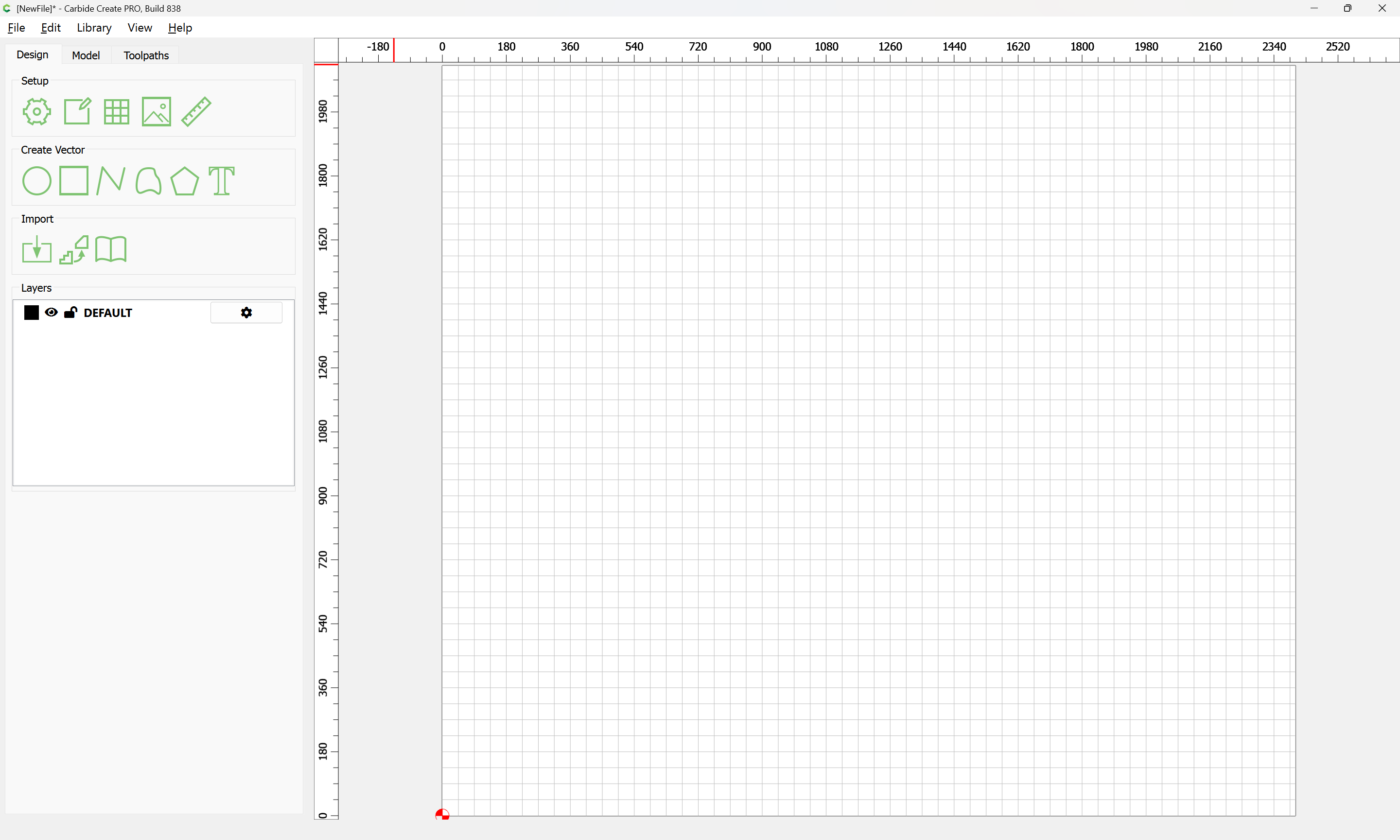

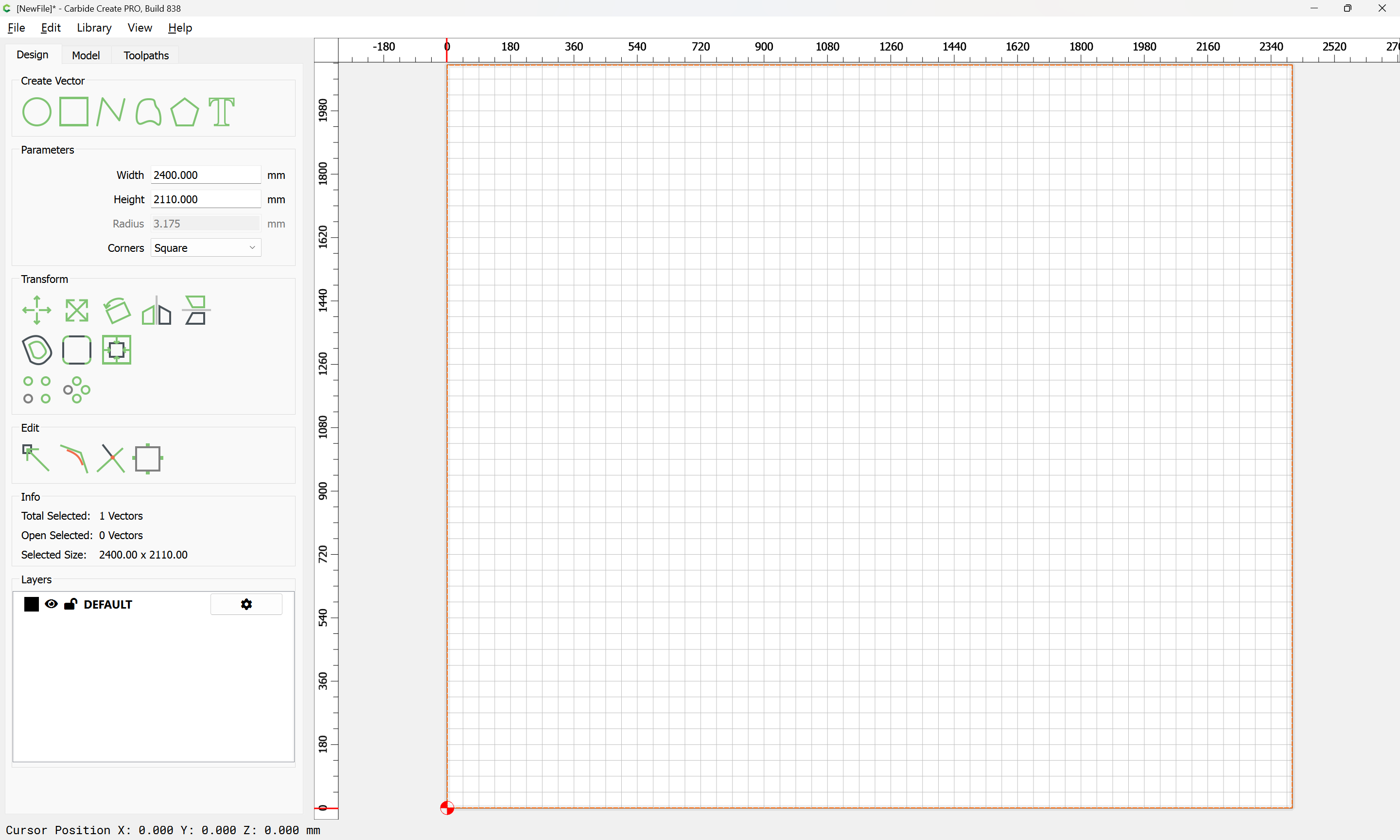

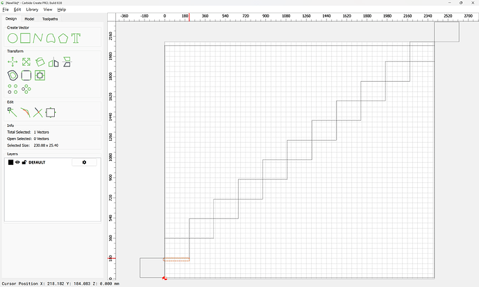

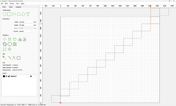

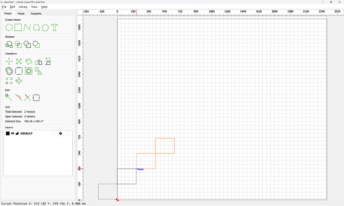

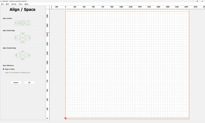

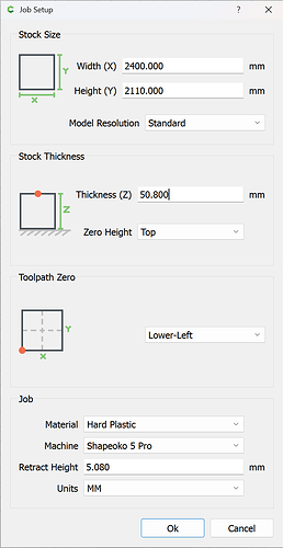

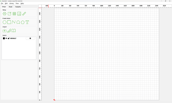

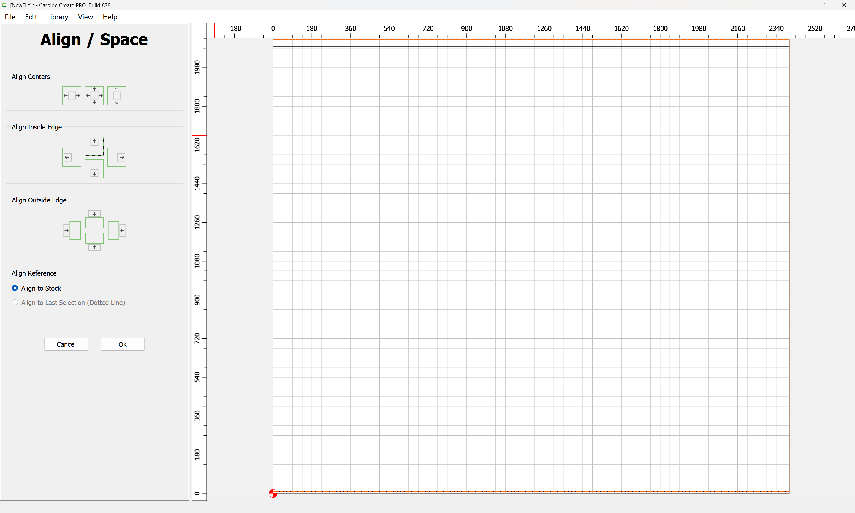

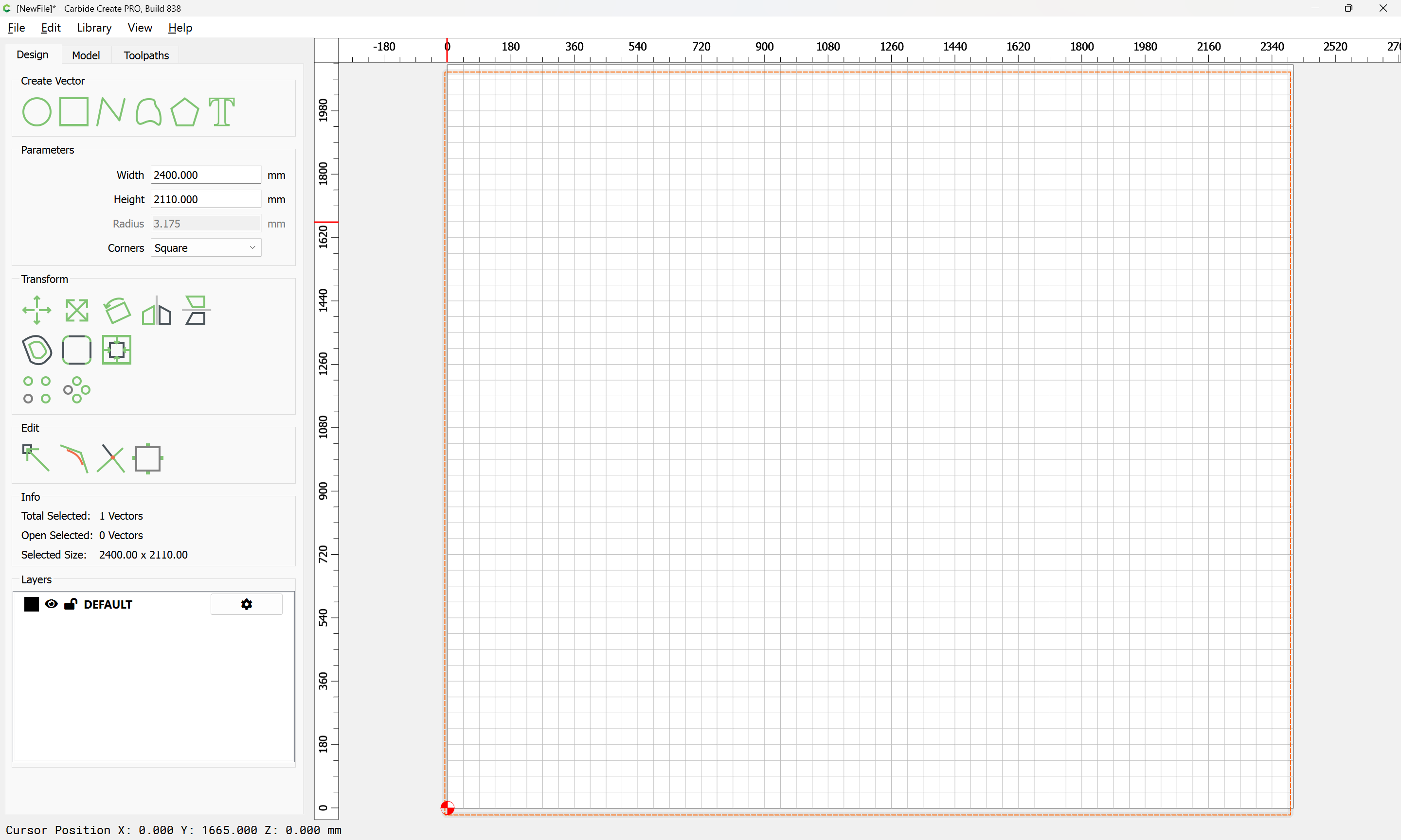

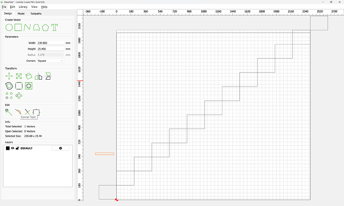

Start by setting Job Setup:

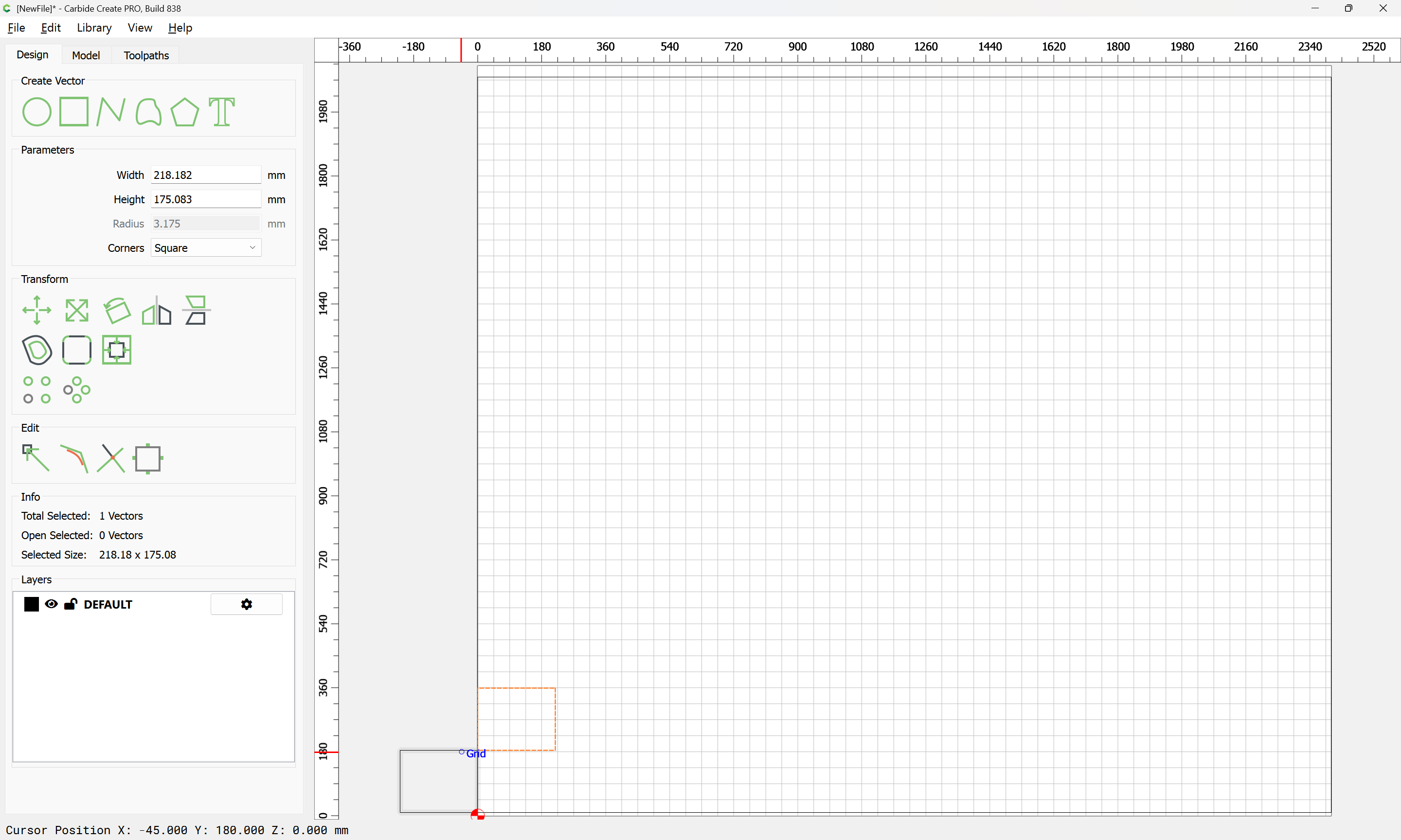

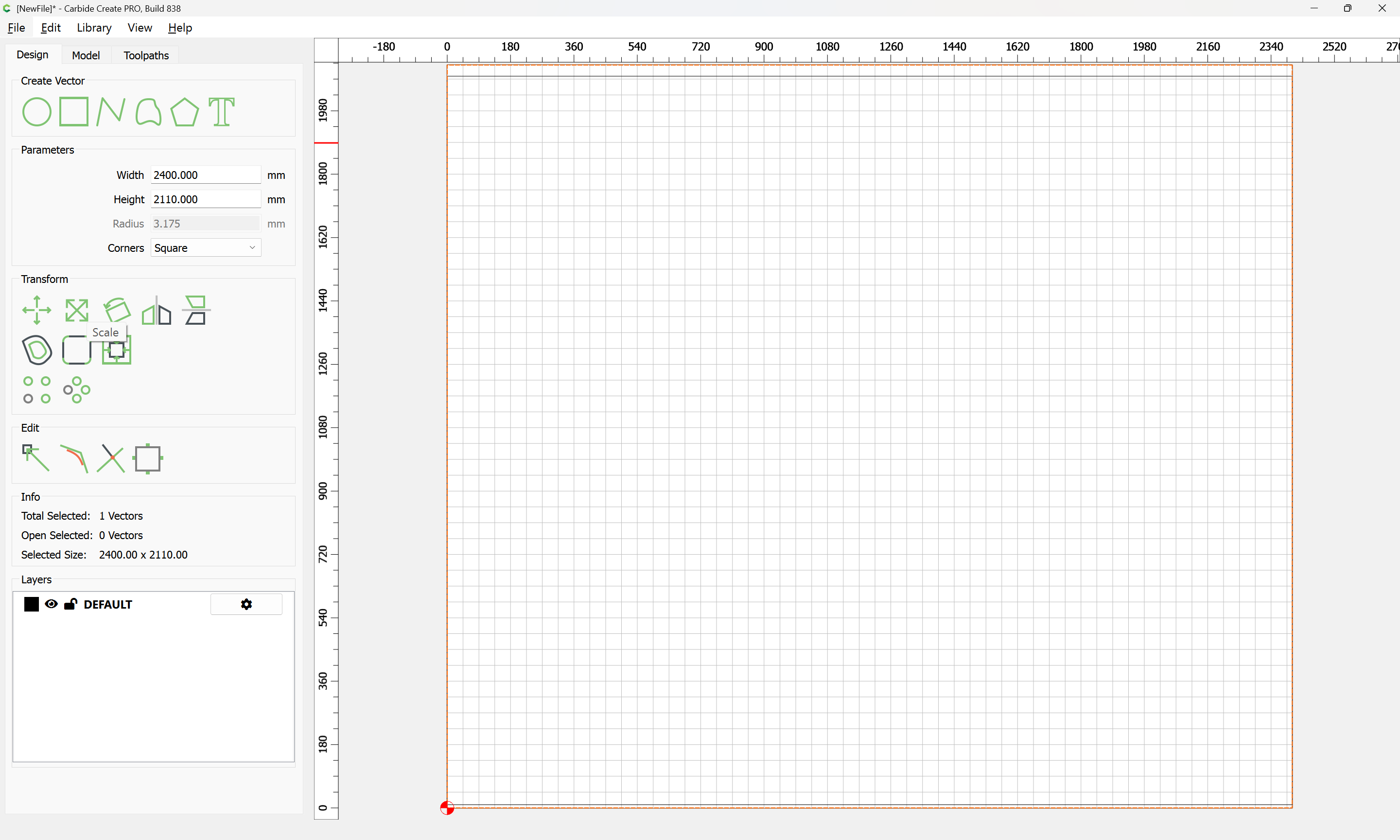

Draw in a rectangle:

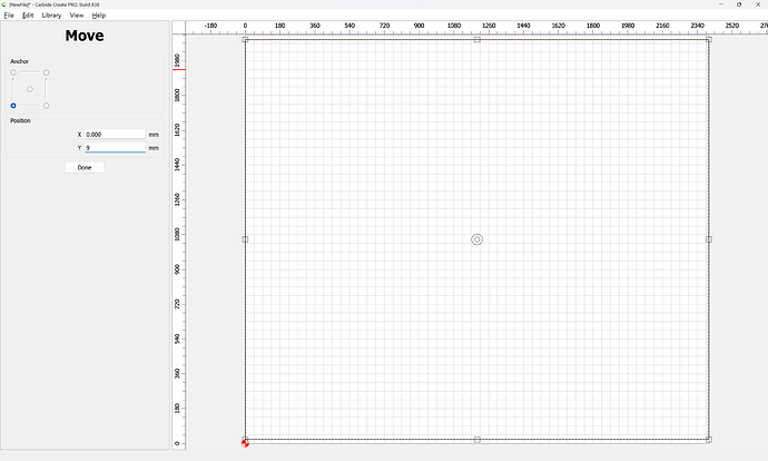

and position it:

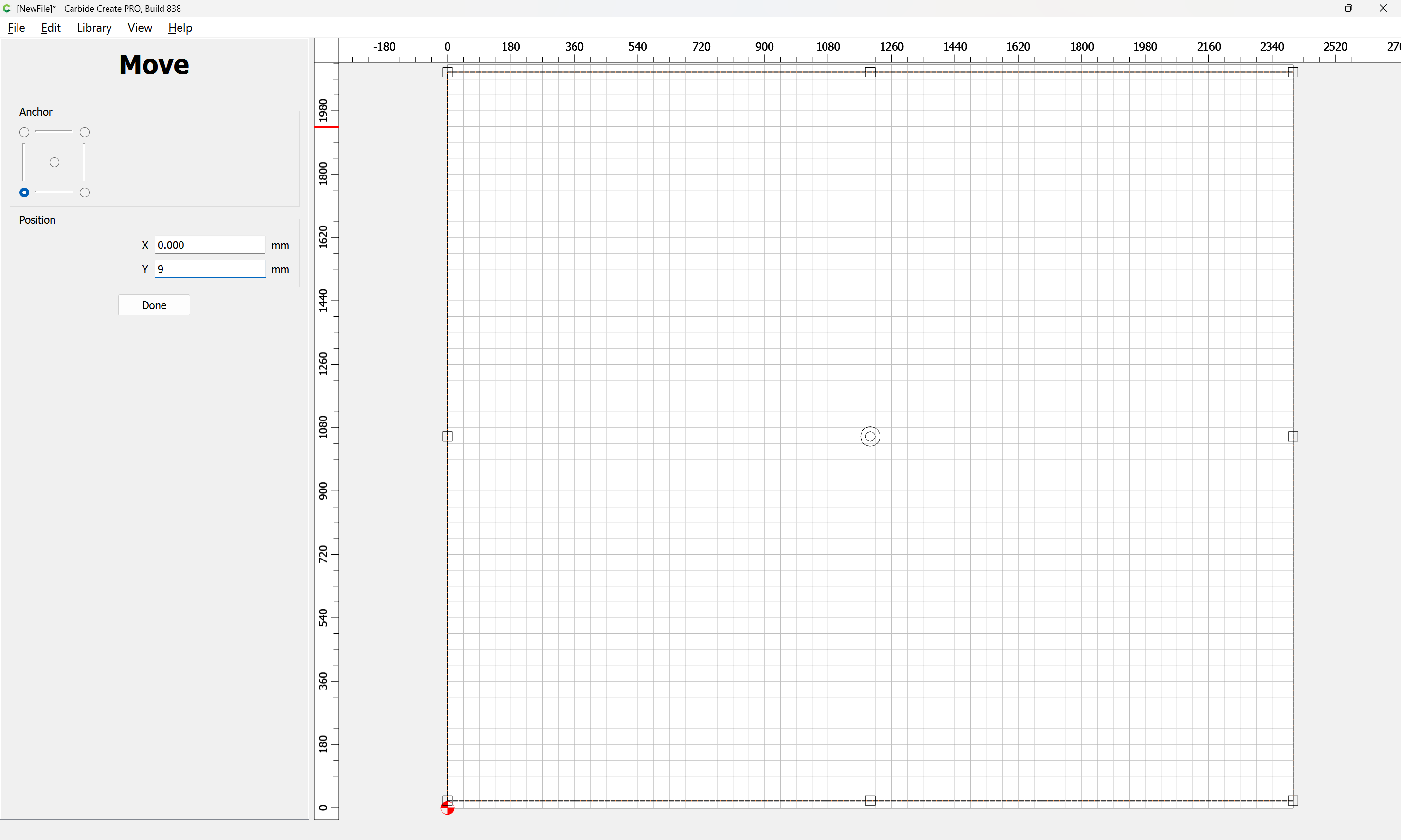

and then subtract the sub/finished floor dimension from top and bottom:
and adjust the position:

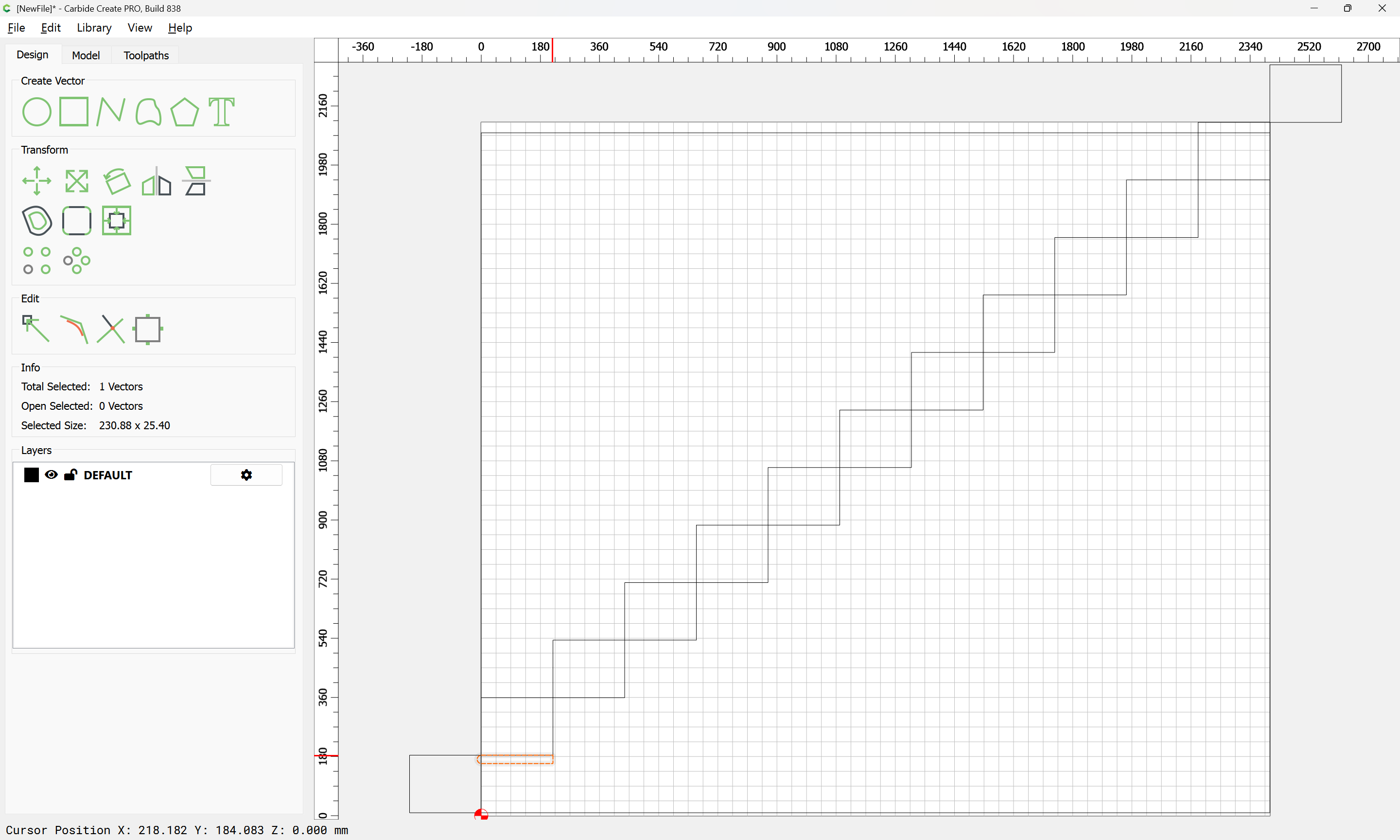

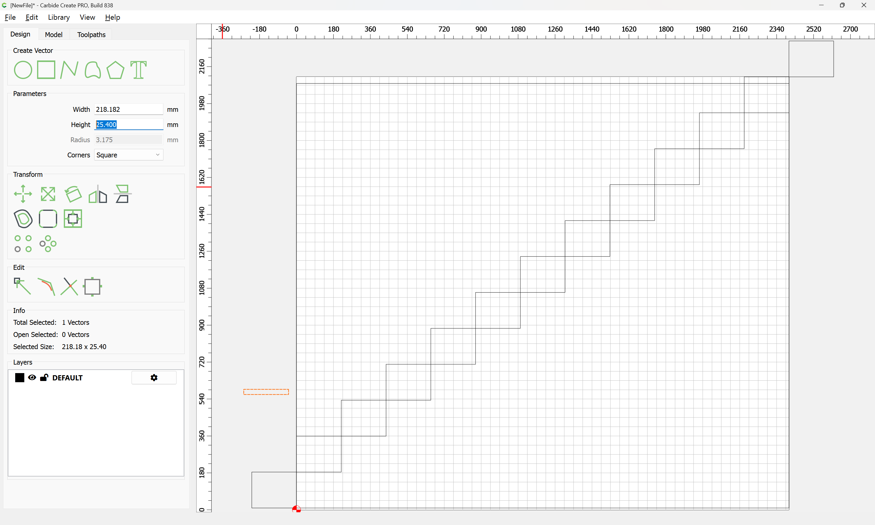

We then re-draw the original:
and subtract only the bottom finished floor dimension:
and re-position it at the top:

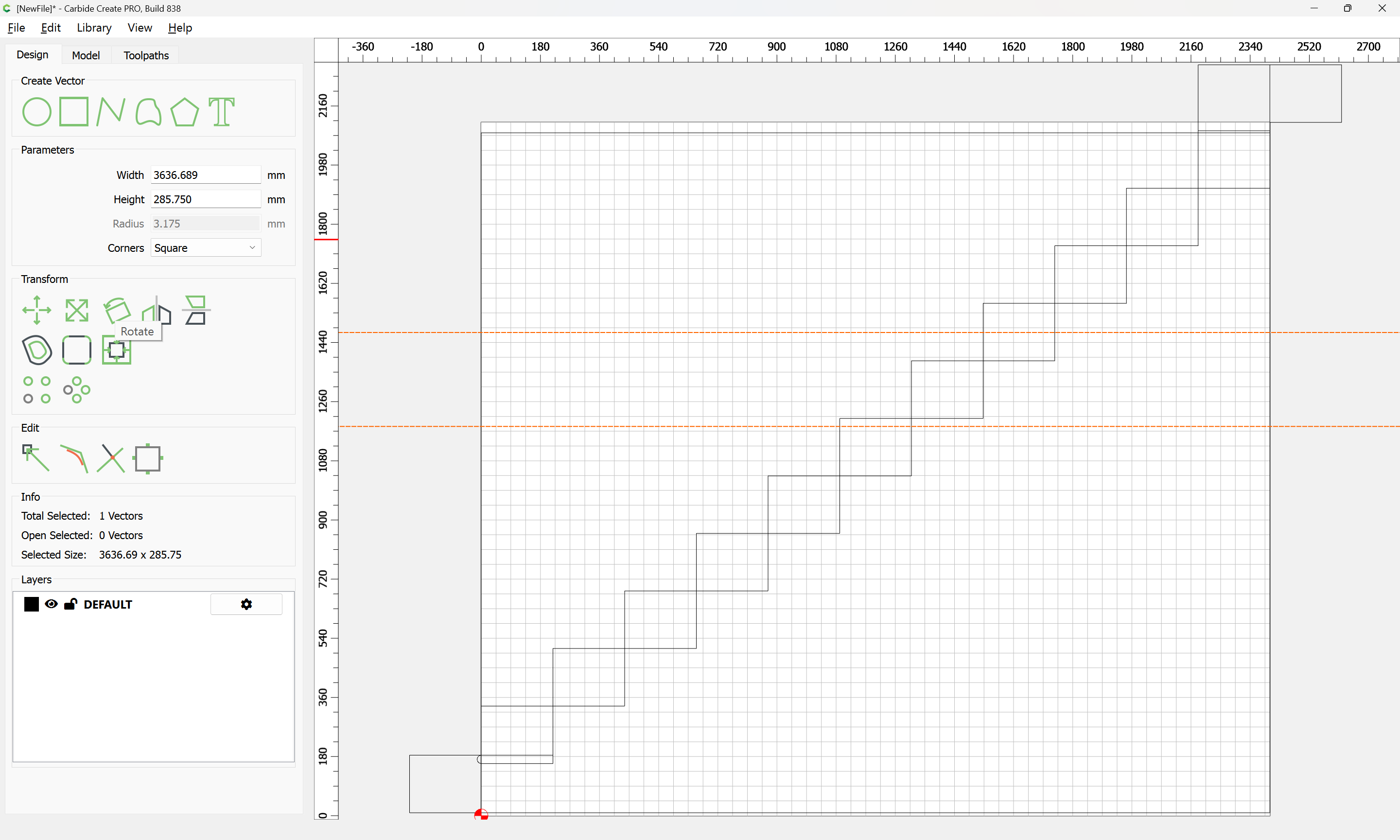

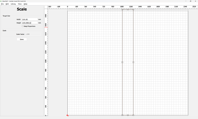

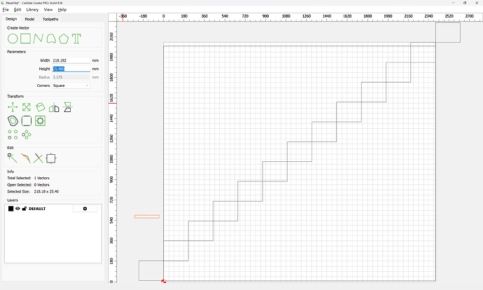

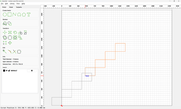

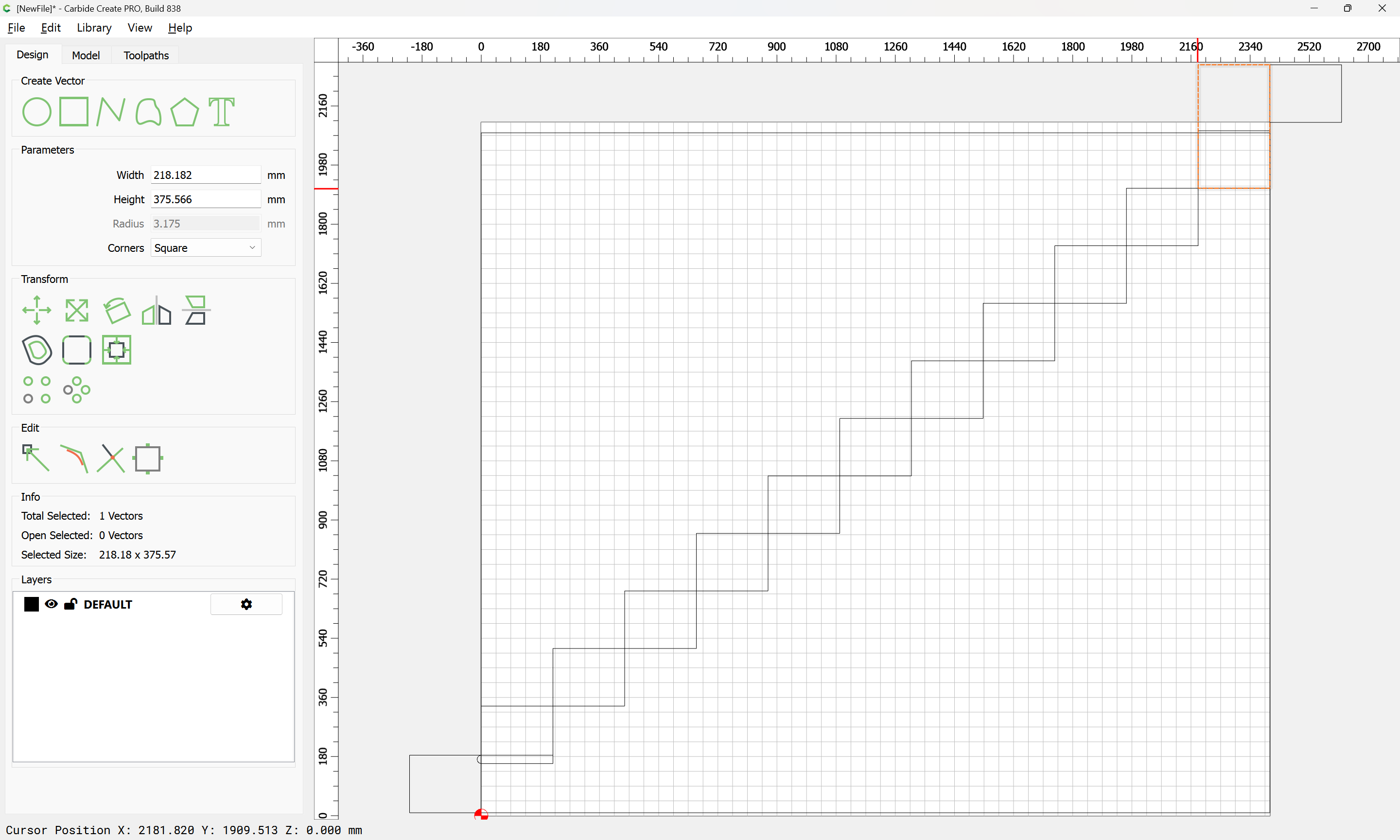

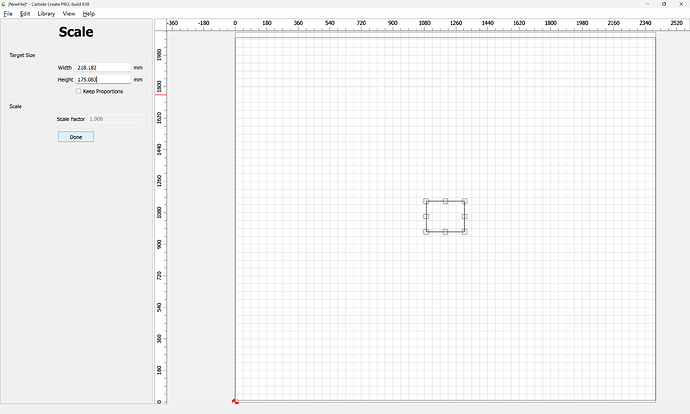

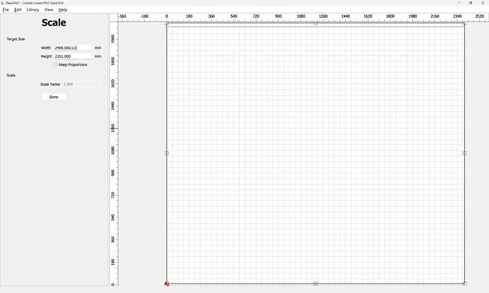

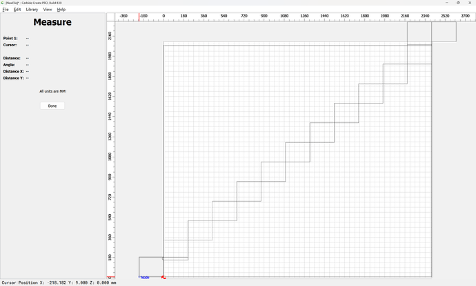

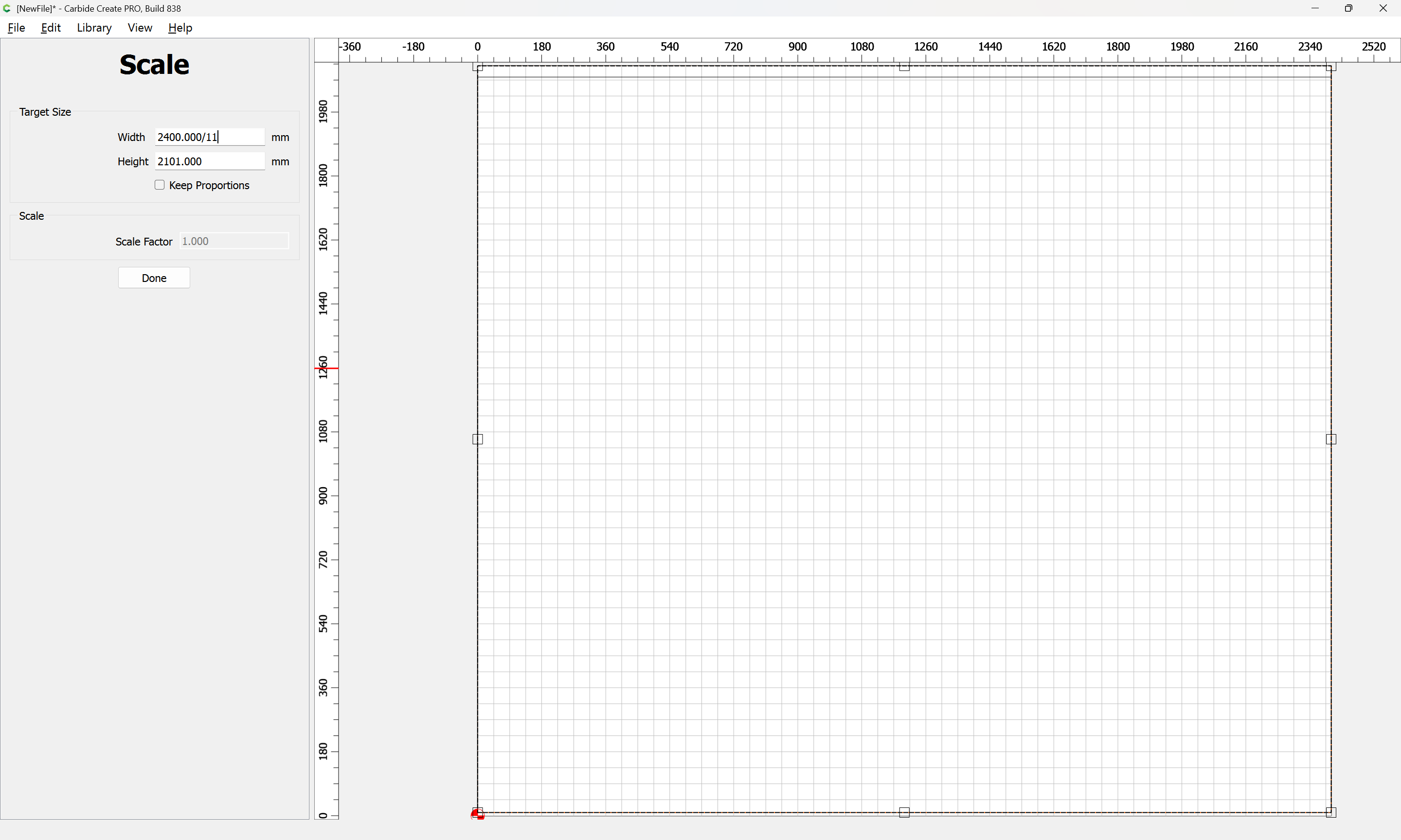

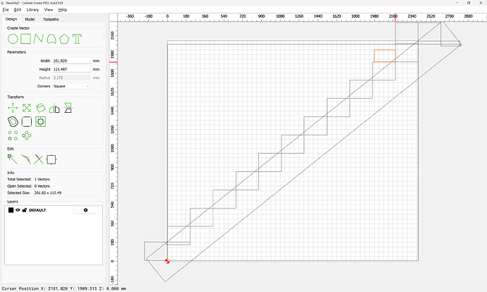

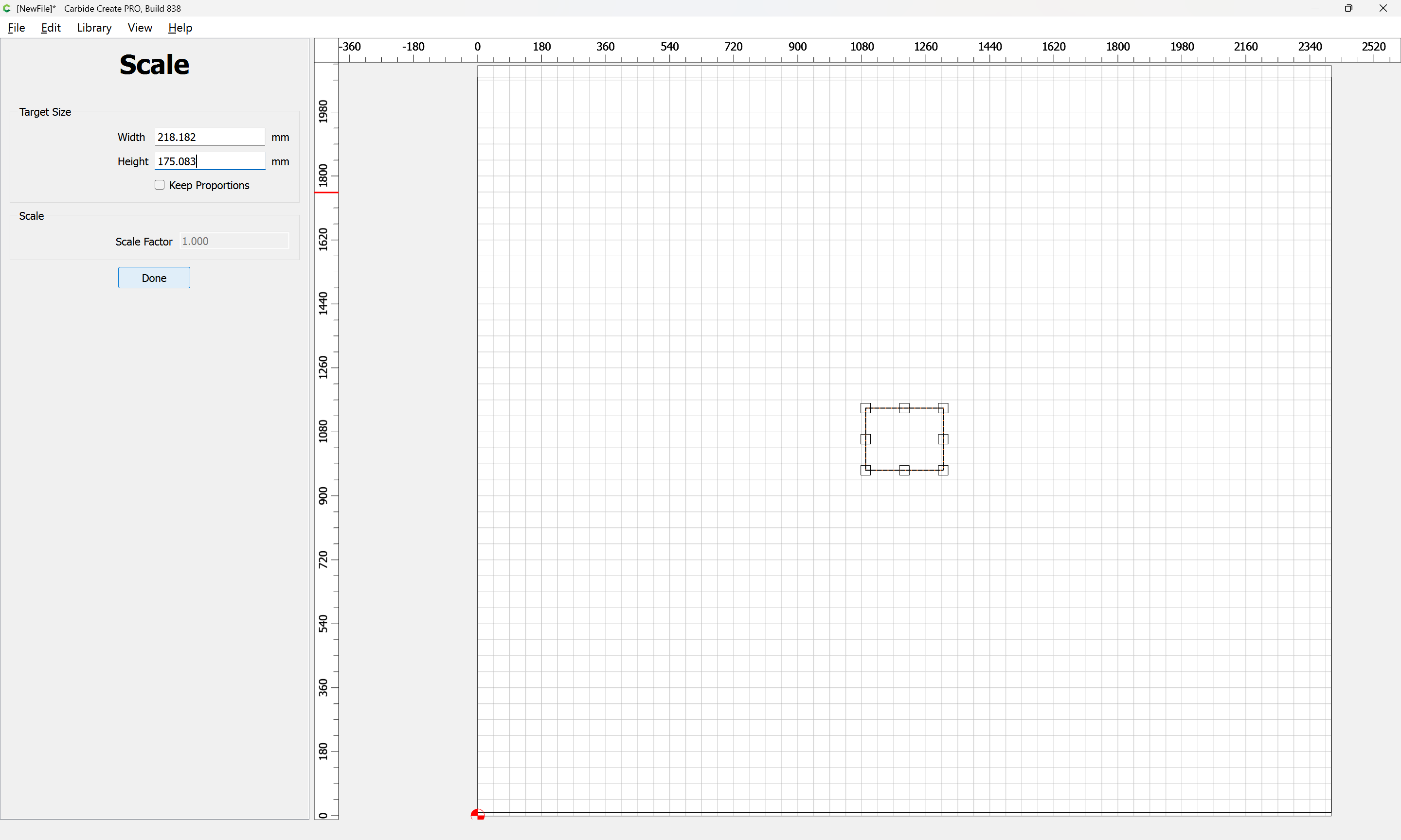

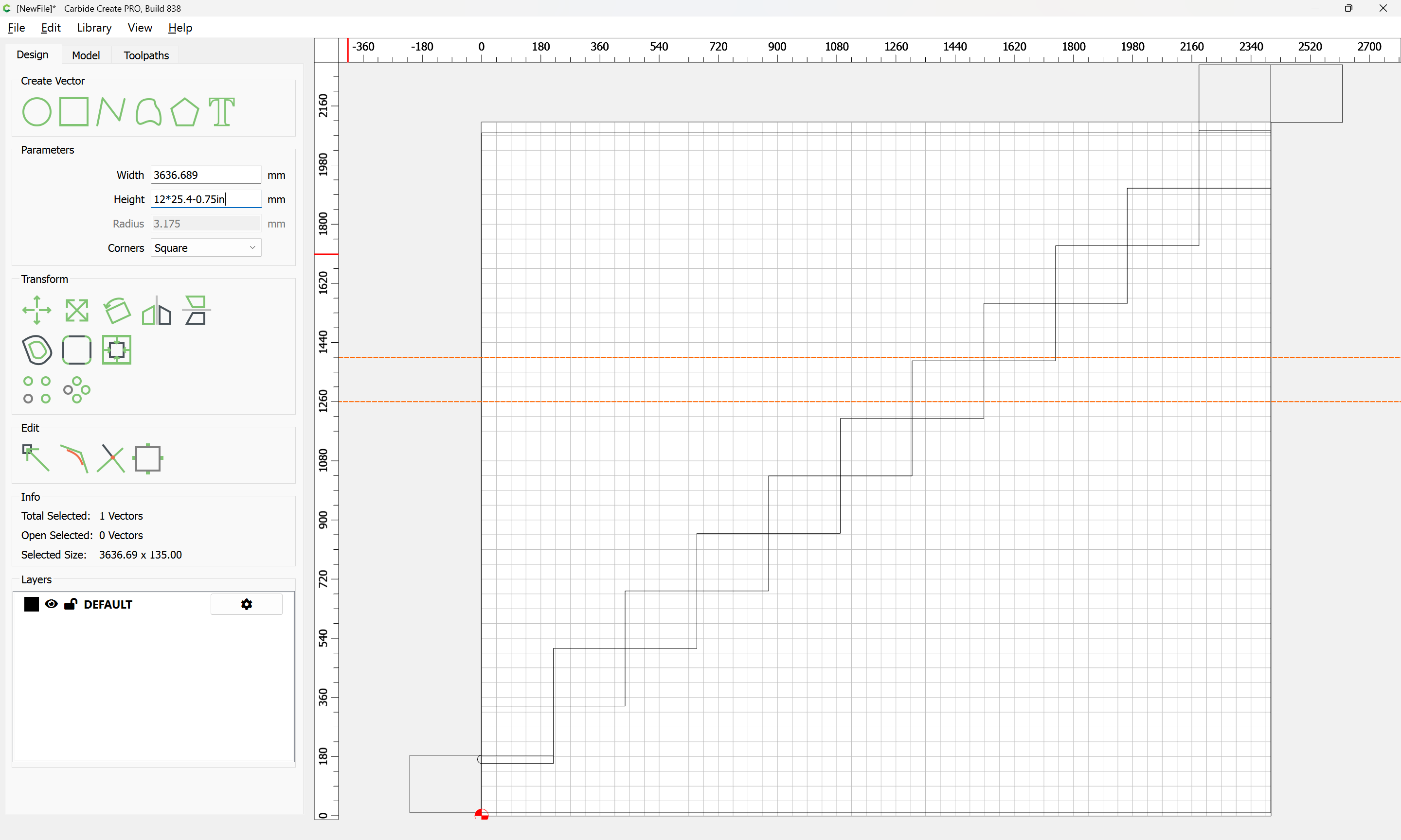

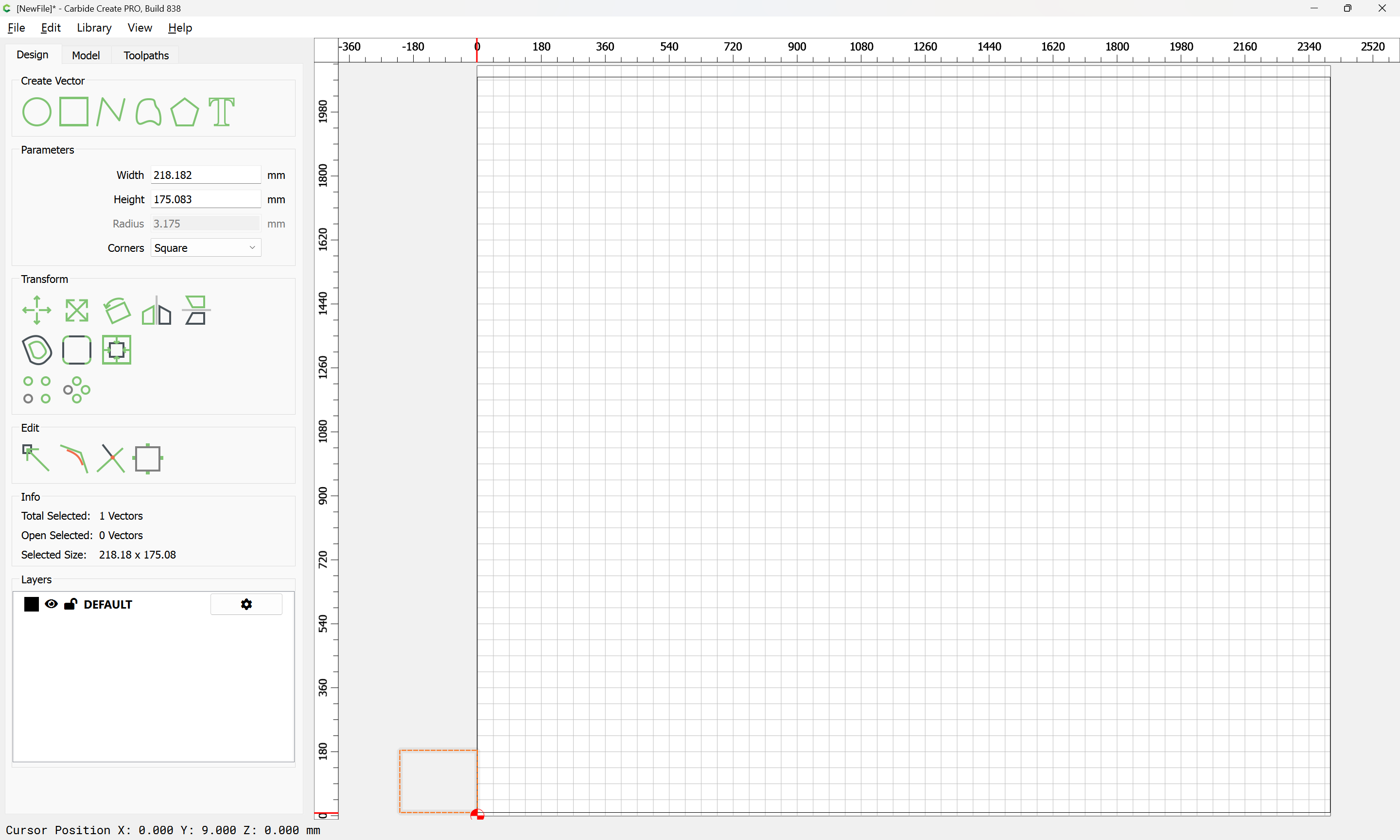

and duplicate it and divide its width dimensions by the number of steps:
and the height by the number of steps plus one:
Done

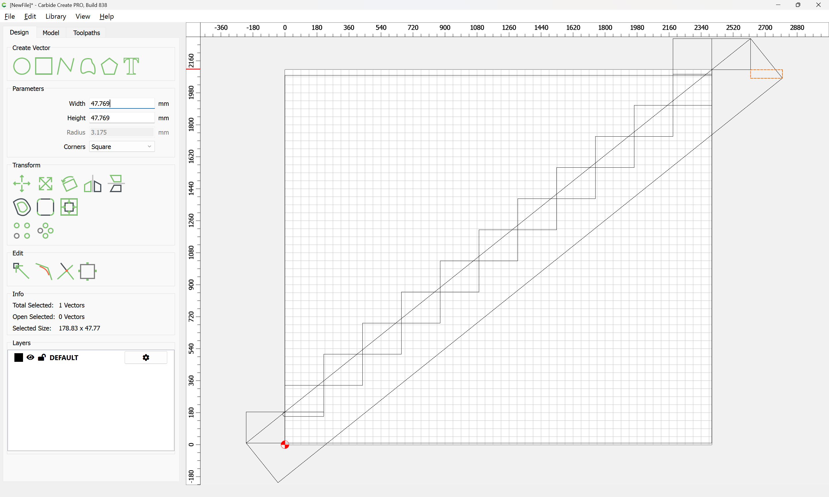

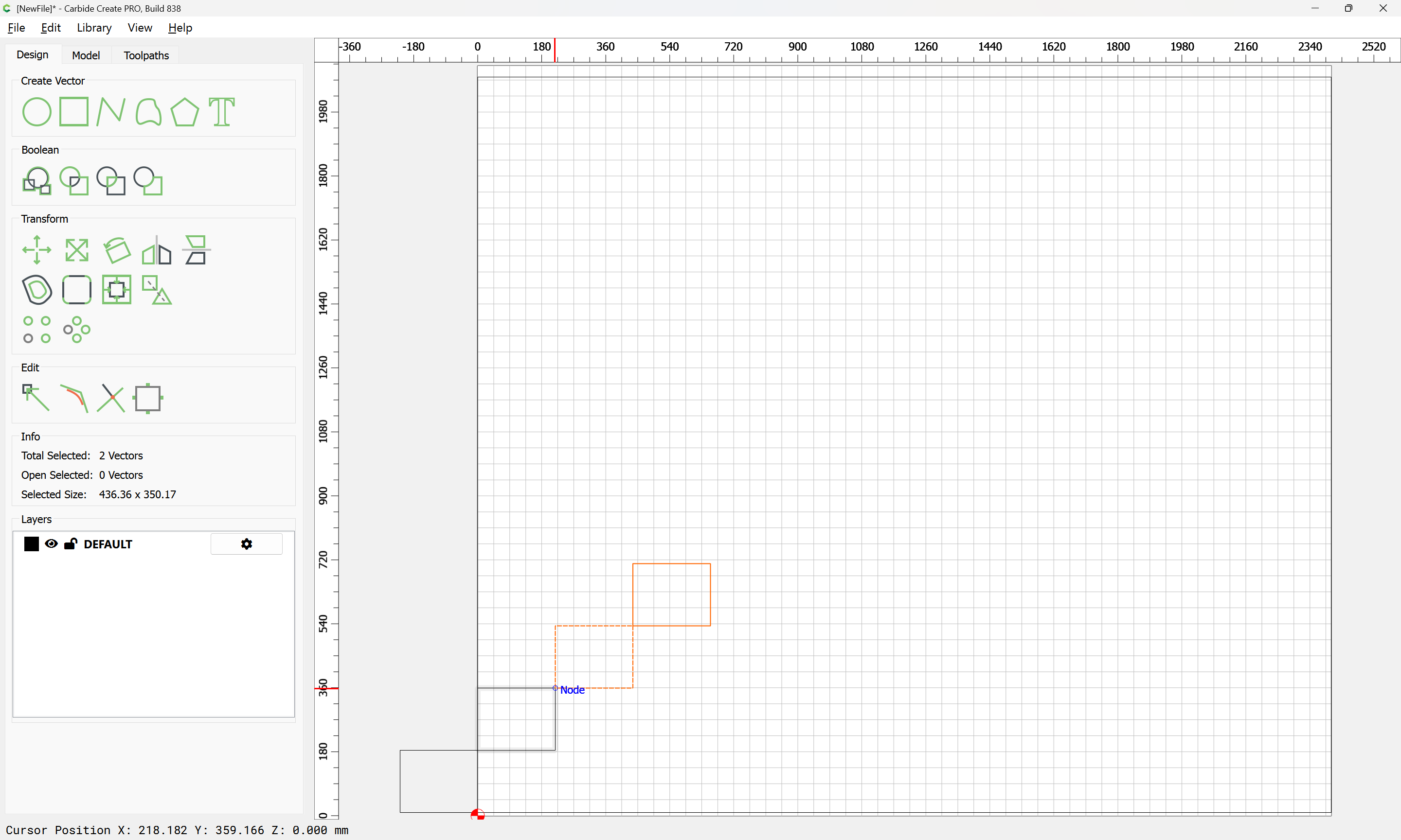

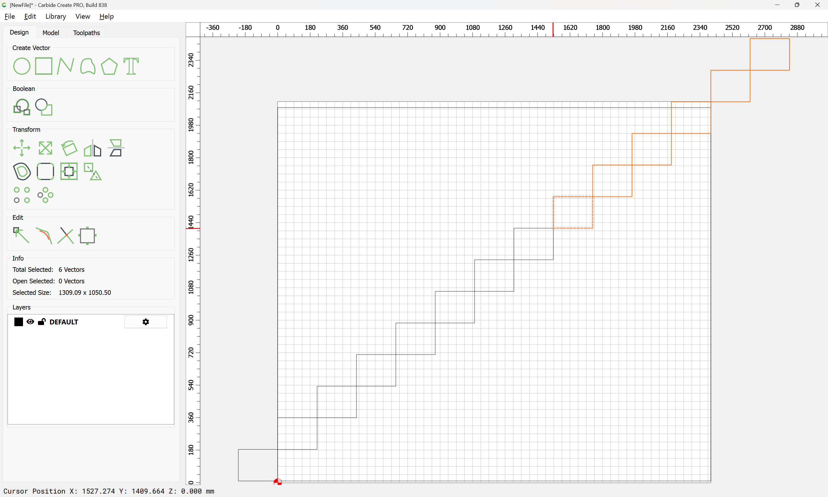

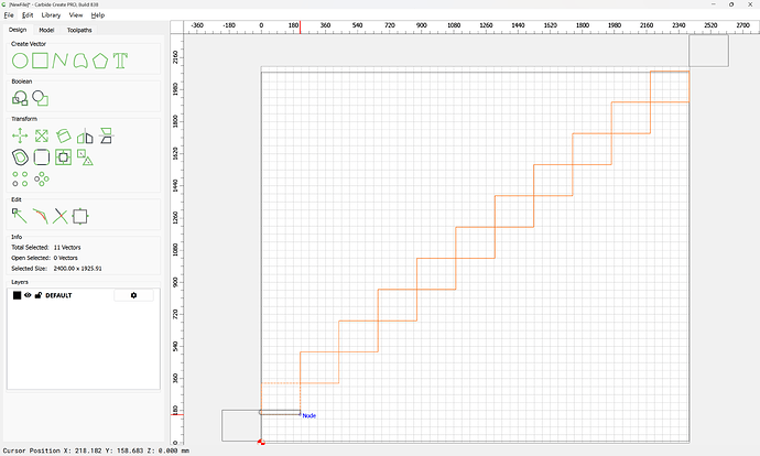

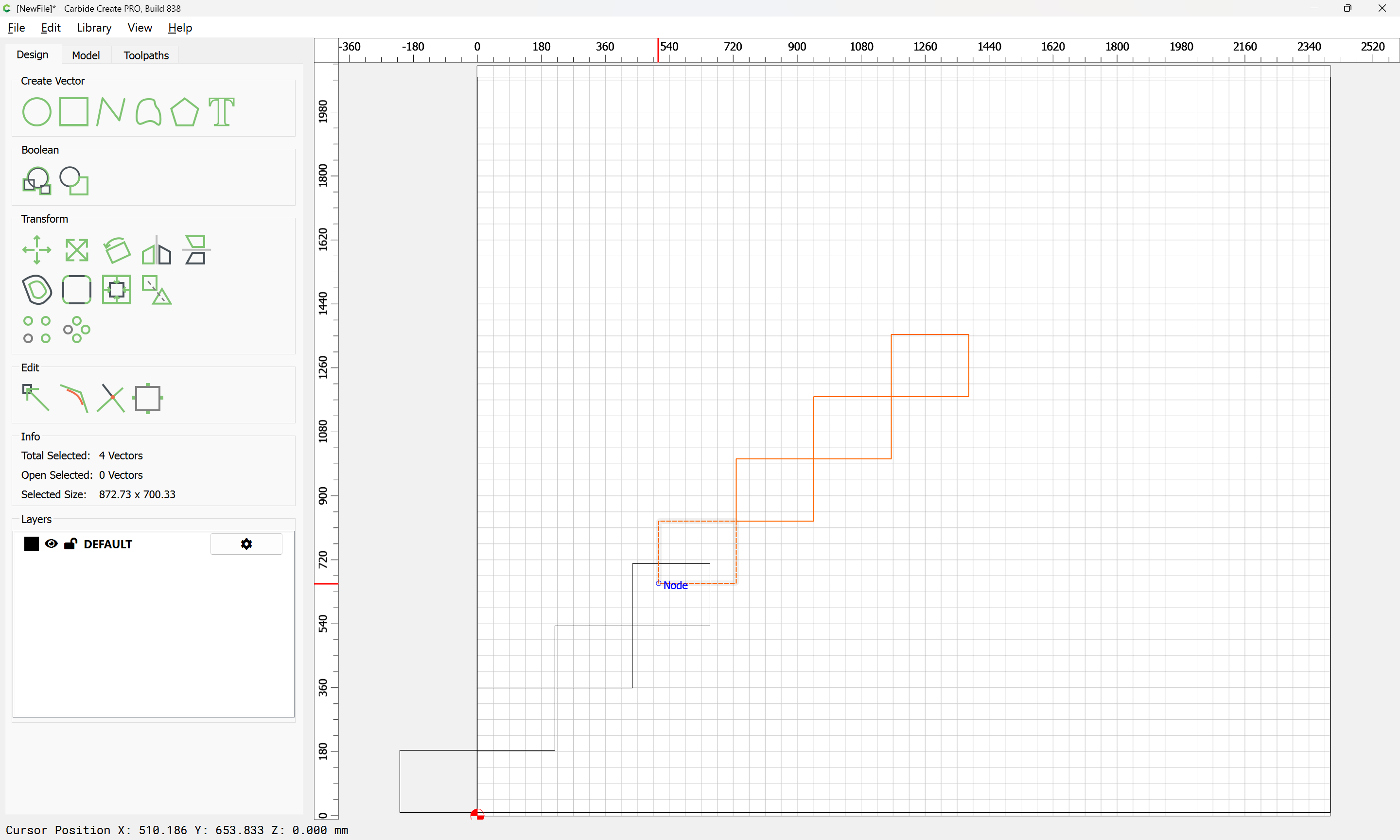

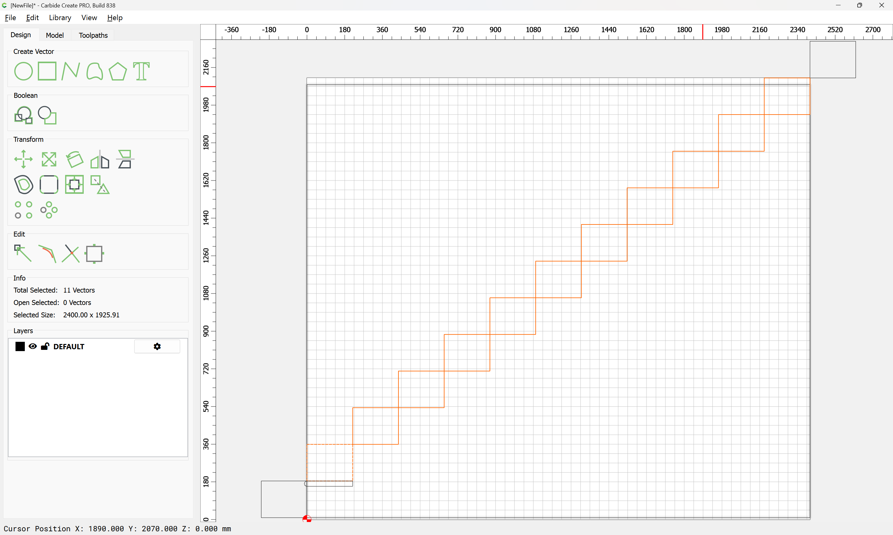

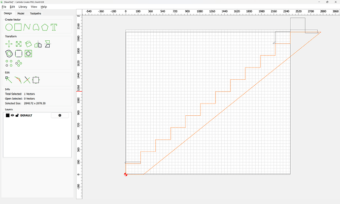

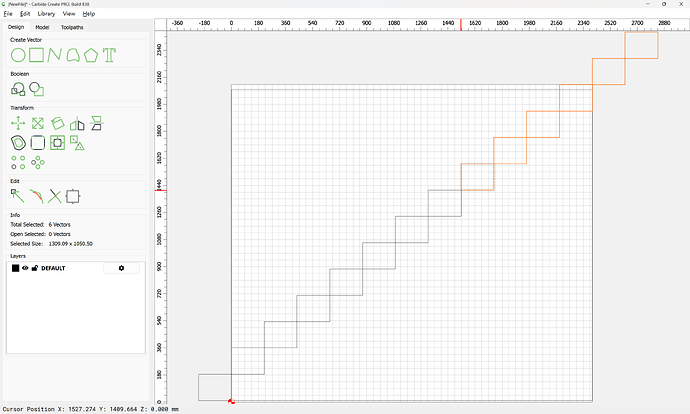

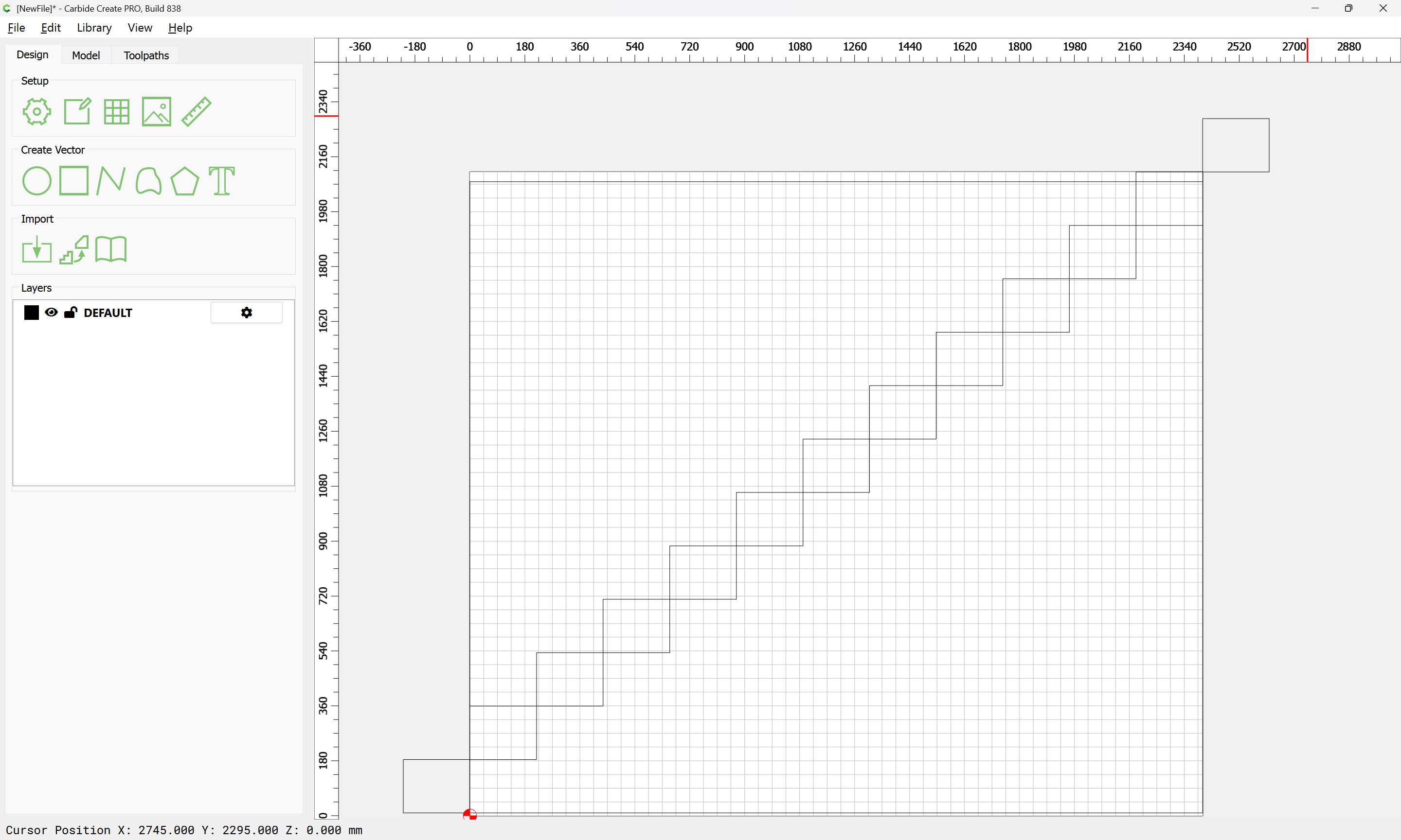

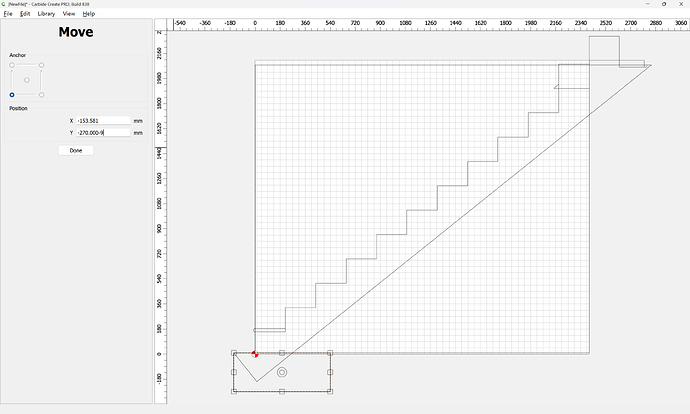

This may then be positioned at the height of the lower floor:
and duplicated in a diagonal:
(and an extra rectangle removed if need be)

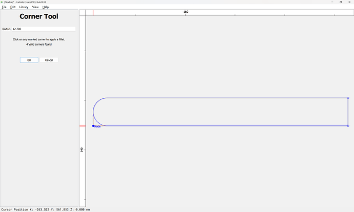

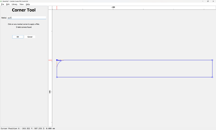

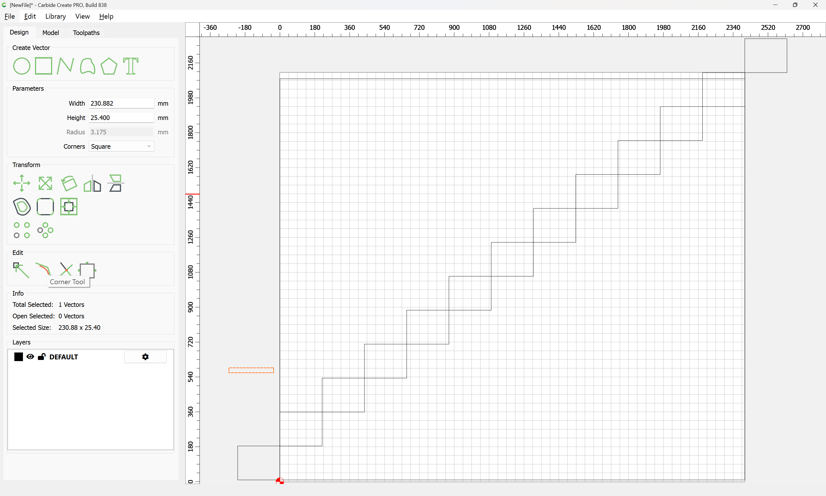

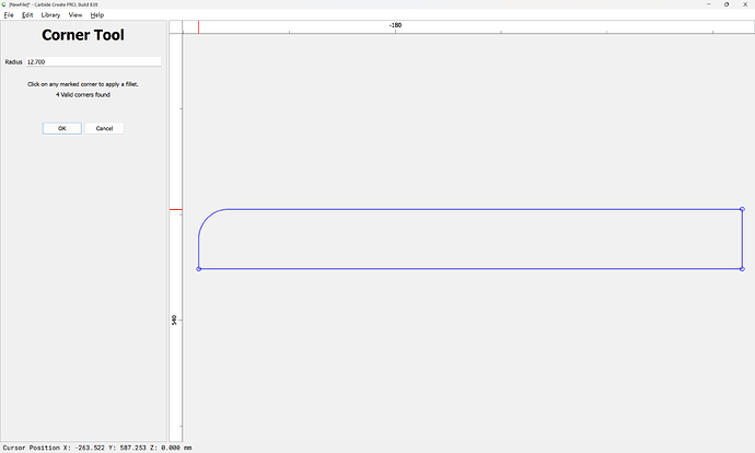

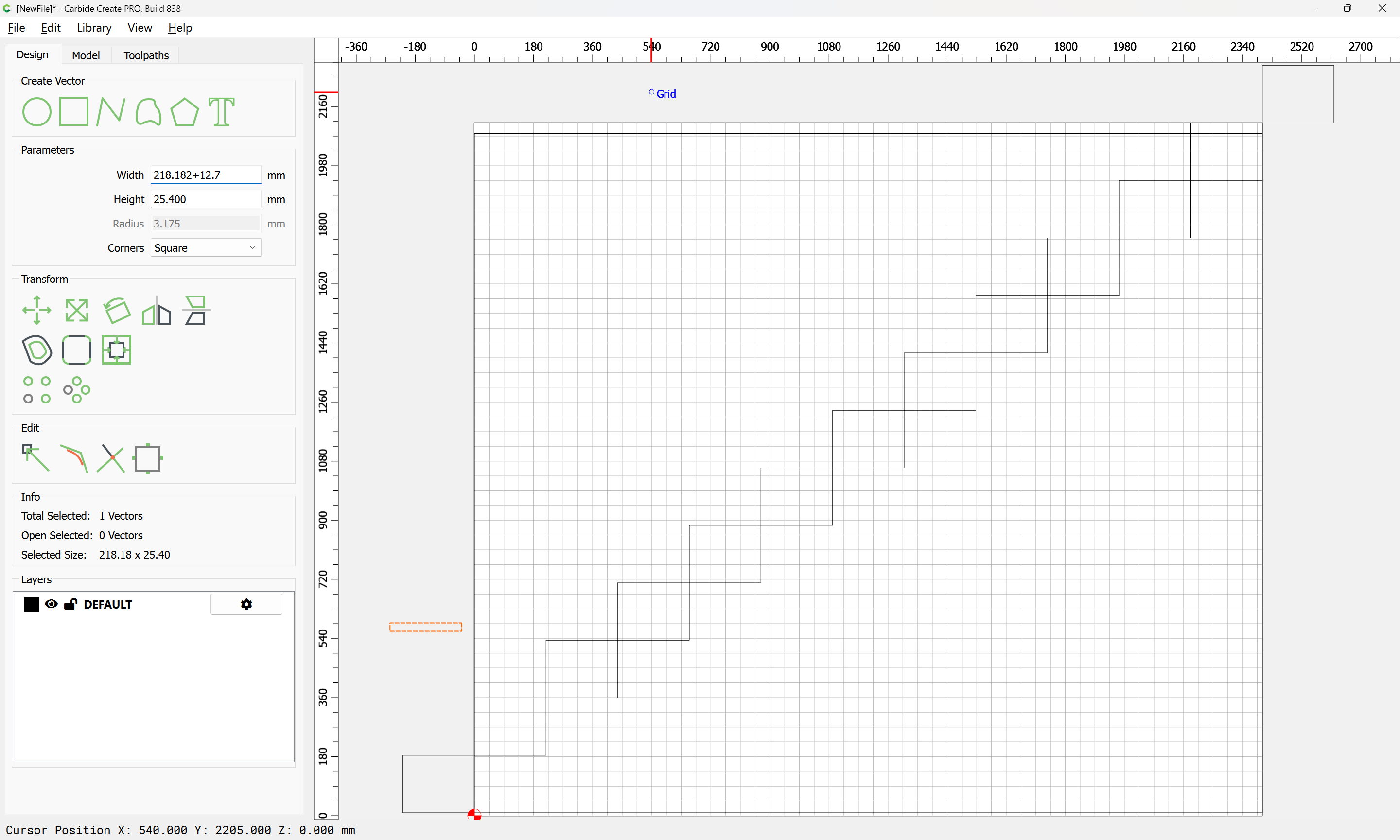

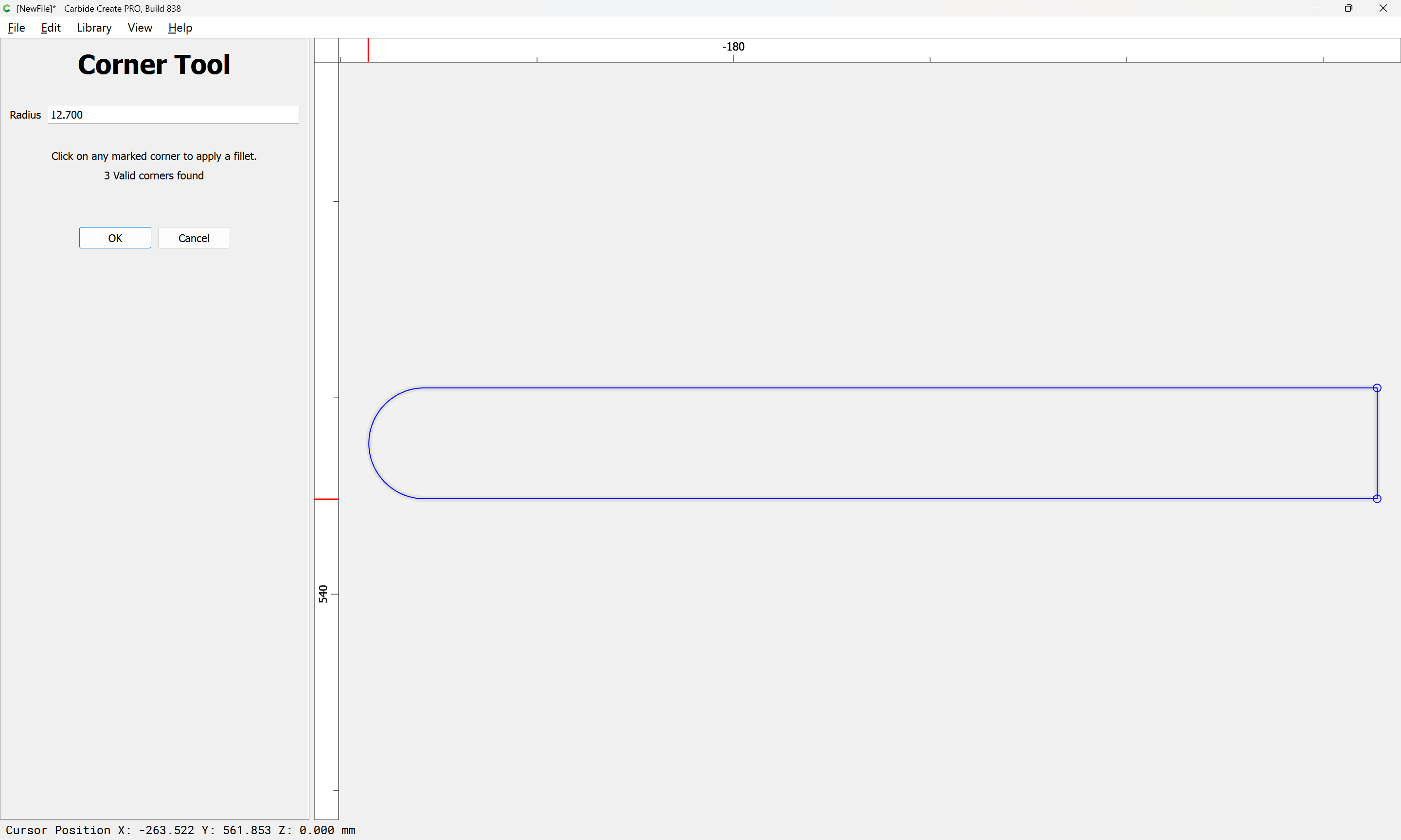

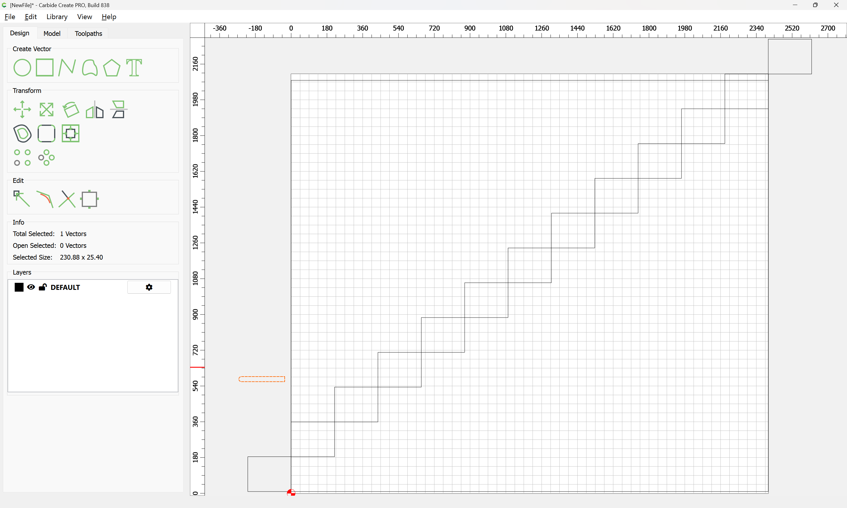

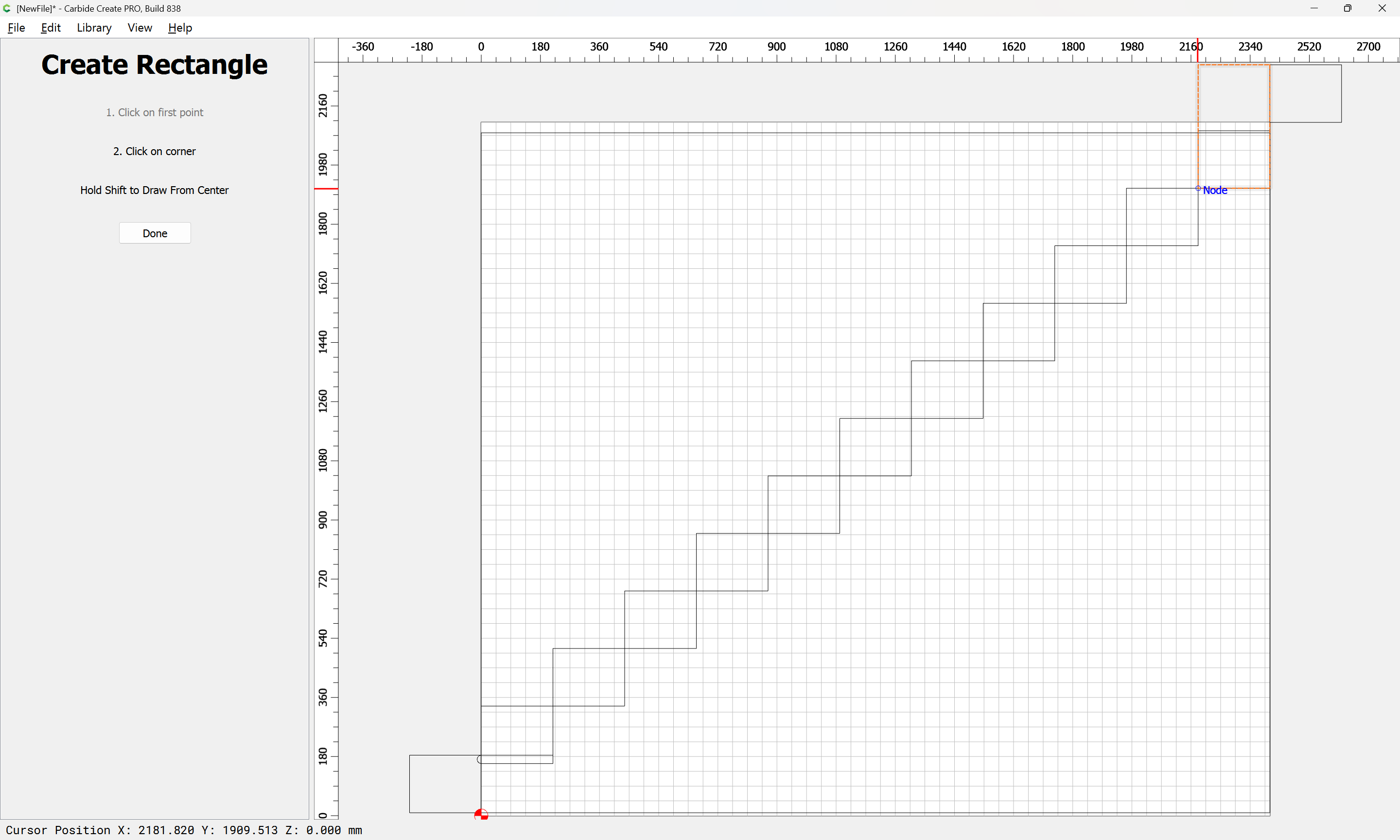

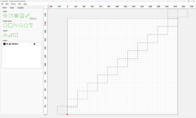

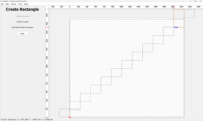

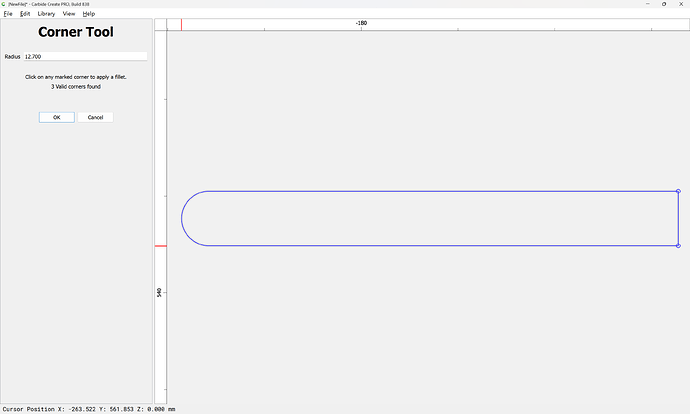

Next, draw in the stair treads w/ overhang:
and round to show the bull-nose:
OK

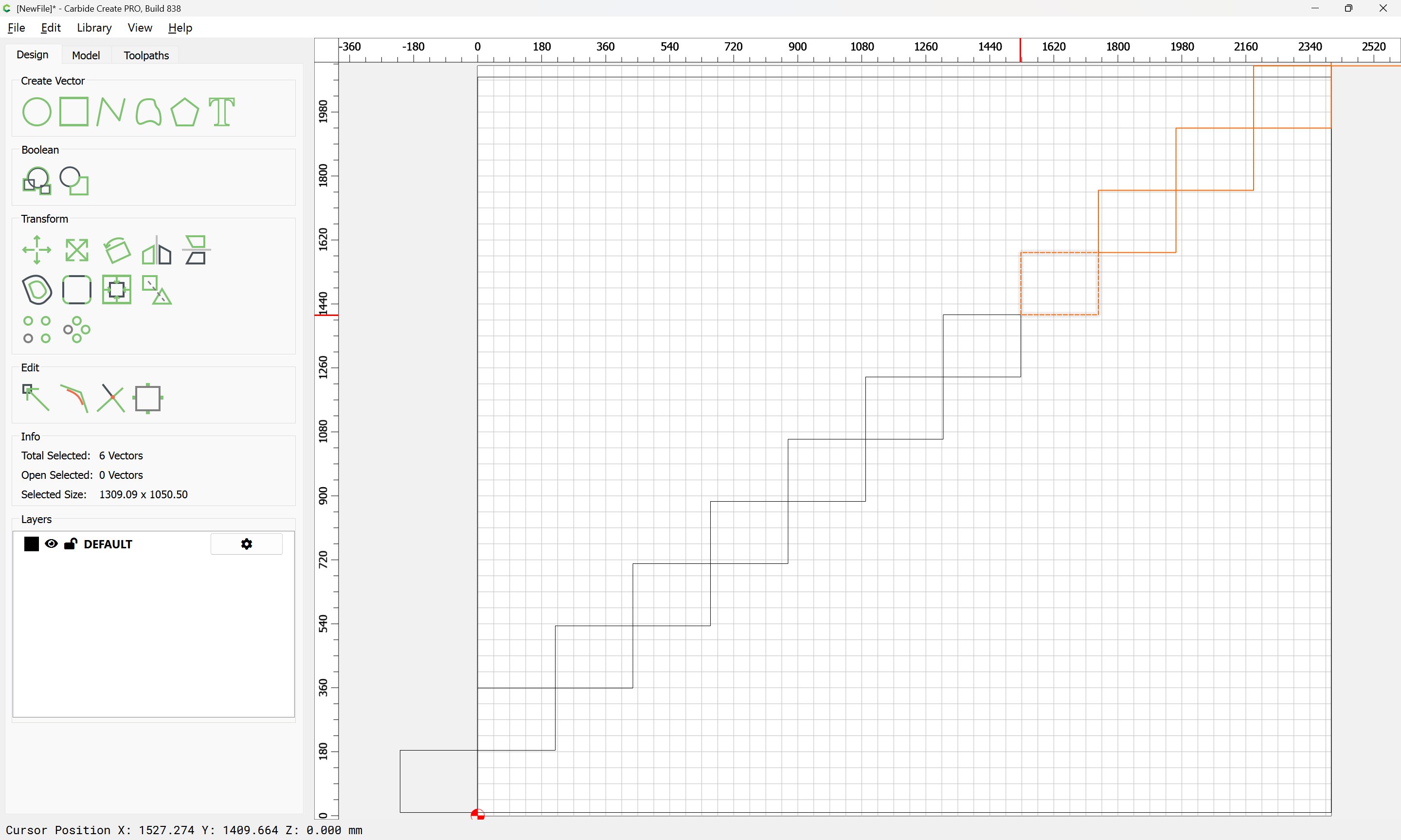

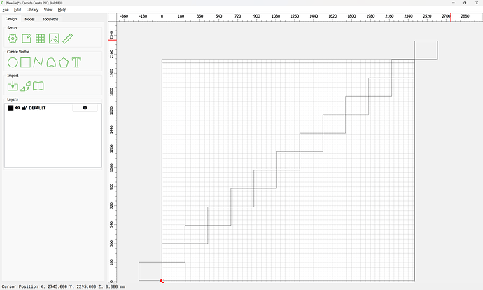

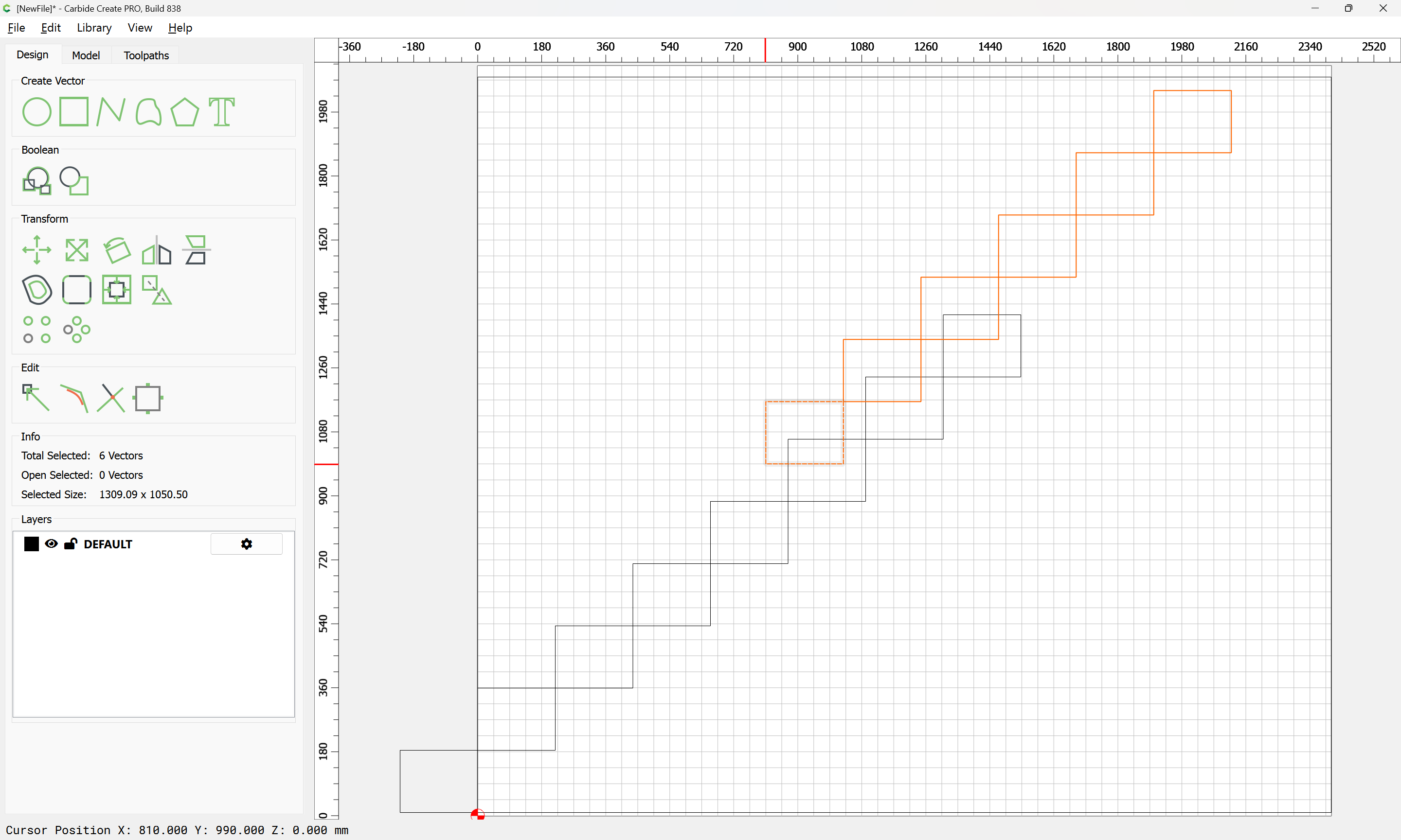

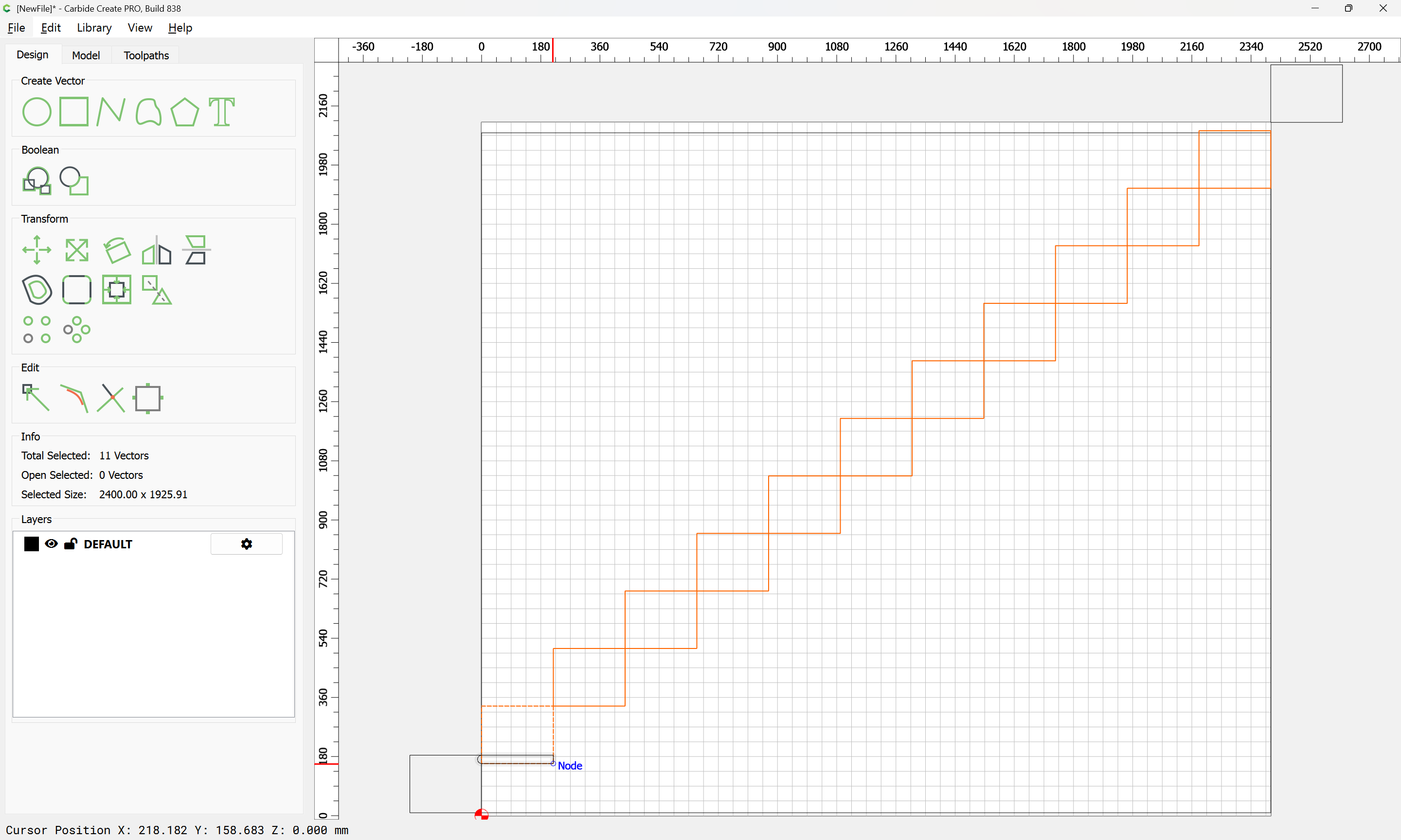

Drag into alignment at the first stair step:
Then select all the rectangles which represent steps:
and drag down by the height of the tread:
Draw in a replacement at the top:

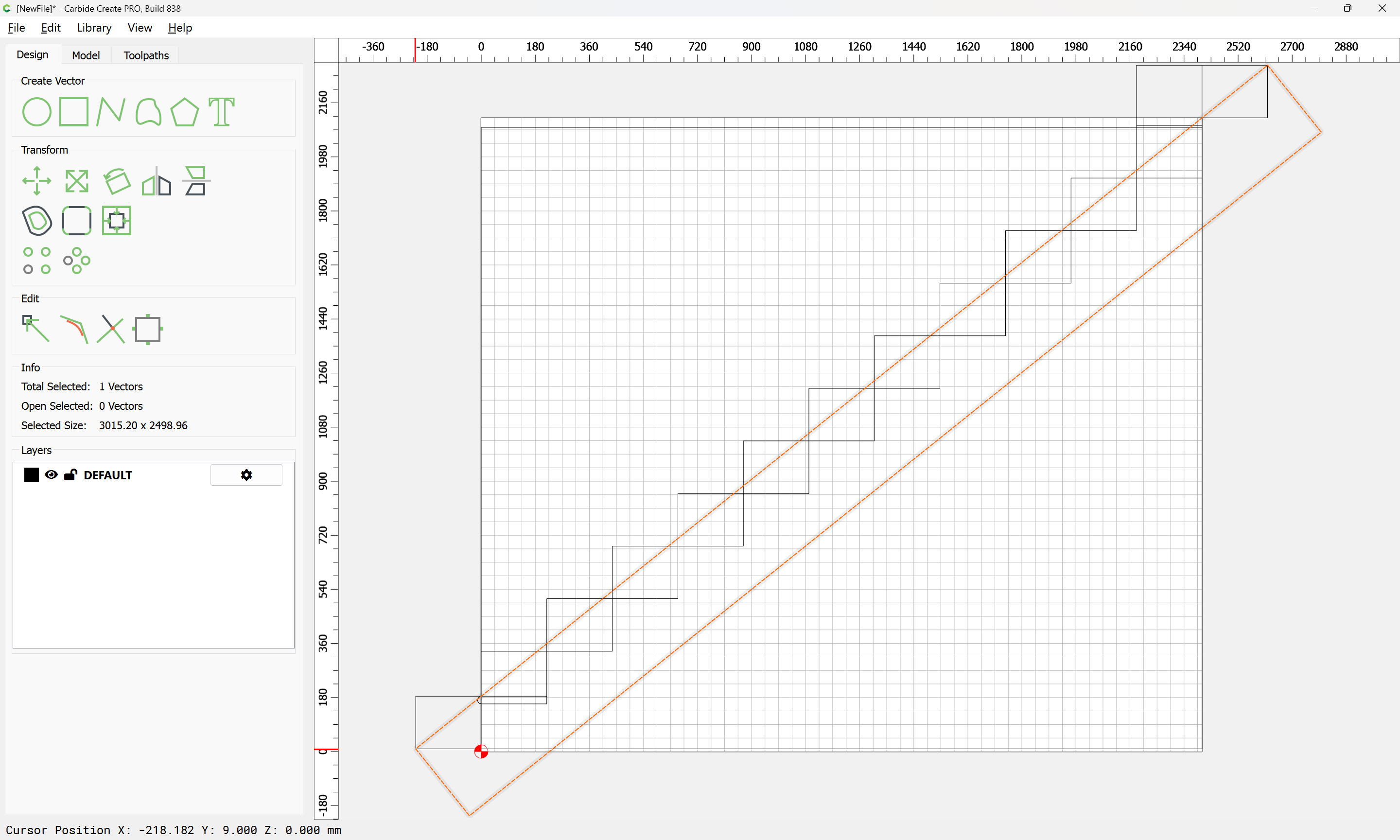

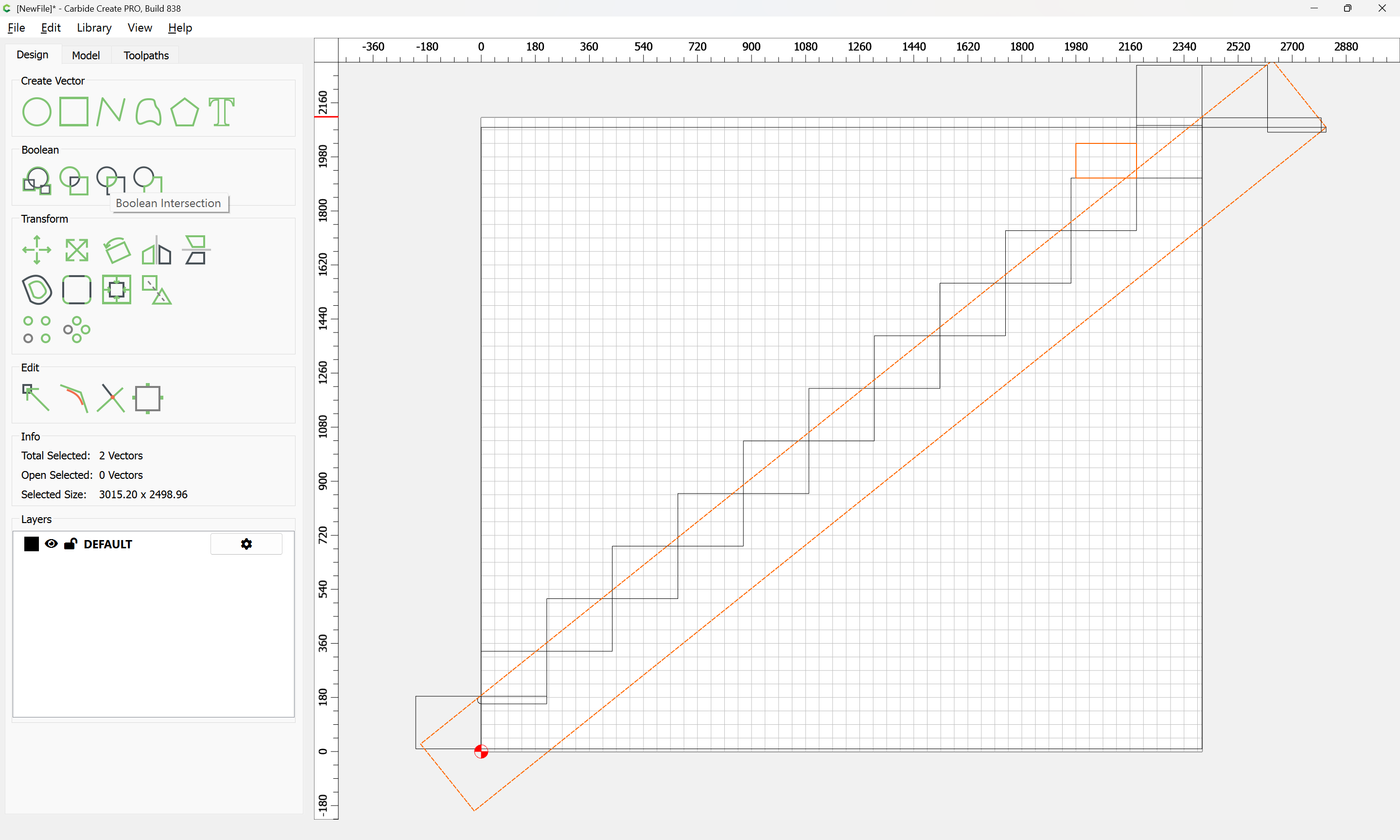

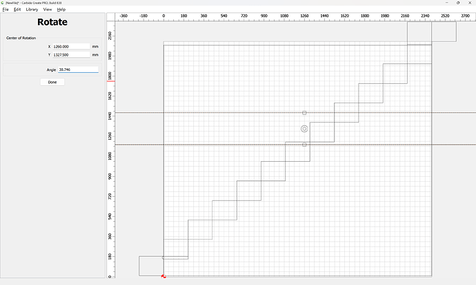

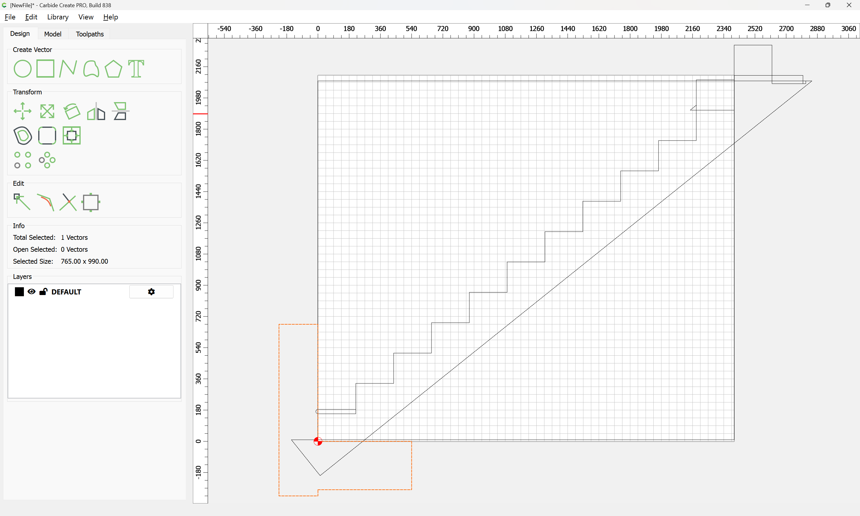

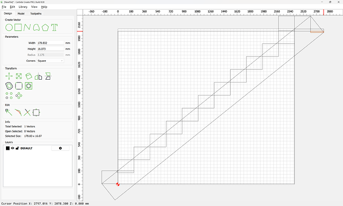

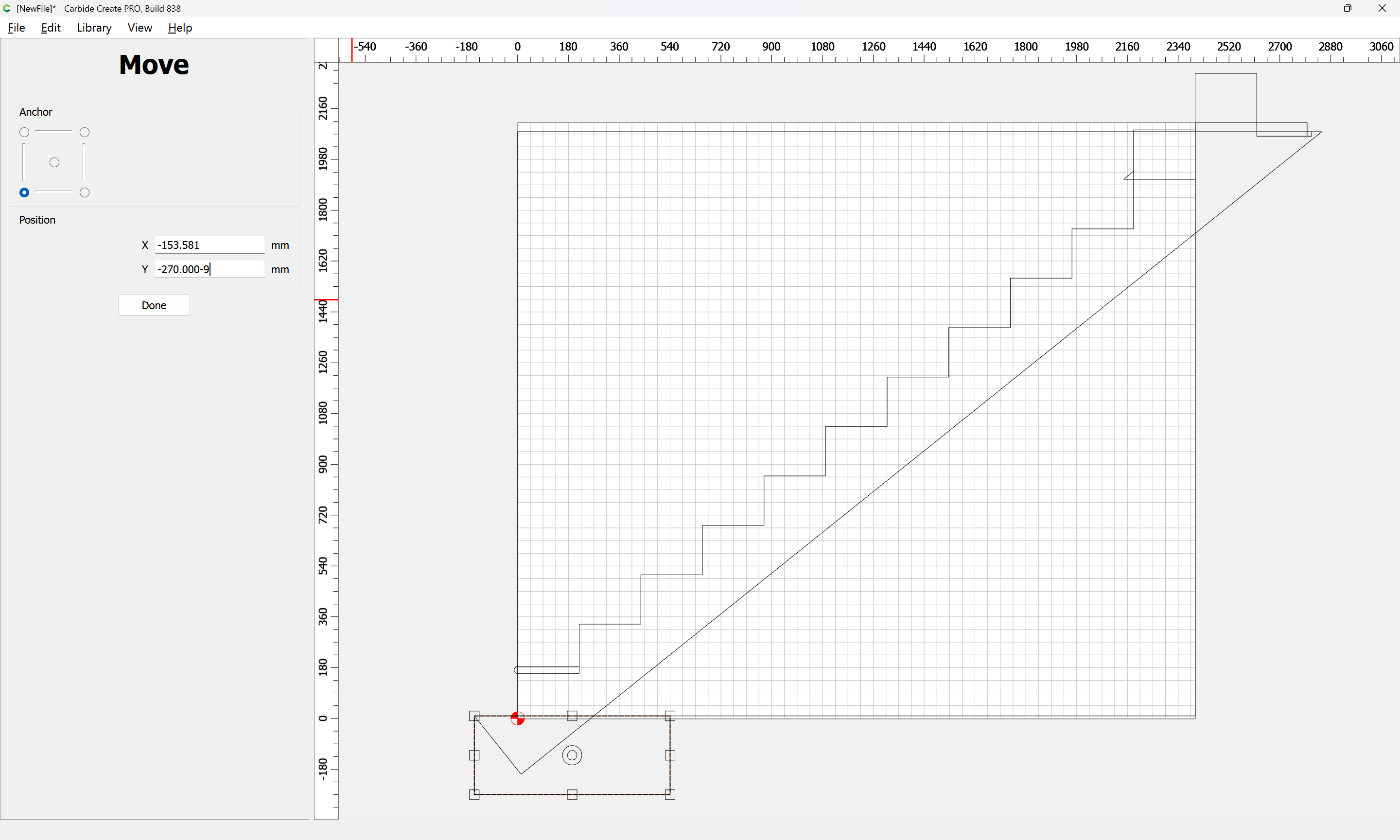

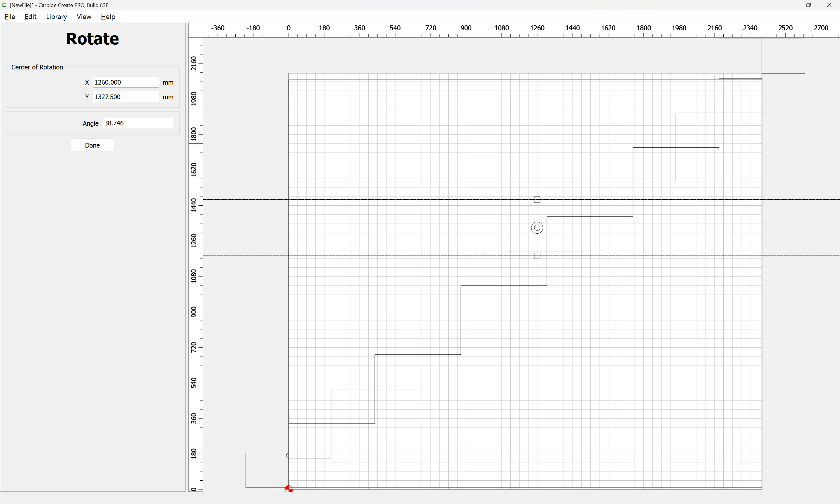

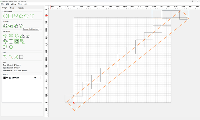

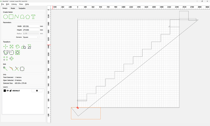

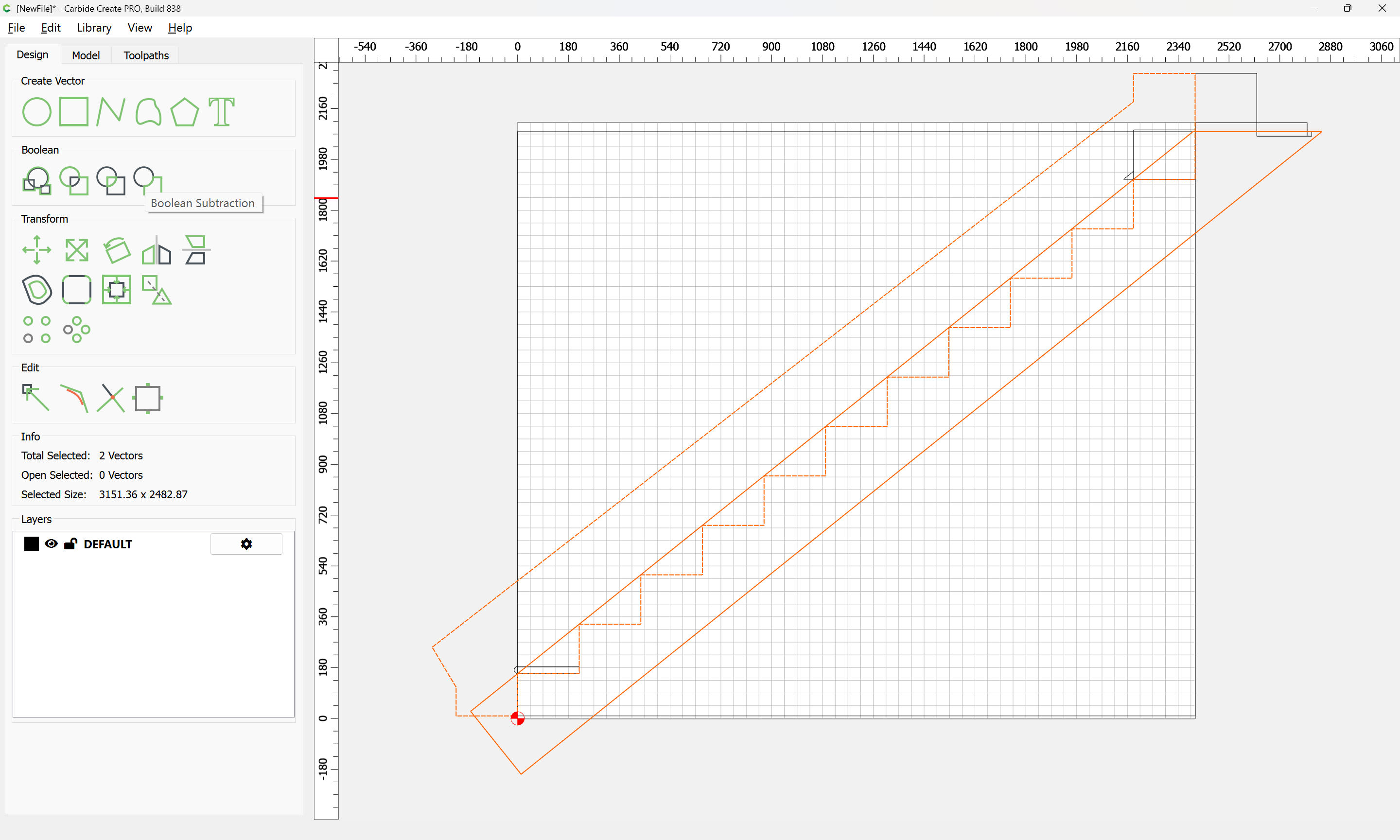

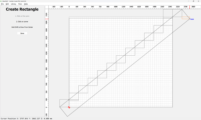

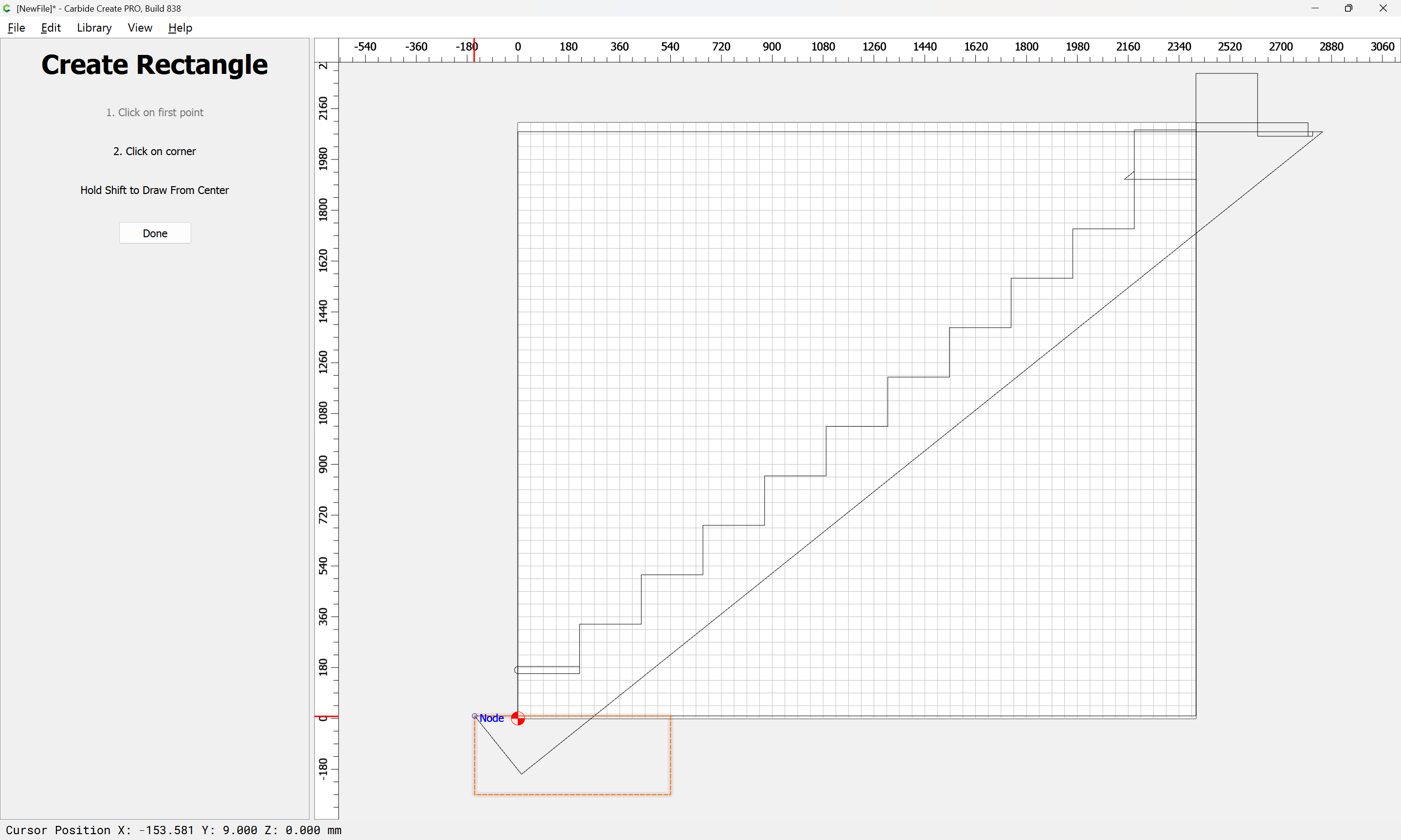

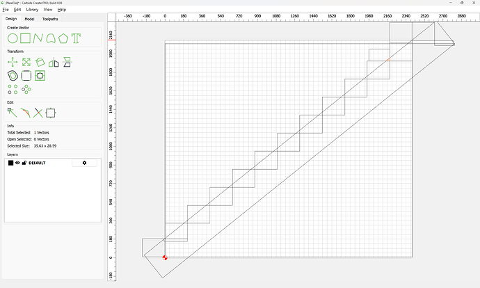

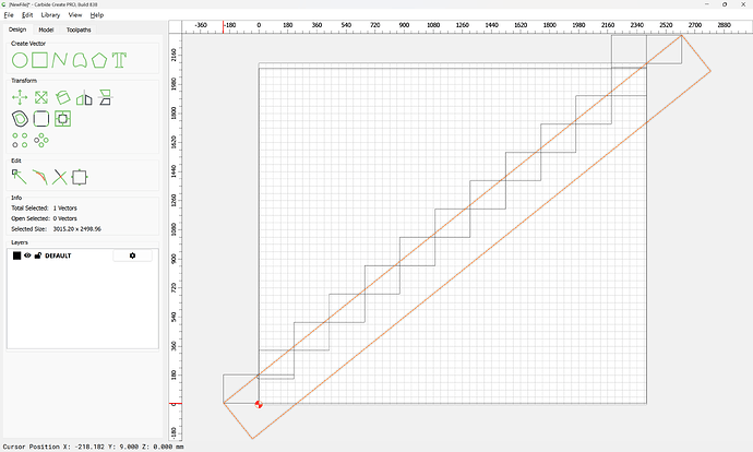

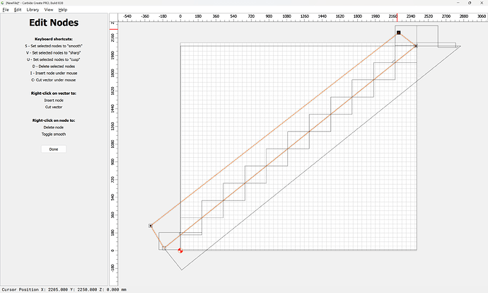

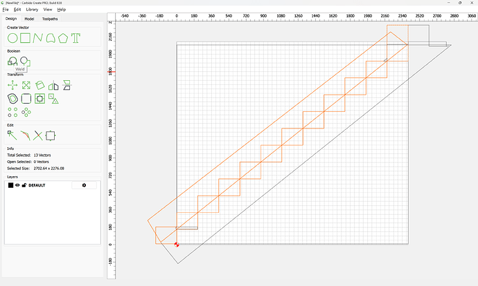

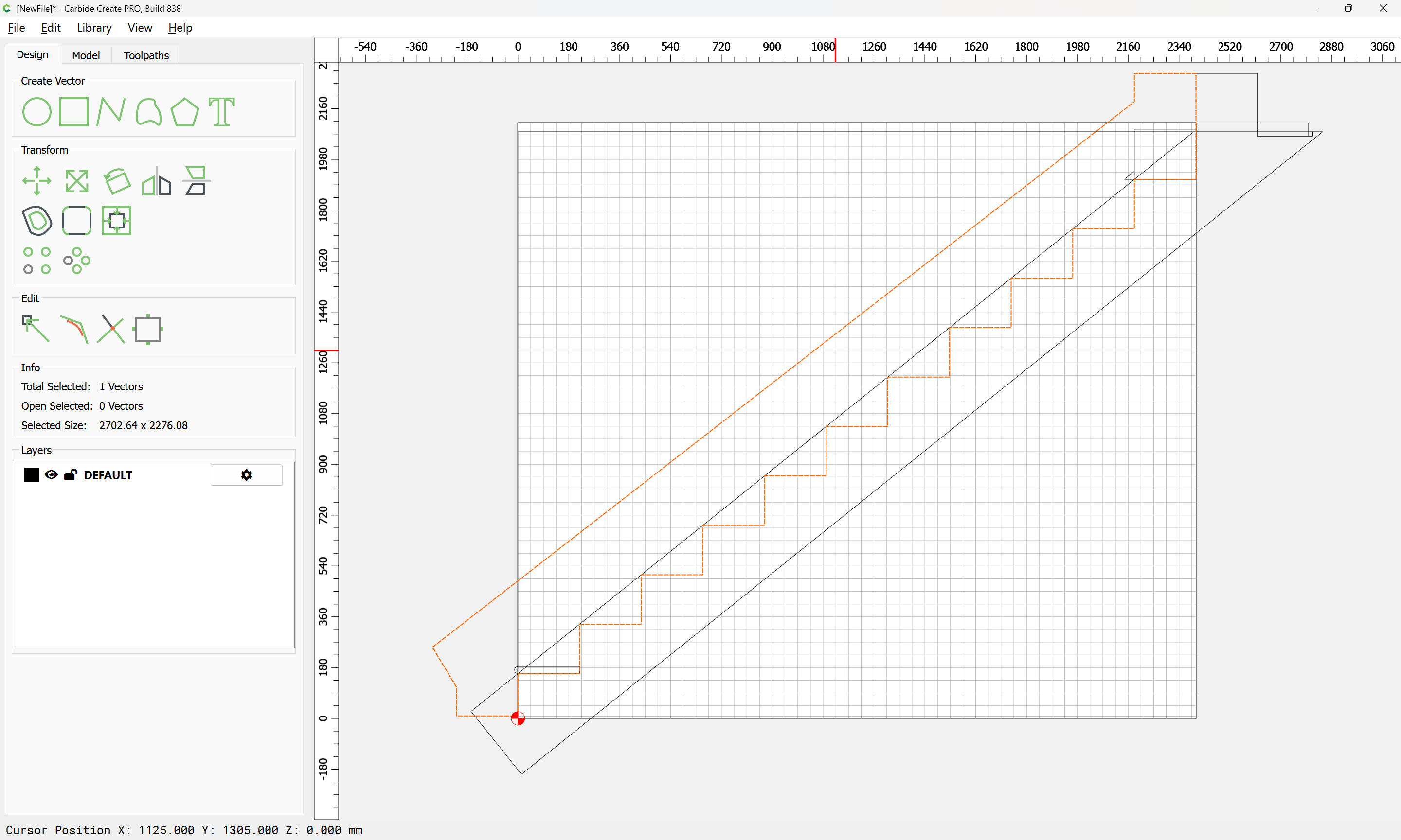

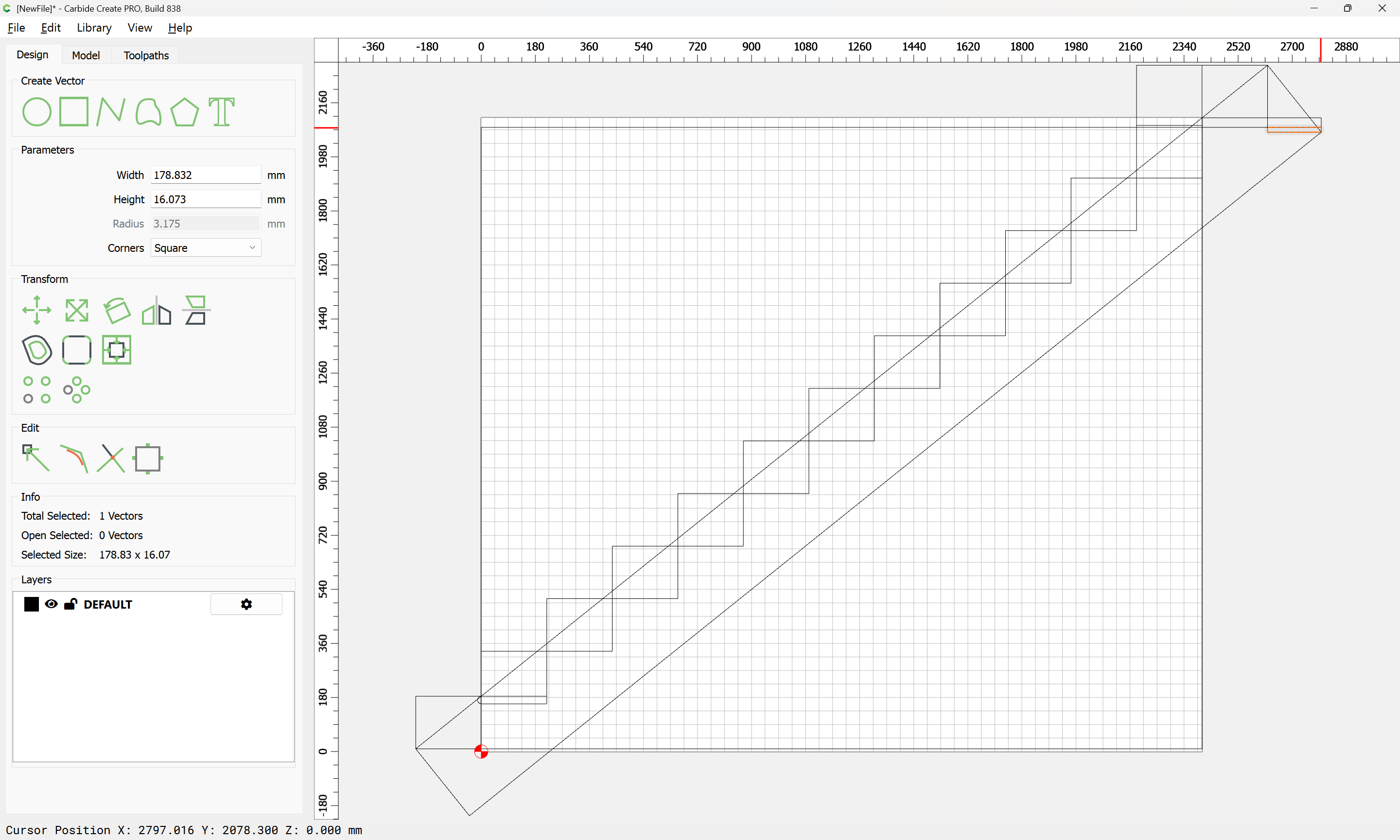

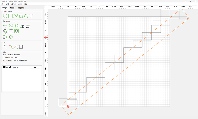

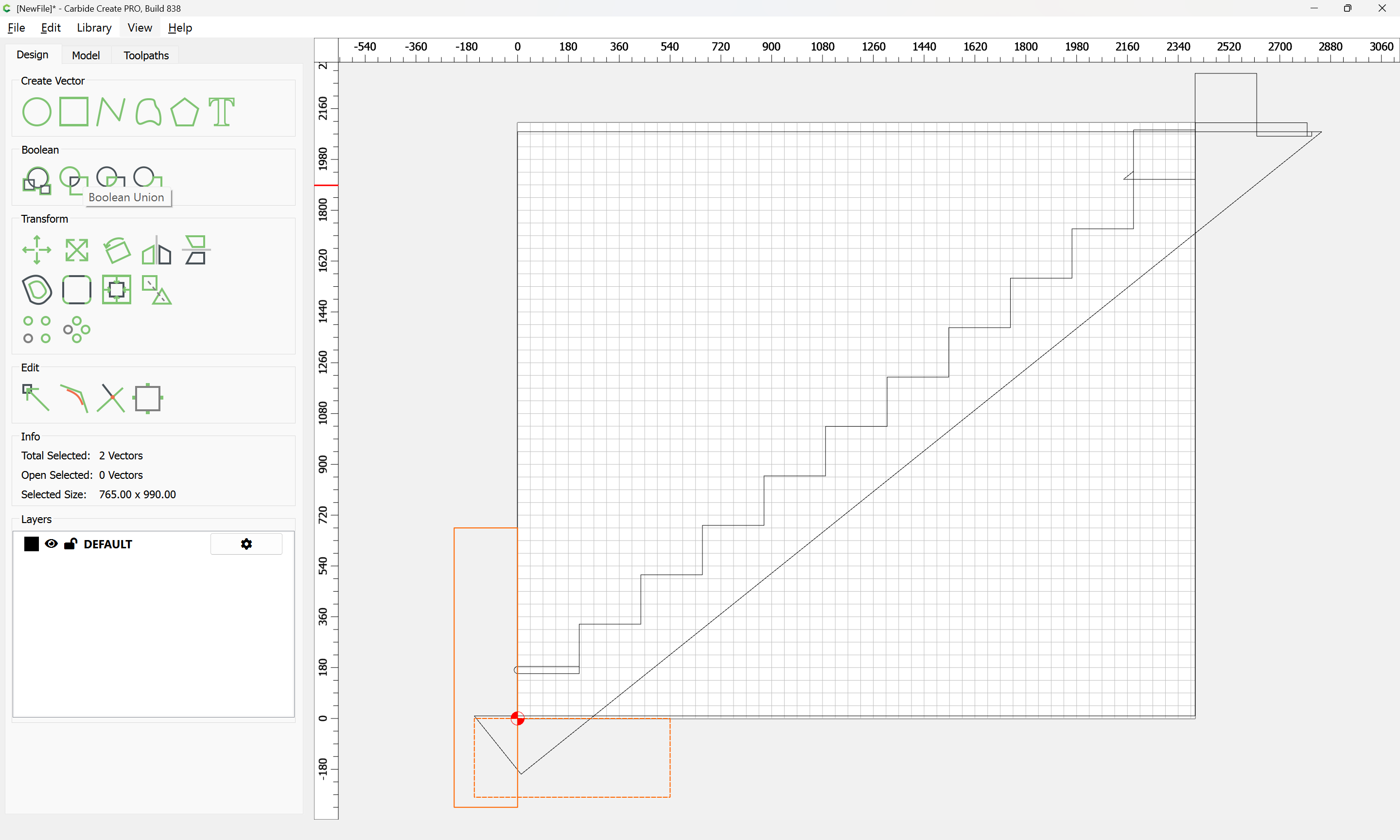

It should now be possible to measure the 2x12 needed:

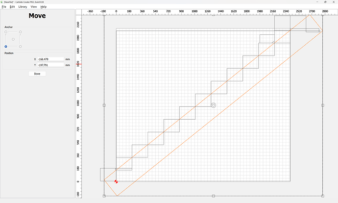

Draw it up:
then rotate it:
Done

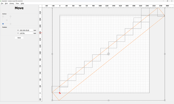

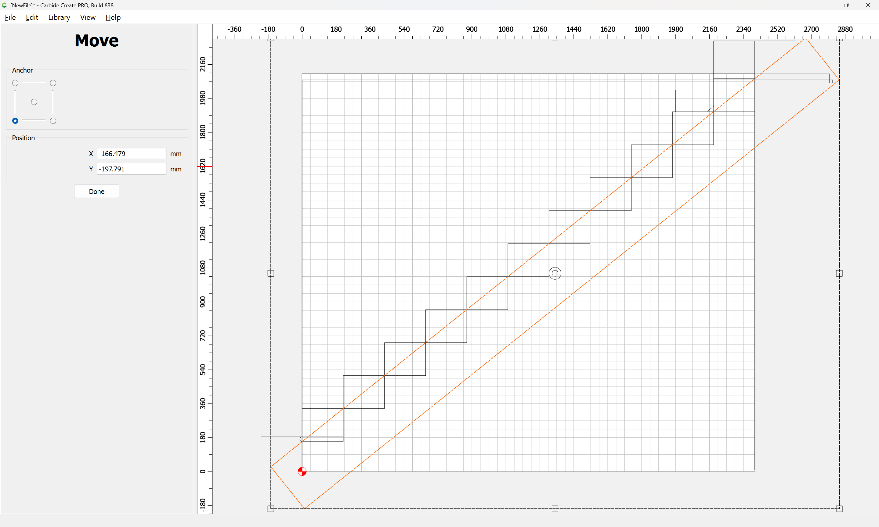

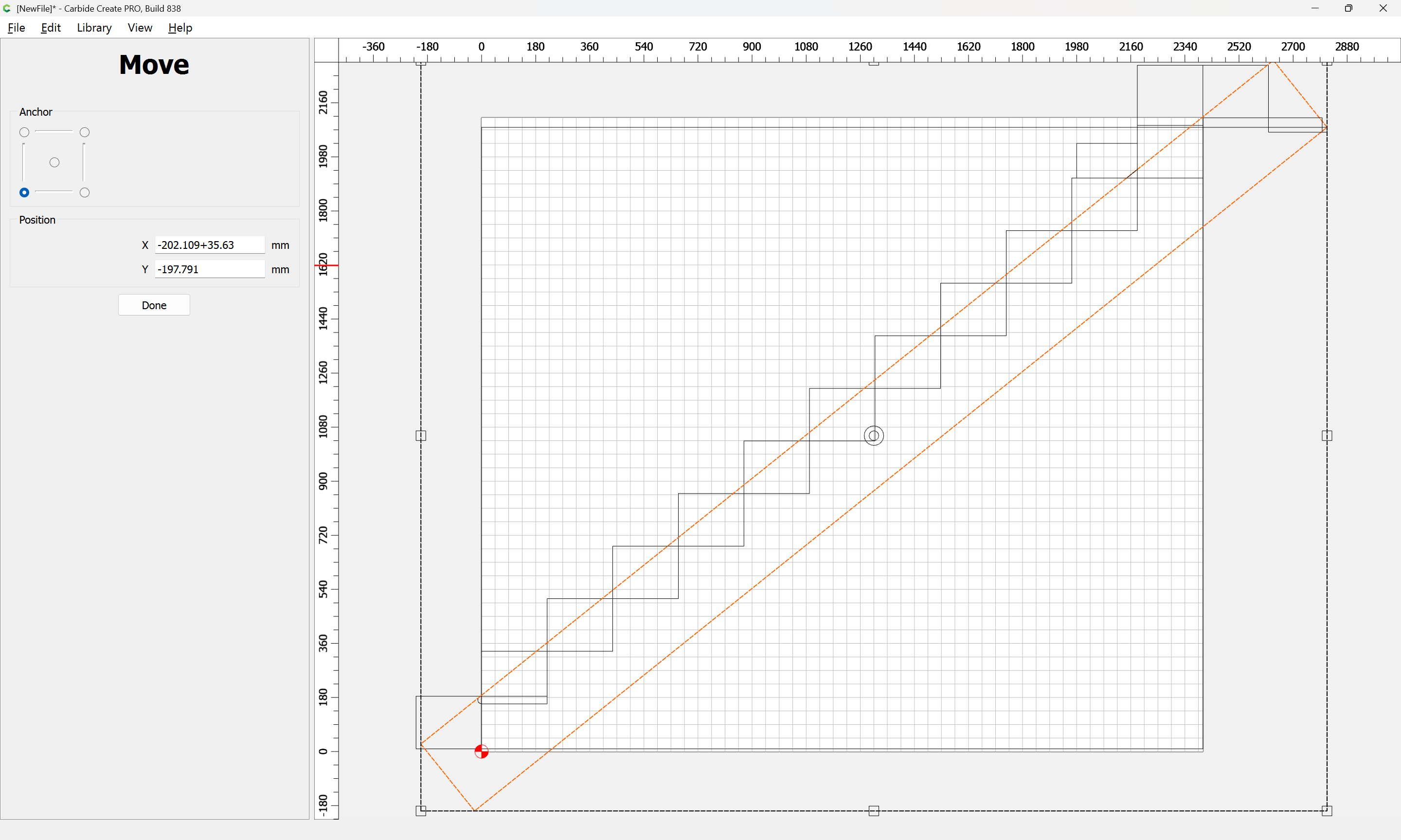

and drag into position:

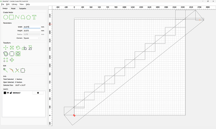

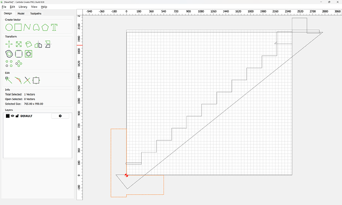

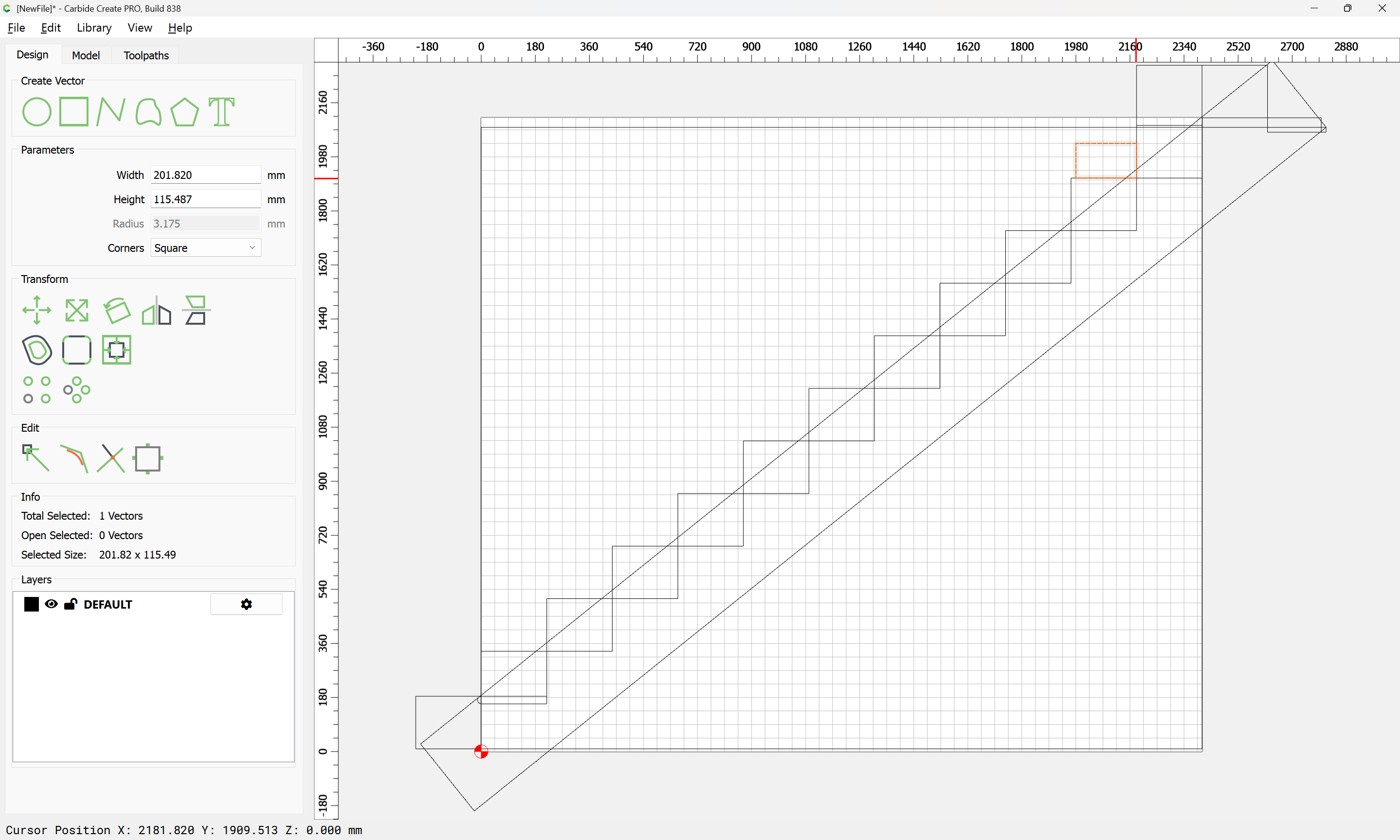

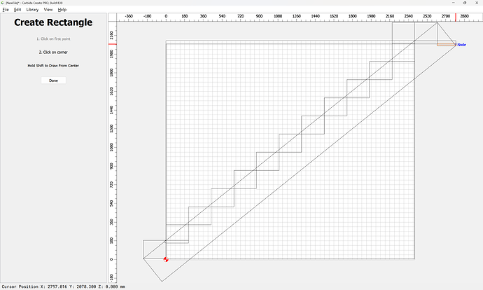

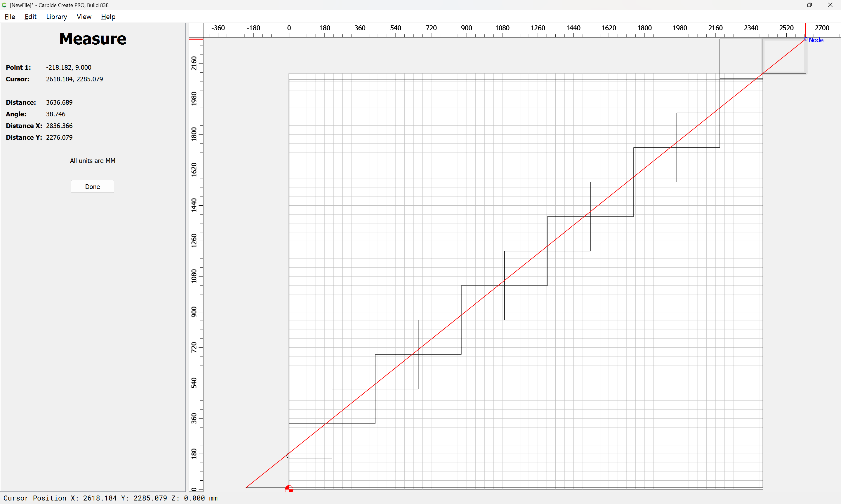

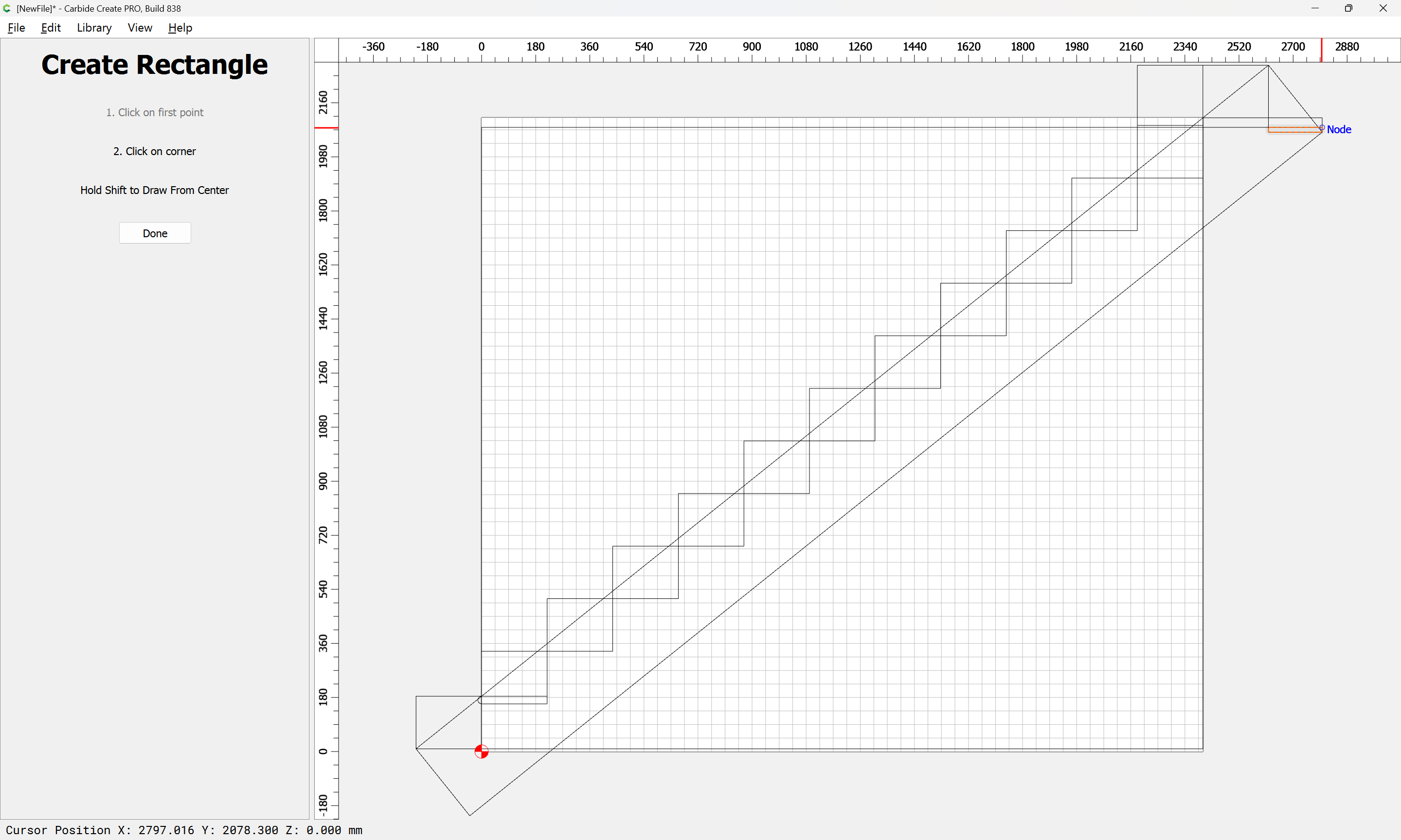

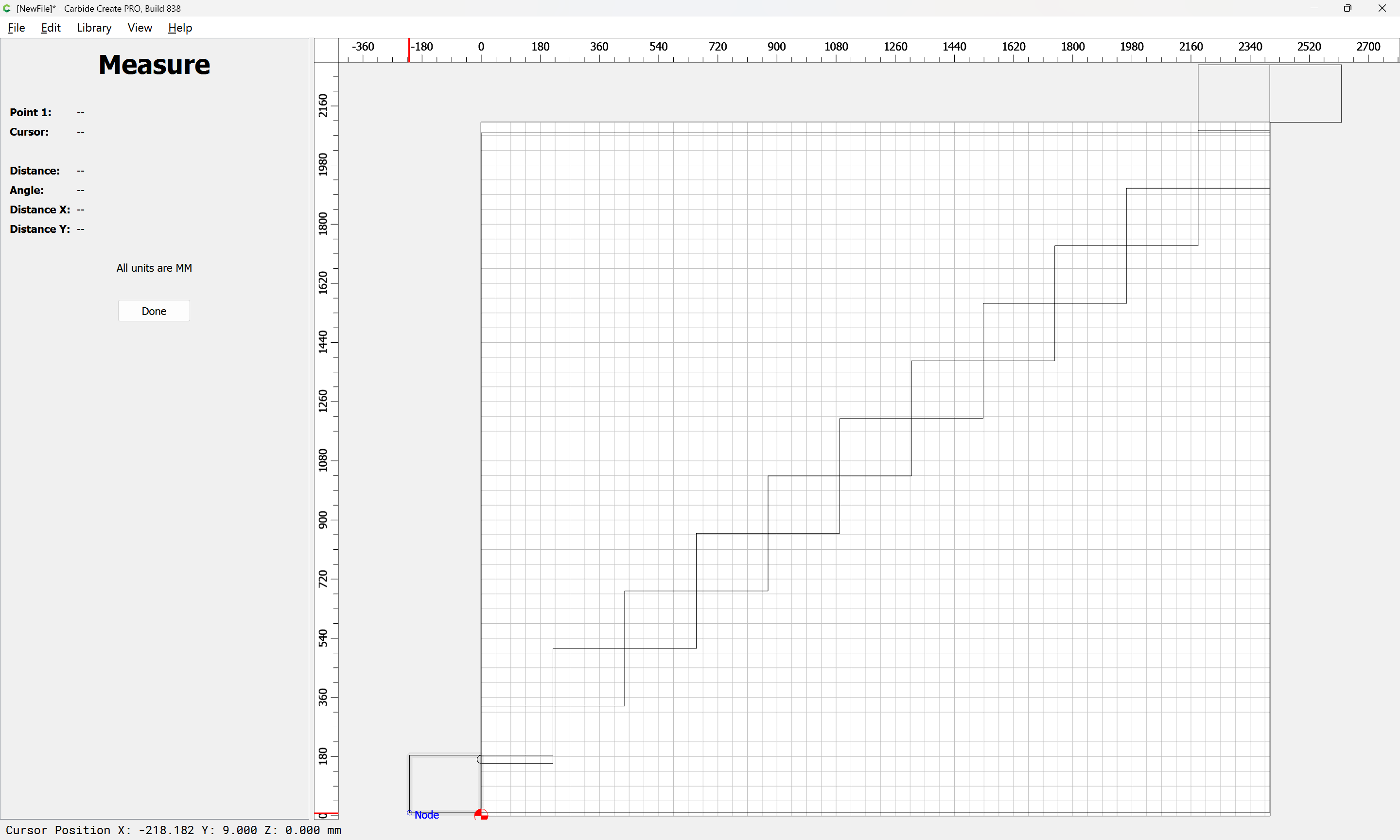

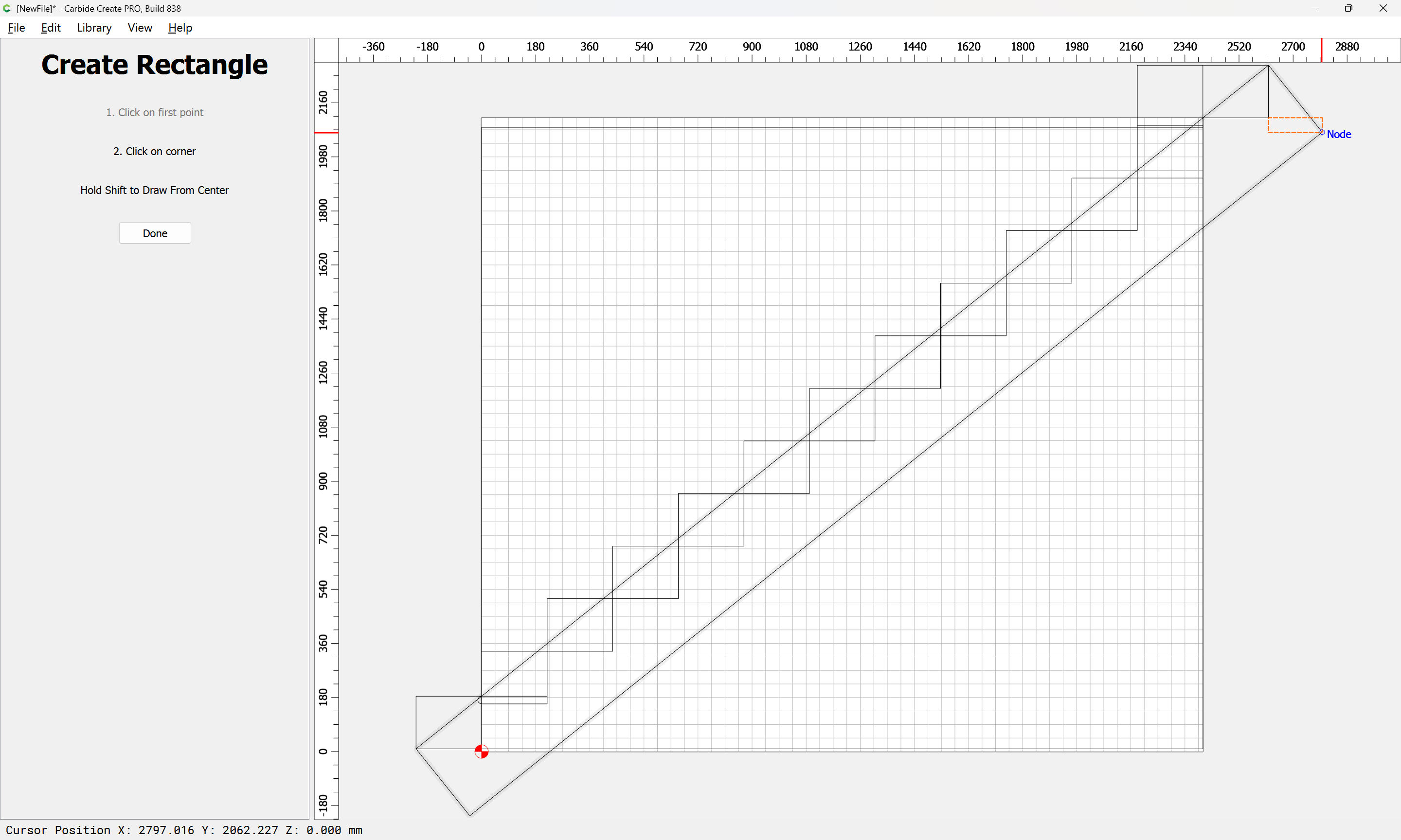

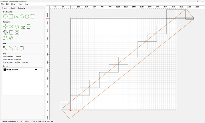

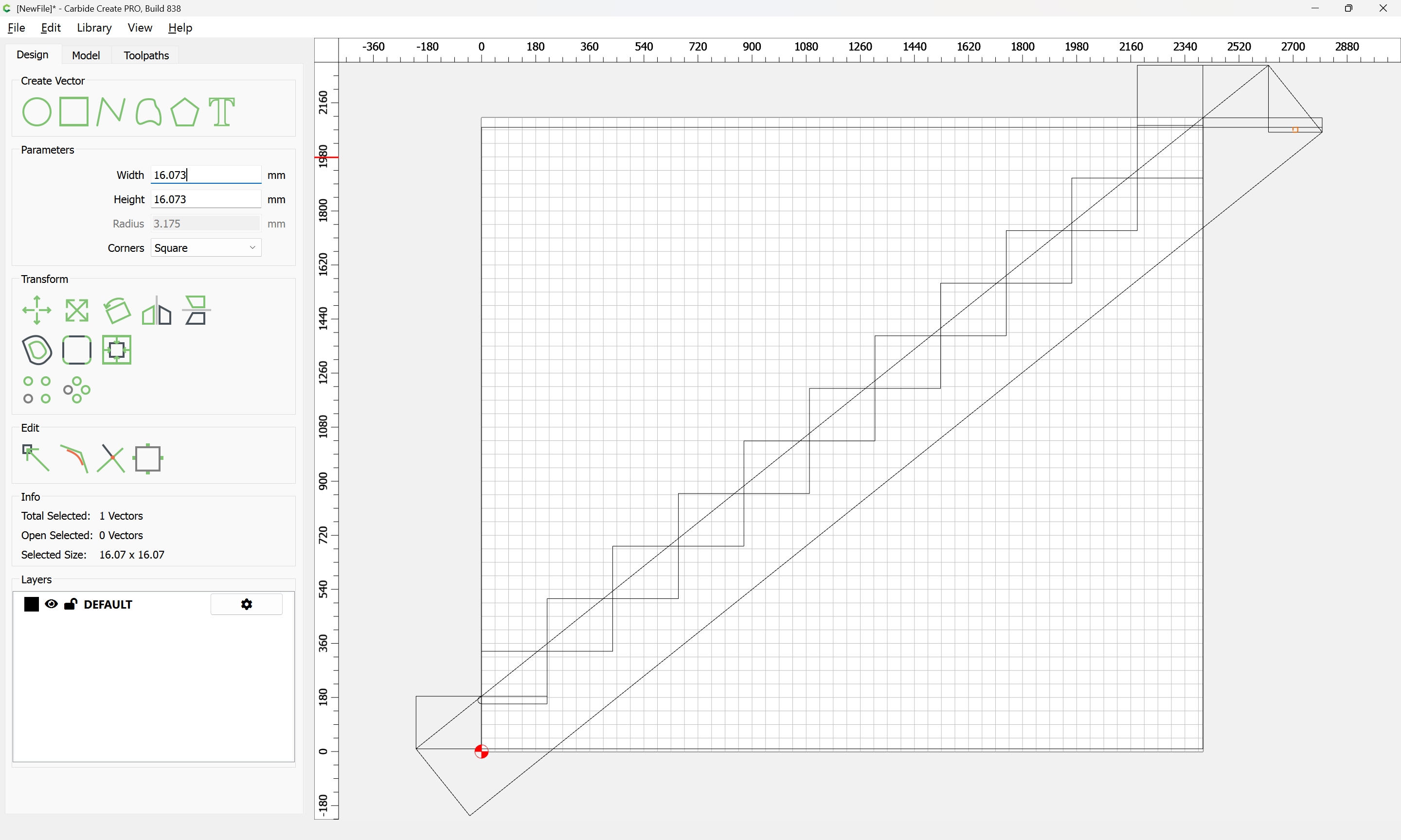

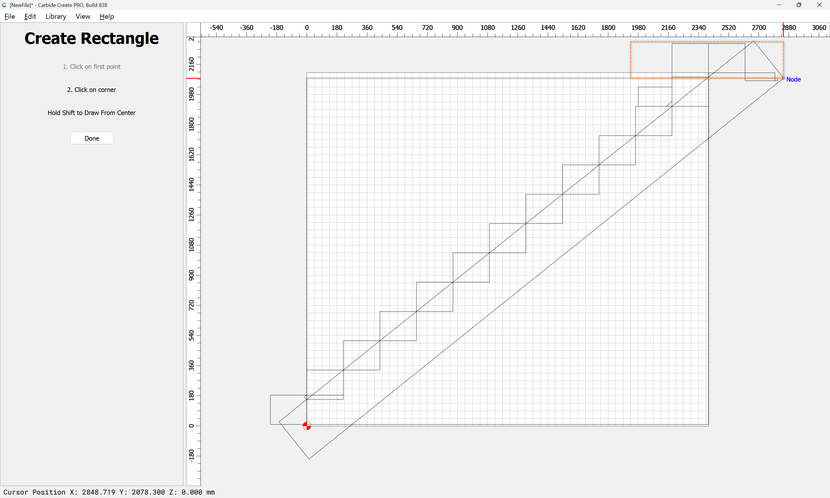

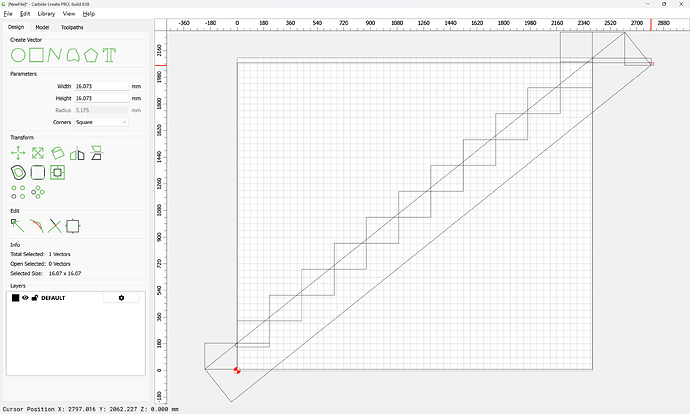

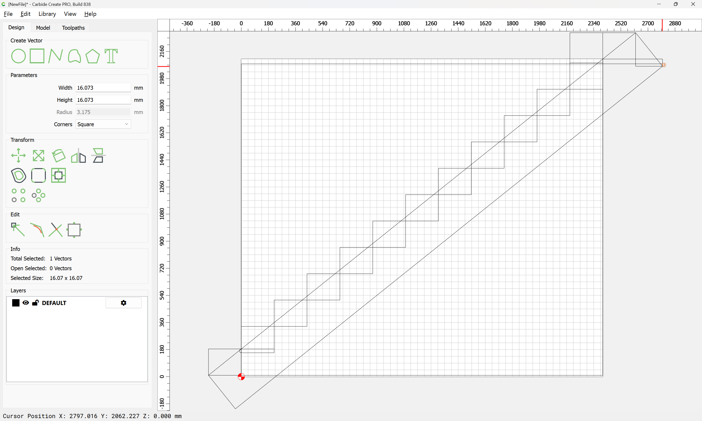

Then measure the diagonal at the top right:
and subtract the top finished and sub floor:

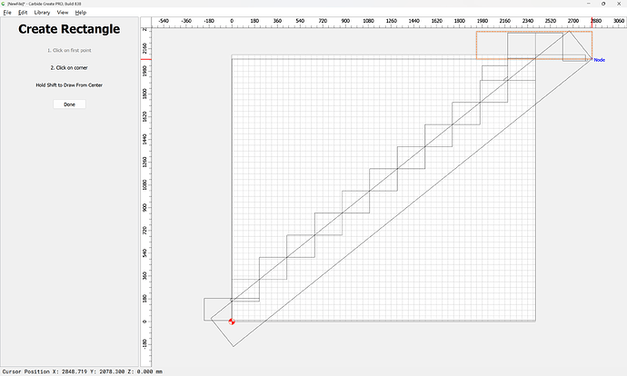

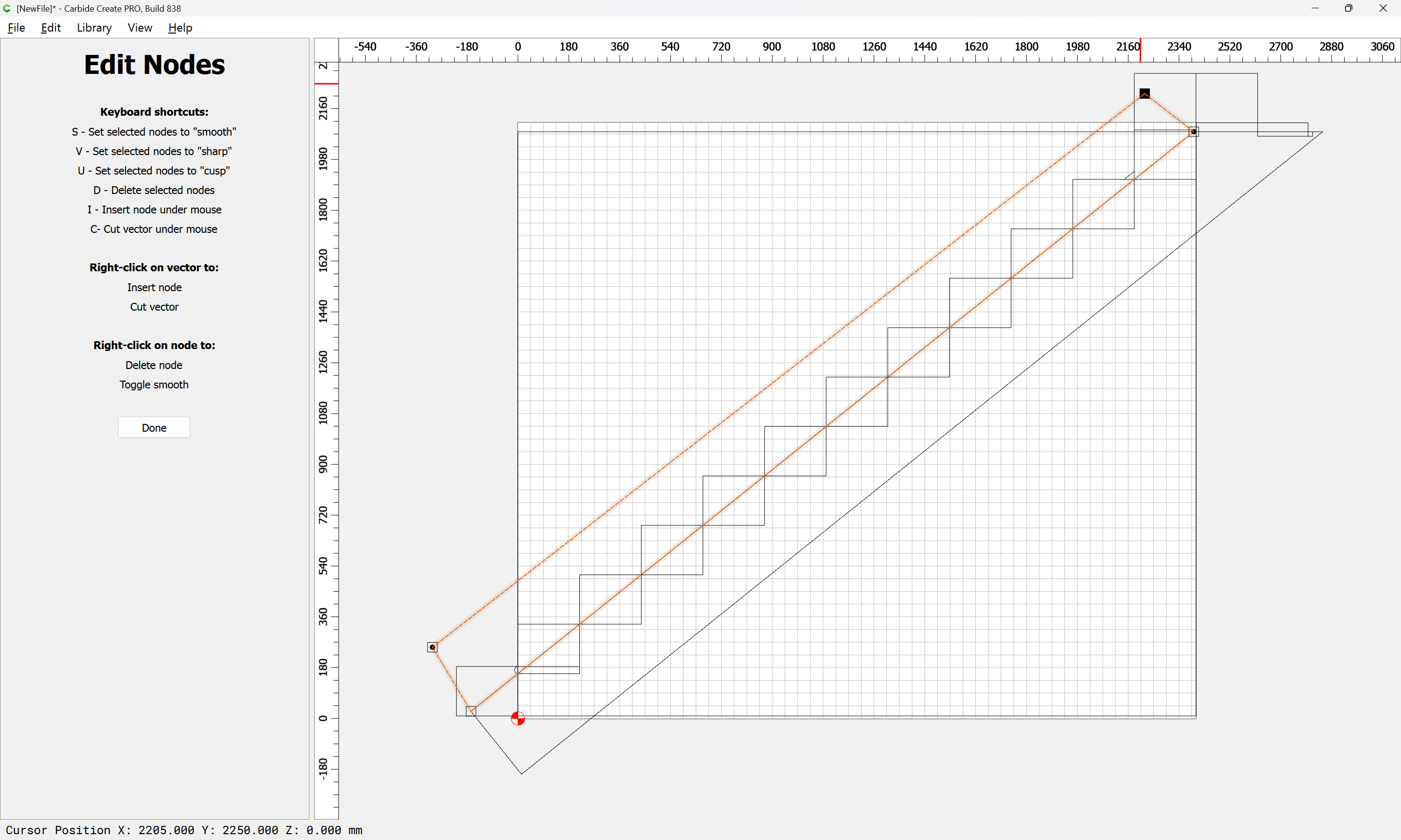

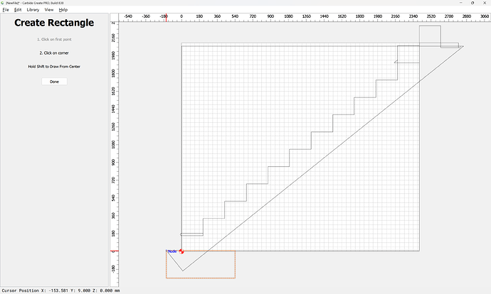

and then draw in a rectangle:

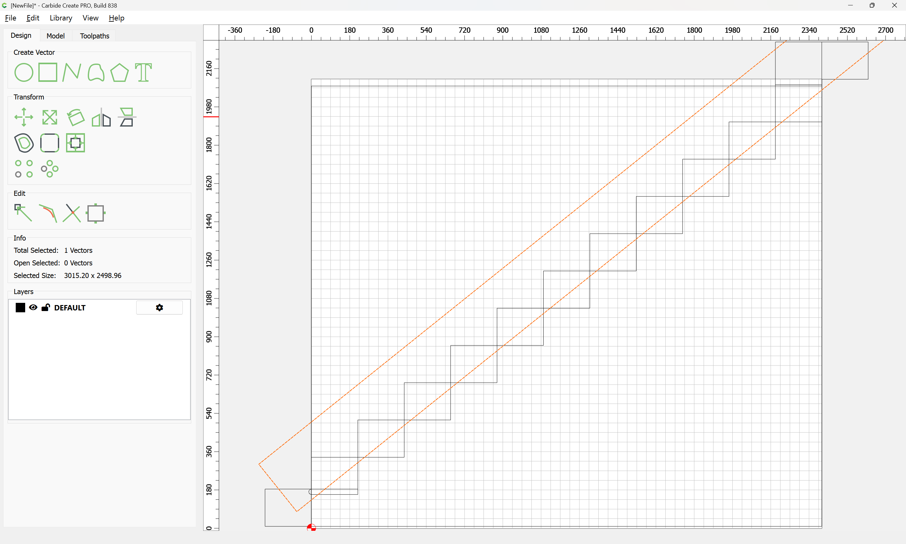

which allows one to determine how much up and over to move the 2x12:

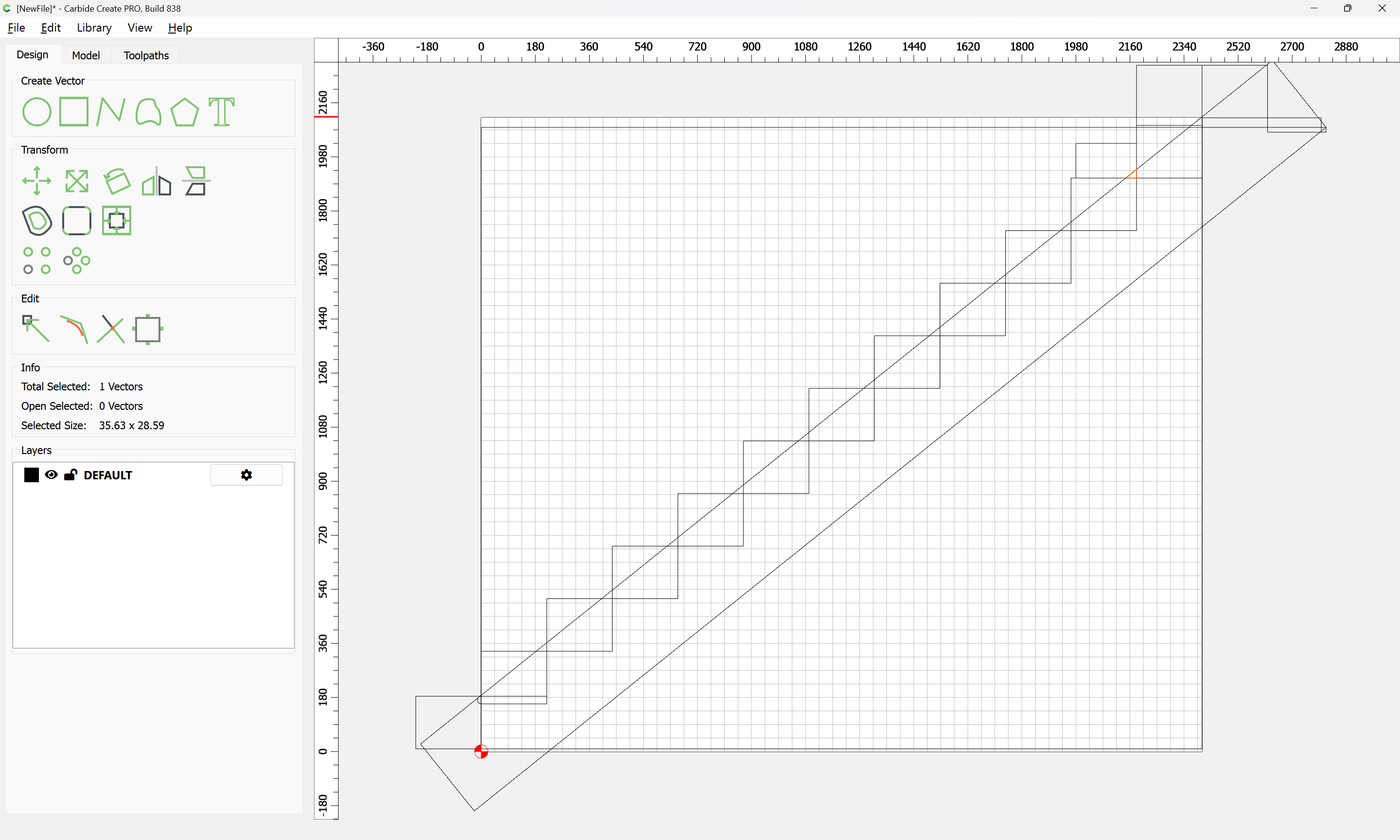

Then measure how much the overcut is:
and move the 2x12 that much horizontally:
Done

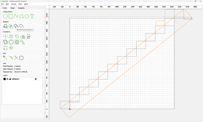

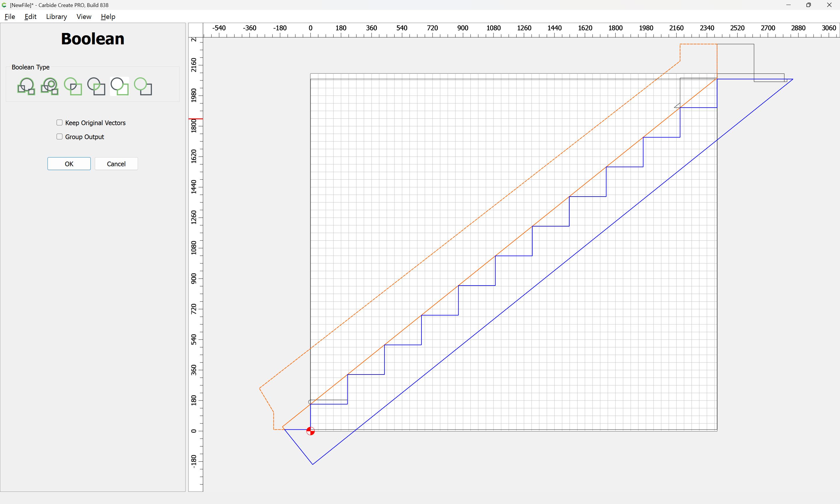

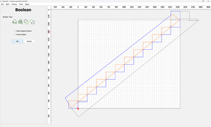

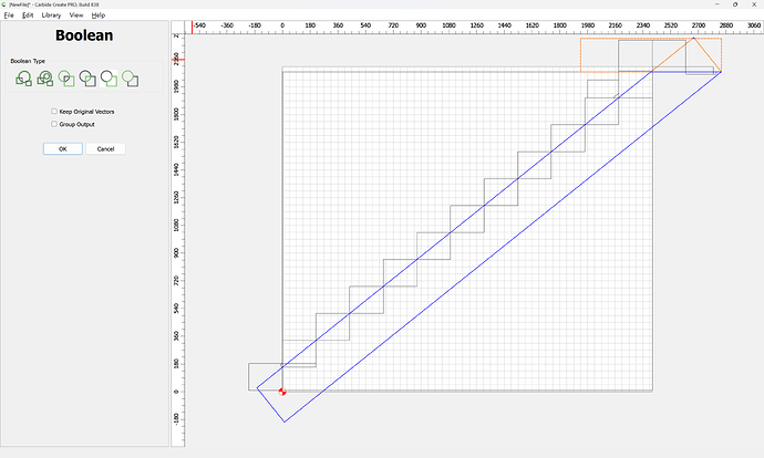

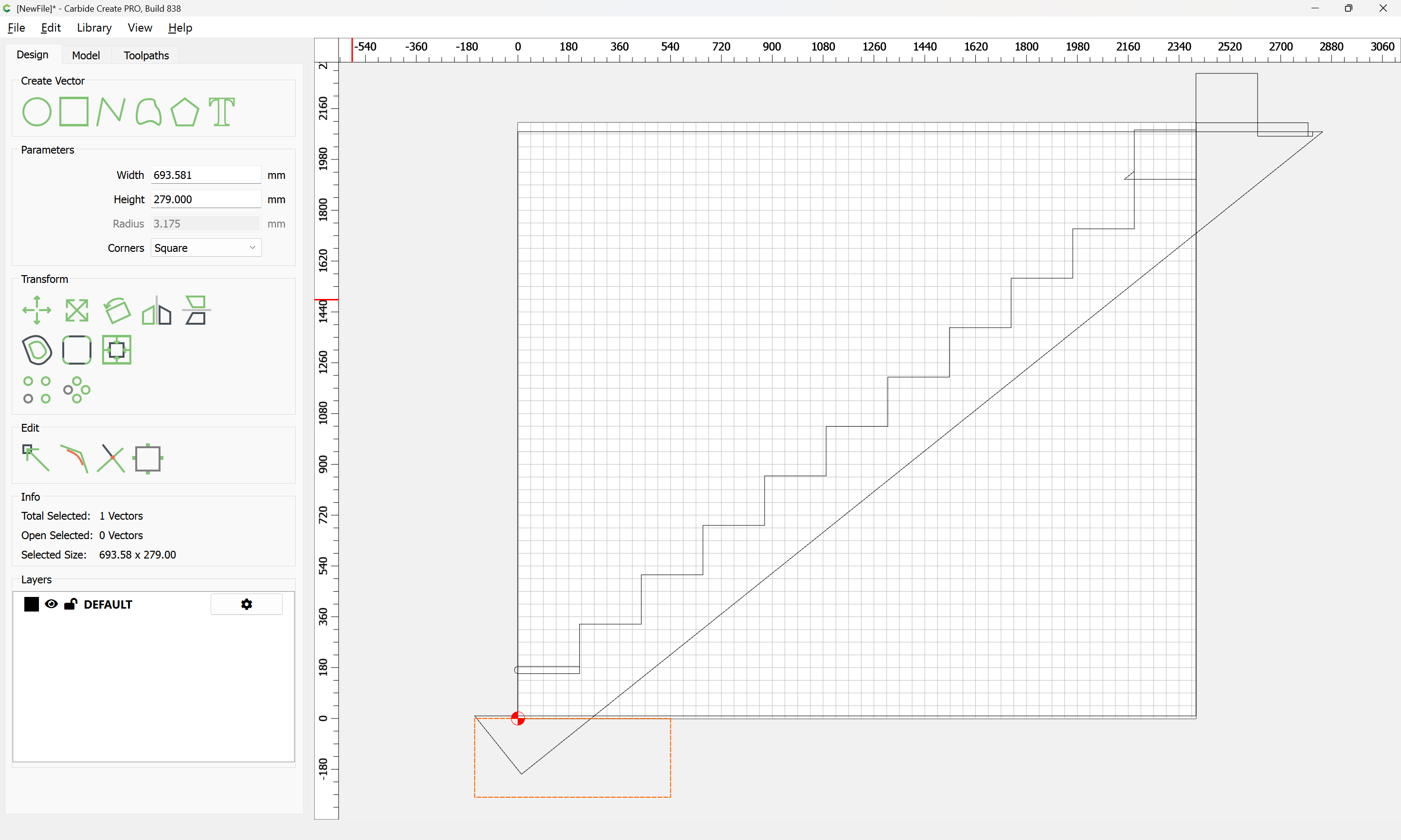

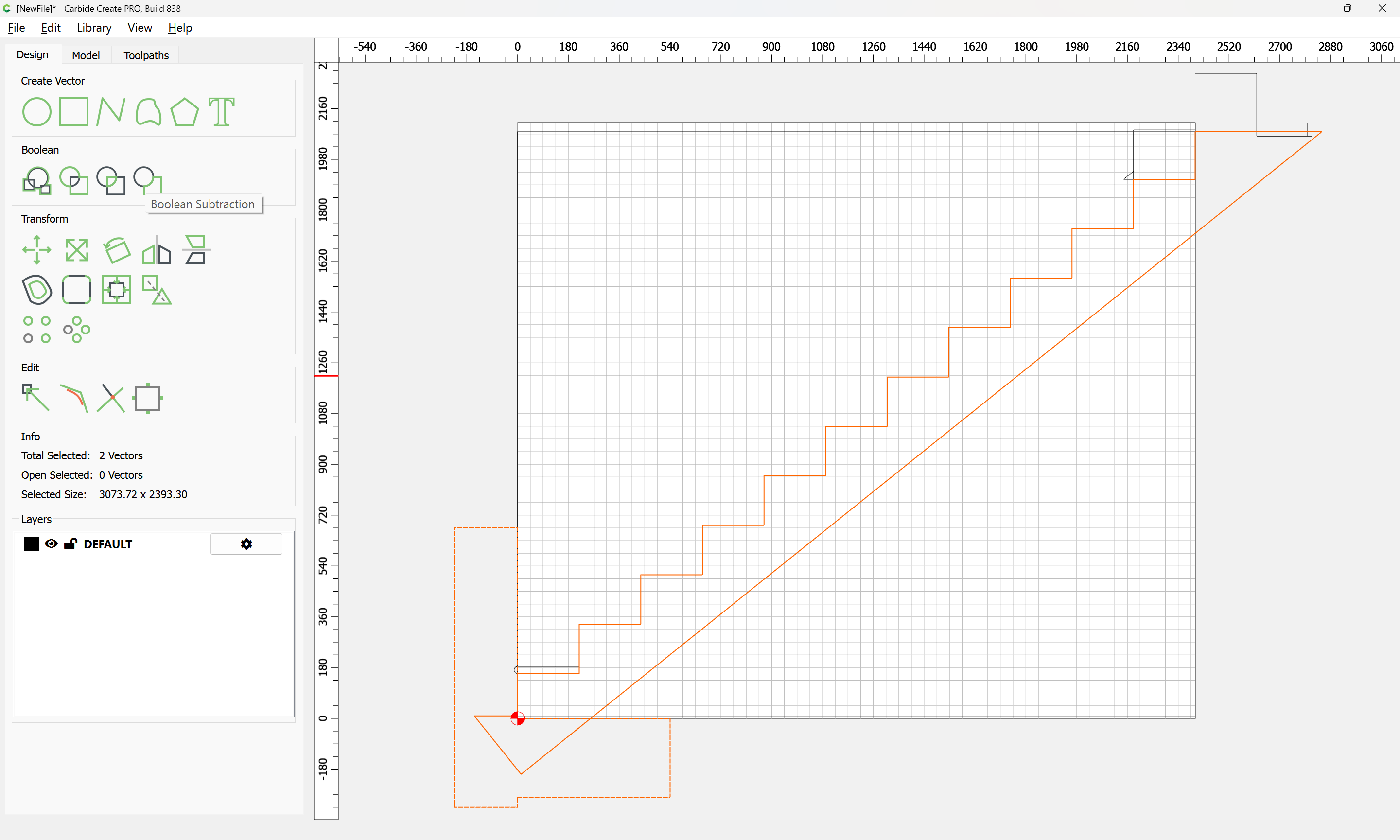

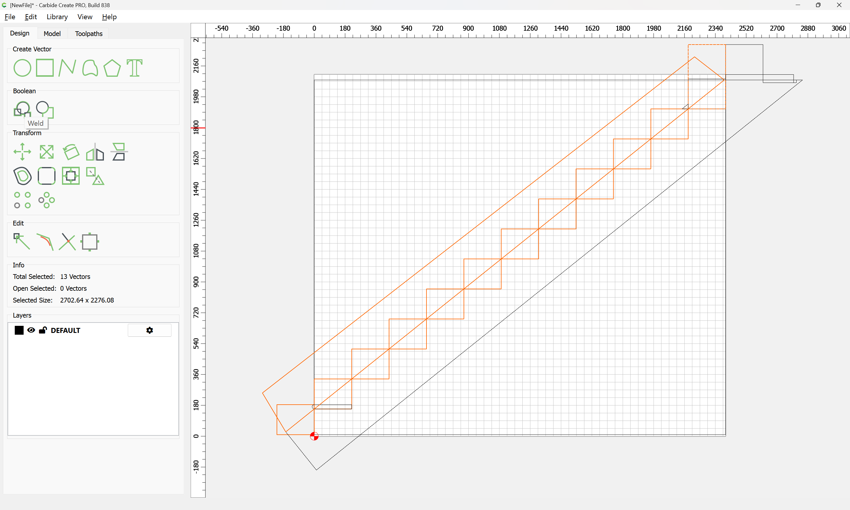

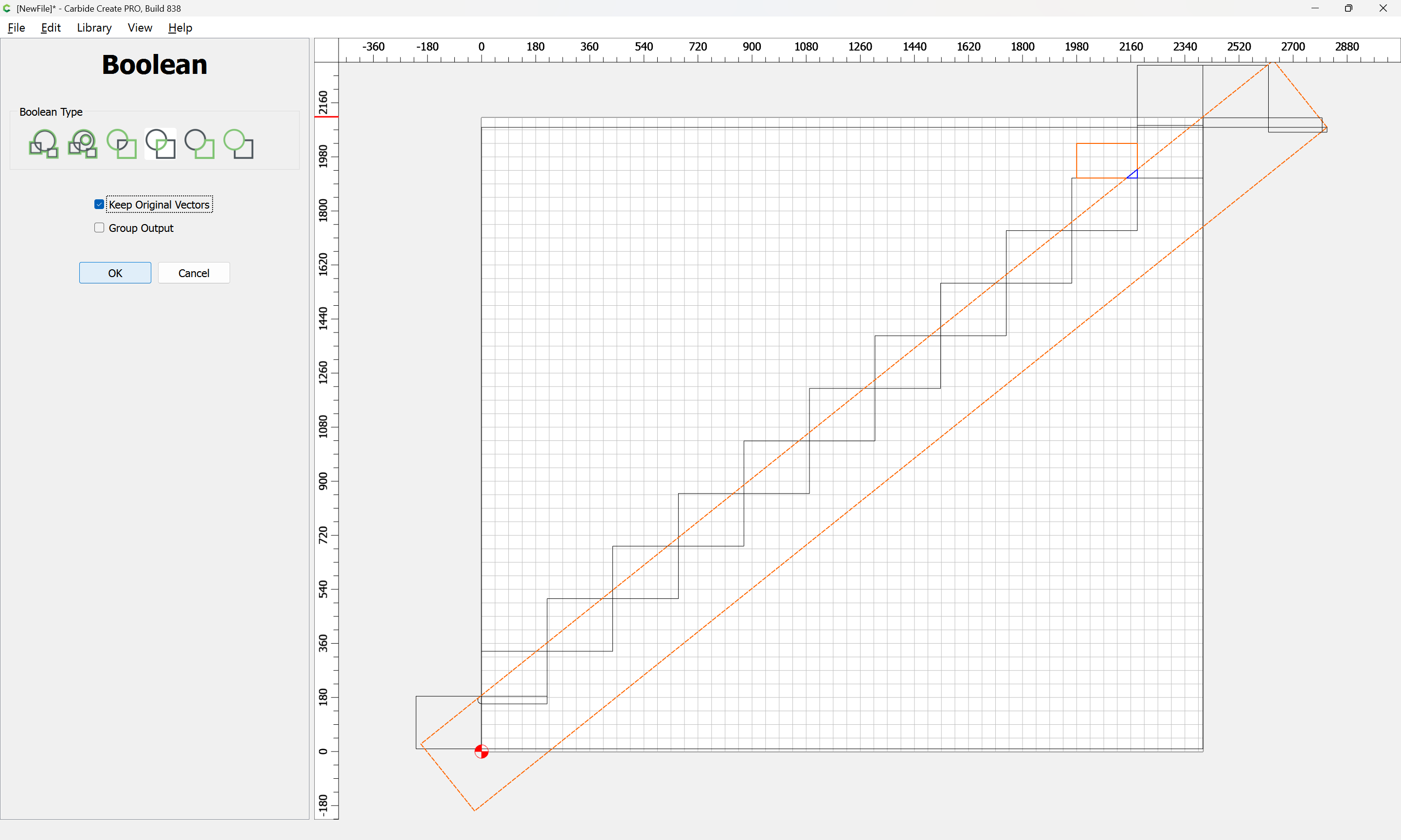

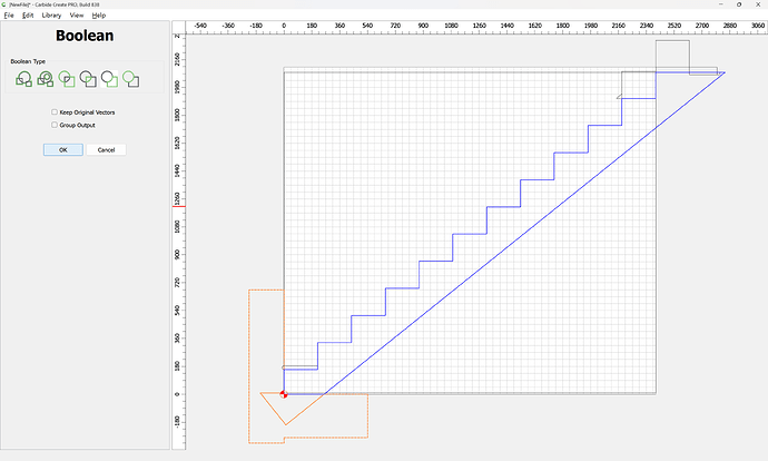

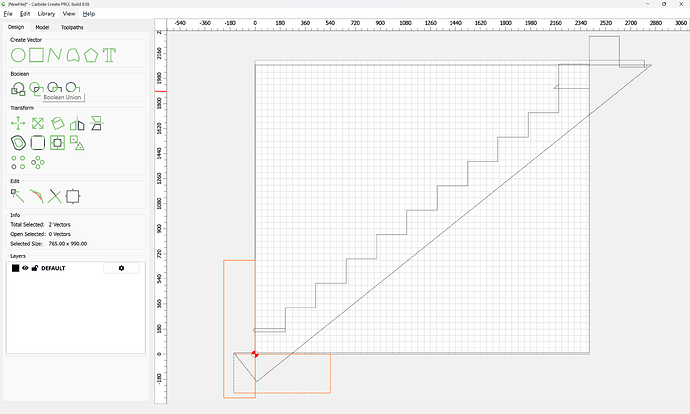

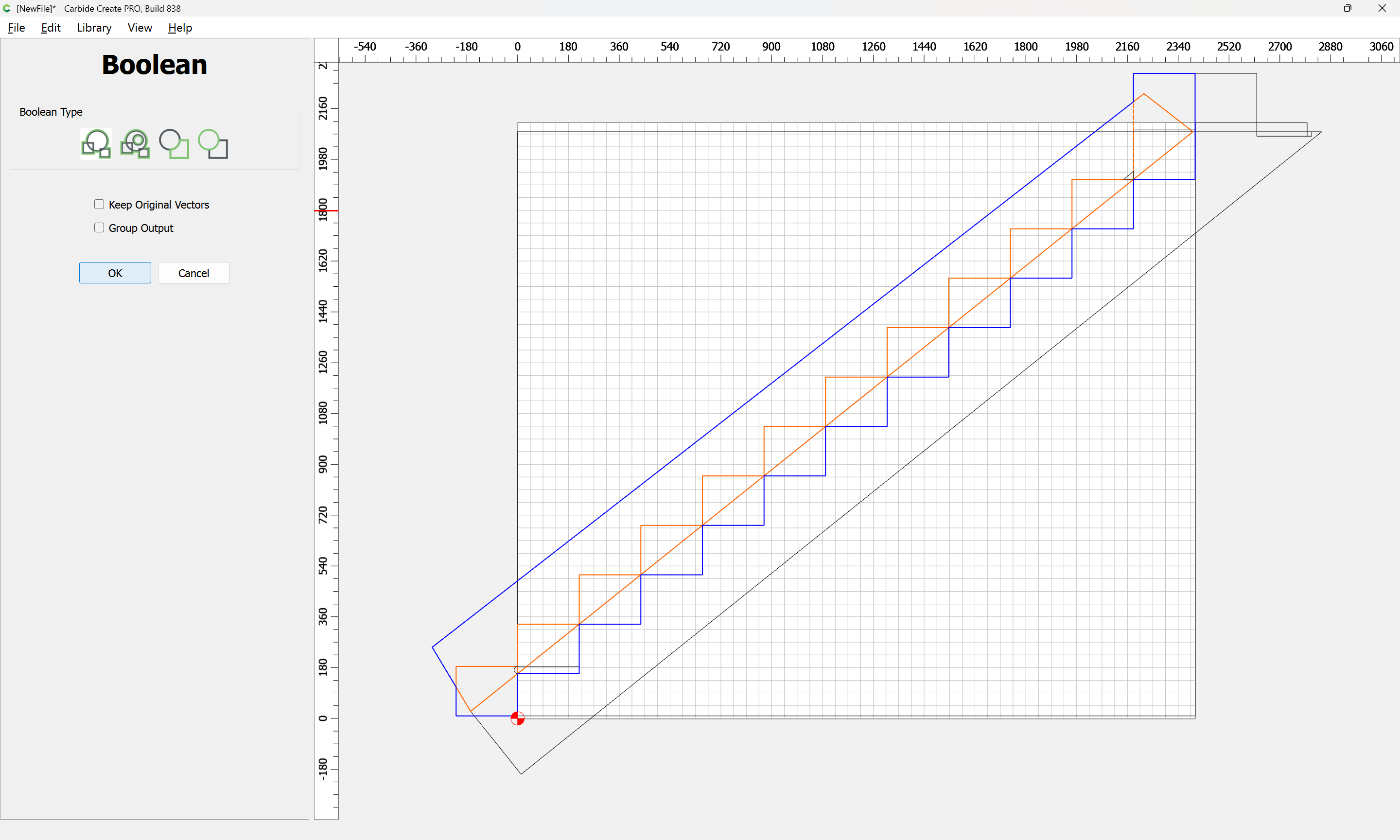

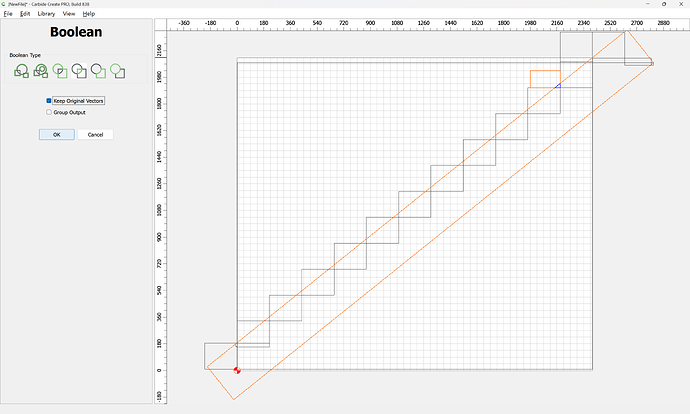

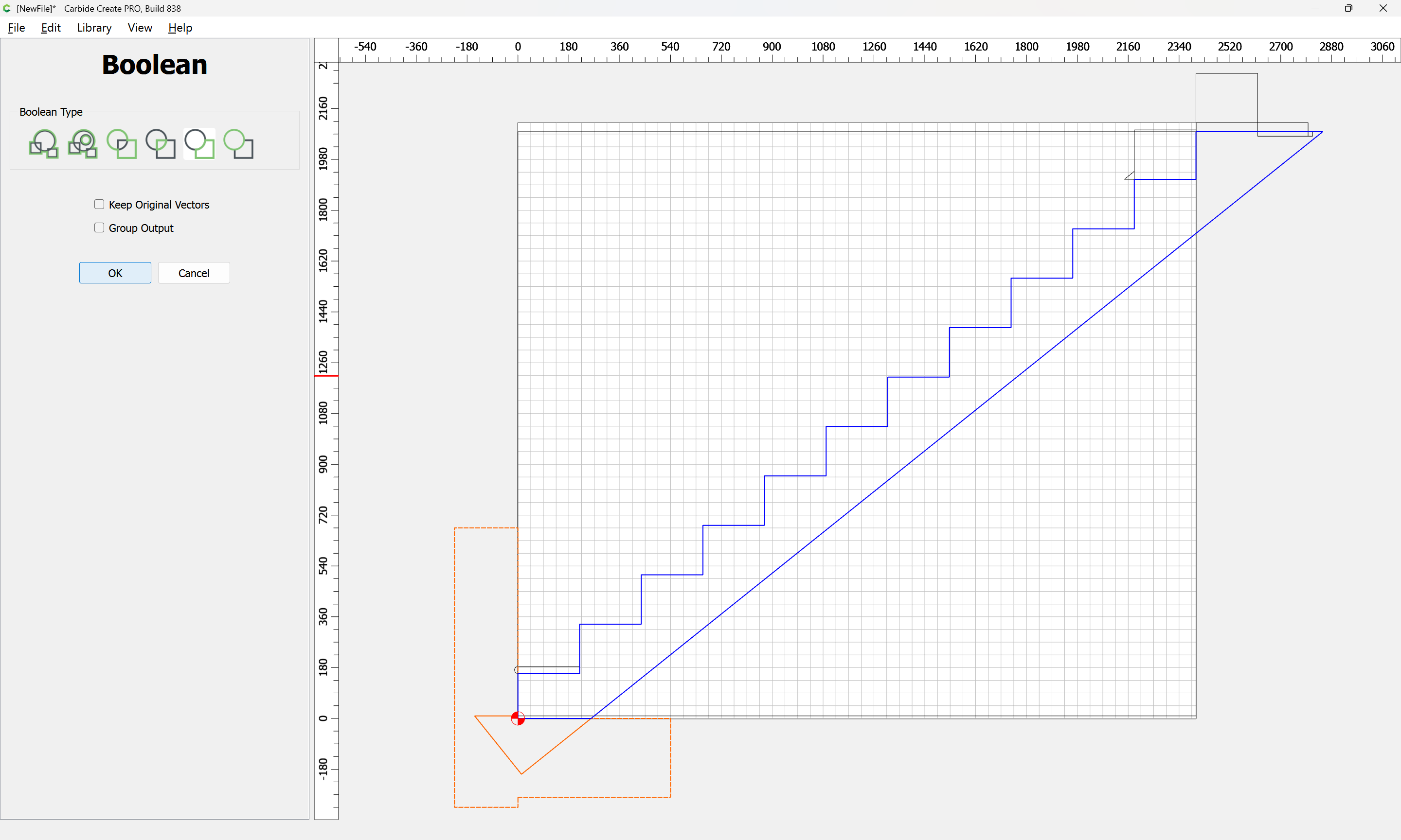

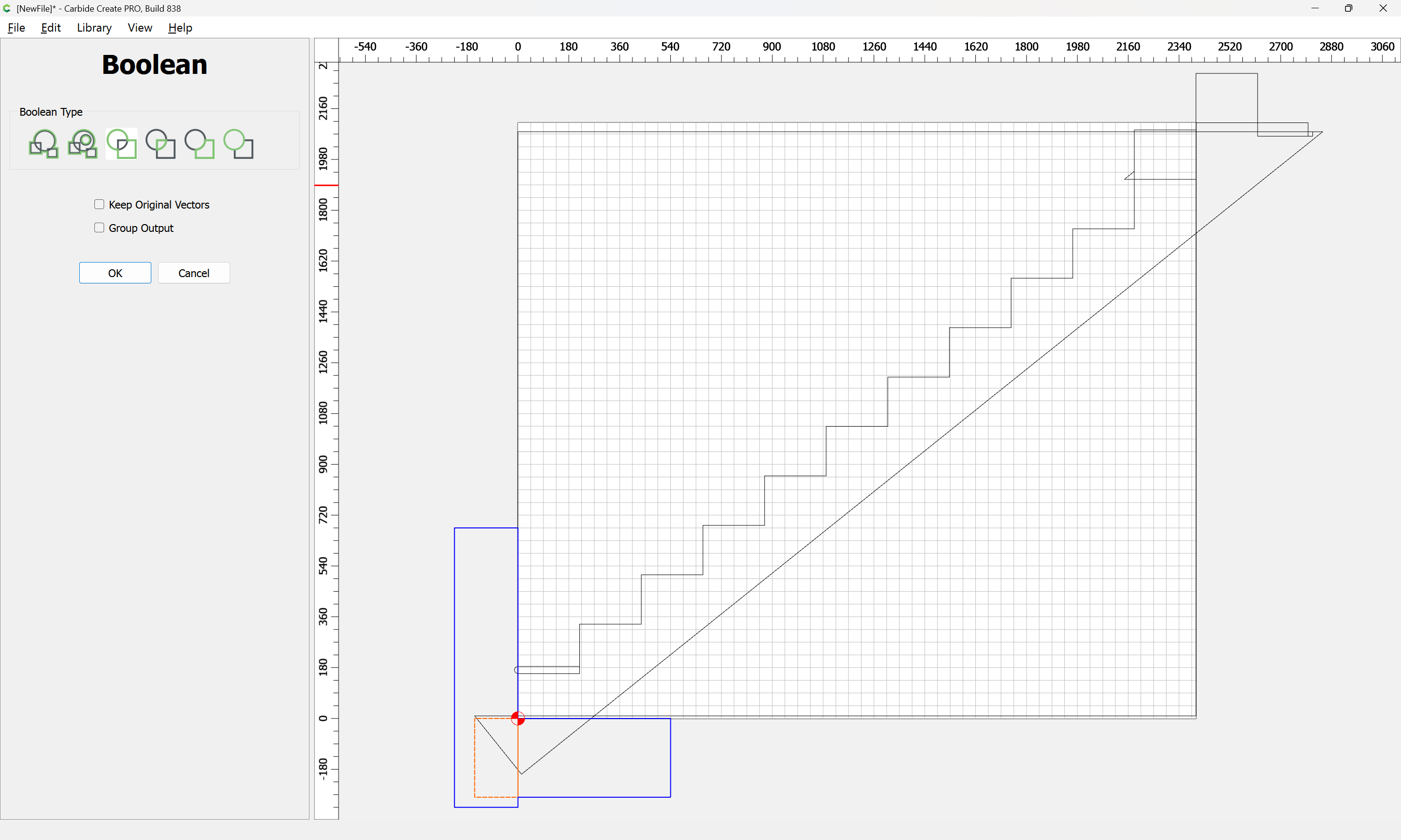

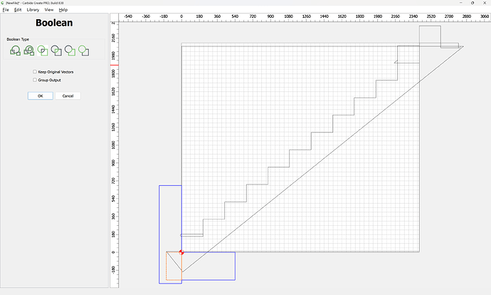

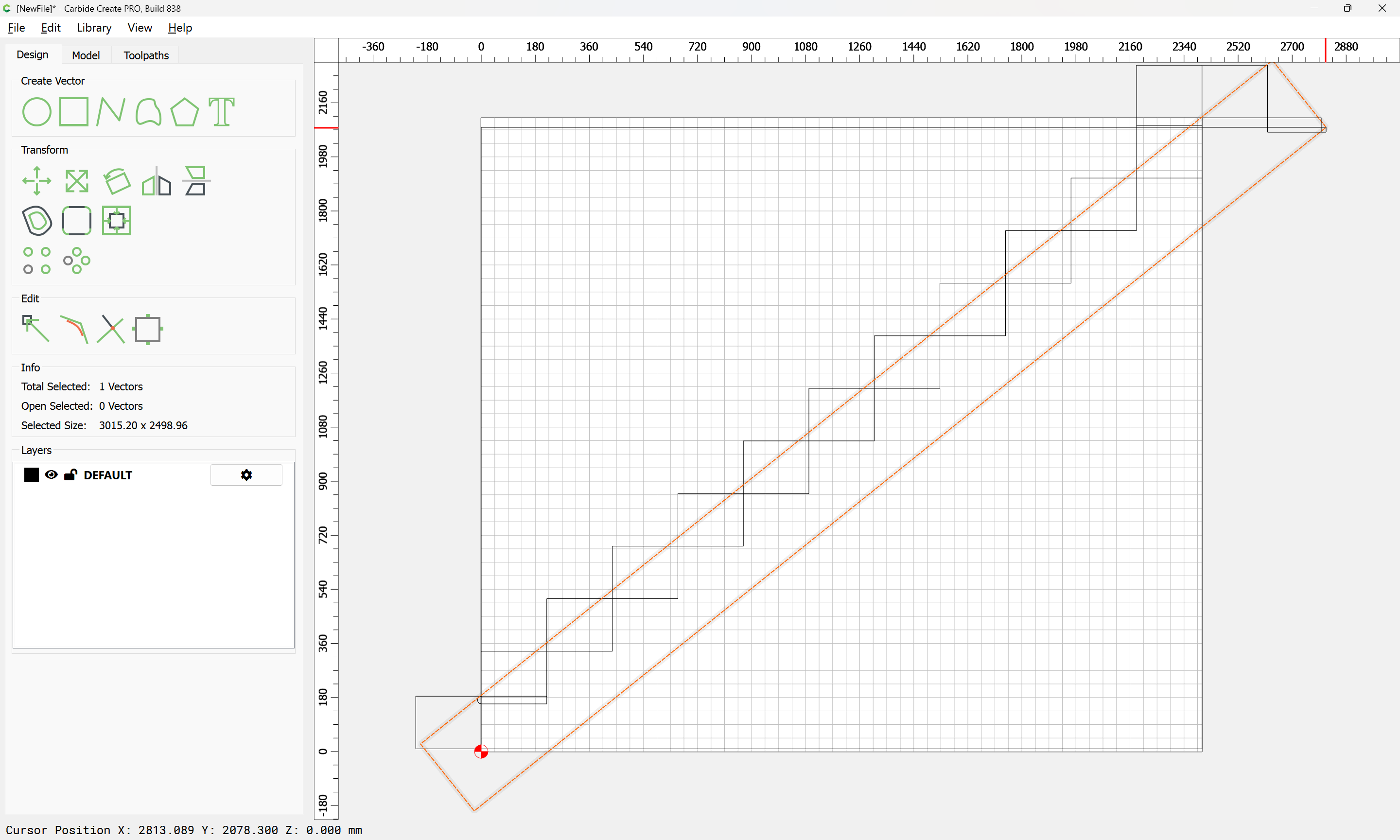

Then simulate the various cuts:
This will be simplest if the diagonals are all connected:
OK
Select the 2x12:
shift-click on the unioned object:
and Boolean Subtract:

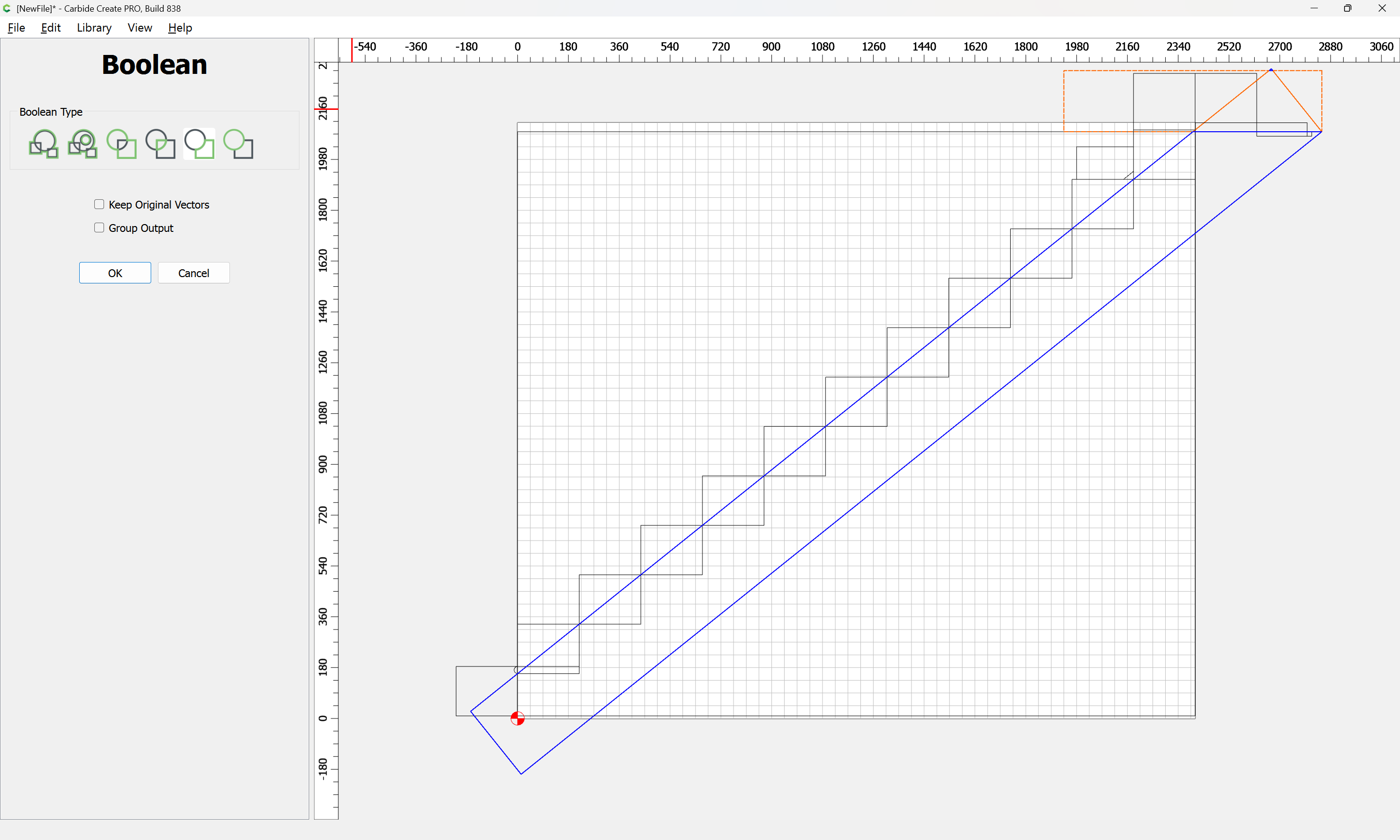

Make the last cut:
OK
Rotate back to level (or vertical) if need be.
