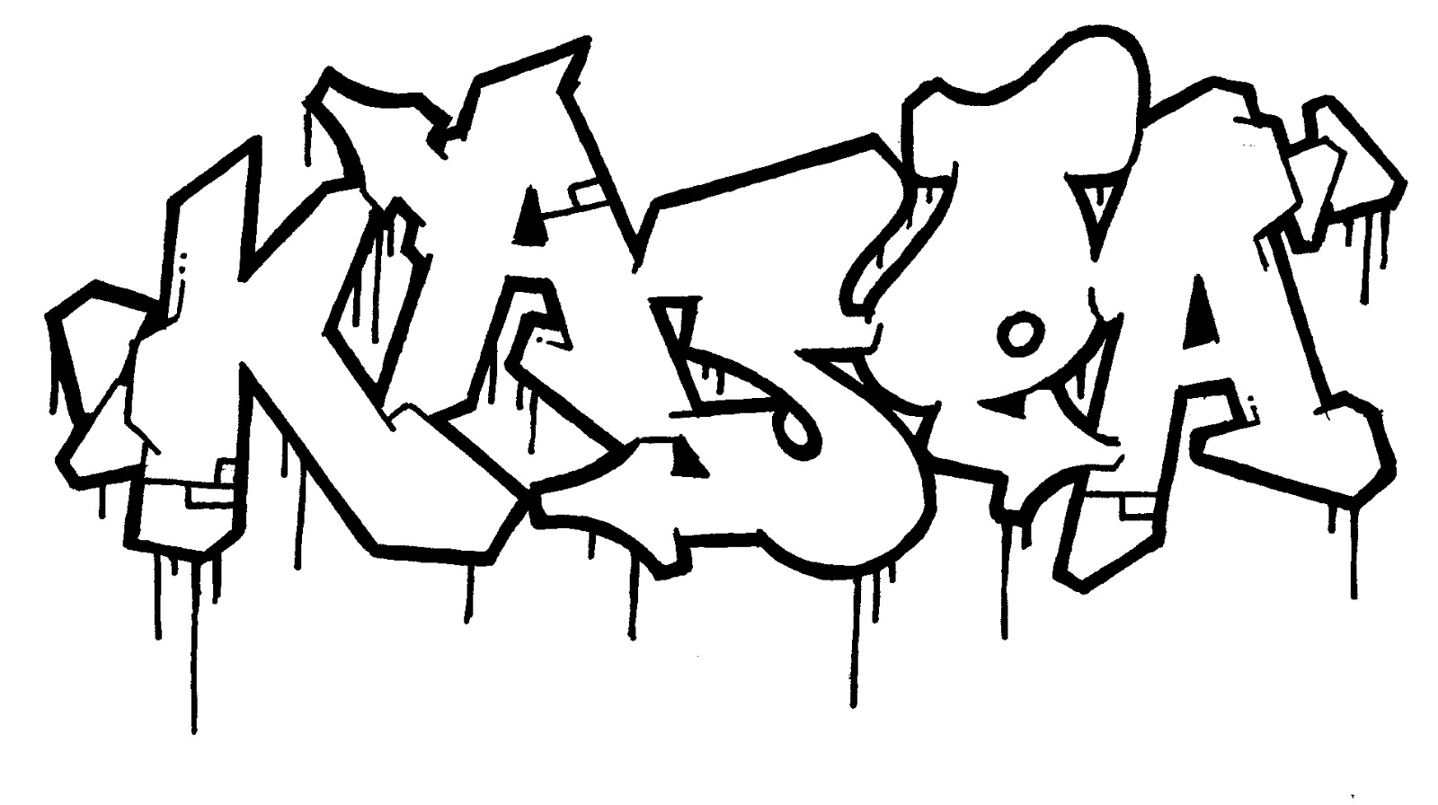

I’m contacting you because I’m working on a project for a client and I’m having trouble getting it right, so I’m asking for your help.
I’m attaching the file.

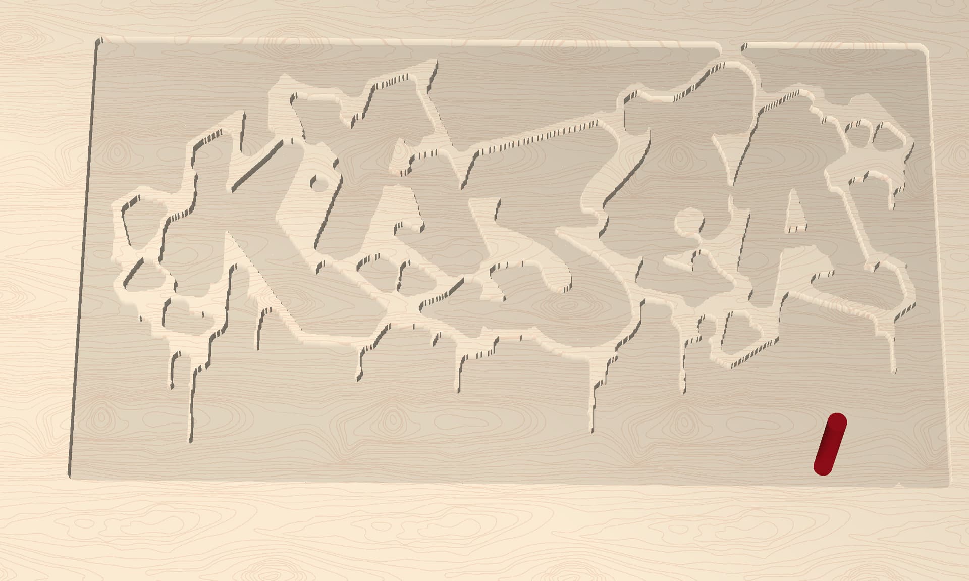

I’d like to make a 3mm pocket in the bottom, so the text isn’t affected… but you’ll see the screenshot of Carbohydrate in my second attachment, and you’ll see that it doesn’t look good… :slight_smile:

Upload your .c2d file?
What size is your design?
What is the width of the narrowest region?
What is the size of the tool you are trying to fit into said region?
Use an (Advanced) V carving instead?
test riton .c2d (1.2 MB)
The dimensions of the design is A3 format.
My little bit il 3mm…
