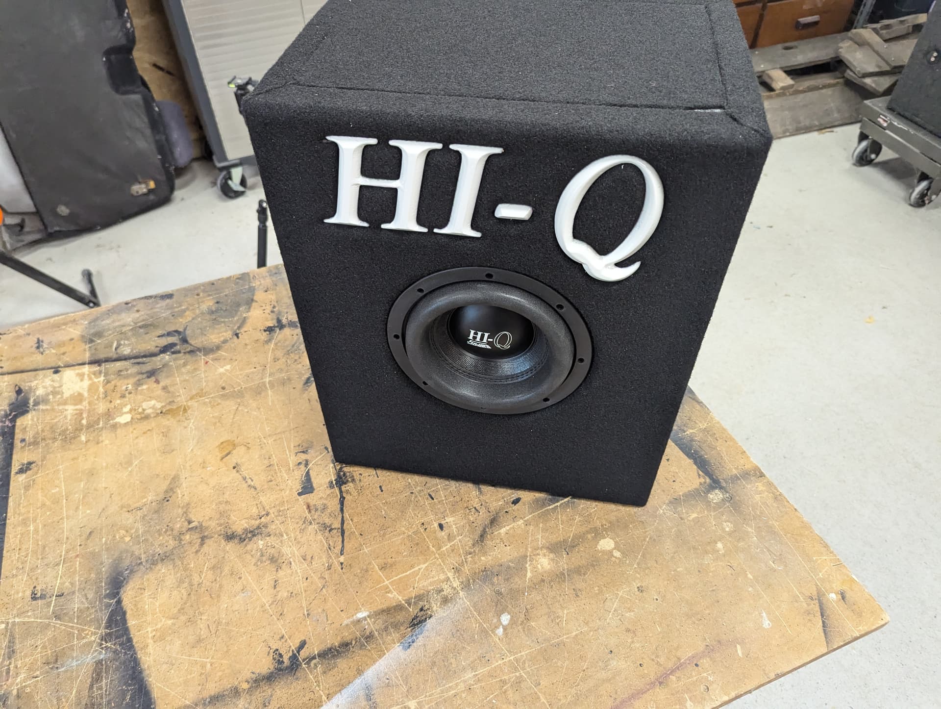

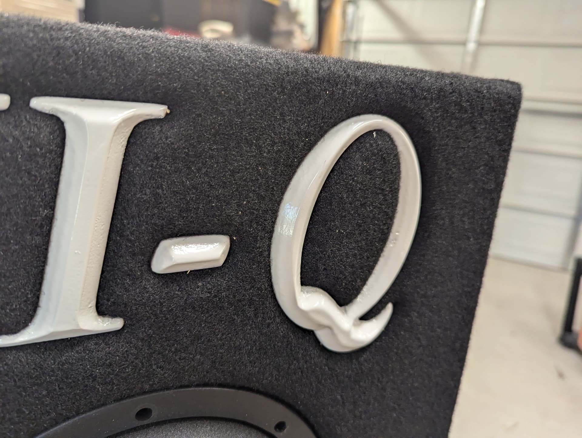

I used V carve to cut a chamfer on the letters and the edges of the enclosure. Then followed that with a contour to cut out the letters.

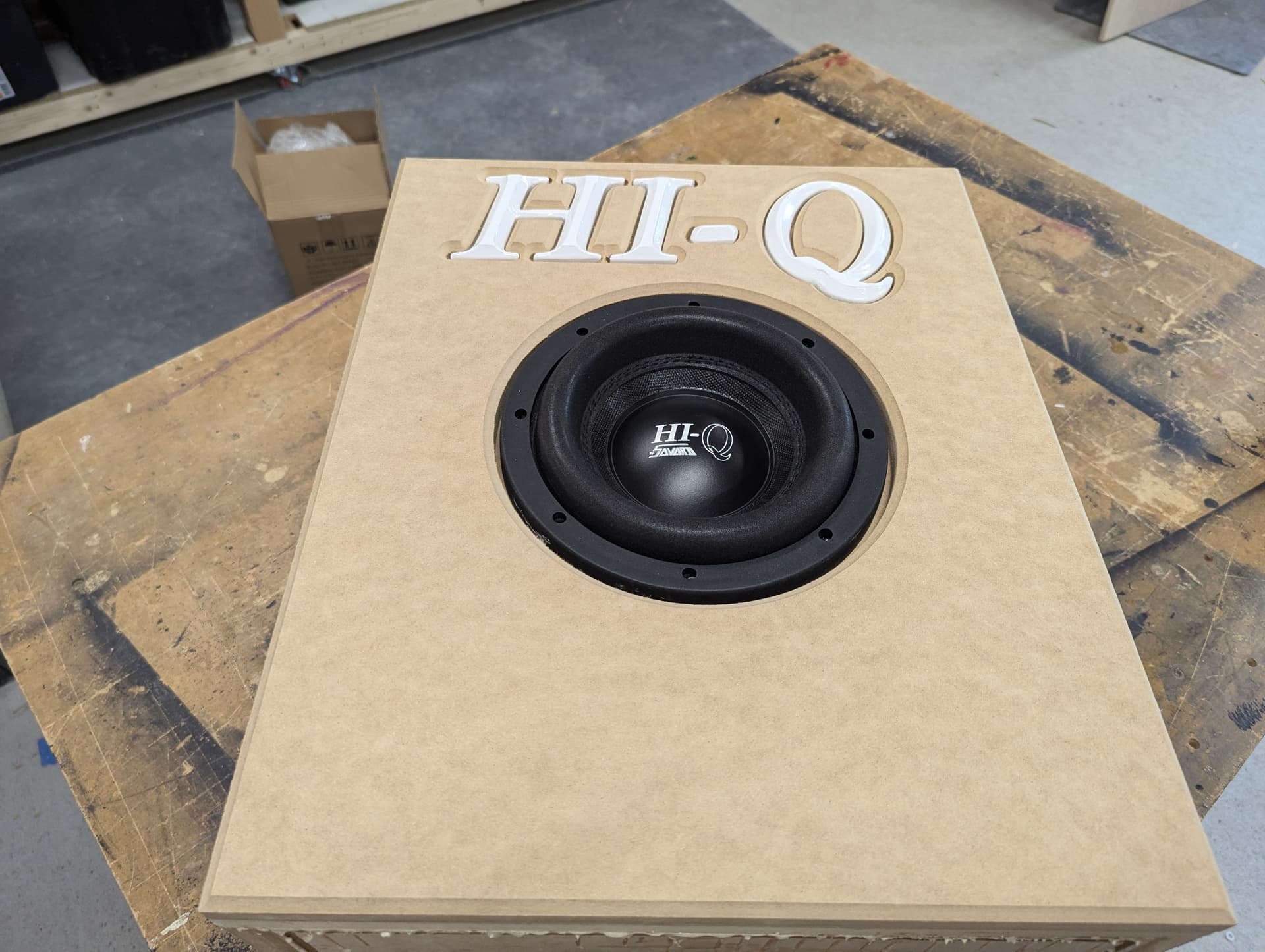

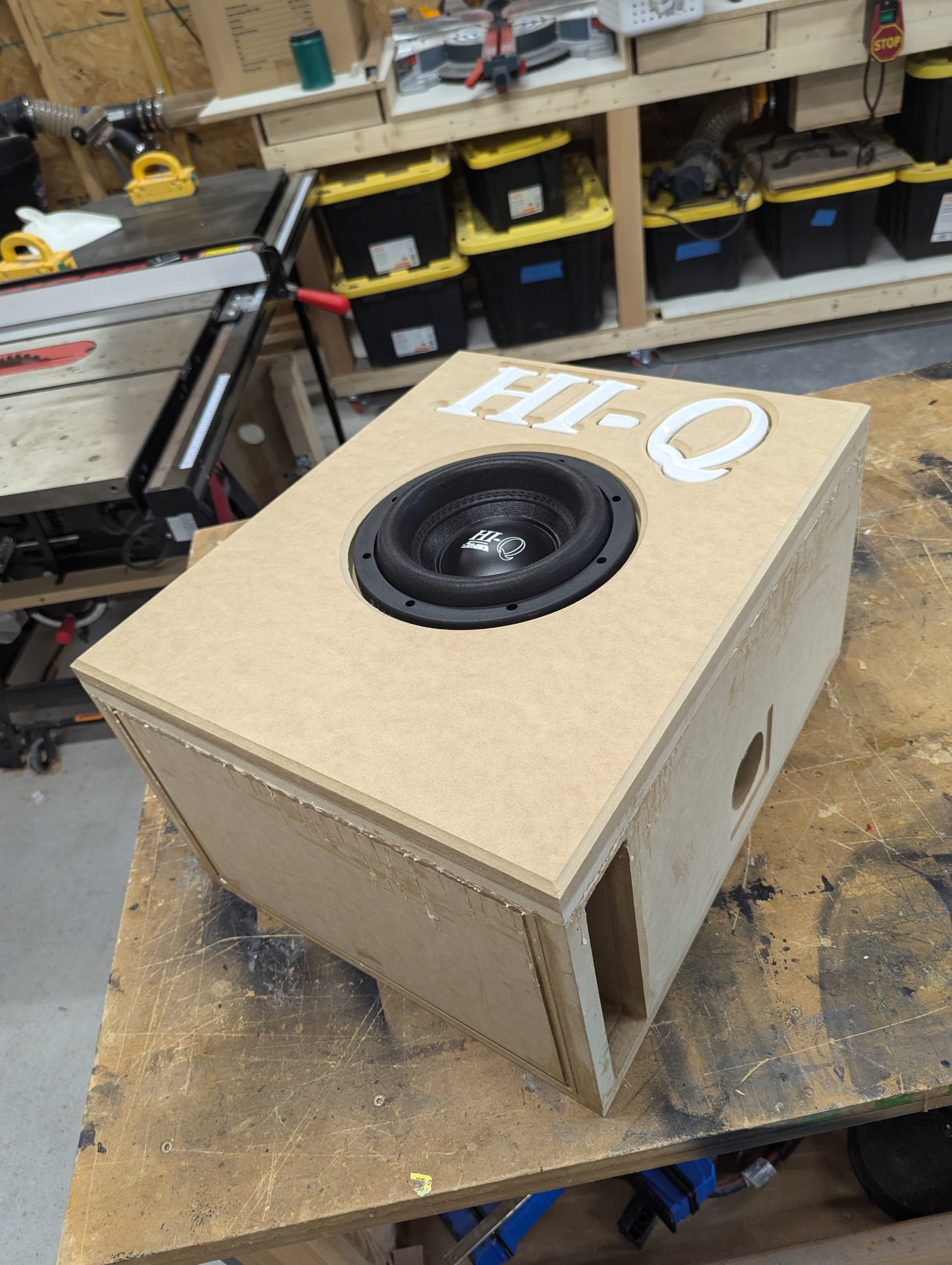

I used the pocket path to cut a recess in the enclosure, oversizing a bit to make room for the carpet. The letters press fit into cu-outs. Does this count as an inlay?
It counts as an inlay if you say so. Everything we do is subjective to what you think it is. The “Inlay” looks good.
Looks good. The inlay having texture rather than being flat is a nice touch.
