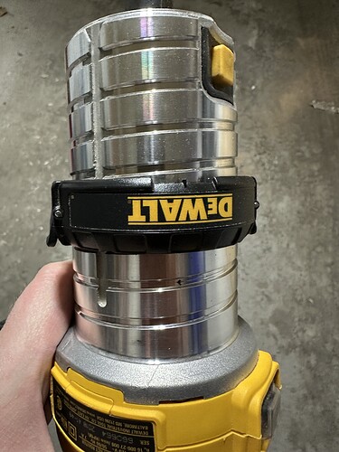

I got the black plastic ring jammed on the dewalt trim router. Its tight trying to go both ways by hand, havent yet resorted to any tools. Anyone have a clever idea on how to unjam it?
Maybe use a heat gun to heat it up & make it more pliable & expand it?
Did you release the latch? in the picture on the left is a little latch that secures the ring in place on the router. Make sure you have that pushed in. The assembly is supposed to follow that assenting/descending threads on the outside of the router body. That is if you push the release.
It seems to have fasteners holding a split collar ?
