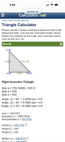

Trying to dial in squareness on my Shapeoko 5 Pro 2x2. It looks square (as accurate as I can measure the machine), but does not cut square.
I cut a 545mm square using a 1/8" bit (that has a 1/4 shaft) and measured both diagonals with a meter stick (front-left to back-right, and front-right to back-left). Front-left to back-right consistently comes out about 1mm longer (than the other diagonal).
I’ve now run this test four separate times. As far as I can tell everything else about the machine measures square, dimensions are accurate, so this really does seem to be just a small squareness offset rather than anything else going on.

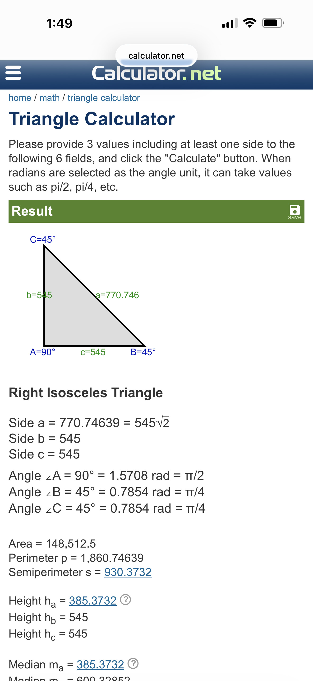

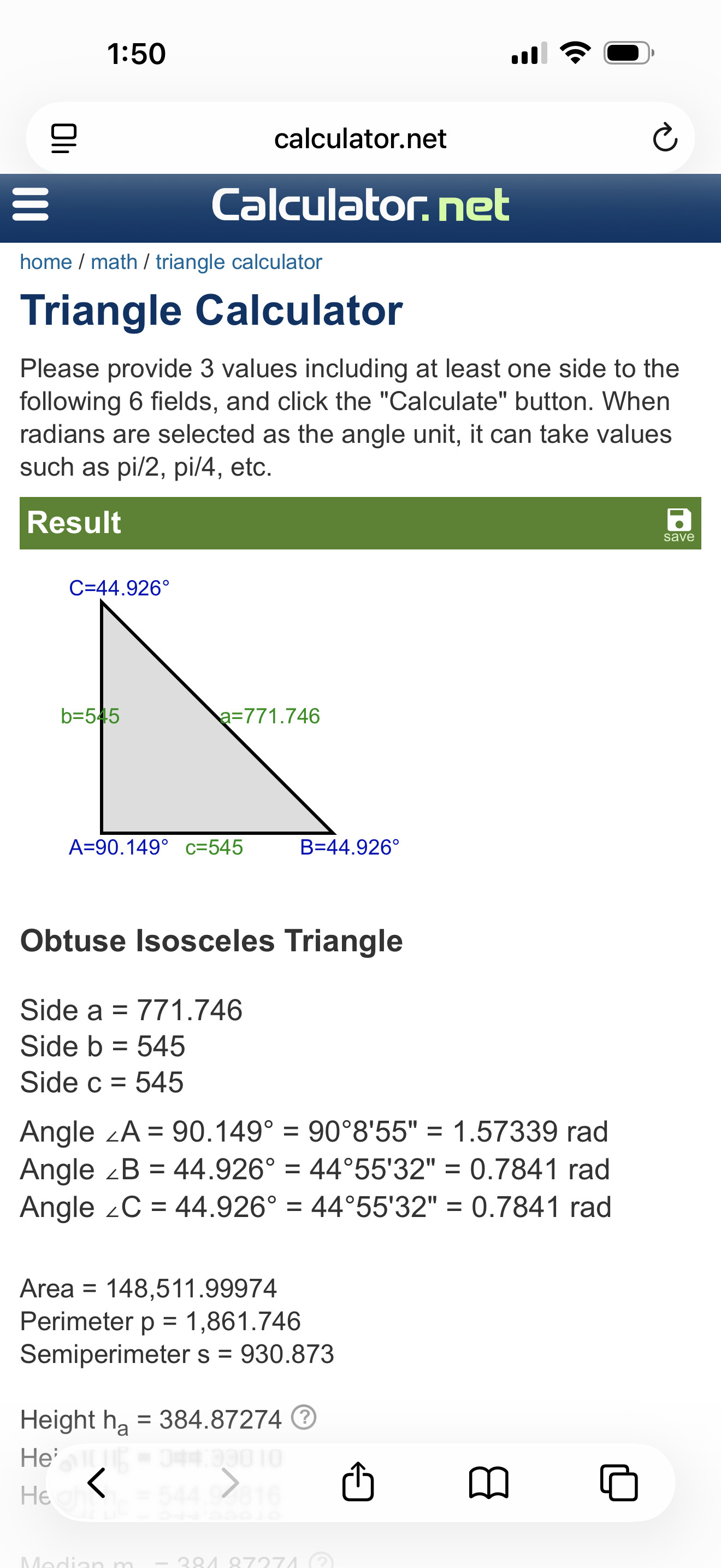

I would like to point out how small of an issue you have. And this information is only as accurate as you and the tool you are using to make the measurement.
You are dealing with a 0.149 degree out of squareness.

Yes, Pythagorean theorem, from 8th grade math, where a² + b² = c². I’ve been comparing the two corner-to-corner diagonal measurements to check squareness
For a square, both sides should be the same length, so the diagonal should be √(a² + a²).

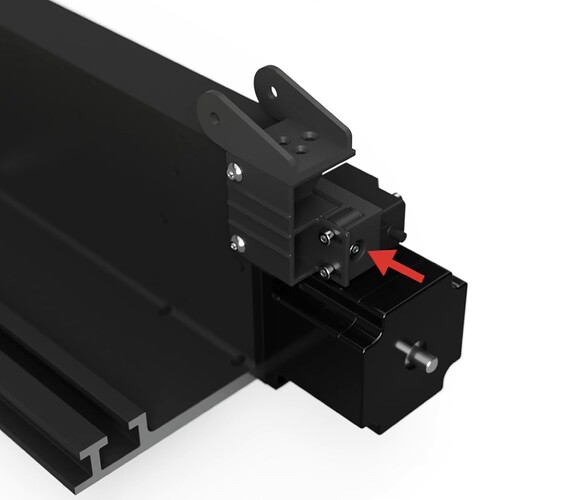

I was in aware that they updated the sensor mounts to be adjustable on the newer machines
To restate the intent of the Shapeoko 5/5.1 Pro design (because I haven’t gotten to do so in a while):
  • ā€œSquarenessā€ of the machine is not the goal and ultimately doesn’t matter because the machine is squared during homing. The only real requirement is that the right and the left sides are parallel to avoid binding.
  • Once you have a machine that’s parallel enough to function (which should not be a problem), the squareness of the cut is adjusted with the homing switches on the back of the Y-left and Y-right.
  • The quickest way to get a good part is to measure the squareness of the cut, adjust the switches if there’s a problem, cut again to check, and repeat if necessary.
If I remember correctly, the adjustment screws are M3x.5, so a full turn is half a millimeter of movement.

Turning the screw on the homing switch worked. Cutting perfect squares now. Thank you.
