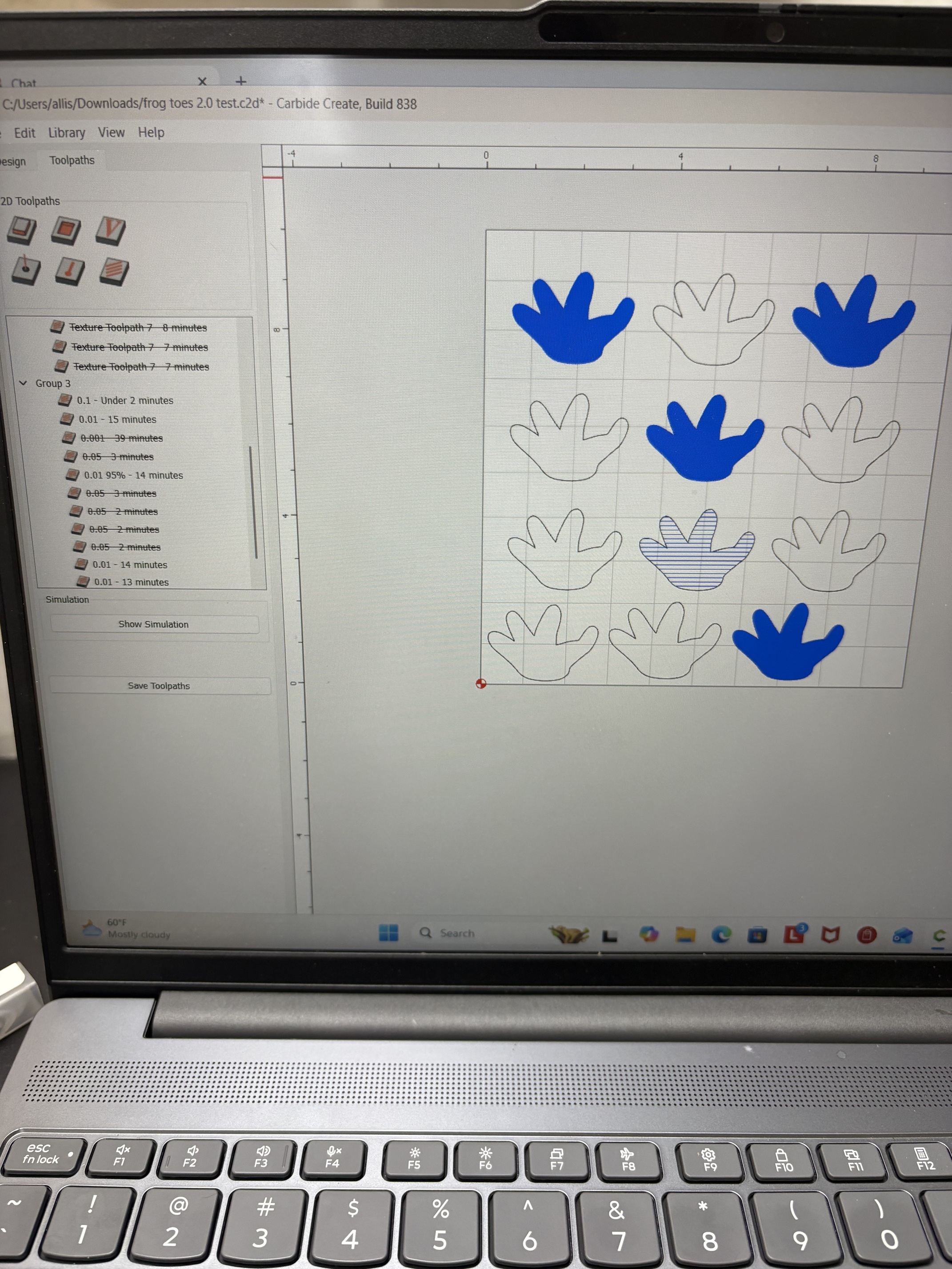

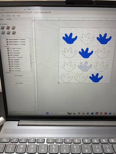

Hi I disabled multiple tool paths but they have still run. I am testing out different ways I can layer and adjust the texture tool and it seems the be running all the paths I made even the ones I have disabled, do you think this is because I disabled some buy group and not individually?

Did you reload the file after you disabled them in CC? If not, when you start the cut in CM it will use the original file loaded.
If you have a file which exhibits this behaviour, please send it in to support@carbide3d.com — that said, I always write out the file using a new name when changing anything and verify that the change took in the Carbide Motion 3D preview.
The files were disabled before they were saved and sent to the machine
Your screenshot shows 5 enabled toolpaths and 5 cut previews. Can you upload your .c2d file?
