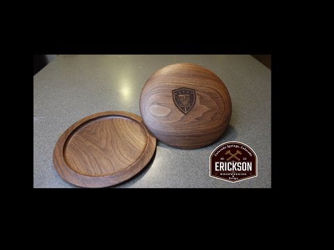

A buddy of mine plays Disc Golf religiously and is putting on a pretty big tournament tomorrow with a ton of sponsors. He asked me to make something for a raffle item during the event. He didn’t give me any specifics, so I made 2 Disc’s out of Walnut. :joy:
It was actually pretty fun! I spec’d out all the regs on tournament discs and made them to spec, exact dimensions.
I purposely left the stepover larger and sanded everything flush.
It took everything I had not to throws these in the back yard.
Cheers!

Did you do the convex side first and then flip it?
I wonder how the weight is compared to the plastics?

Are the setups correct in Fusion? It looks like both setups are using the top model.
Re-update the bottom toolpaths and they will switch over to when I moved the model.
Basically, click each toolpath and hit ok and it will switch over. Thought I did that before I sent the file, but apparently not.
Depending on how long you want to job to run, I would play around with the stepover, there was a lot of sanding with the current one.
Also, to get your backside cut lines up correctly, when I cut the stock in the table saw, I didn’t move the fence at all and cut everything at 9”. So everything was completely square when I marked the center point on both sides.
