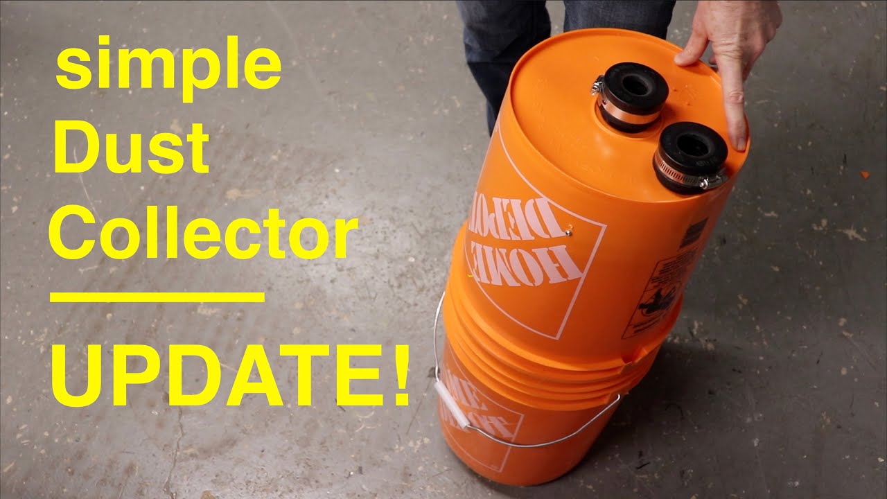

You can build one of these yourself for the cost of 4 buckets, some rocks and pvc fittings from your local hardware. Checkout Chris Notap’s build here:

Nice! Love the huge capacity and the simple disassembly. The bucket version uses the same internal setup with the pvc elbow.
With the Chris Notap version, he solved the collapsing problem by doubling up the buckets (2 external buckets as a sheaf). Works like a charm.

That’s what I do with my BBS orange/blue buckets in my collector.
