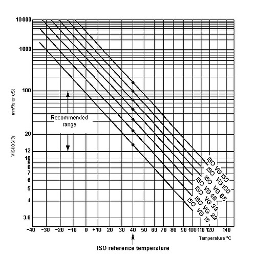

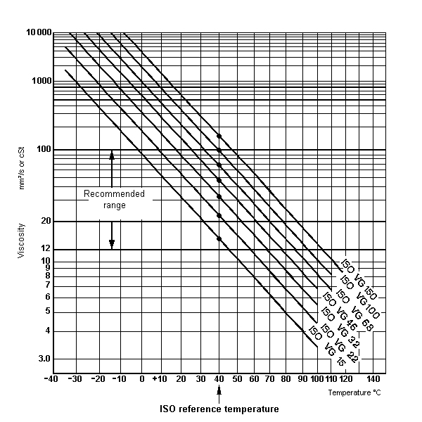

Indeed, Mobil Vactra 2, the recommended way oil, may be getting rather thick for the slideways and ballscrews by those temperatures.
It appears to be an ISO VG 68 hydraulic oil, there’s a chart here showing the viscosity behaviour against temperature for those oils
https://en.webtec.com/education/viscosity-of-hydraulic-oil/
The chart is consistent with the pour point being -6C as per the data sheet.
I’ve used the linear rails on my machine down to about 10C, that’s a range of 68cST to ~400cST viscosity, as the pour point is approached it’s not really a lubricant any more. Looking at the chart, I don’t think I’d want to run it any colder as increasing viscosity can do bad things to the bearings in both the slideways and the ballscrew.
So, warm it up a little before using it, the main thing I’d look to minimise is any condensation on the machine, particularly after using the space.
