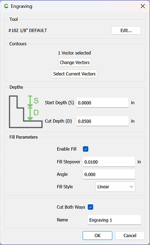

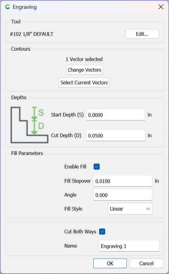

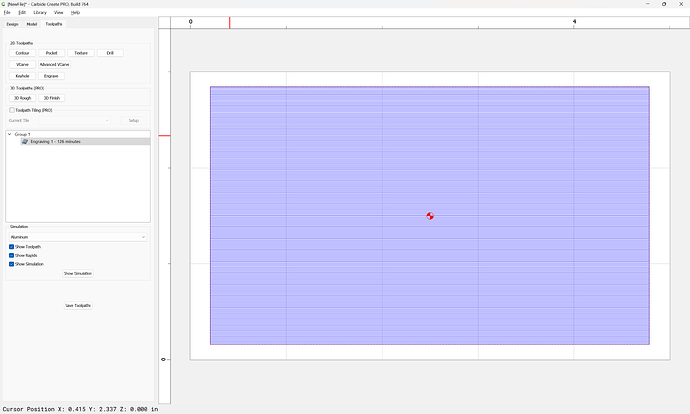

Some folks use the Engraving toolpath:
for this purpose.

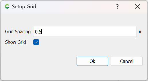

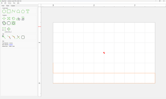

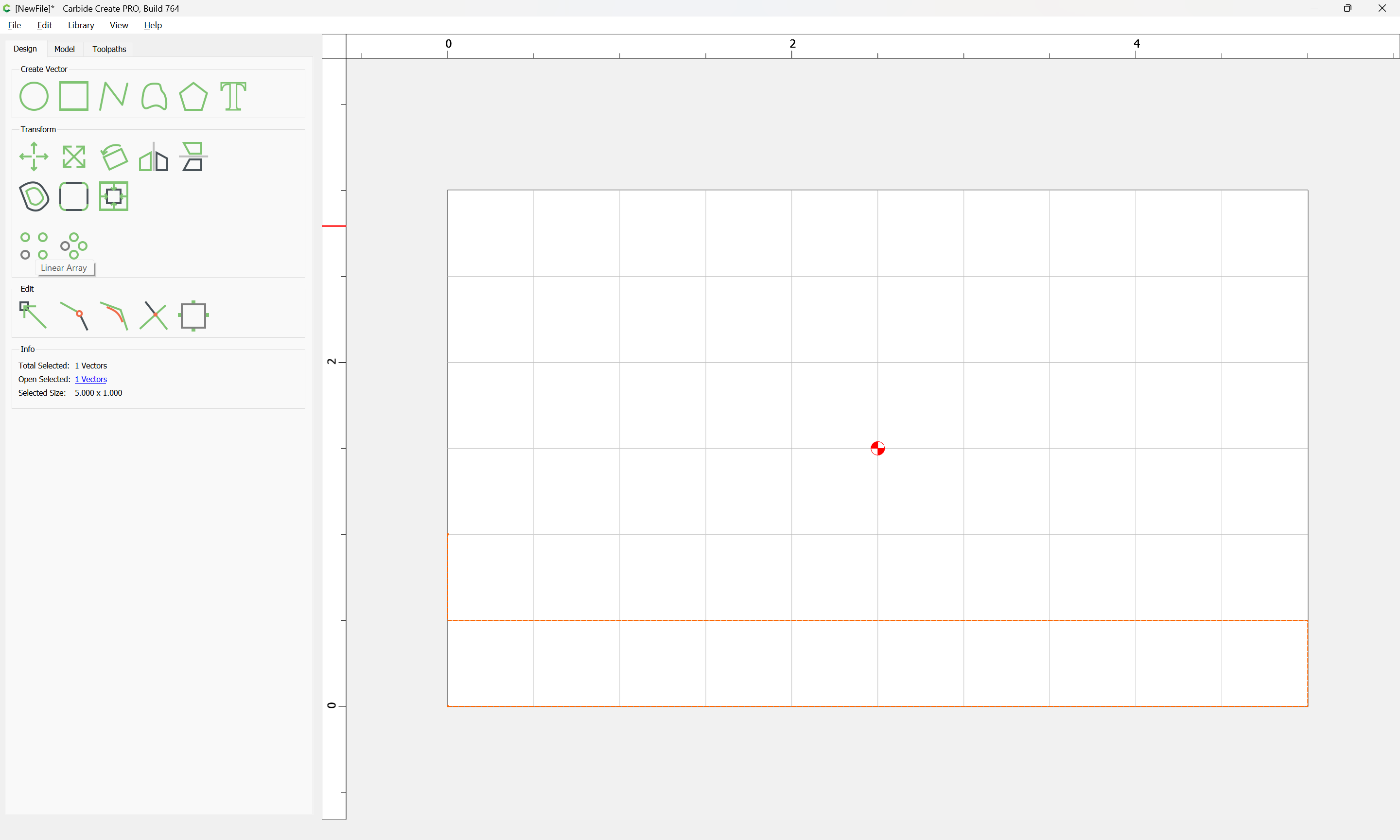

Most folks just set the grid to the desired stepover:

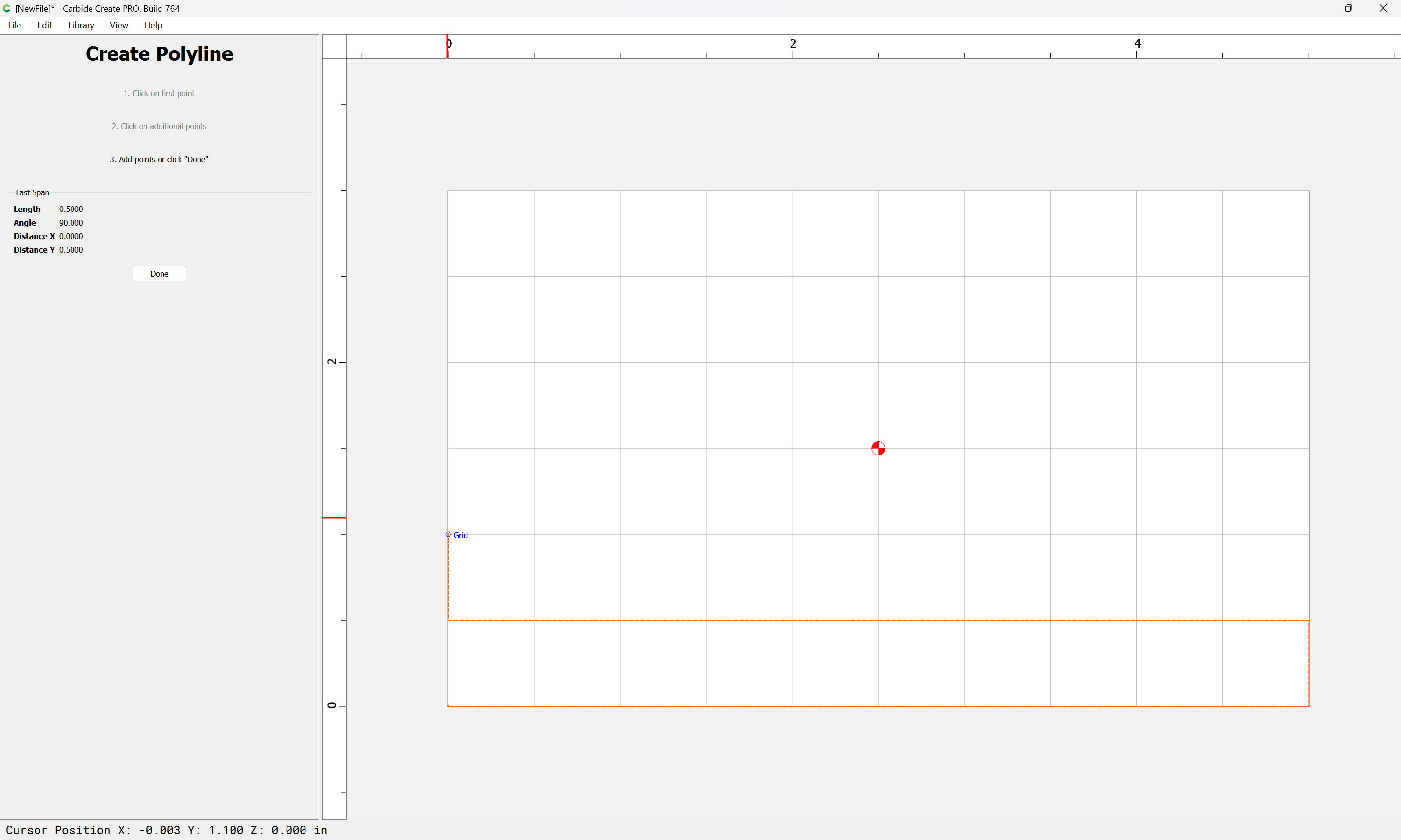

and then draw a suitable pair of passes:

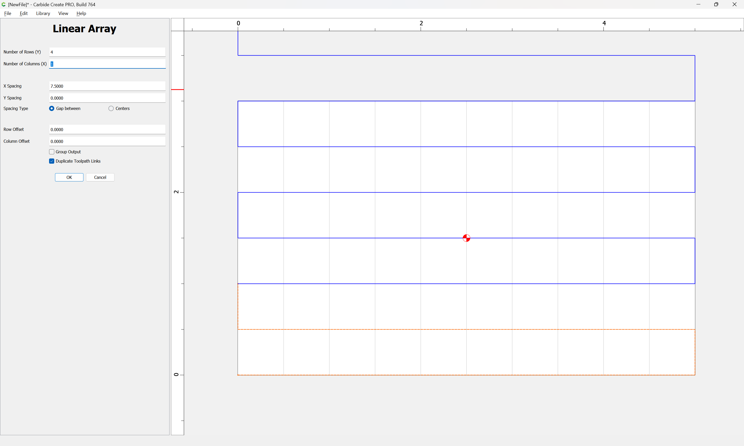

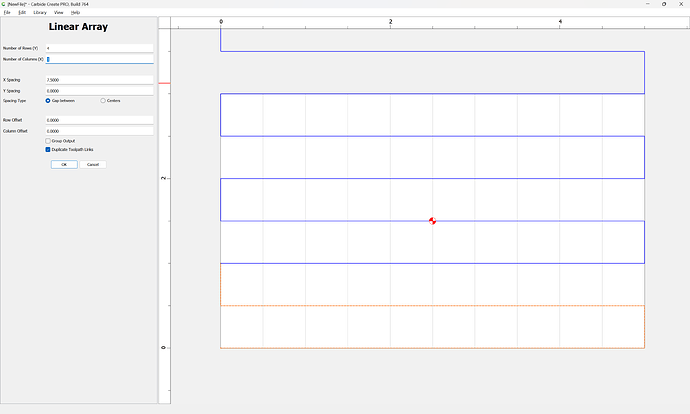

and then user Linear Array to duplicate as needed:

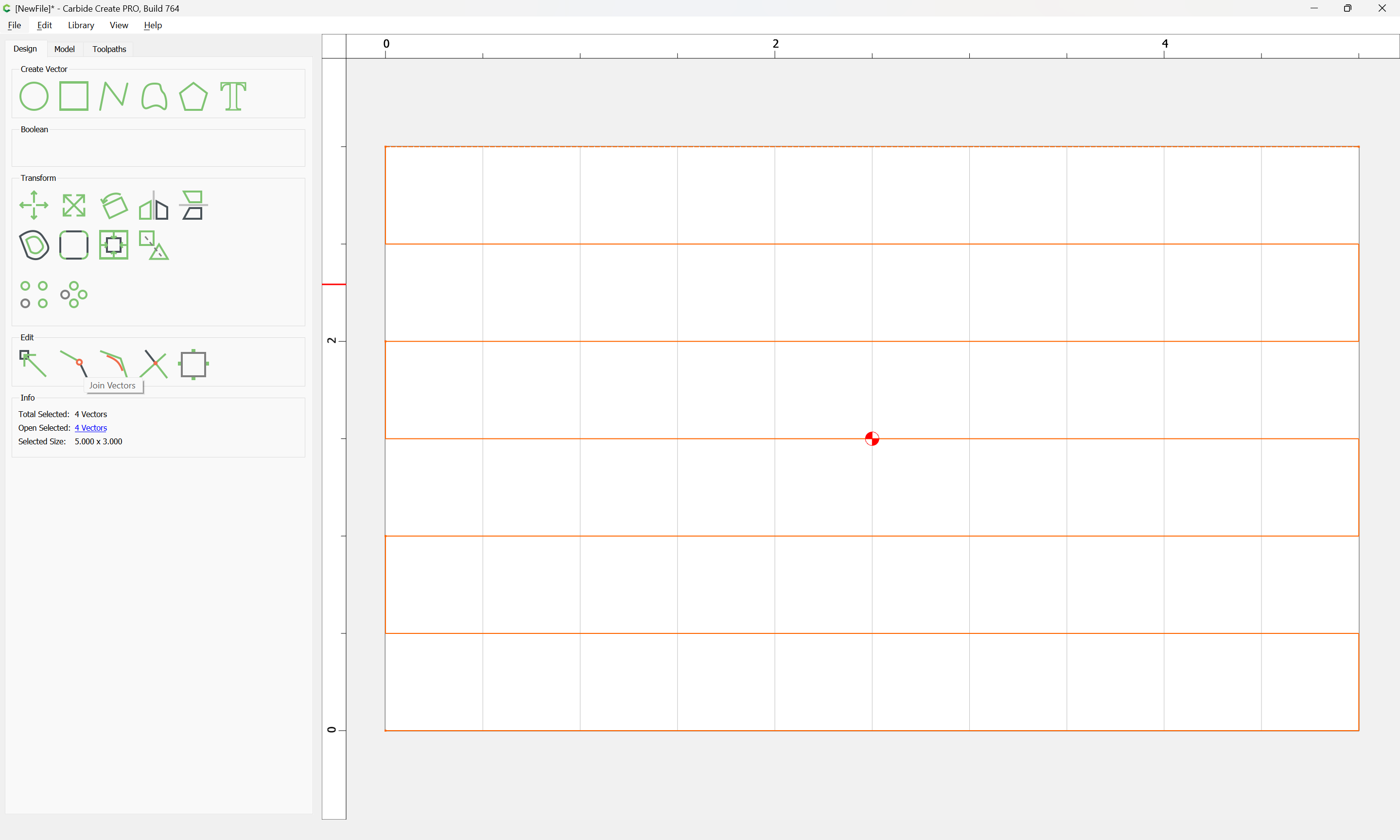

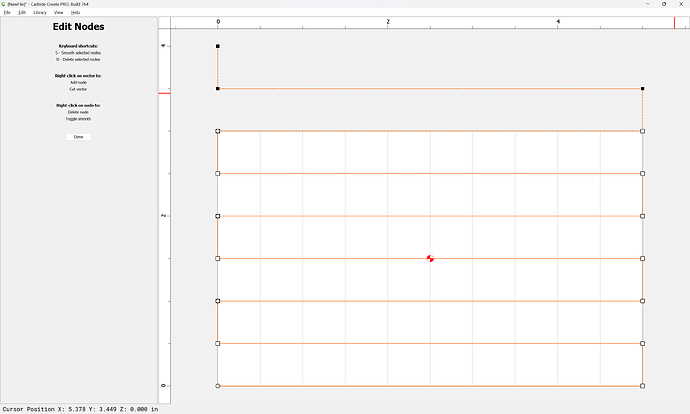

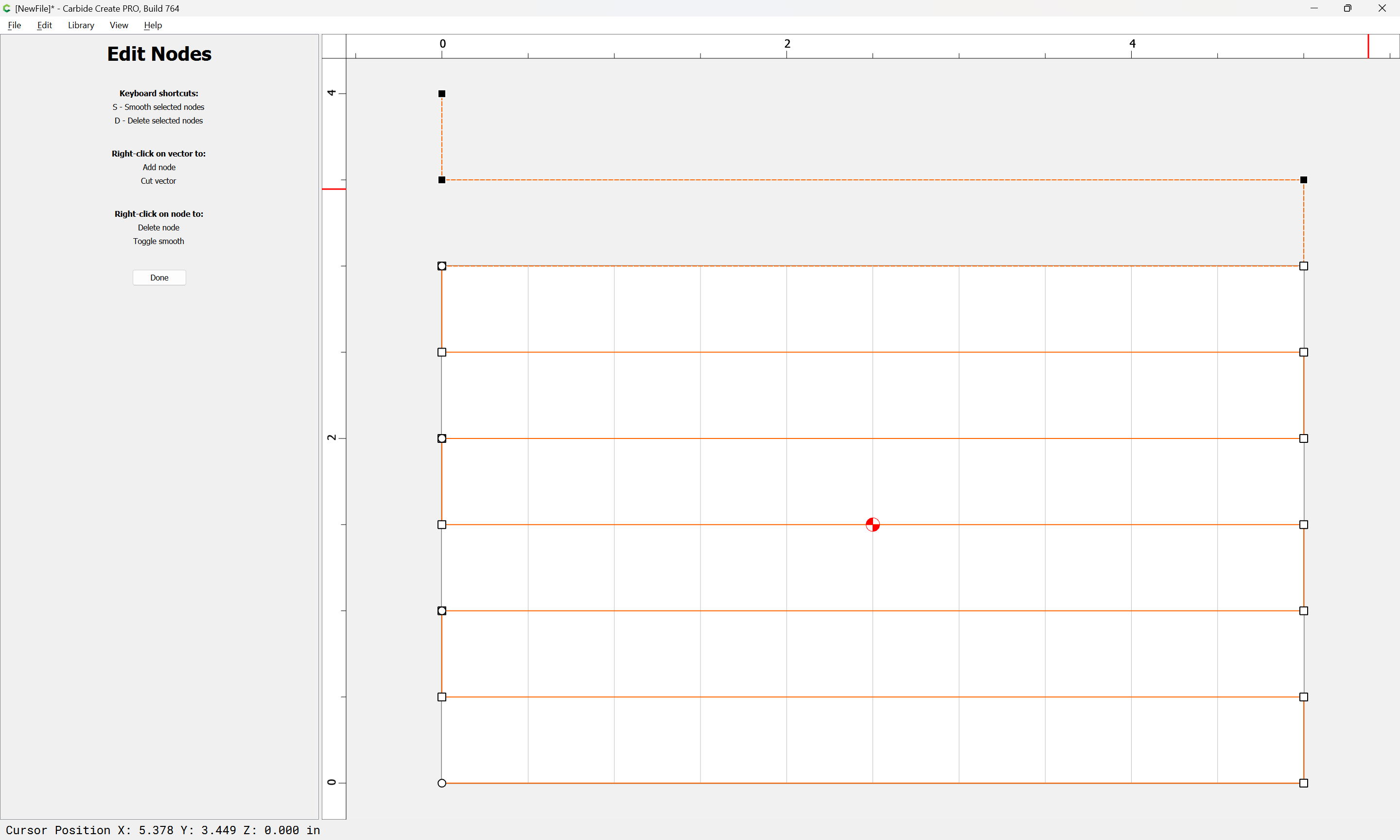

delete what is not needed:

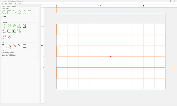

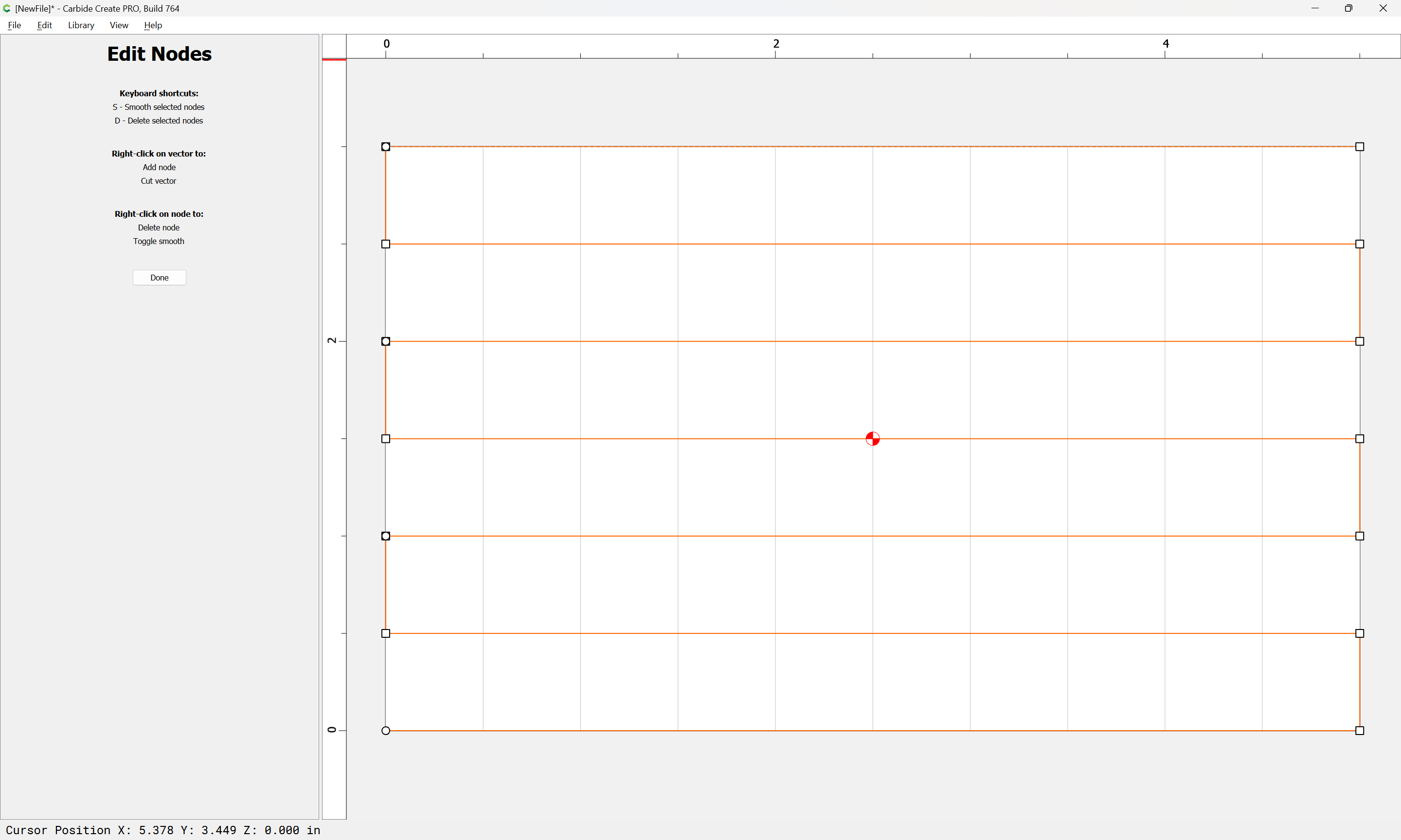

using Node Edit:

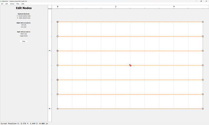

Done

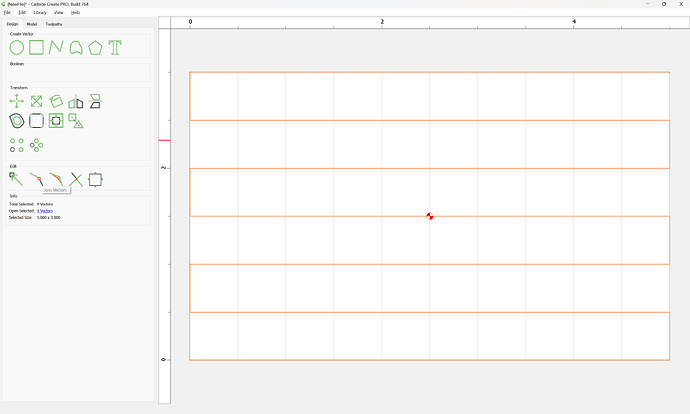

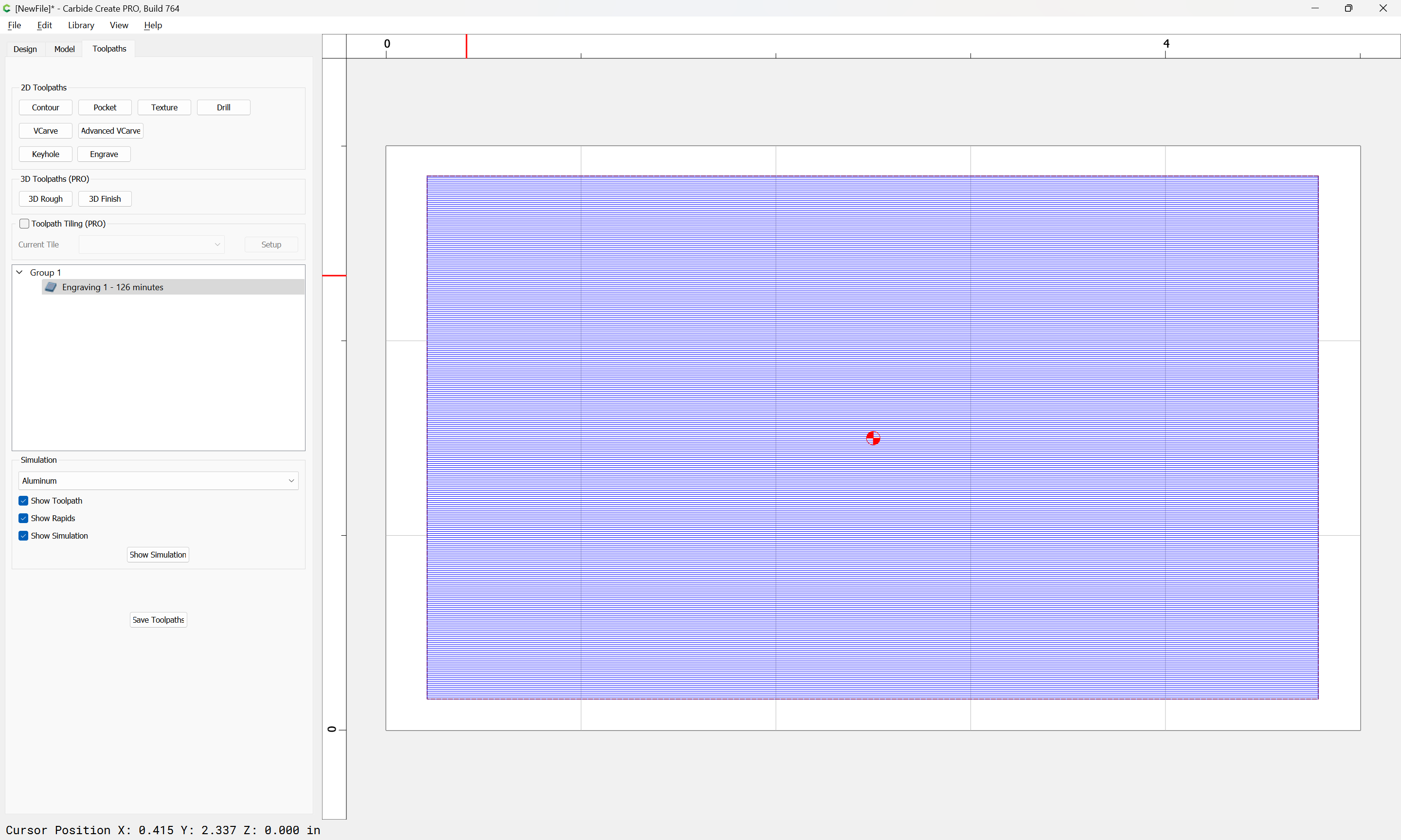

Join Vectors to get a single path which a toolpath may then be assigned to.
Sometimes I use the 3D finish in CC Pro just to create a rasterized tool path which is 90 degrees to the direction of the grain of the wood I have setup in the machine. Have to remember that the 3D finish only makes a single pass at whatever depth the model you create comes up to.
