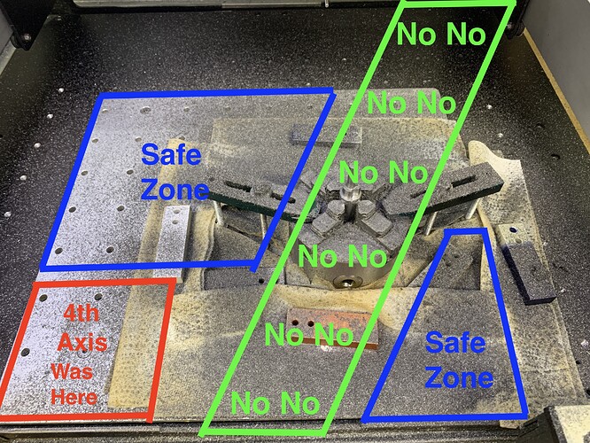

Not yet, but it hasn’t been used much since the part that I have been running for the last week is just a little too tall (so it doesn’t fit under the Z). Meaning I can’t let the machine do it’s crazy rapid move to the front center without crashing into my part. Grrrrrr. I wish I could decide WHERE the tool change position was located.
Roughing out five mini crankshafts out of O1 Tool Steel: (So messy)
EDIT (ADD) Yes I know that the Tool Length Sensor is going to rapid to the Front Center, but as a new user, I just plain forgot to setup my part in the New Safe Zone. My Bad.
This would be better. Move Y first, THEN X
CM’s fixed method / points has pissed me off many times and that’s one of them. I have to really think about the damn machine’s behavior more than anything else before I do anything. It isn’t always possible to make everything low-profile, and there’s no way out of it once you discover an interference.
I agree this is a significant “but why?” issue. I mentally map my machine’s area into “places I cut stuff” and “places out of bounds”. Having CM respect this would be terrific.
