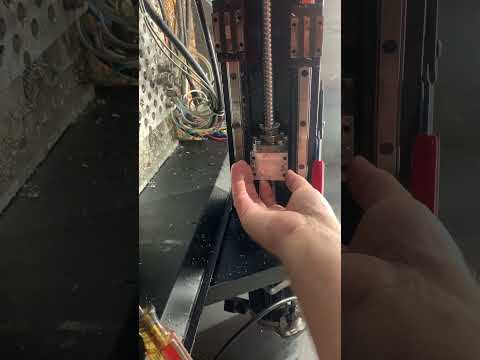

Hey Matt do you think a grease nipple could be added to the port and it be accessible with the Z axis installed if there were an access hole drilled somewhere?
I can’t make out where the port is on the video.
I don’t see a port on my ball nuts to put oil in.
Is it under the ball nut mount?
it looks like there is a threaded hole on the round section of the flange that should have a grub screw where you can fill it with a syringe.

This was the ticket, thanks Able
glad it helped clear the debris from the bearing. Is there enough room for a grease fitting to be installed and used so a tubing setup could be installed to remotely oil the bearings like the Dmc 2 uses?
