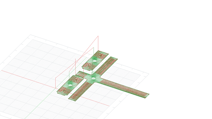

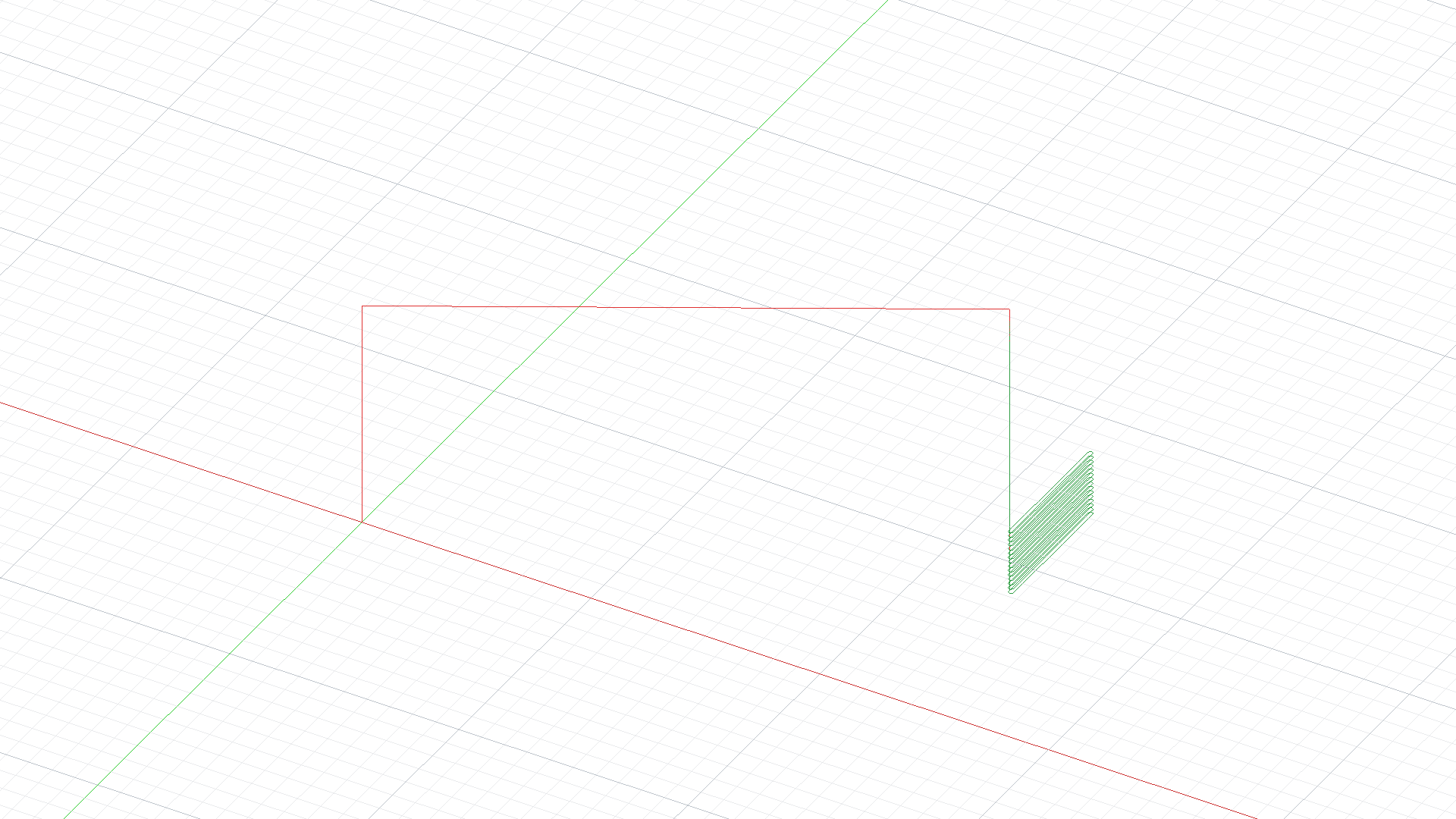

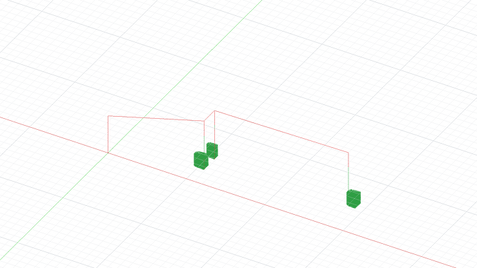

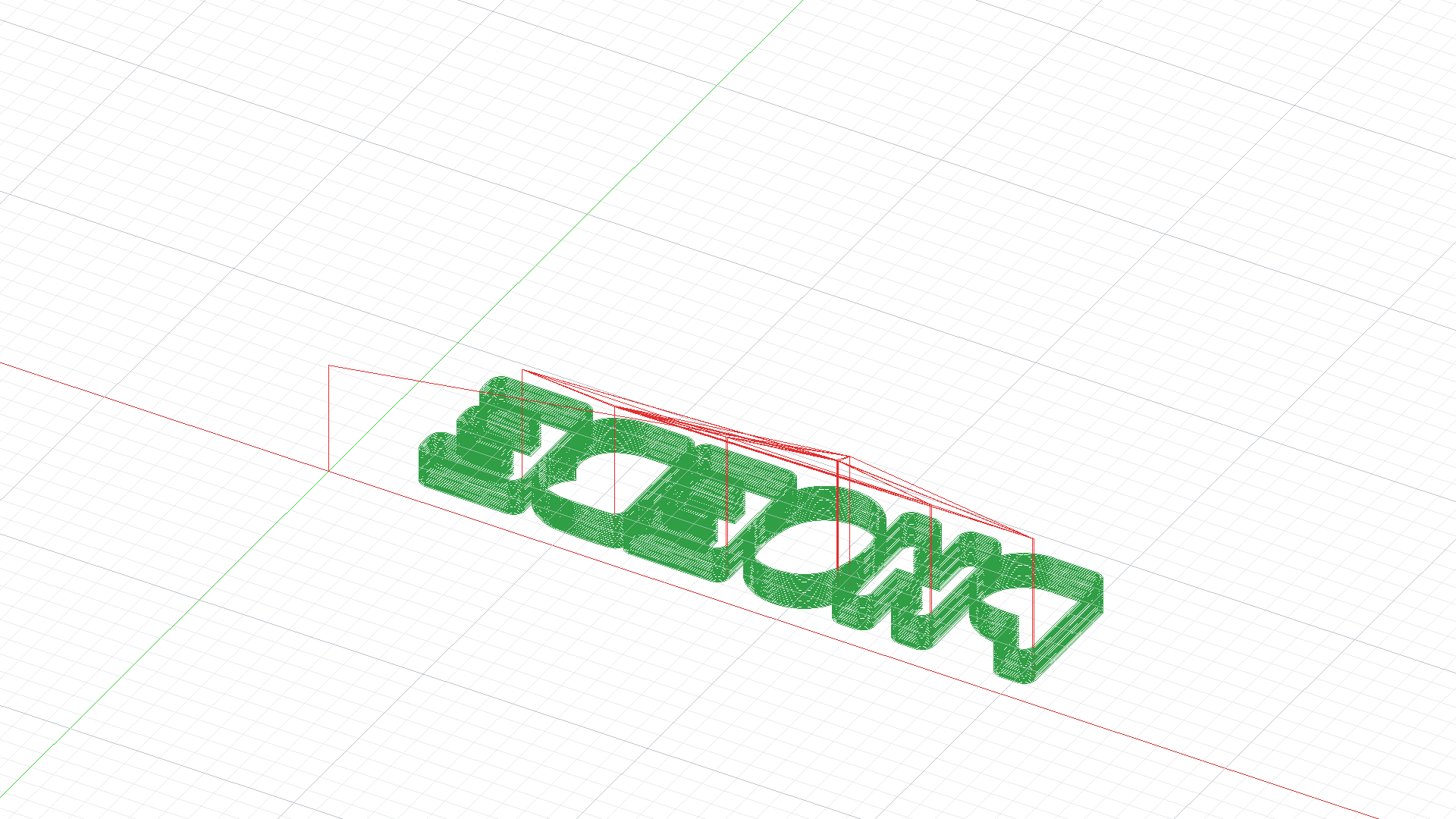

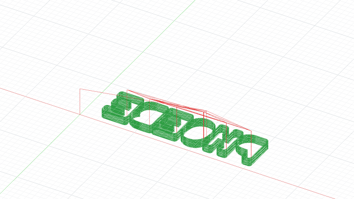

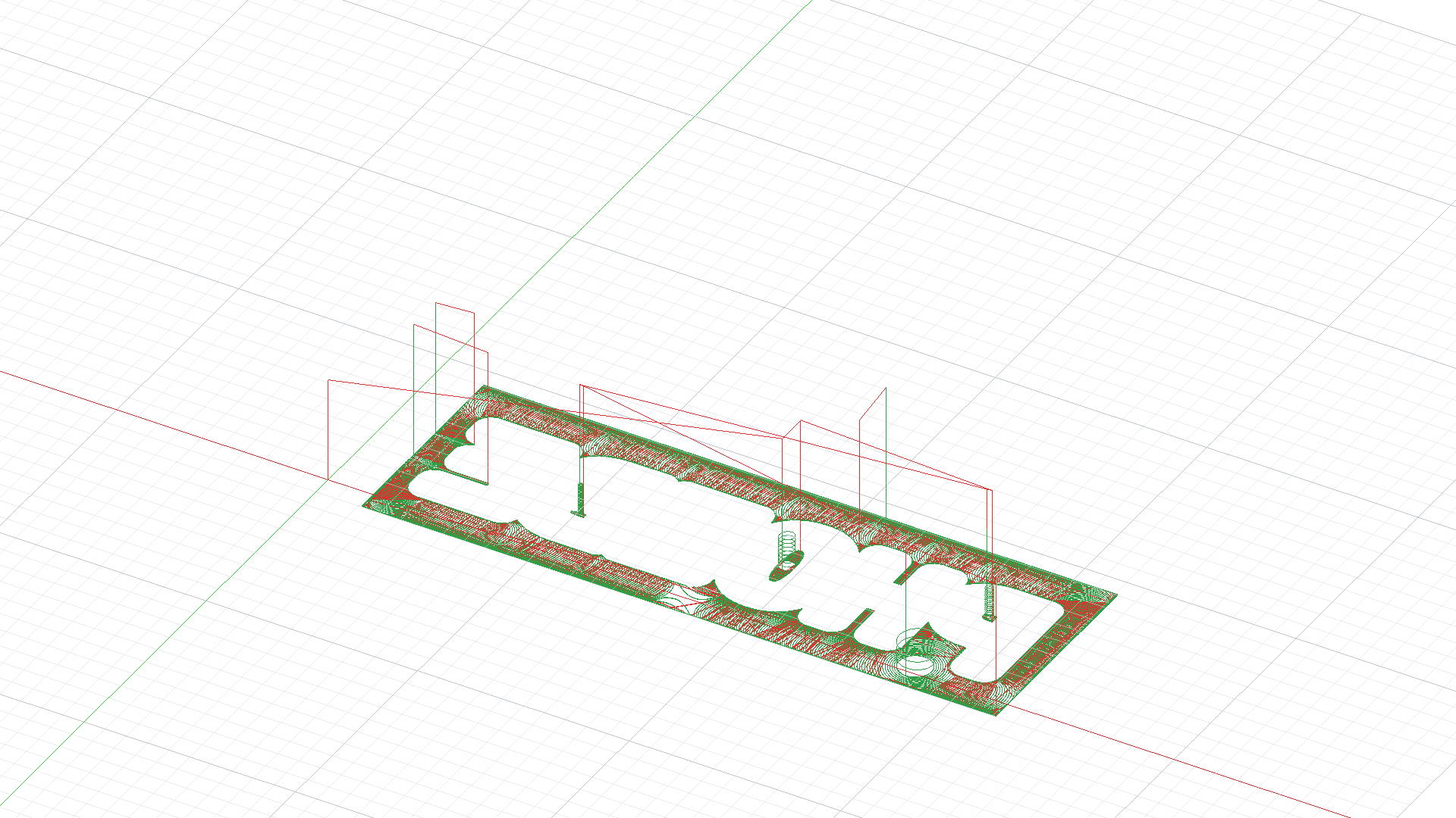

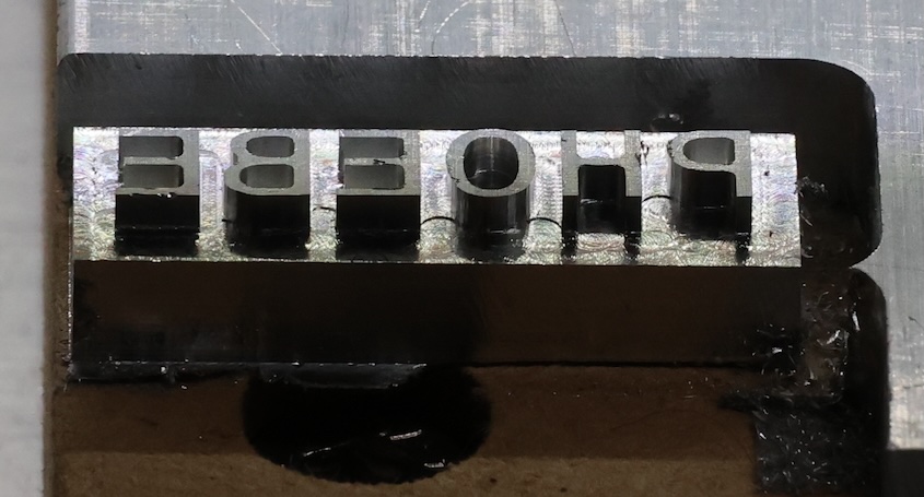

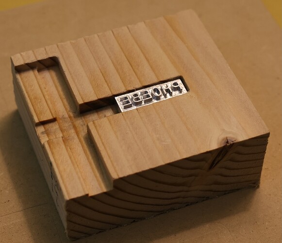

I made a dog toy “branding iron” out of 6061 aluminum.
This is a two part design
iron (aluminum)
base (wood)
Several 1/32" end mills broke during this effort as I iterated on toolpaths and speeds. Ultimately, a forum post encouraged me to .1mm DoC and 12ipm. F&S for the other endmills provided by CarbideCreate.
Toolpaths
Iron
Adaptive Clearing, 1/16" Single Flute ZrN
Letters Profile, 1/32" 2-Flute Uncoated
Letters Pocket, 1/32" 2-Flute Uncoated
Side Pocket, 1/16" Single Flute ZrN
Cutout, 1/8" 2-Flute ZrN

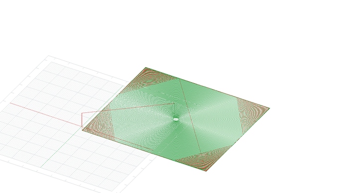

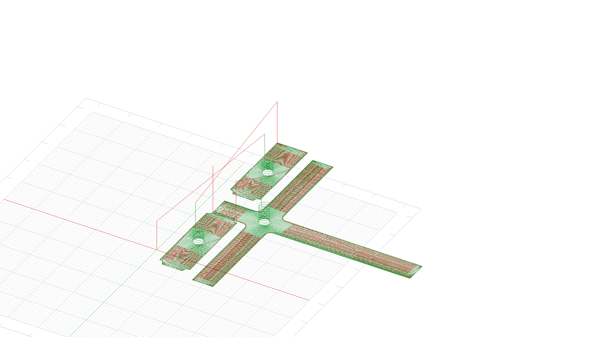

Base
Adaptive clearing, Facing, 1/8" 2-Flute Uncoated
Adaptive clearing, Channel, 1/8" 2-Flute Uncoated

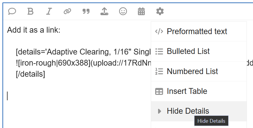

Cool project, but I’m just as impressed with the collapsible sections in the post. I didn’t know Discourse had that. Well done on both counts!
WillAdams
(William Adams (Carbide 3D))
May 26, 2026, 1:31am
4
Add it as a link:
[details="Summary"]
This text will be hidden
[/details]
using the menu entry:
