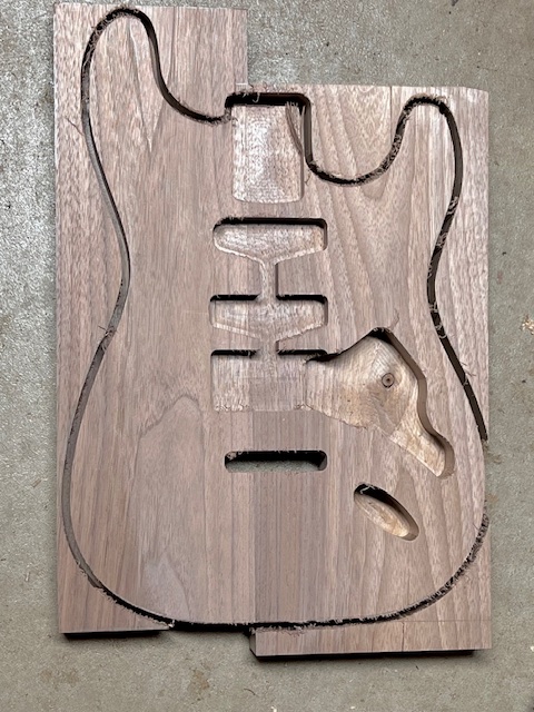

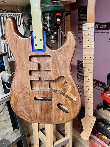

I have made several guitars (Strats and Les Pauls). I cut this one last week from some glued up walnut boards from a tree in my backyard. It will be a little heavier than most of my other guitars but the wood is cool.
I use my CNC to pocket out the holes for the hardware and to cut out the rough shape. Then I use round over bits on my router and a spindle sander to shape the front and back contours. It usually takes me about an hour to shape the guitar before I start sanding and finishing. Honestly, I can get much more complex and interesting contour shapes on the front and back using other power tools than the CNC for the final shaping and can even do the work a little faster. The CNC though is invaluable for the front and rear pockets.
Hi Jim,
That’s awesome — very cool to see a similar build! My buddy got the file online, so it’s cool to compare the process. Really love how your finish came out — that walnut looks sharp. My friend’s in the middle of finishing his right now, but if I can grab some more pics I’ll share them here. Always great to see different takes on the same style!

One trick I use is to cut out the front of the guitar first. Then I drill a small hole in the exact middle of the bridge opening. Then I use that hole as my center zeroing position for my CC file for cutting out the pockets on the back of the guitar. This way, the front and rear pockets line up perfectly and it is easy to center everything.
