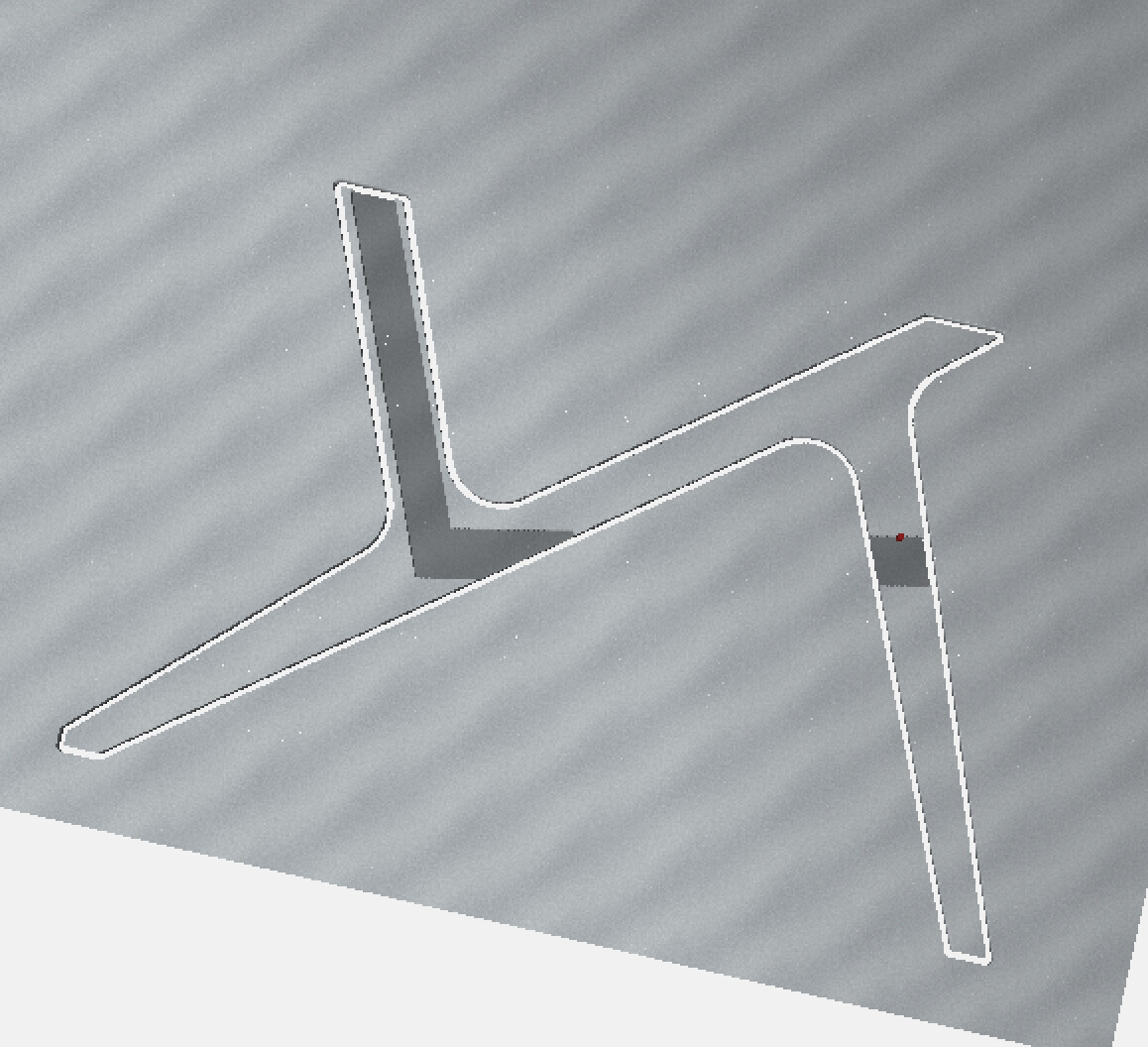

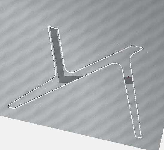

I do not have problems, would like to avoid some. Intend to make Kevin’s middle century armchair. So far I designed the side piece:
the round dowels holes are just for alignment, the pieces should be 2" thick so I will make them from 1" stock and glue them together. I have a Shapeoko pro XXL with the smaller spindle, max 1/4inch bit.
Worked well with these ones:
Still was some -not much- “manual” work.
Now with Kevin’s armchair I have to decide how to get the seat and the backrest attached. And I have some pounds to put in there, should be sturdy…

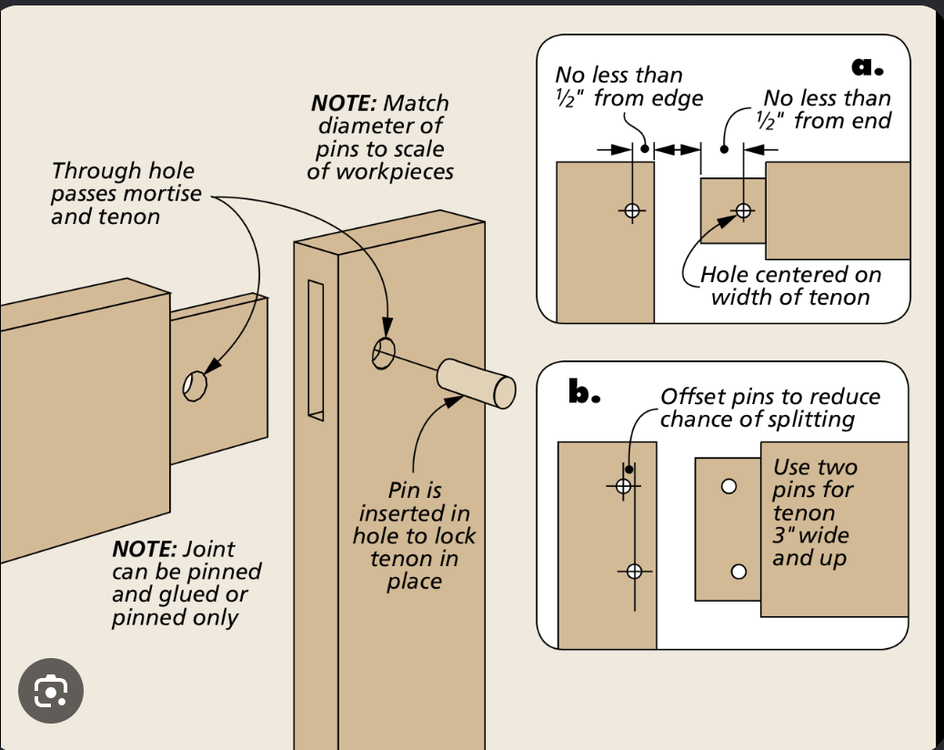

Great information on older joints/pieces. Just wanted to add two things:
  1. Historically, when glues weren’t as good as today, M&T joints were often pinned - a very small dowel inserted into slightly offset holes bored into the faces of the mortise and tenon:
