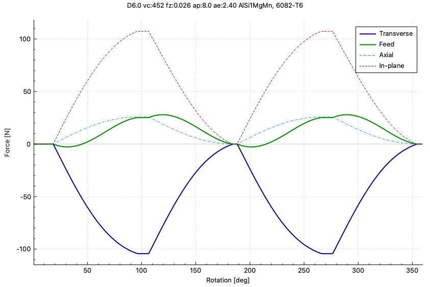

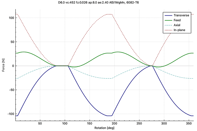

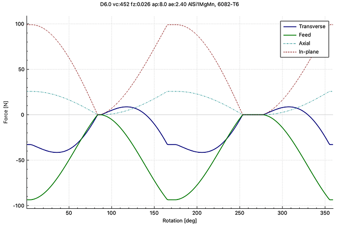

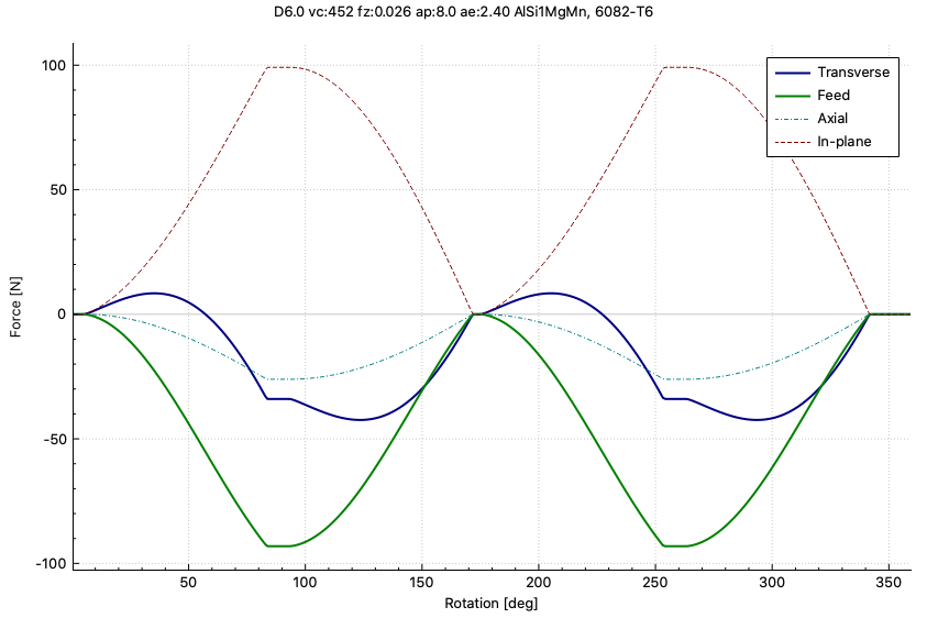

@Julien is entirely correct: Upcut/downcut and climb/conventional are independent. The downcut endmill just has the spiral leaning “forward” instead of “backward”, which has no bearing on the mechanics of climb vs. conventional.
In terms of forces, the only difference between upcut and downcut is that the axial force changes sign: Normal (upcut) tools are pulled down (Fz < 0), downcut tools are pushed up into the collet (Fz > 0).
Forces downcut climb:
Forces downcut conventional:
Forces upcut climb:
Forces upcut conventional:
