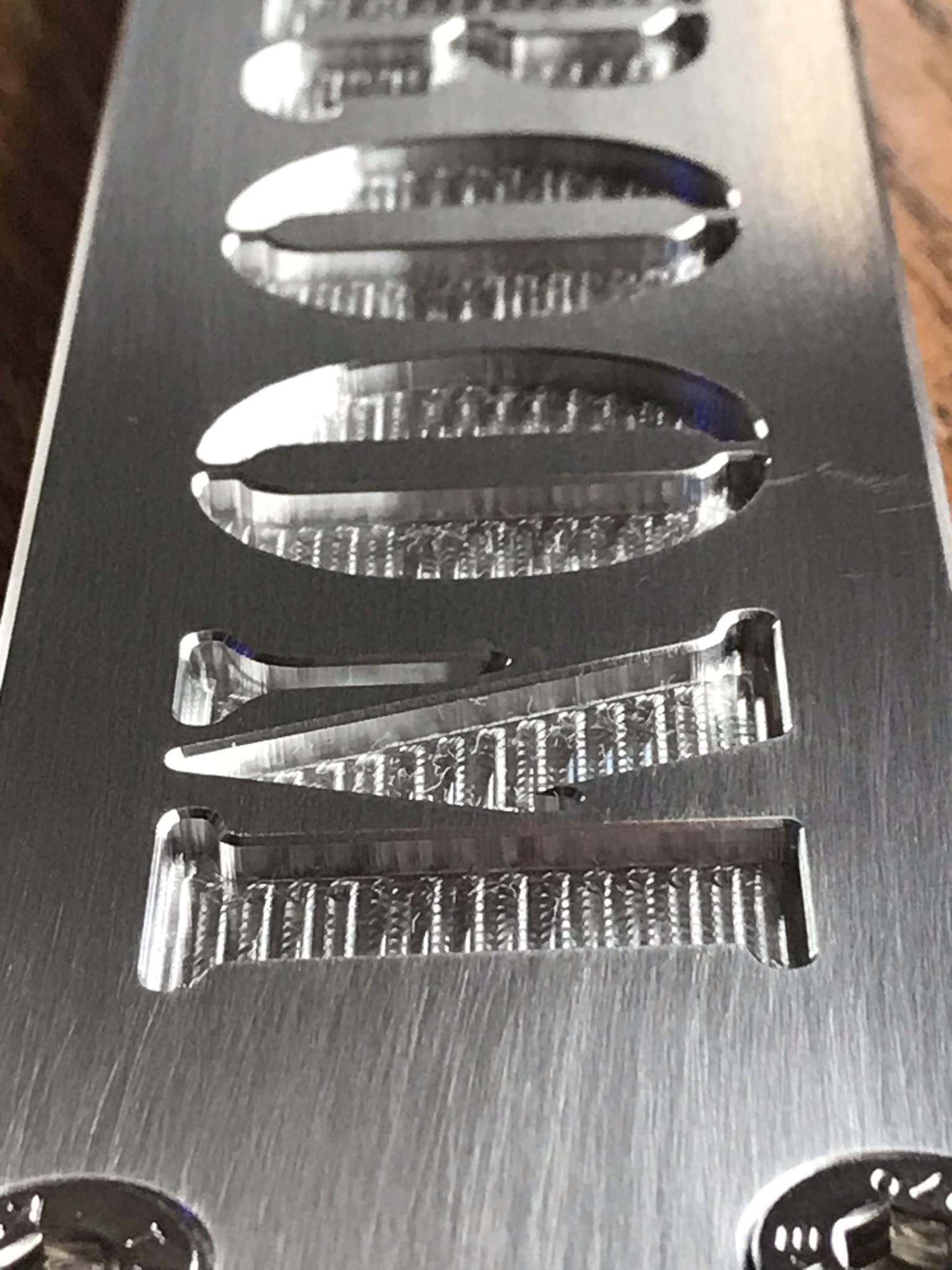

Here’s some Aluminium with a 0.25mm 45 deg chamfer run around the top of the cutout profile.
