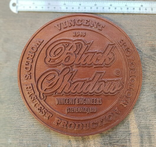

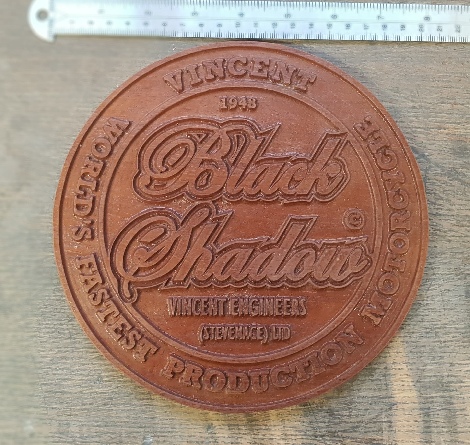

I have made hundreds of patterns out of wood for casting, mostly aluminium and brass.
When I was using CC I used Advanced v-carve with either a 1/8" or 1/6" end mill followed by a 60 degree v-bit to get the draft angle. I now use Vectric V Carve Pro and do essentially the same procedure but occasionally use a tapered ball nose to get the draft angle, it all depends on how detailed the design is.
The pattern below was cut using CC and advance v-carve.

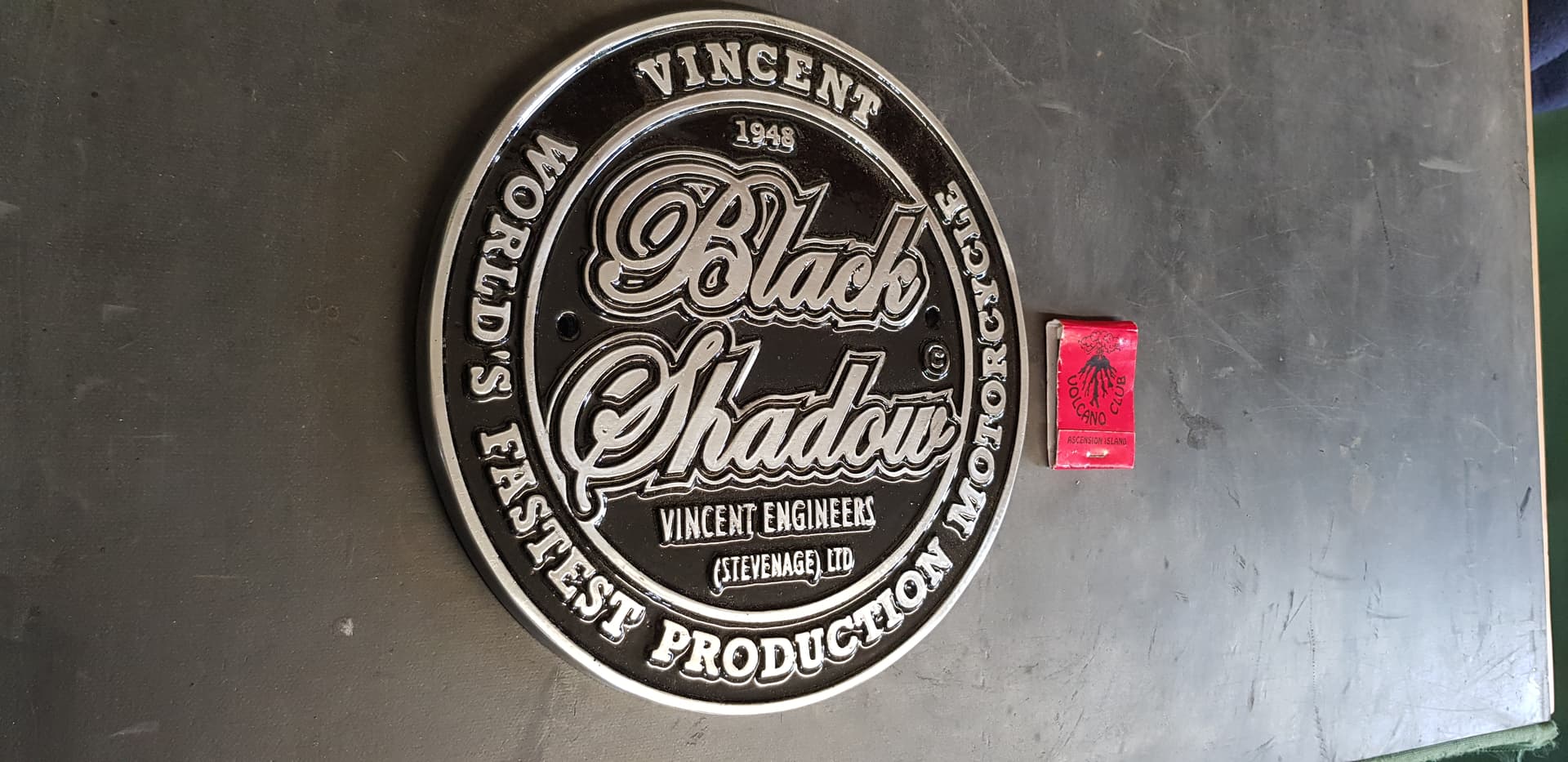

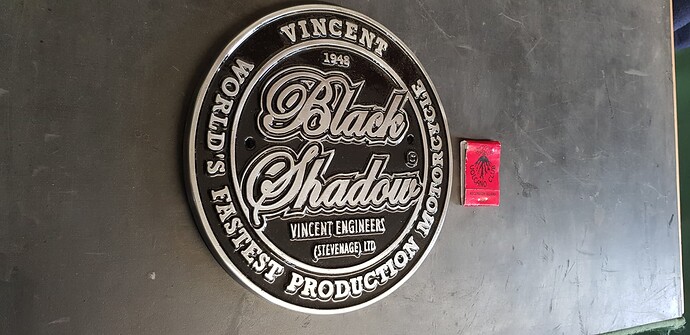

And the finished item in aluminium.
