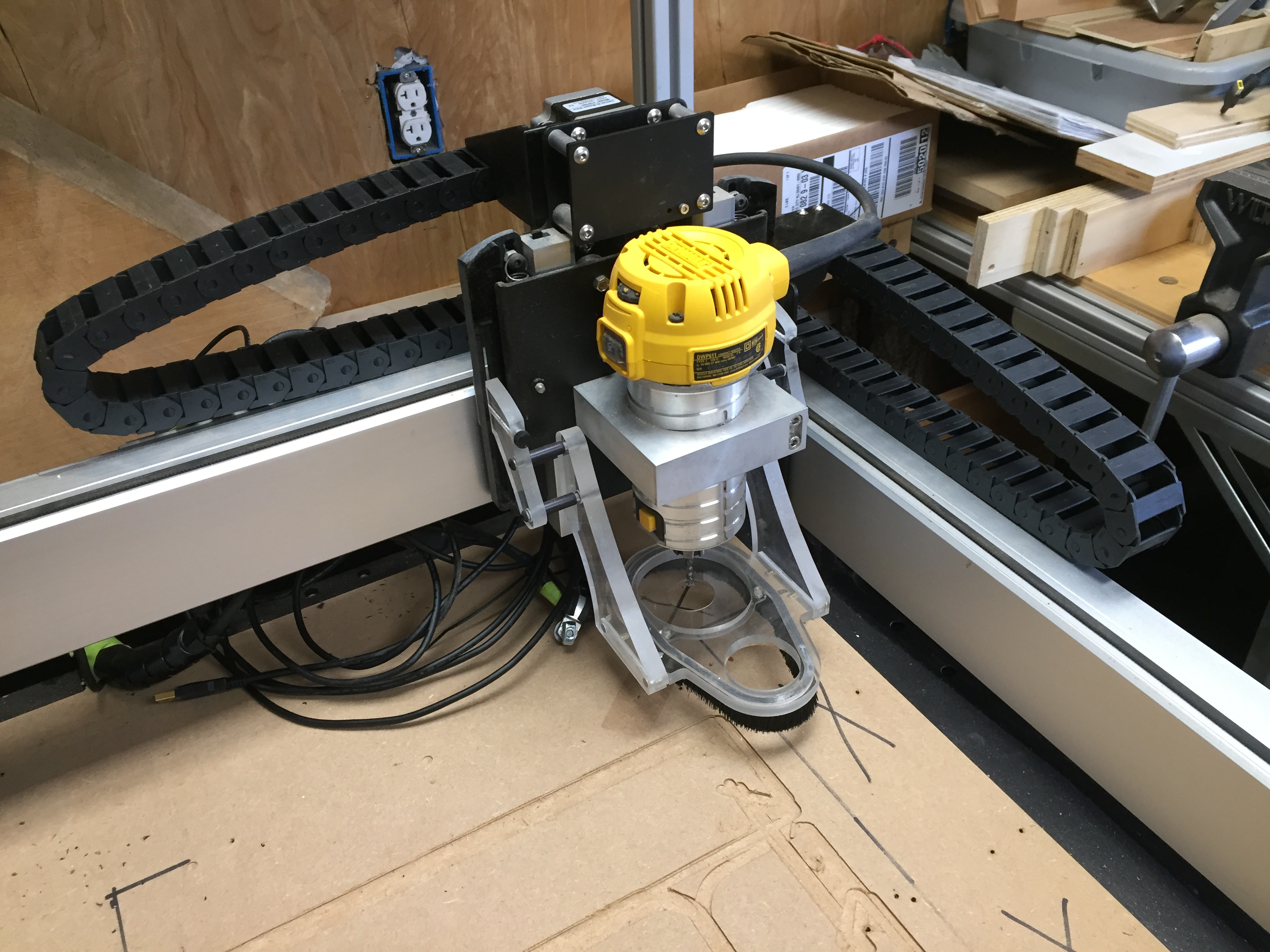

I designed and printed these for my SO3. and they work great. I did change them out for silver ones, and they have been working fine for 2+ years.
Here are the files in a few different formats. I can’t double-check the link because I am at work and Google Drive is blocked.
EDIT: Checked the link with my phone - it works.
These brackets fit the 15x30mm drag chain (P/N 30331-01) sold by Inventables.com
Those are really smart, although I can’t use them
I made my enclosure to git the machine + 1cm either side I can only get away with running them slightly over the edge of the Y. As you can just see in the pic it’s tight in there. Unfortunately I don’t have the same X as you.
Cracking design. Out of curiosity, I see you have opening drag chains and you mention your machine is over 2 years old, I take it that was an upgrade you did?
Thanks! Actually, my machine did not come with any drag chain. I did the pre-order (#0054) and ended up waiting ~7-8 months for it to ship. I had a lot of free time on my hands (while laid off) so I sleeved all of the stepper motor wiring in nylon overbraid and designed the brackets and bought the drag chain to get everything nice and neat. I had to slice some of the rubber off the ferrite bead for the SO3 power cable, but I made it fit.

Hey a big shout-out to @MadHatter for sharing the drag chain brackets. I made up a set while waiting on a repalcement for my controller board and just got both installed this AM. They fit perfectly:
Thank you MadHatter!
Now it’s time to wire up the Super-PID and reroute the cables. The chain I purchased does not pop open to let me lay the cable in, so I’m trying to figure out how to get the route power cord thru. I was going to retain the plug and wire a socket into the S-PID box, so I’m considering putting some sort of low profile disconnect in at the router end. Would welcome any advice on this.
RMW
Richard, glad it worked out for you. For my setup, I diked the power plug off the router and after feeding the cable through the drag chain, I put this plug on it. I put this socket on my SuperPID box (I used this box for my SuperPID, and separated the display from the control board and used these wires to join the display to the control board). I also put a 1/8" headphone extension female plug sticking out and an IEC socket I had so that I can unplug everything from the box and move it around if needed. For funsies, I added 3 lights like this (green, yellow, red) to indicate the status of the setup. I think the green and yellow are 120VAC, and the red is 5V (since I might have tied it to the 5V signal level voltage on the controller board), but it’s been a couple of years since I put it together, so I could be wrong.
Green on means it’s plugged in and has power.
Yellow means the SuperPID power is turned on.
Red means the router is running (or should be running if it is not)
I bought a 3 turn 10K pot to replace the 1 turn pot for more granular speed control, but I have not installed it yet. I’ve only had it for a year, so I guess it’s about time to put it in.
If you are interested, I can post pics of my setup.
@MadHatter thanks for the details. As usual I over-complicated things, lopping of the router plug is just too simple and easy. I do like the idea of the EMI filter power socket, both parts are on their way. Not sure how I ever did anything before Amazon.
I finished up the wiring as far as I could go. Mickey-moused the router and controller power for now. Had to lengthen the limit switch wiring a bit and then wrapped most everything in split loom.
Really works beautifully with the new control board. Fingers crossed that the EMI issue is resolved, I wracked it around a bit turning the router on and off while doing rapids with no issues. I can even turn off the controller power and restart and CM recognizes it, that was never possible before.
