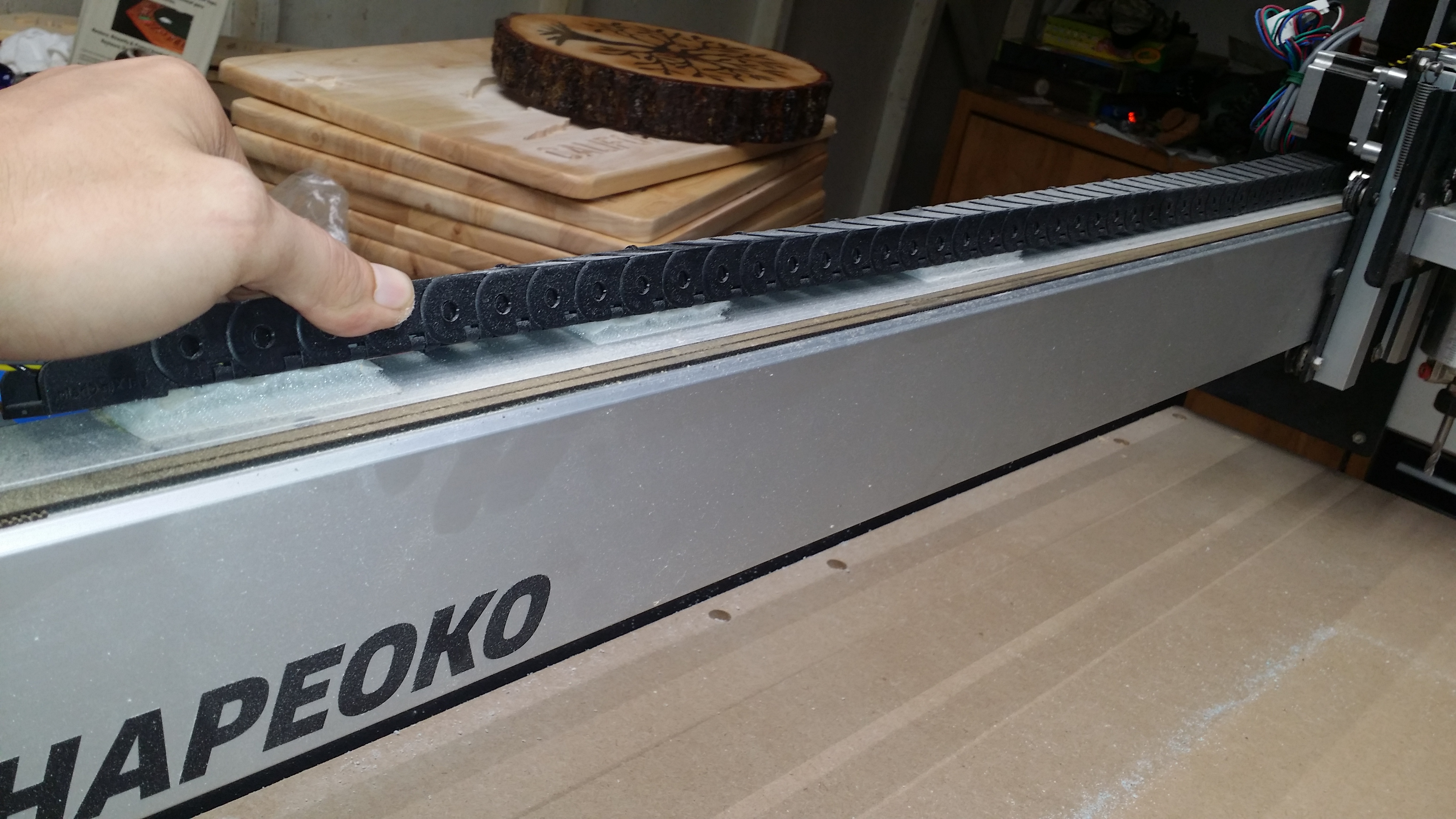

A few 2-3" strips of HD Velcro placed in the right spots works well. Have this setup since assembly, haven’t had any issues. Just make sure you can go all the way to the left with the spindle without binding. Excuse the mess I rushed some work right before surgery and am not allowed to lift anything for another 2 weeks… ugh
As for the X axis I put a strip of the same velcro parellel to the extrusion rail on the controller. This allows the x axis to travel full range without ever binding. Also allows for easy removal when needing access to controller during maintenance or upgrades.

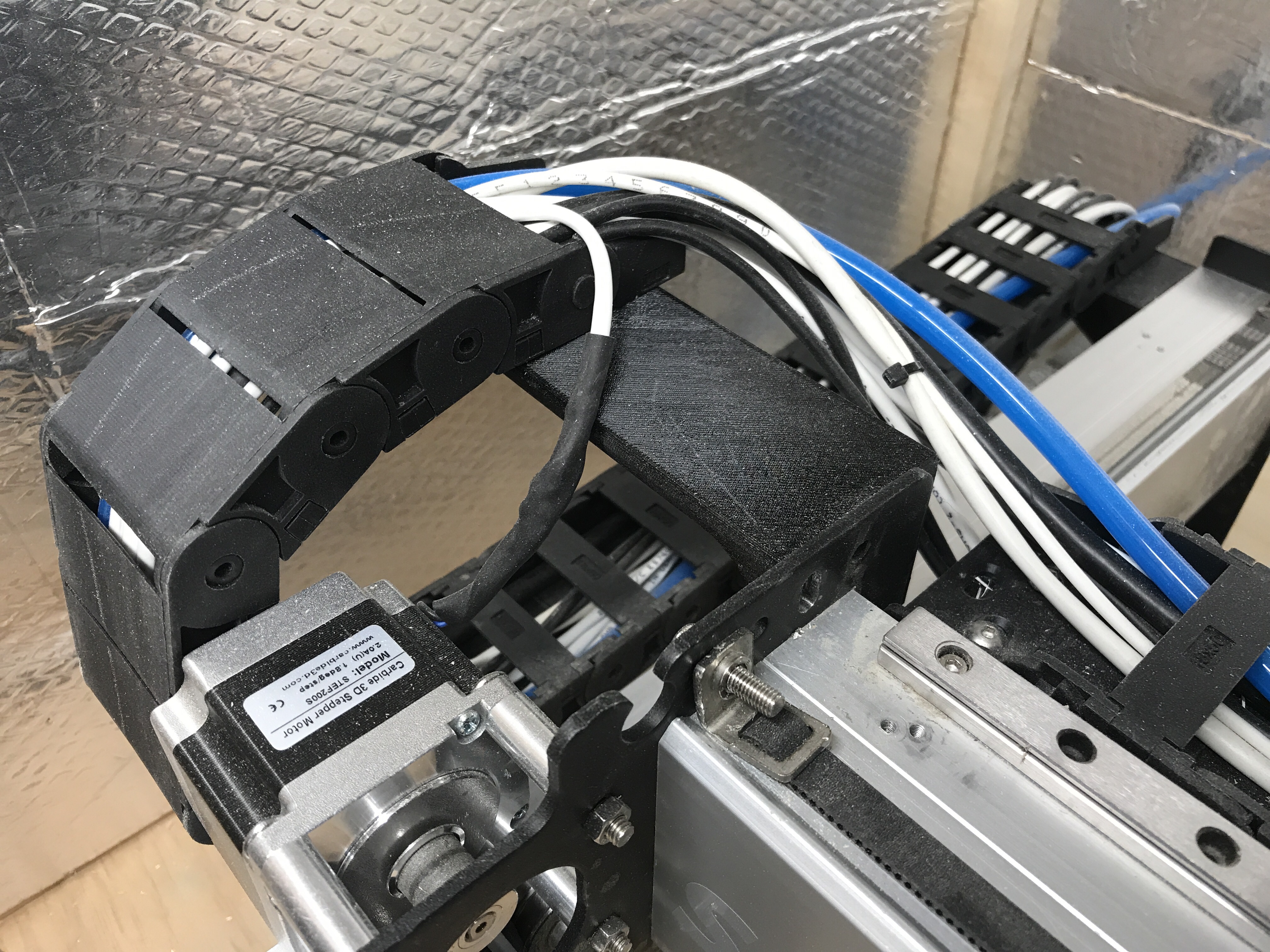

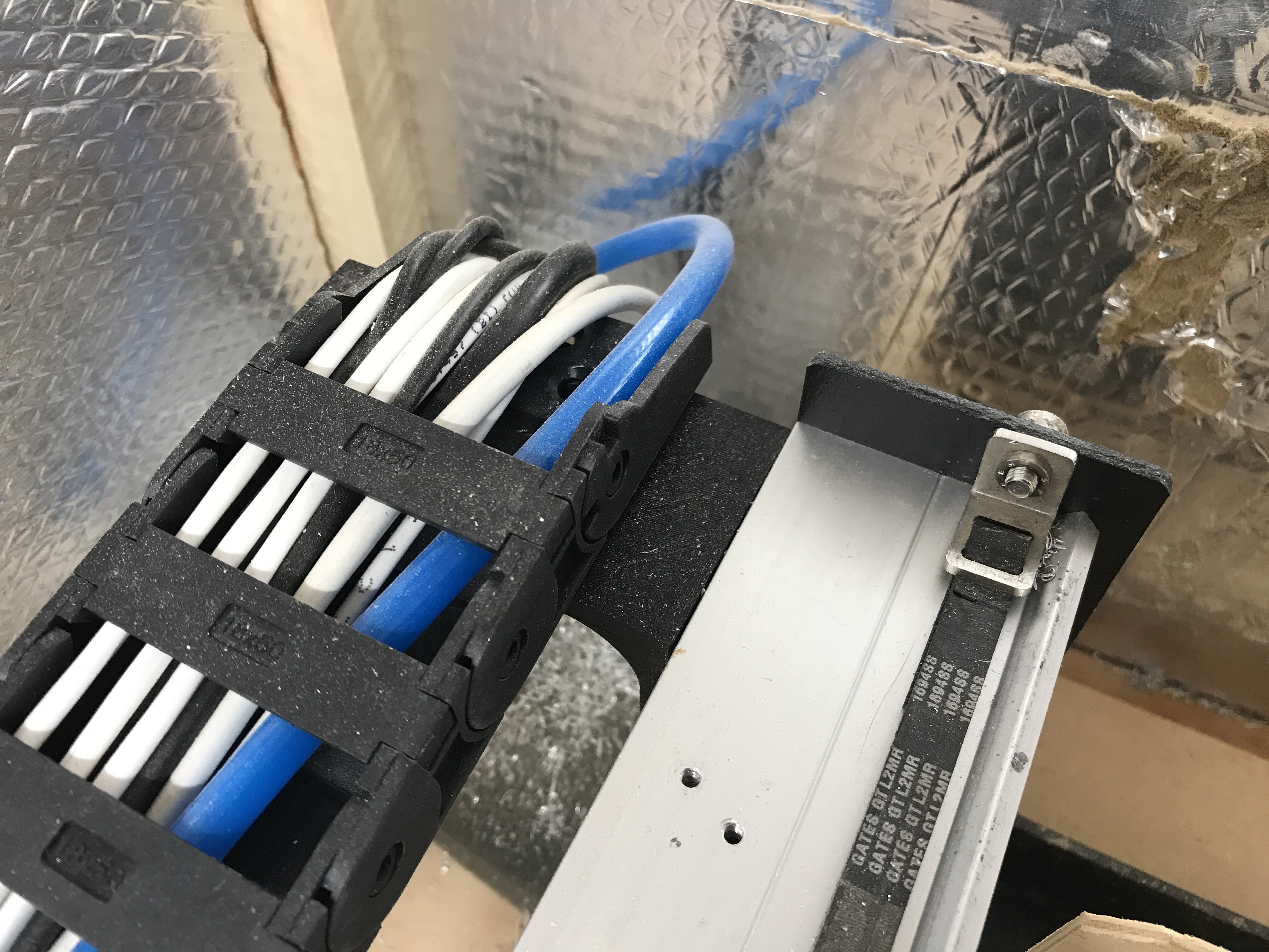

For the X axis - used a bit of aluminum angle from Home Depot with a full length strip of 3M double sided automotive tape. This helped aid the alignment of the link to the Z mount. Then, I bolted the drag chain link to the aluminum angle.
For the Y axis - drilled and tap the Y axis extrusion to mount the end of the drag link chain. Alignment here was great.
The supplied tape has poor retention to the drag chain link, even being meticulous with prepping the surface and compressing the tape to ensure complete adhesion. It’s just a small area of engagement.
I would probably do it again by making a couple large surface area plates of 1/8" aluminum. Drill and tap for M3 countersunk bolts. Then use 3M on the much larger surface area plates to extrusion. This would have a much better chance of holding on.
