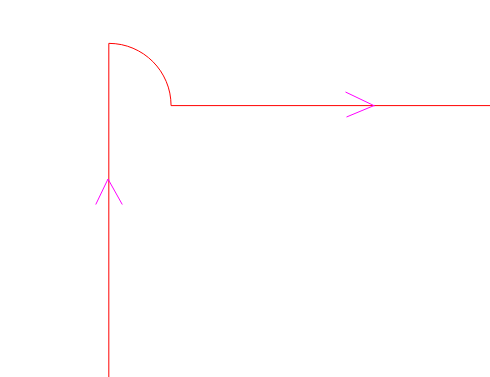

I think the fancier drag knife programs will account for the cutting tip trailing the center of the spindle with a cut something like this to get sharper corners.
Nothing I’ve done so far has been that critical to get perfect corners, and with the smaller tip they are really close.
Interesting, Thanks. I did watch another person’s video and he showed that on tight corners it was pulling the tips up. I am going to do small lettering. And I guess it also depends on what you are cutting.
I also found it interesting that in DXF2Gcode he always orientates the cutter to the right at the end of the cut and then he knows which way the knife is pointing, On the start of the next cut he rotates the knife with a light drag to the correct direction before going to cutting depth. This does start and stop at the same point with no over lap.
