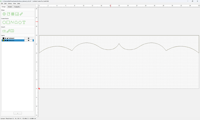

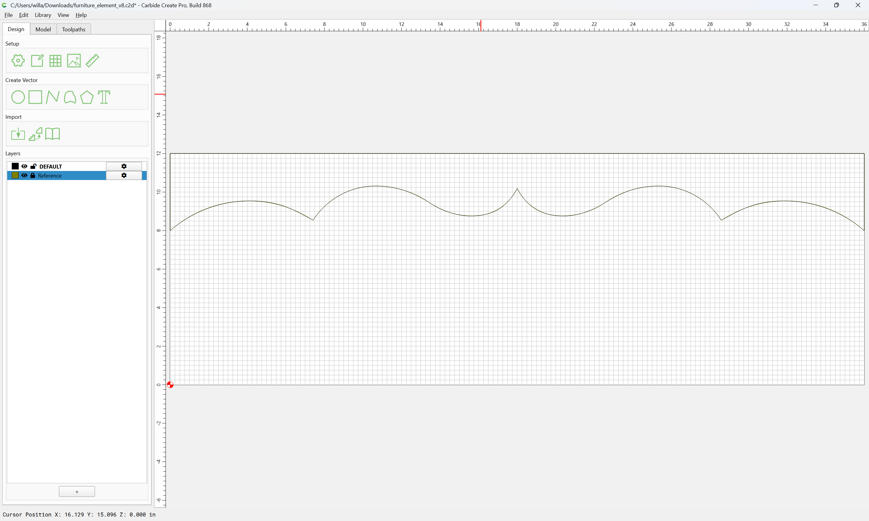

Drawing a decorative furniture element
as requested on support…

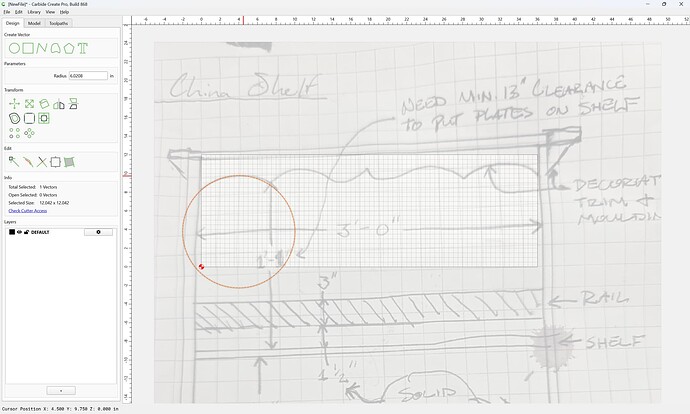

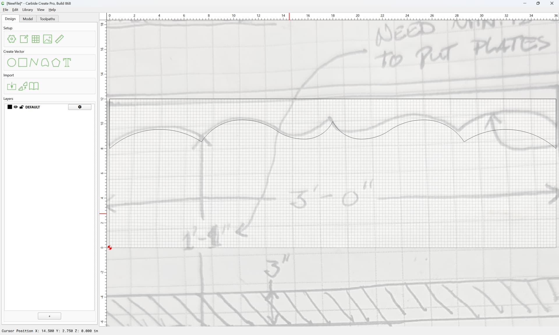

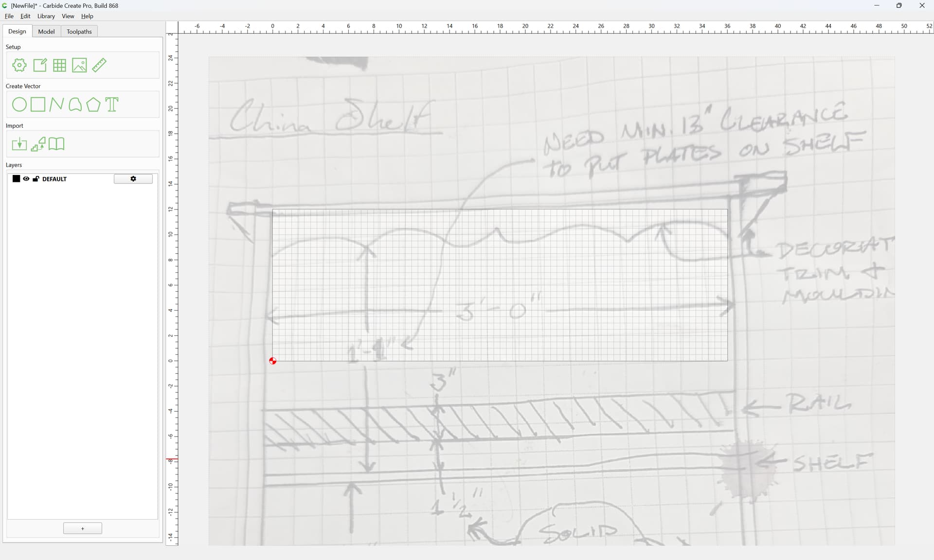

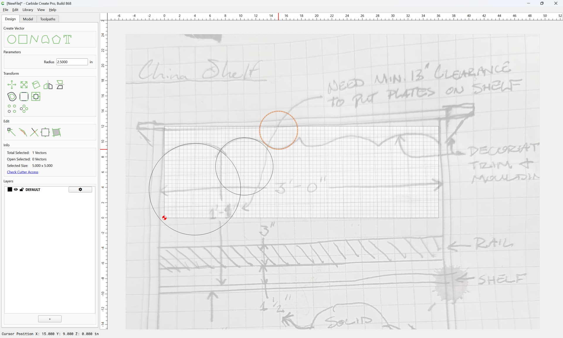

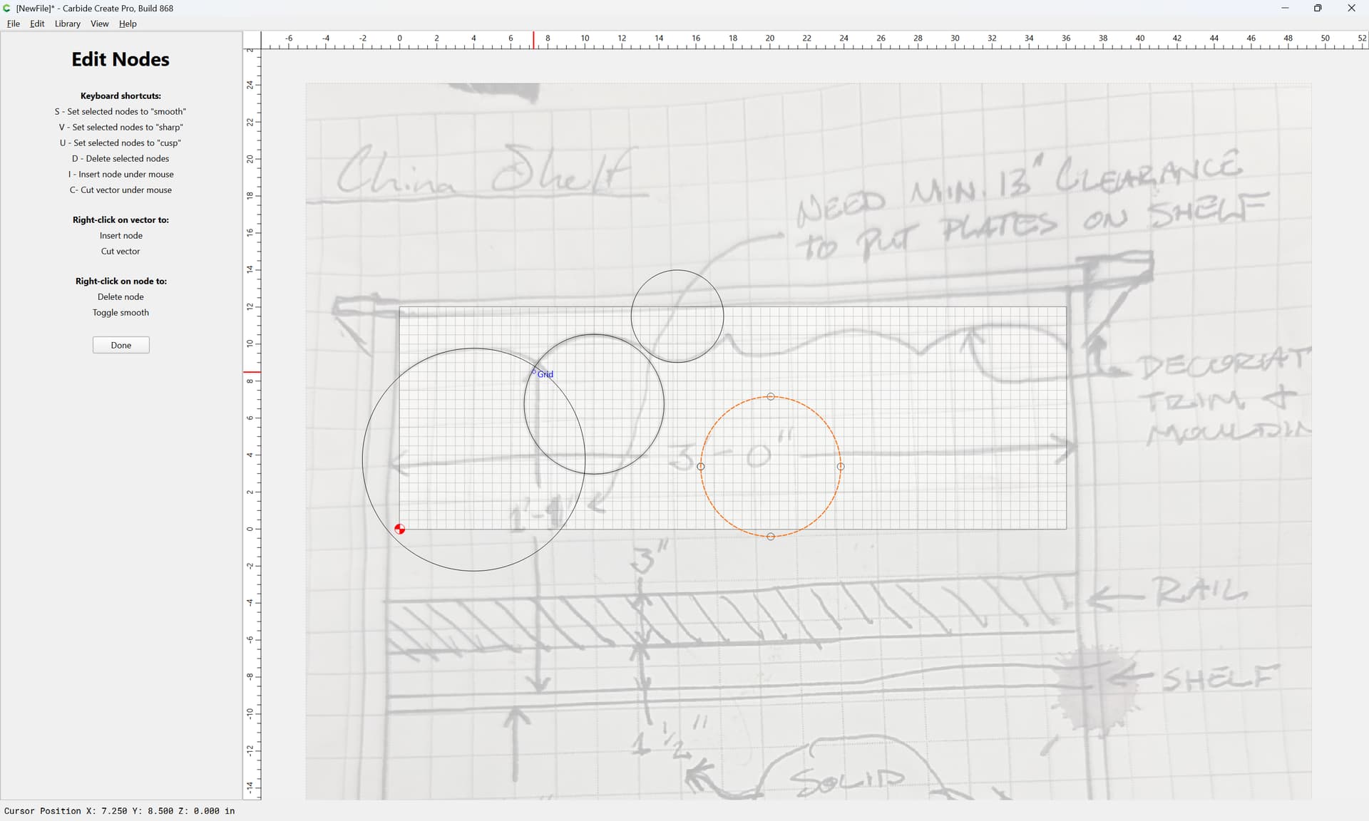

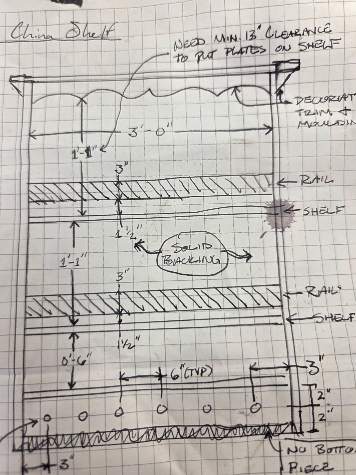

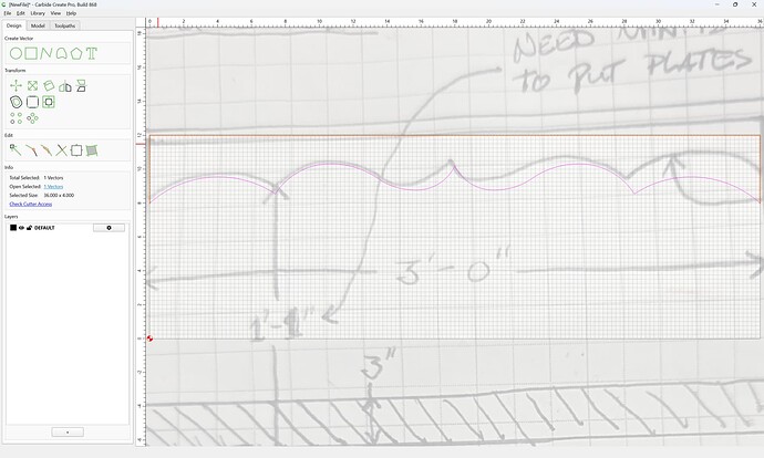

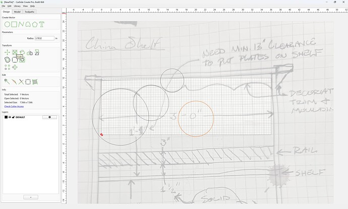

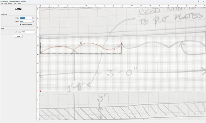

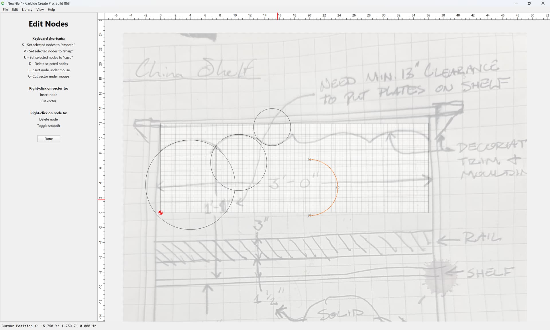

I am trying to design a valance for a kitchen cabinet that has multiple arcs …
where the design is:

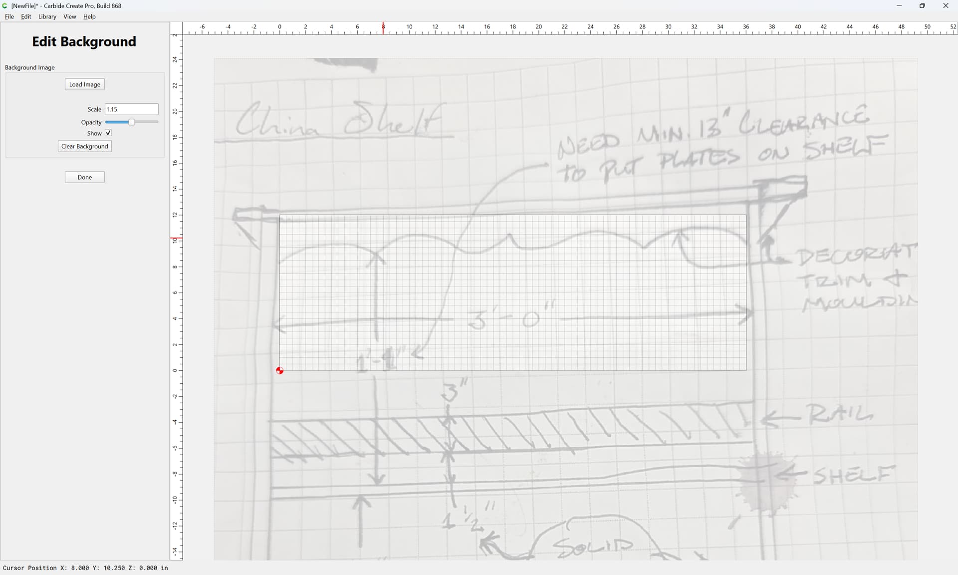

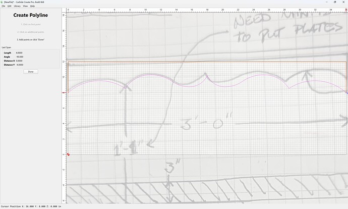

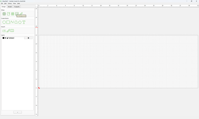

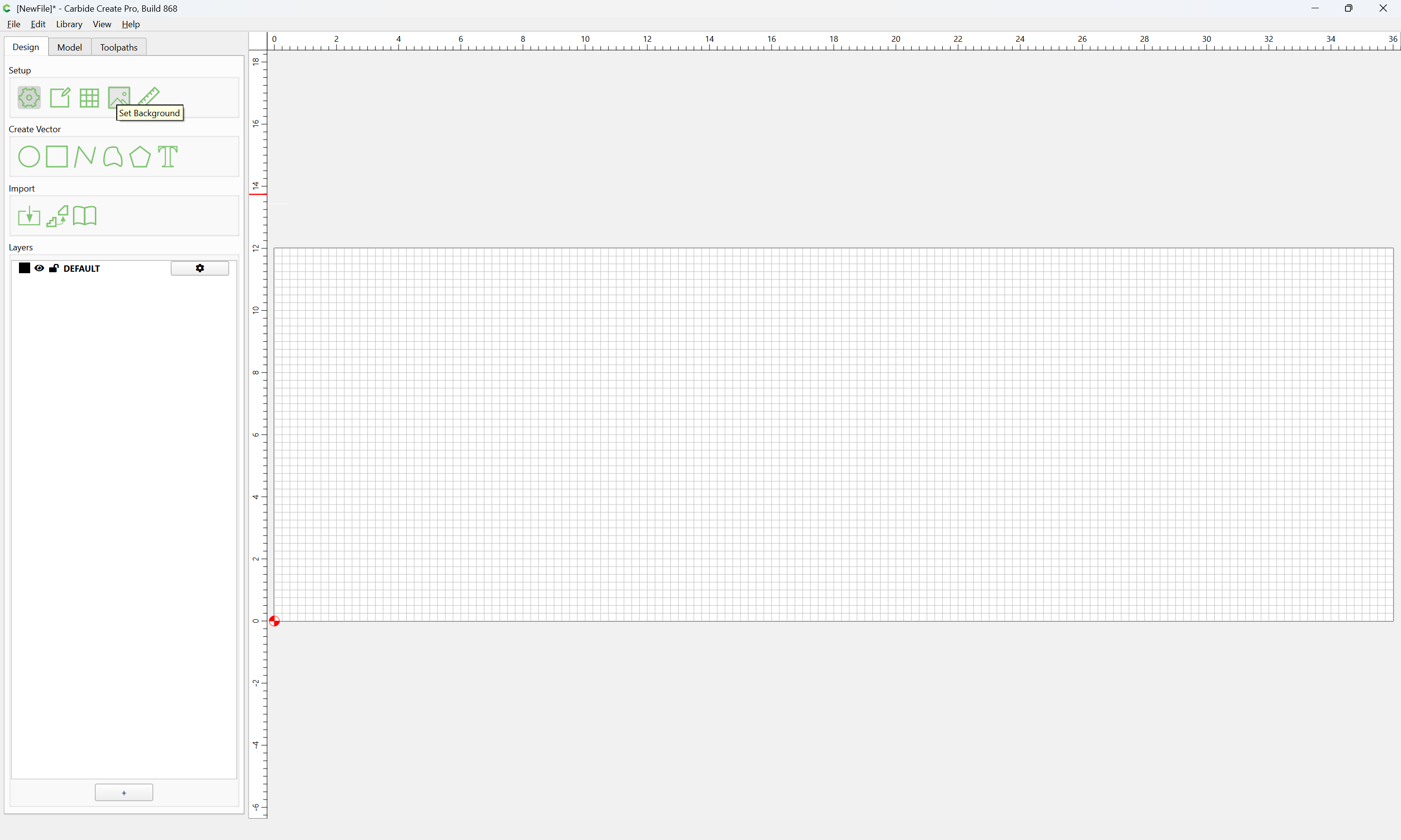

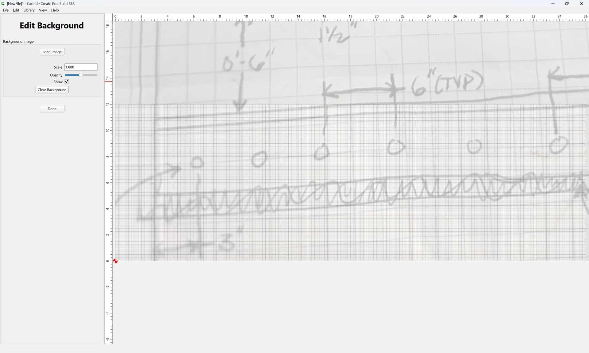

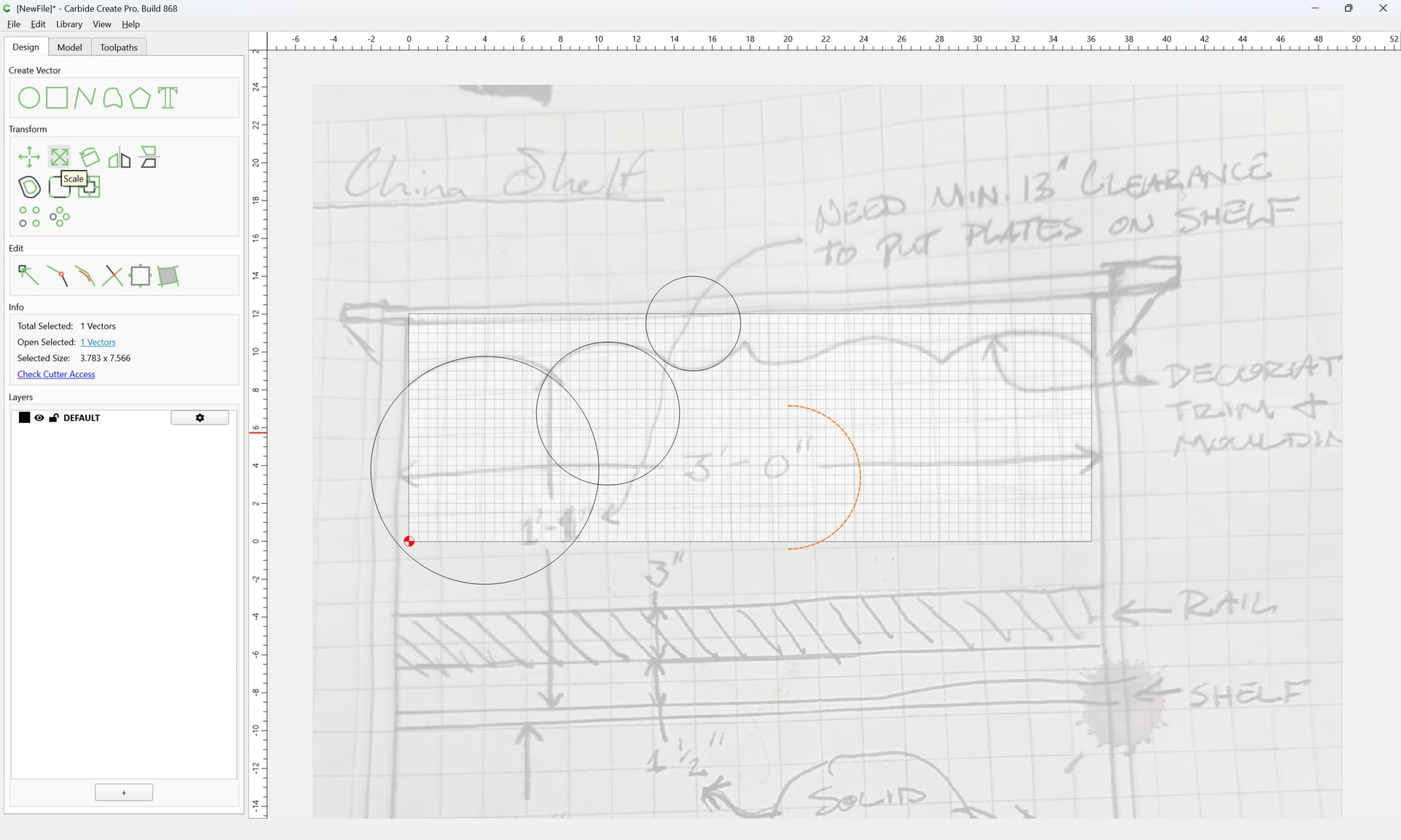

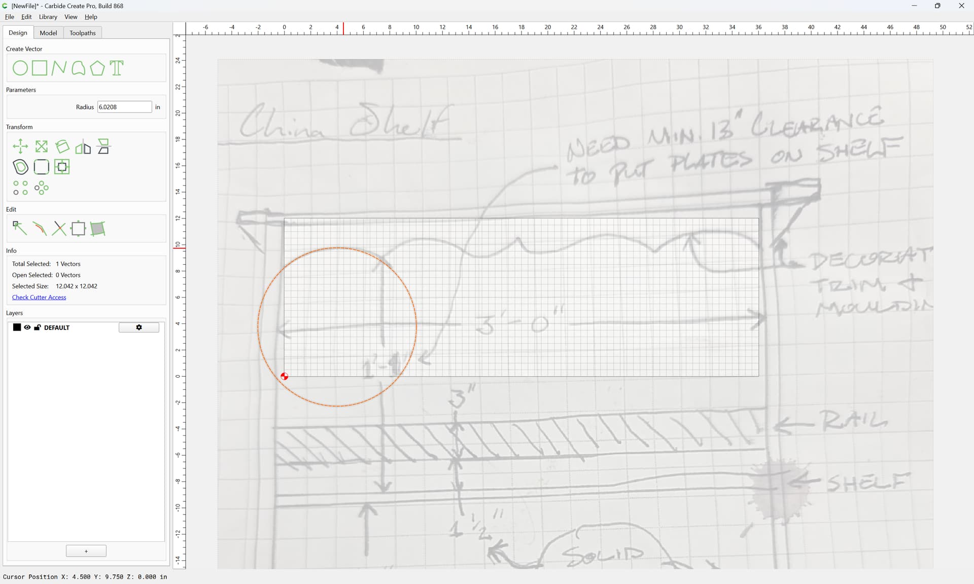

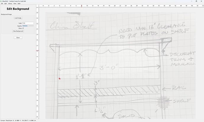

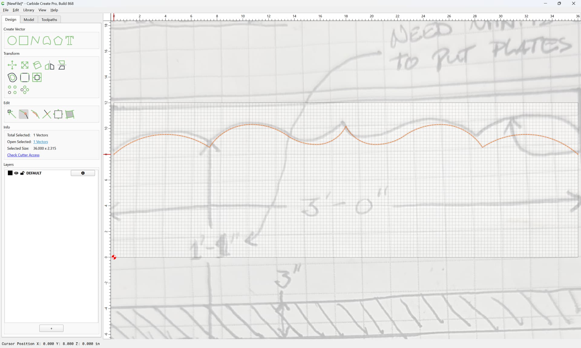

first, create a suitably sized working area:
then Set Background
and adjust:
Done

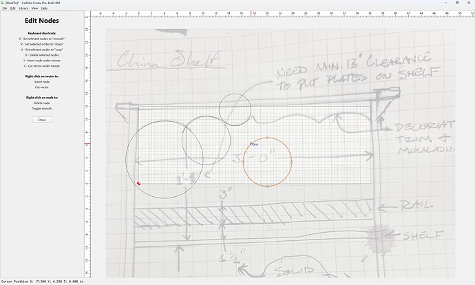

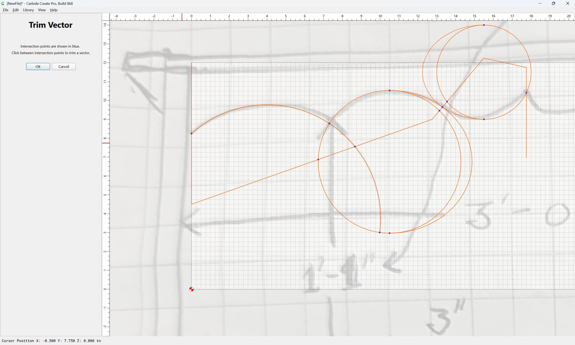

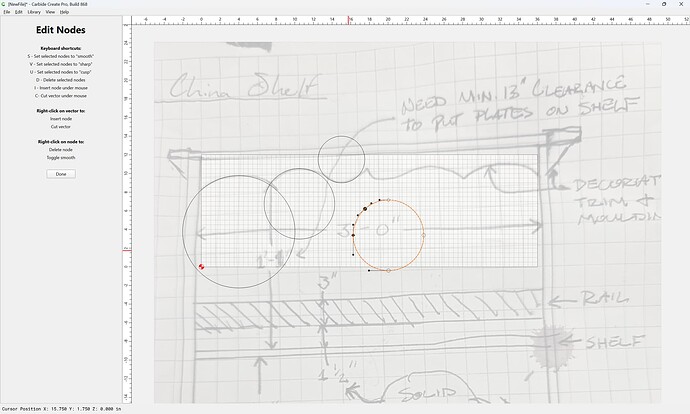

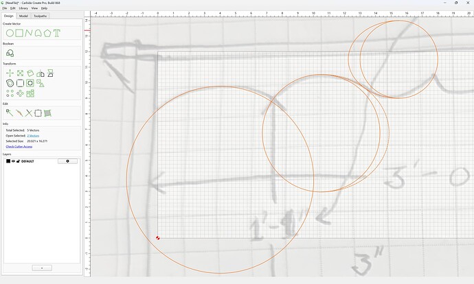

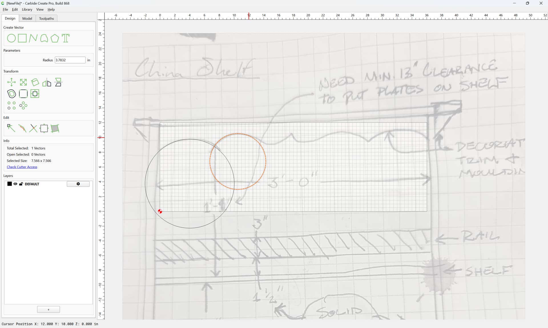

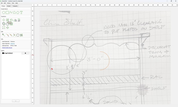

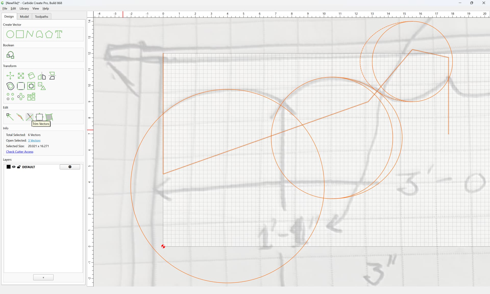

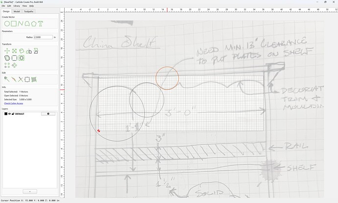

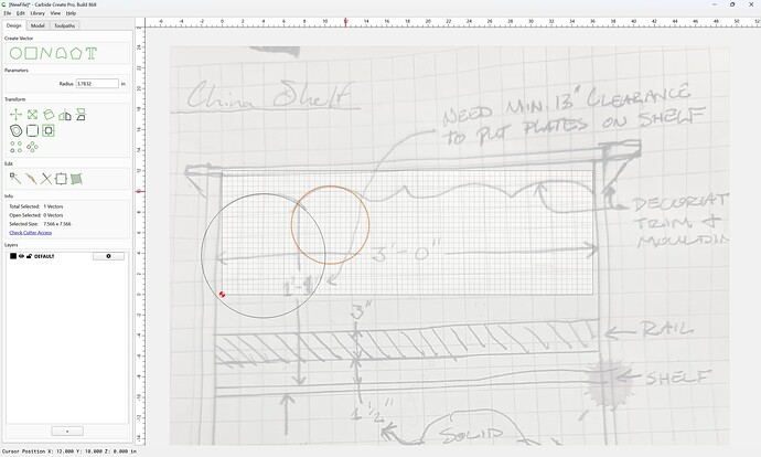

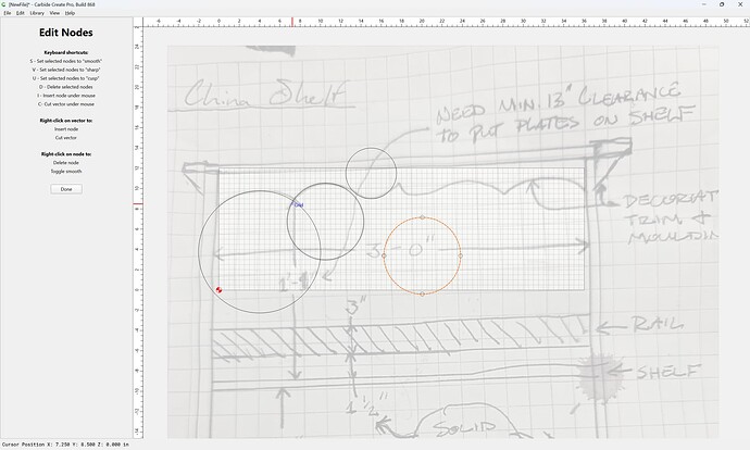

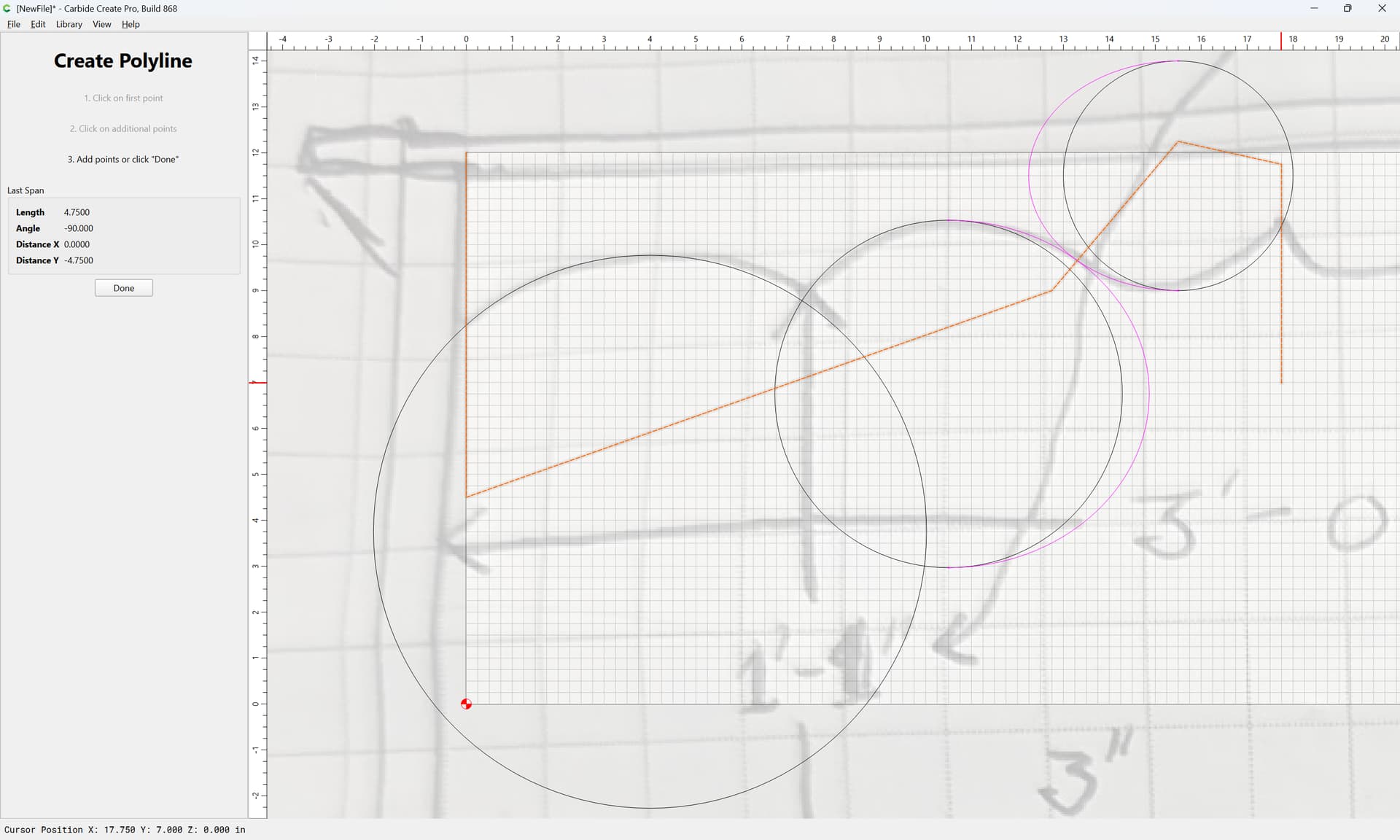

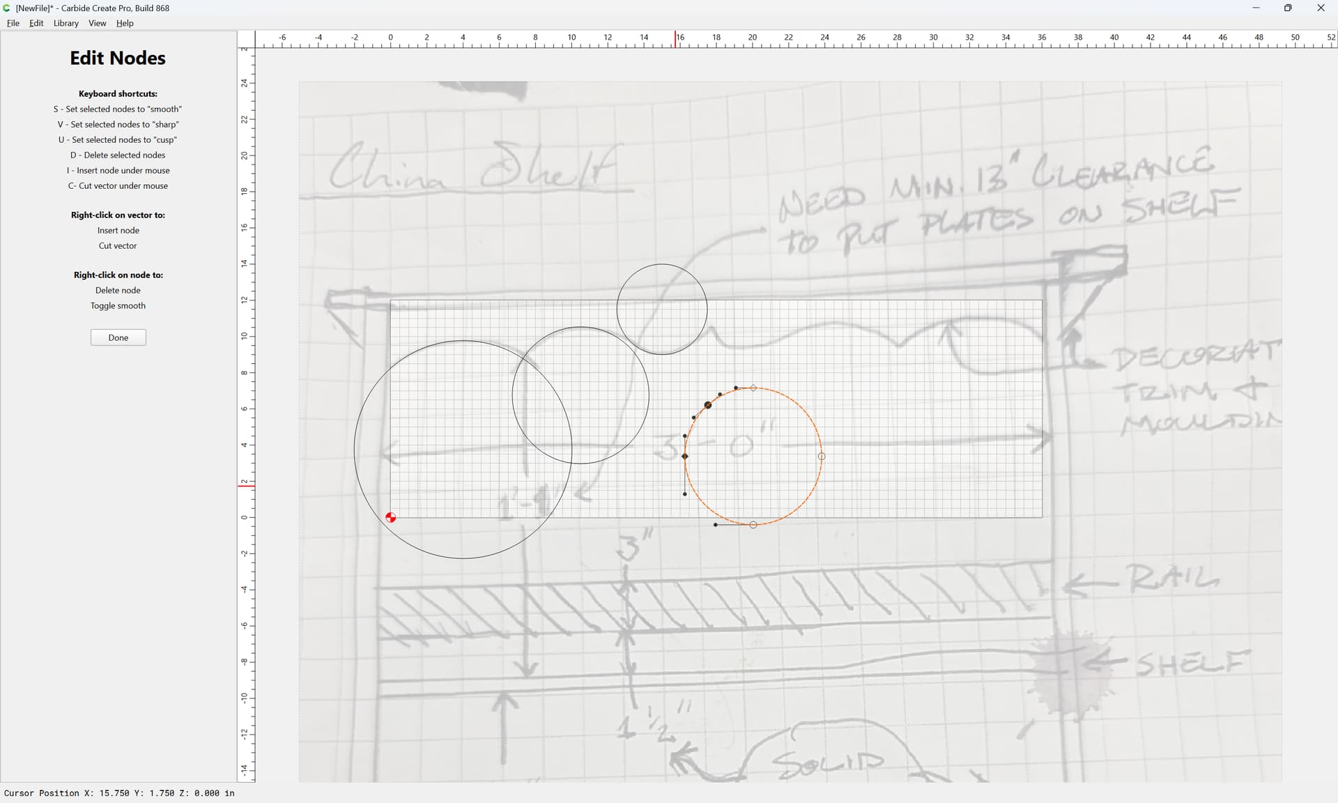

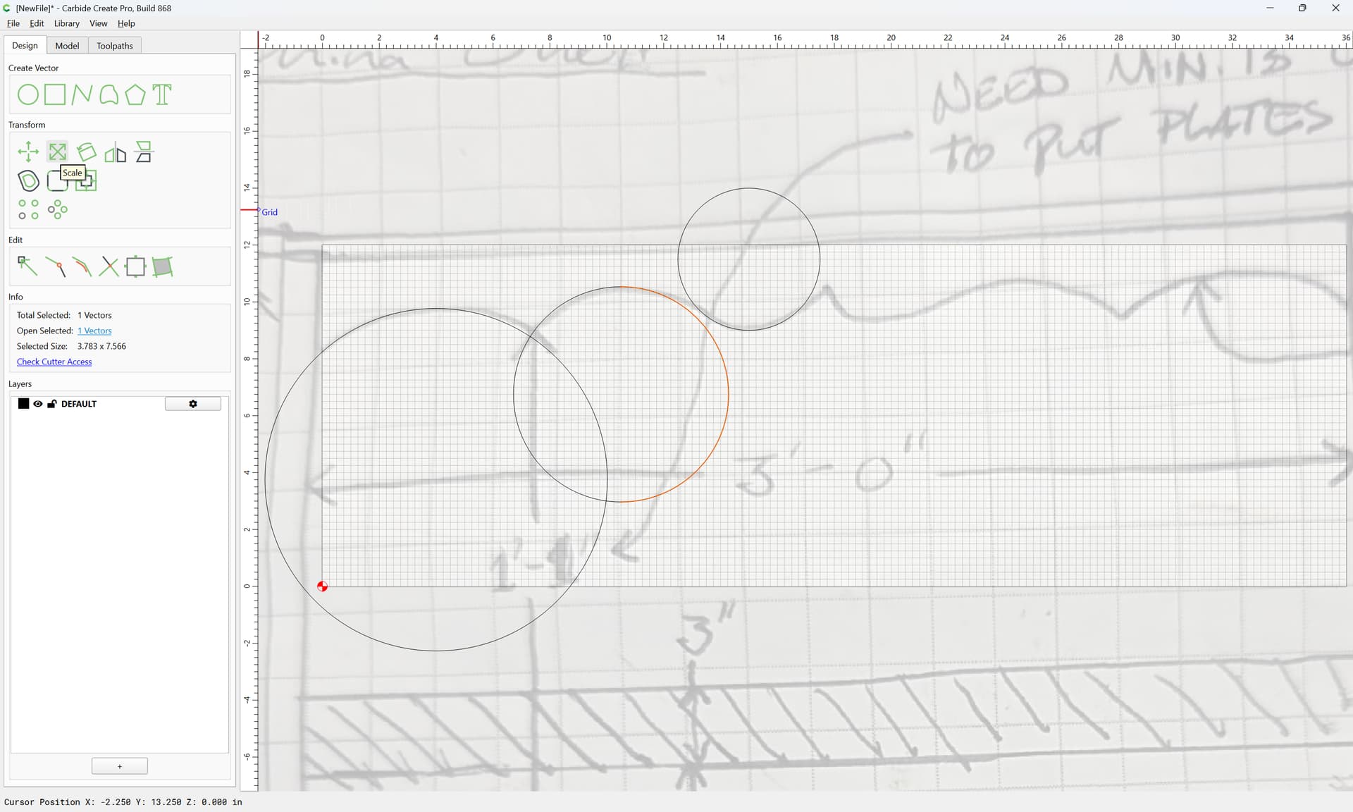

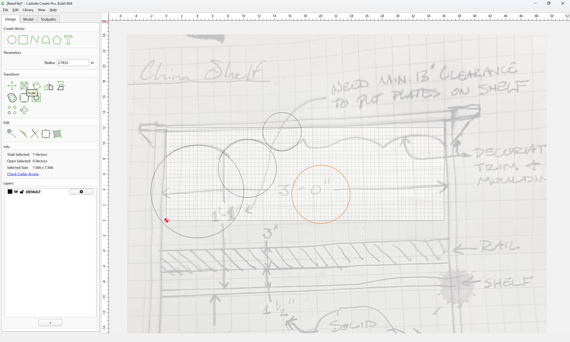

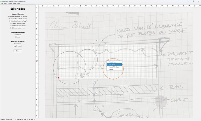

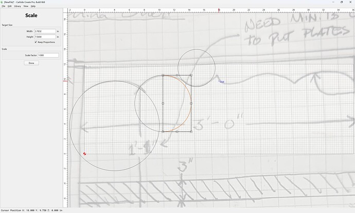

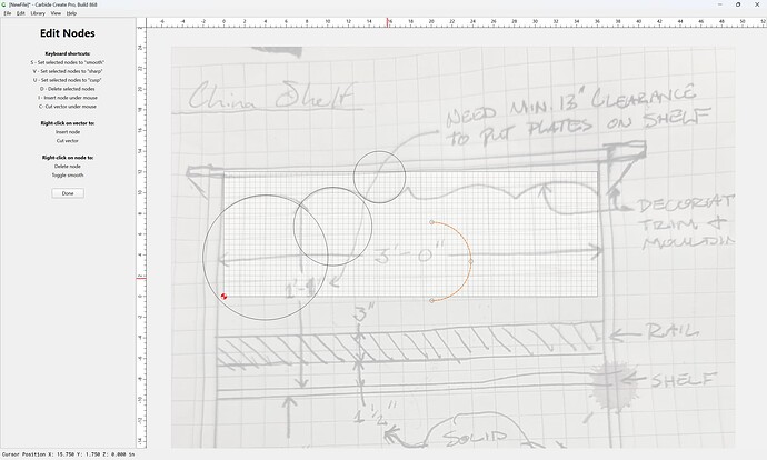

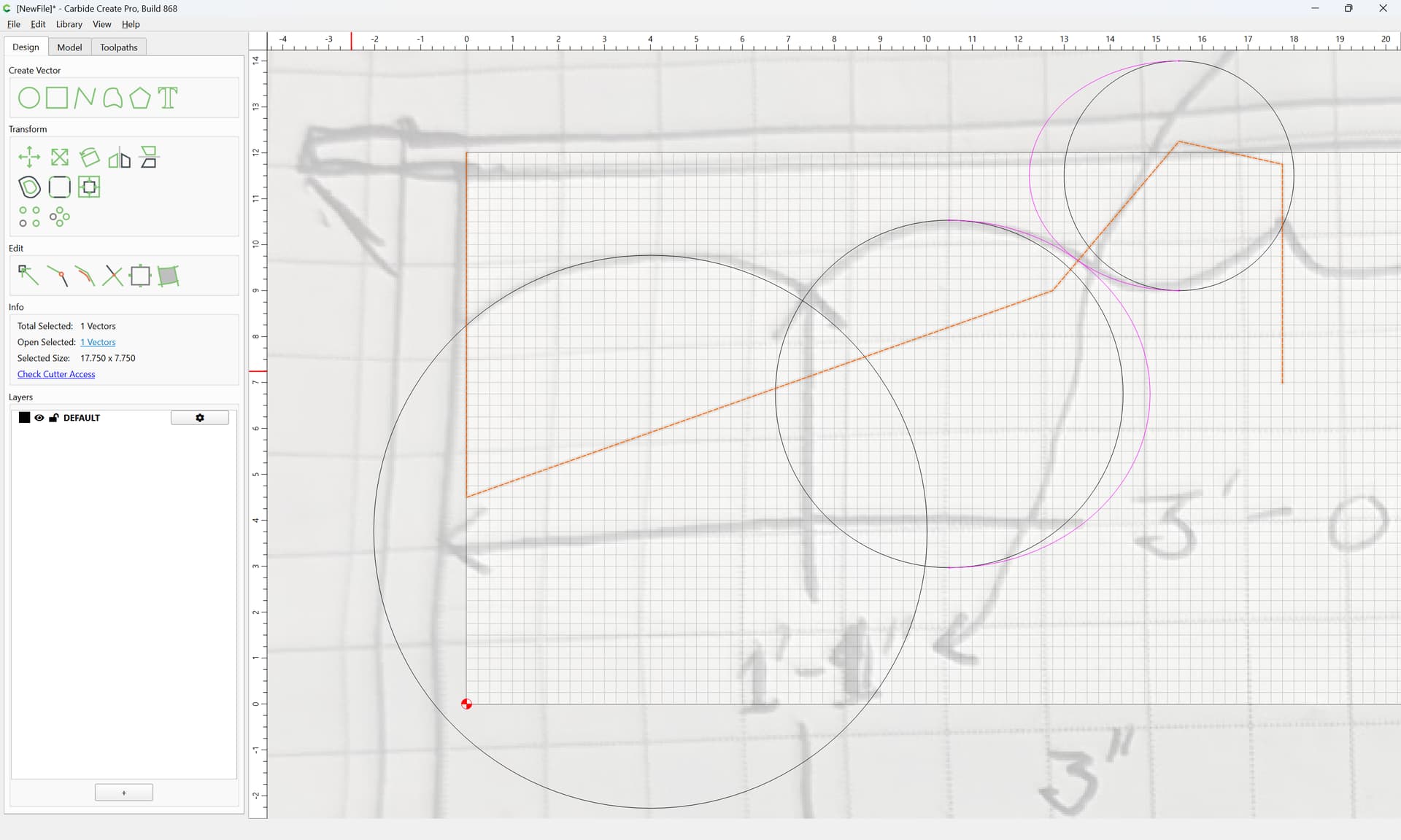

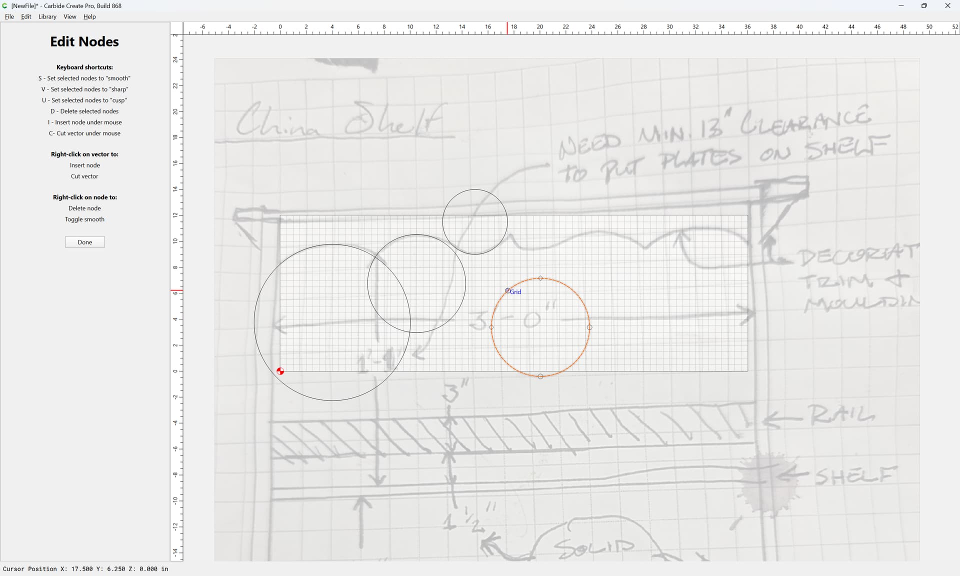

Draw circles which approximate one-half of the design:

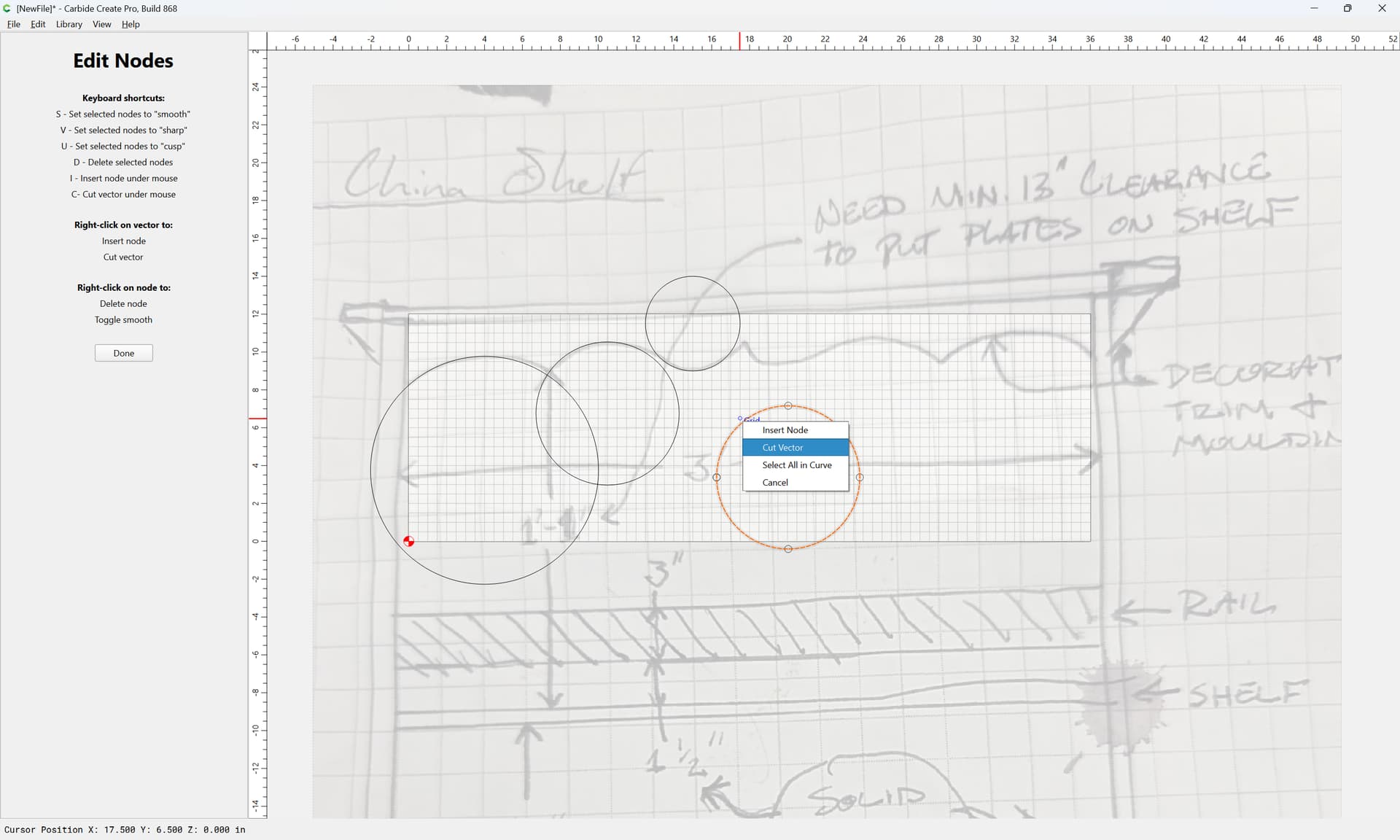

where necessary duplicating a circle:
halving it using Node Editing:
d
Done

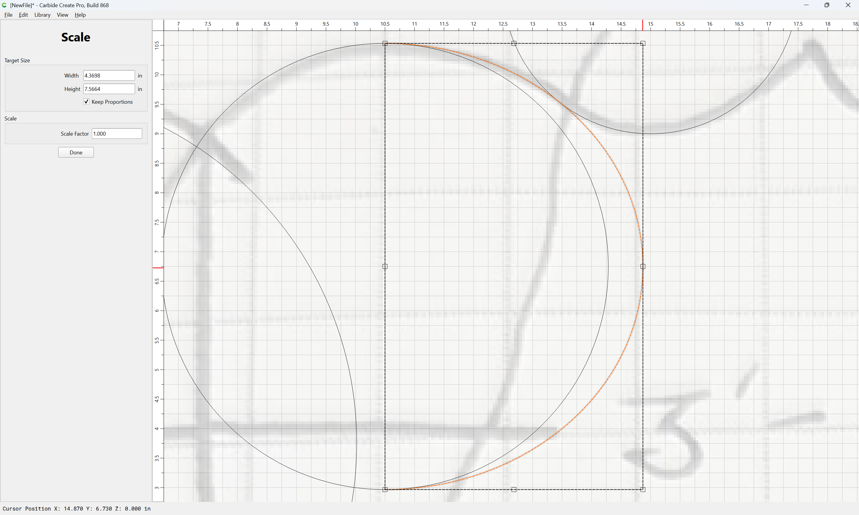

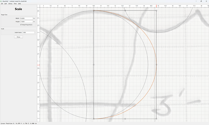

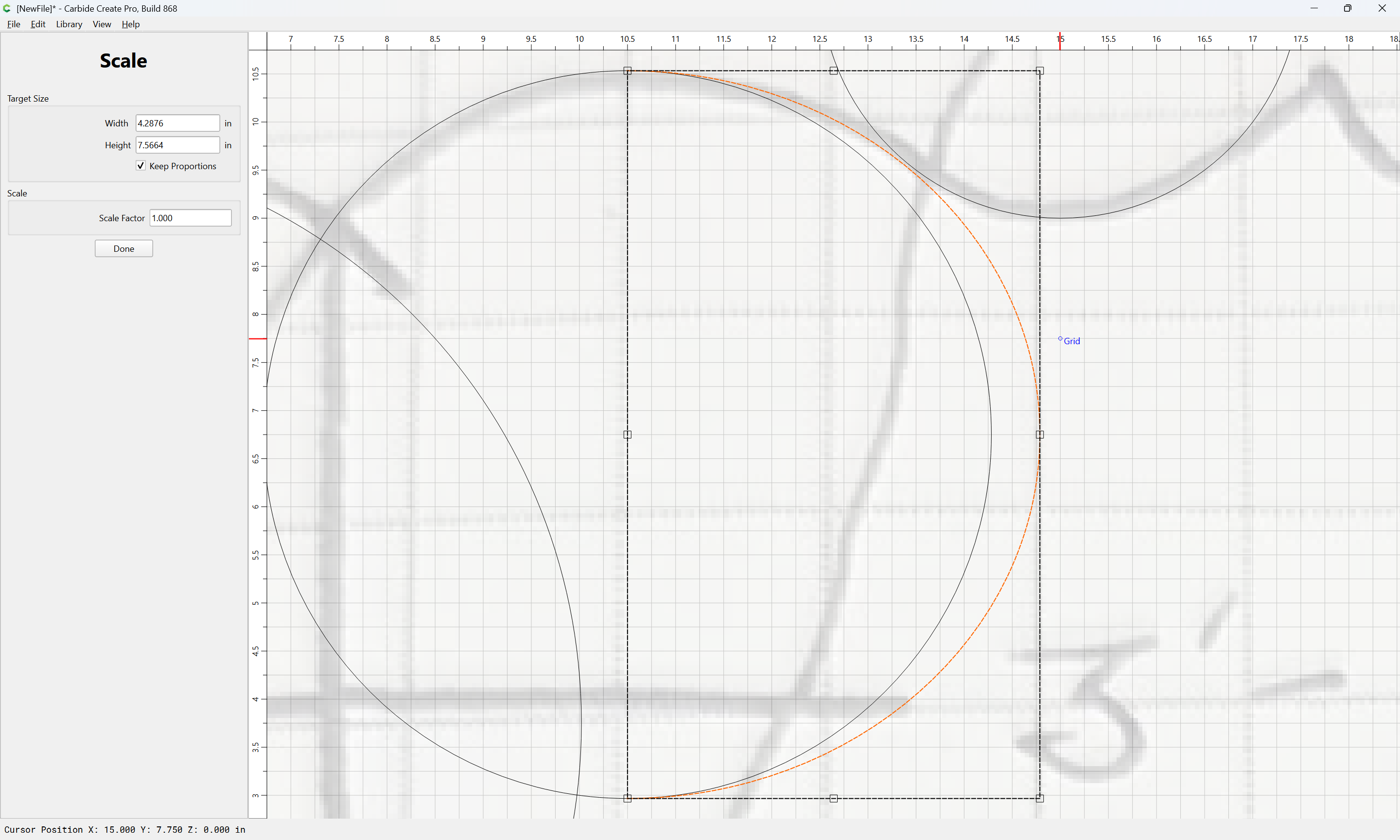

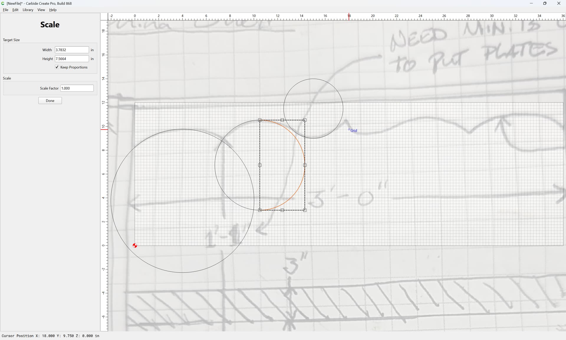

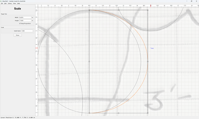

drag into registration with the original:
and scale asymmetrically:
if need be turning off the grid:
Done

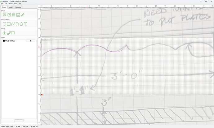

Repeat/adjust as necessary:

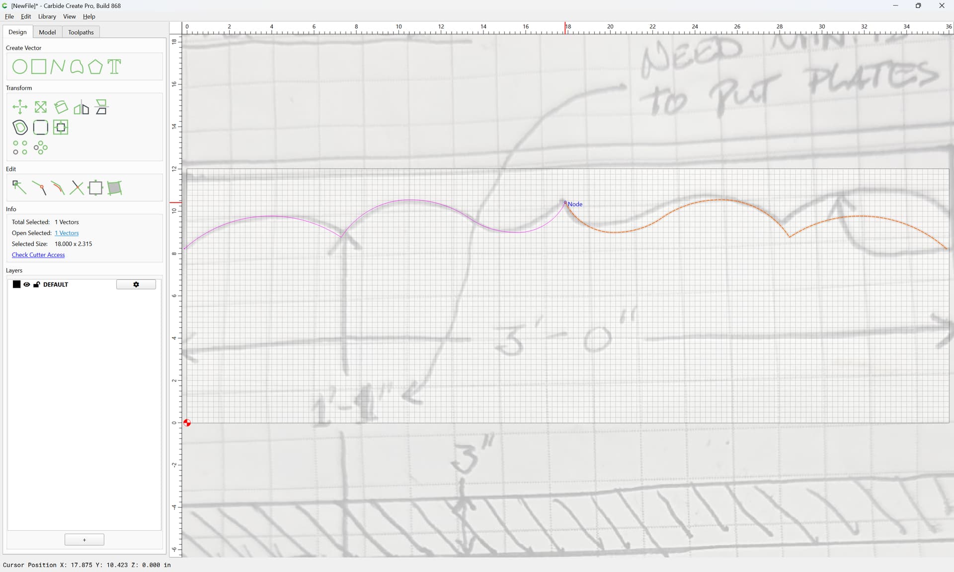

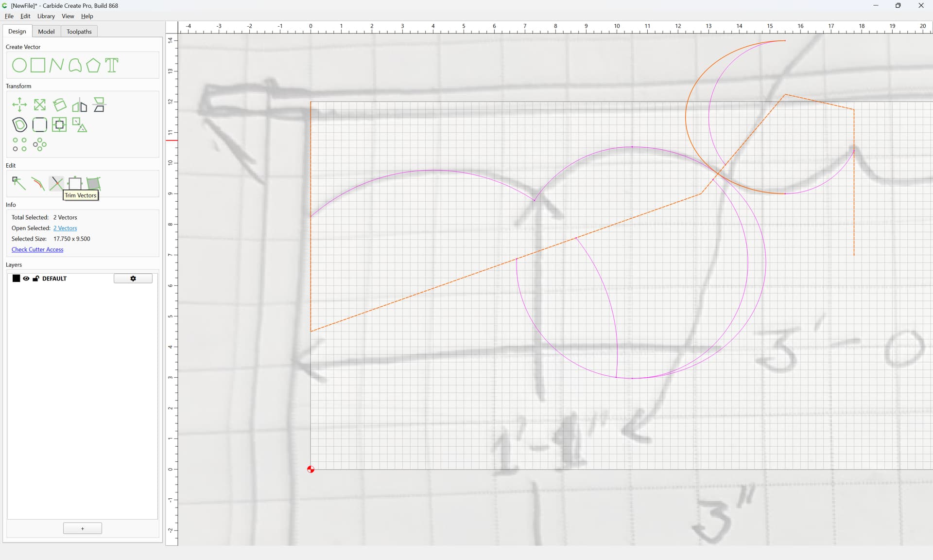

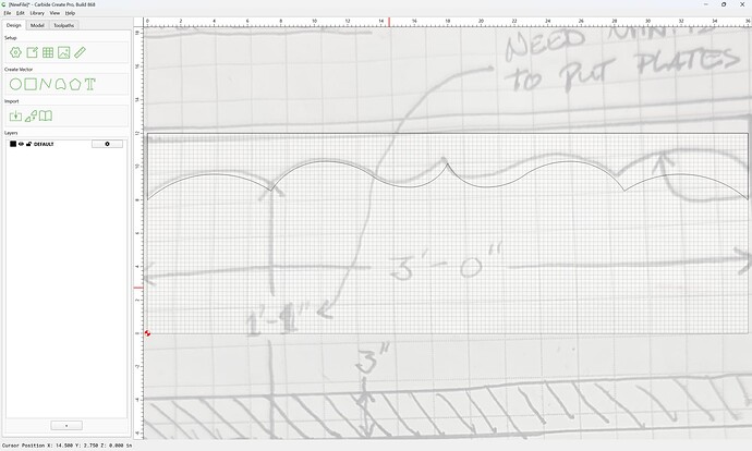

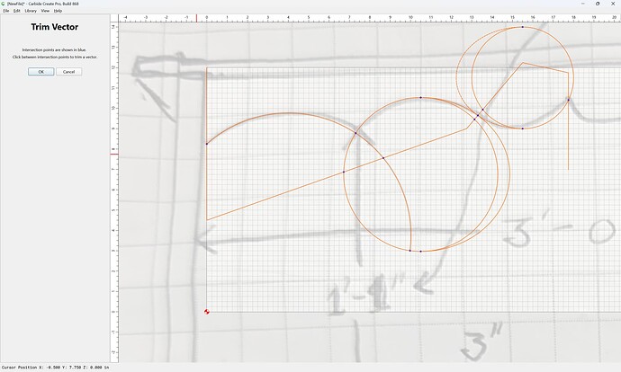

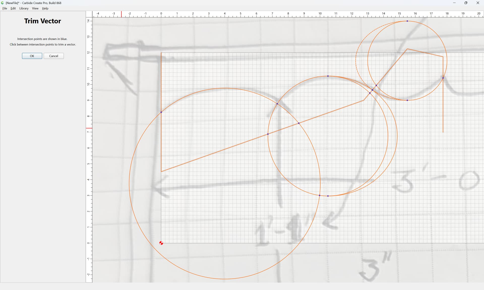

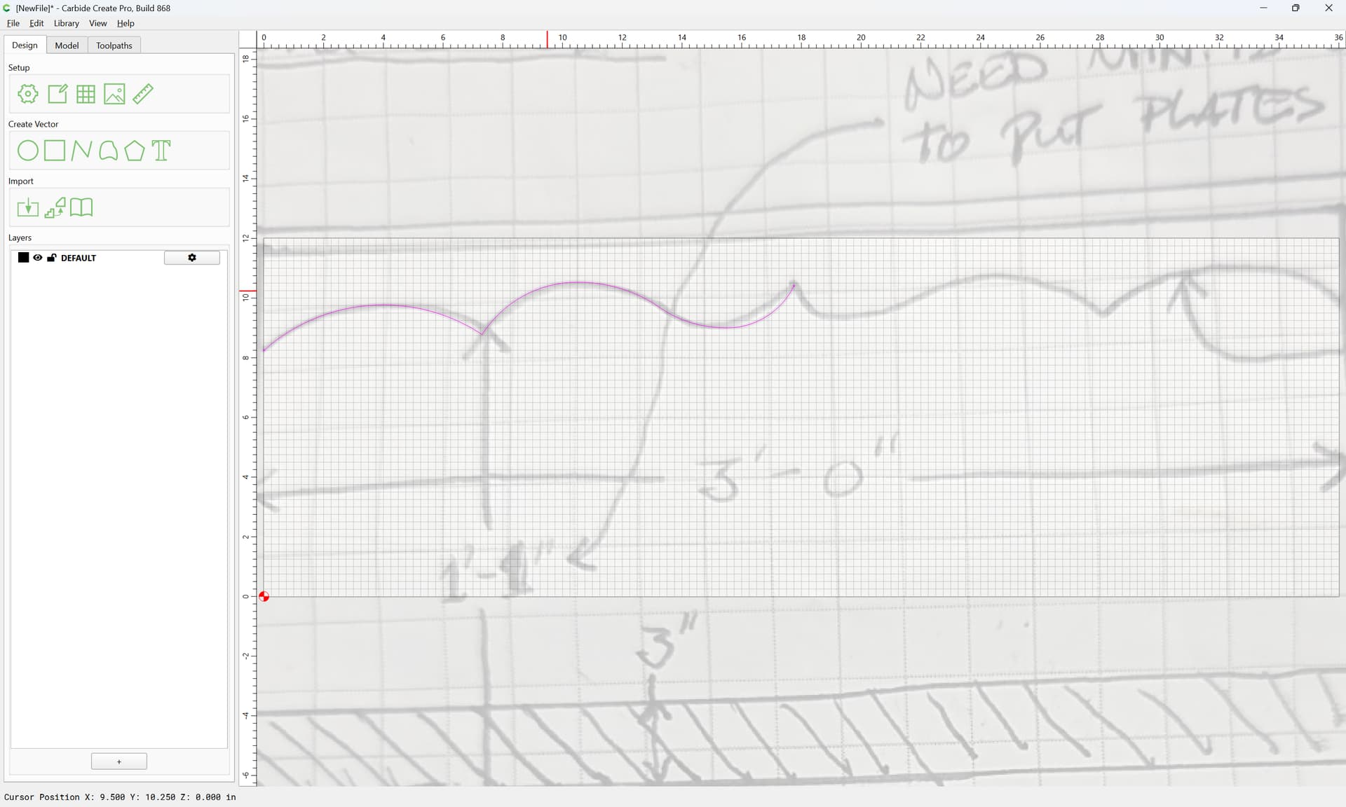

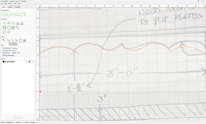

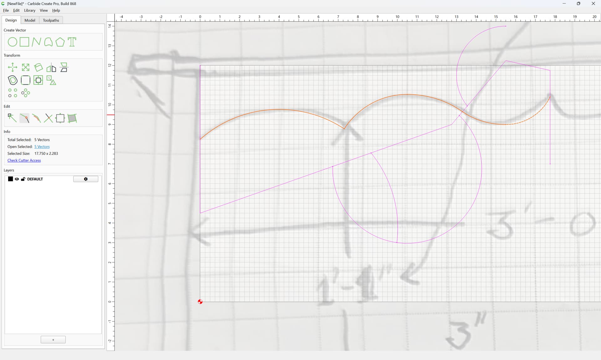

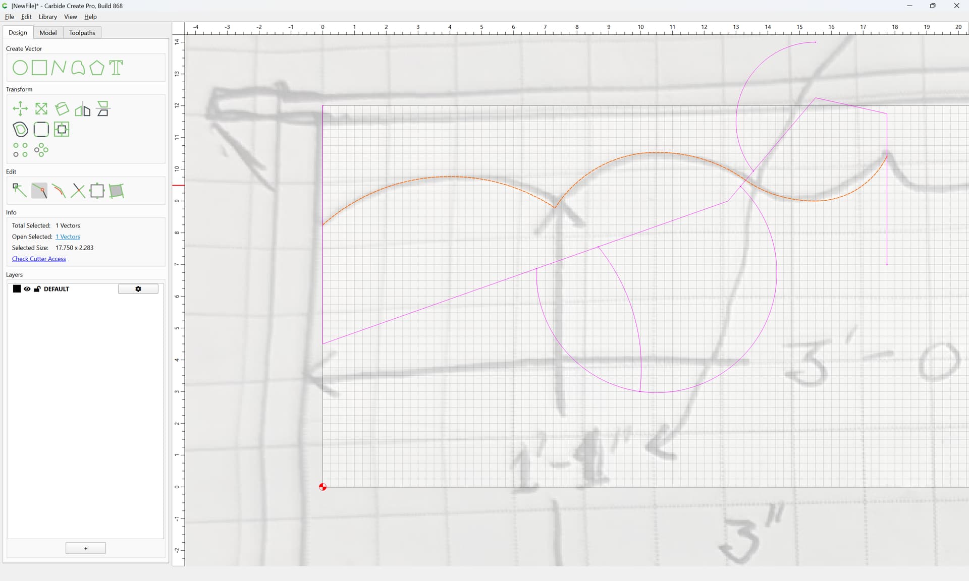

Then draw in geometry which defines the intersections:
Done

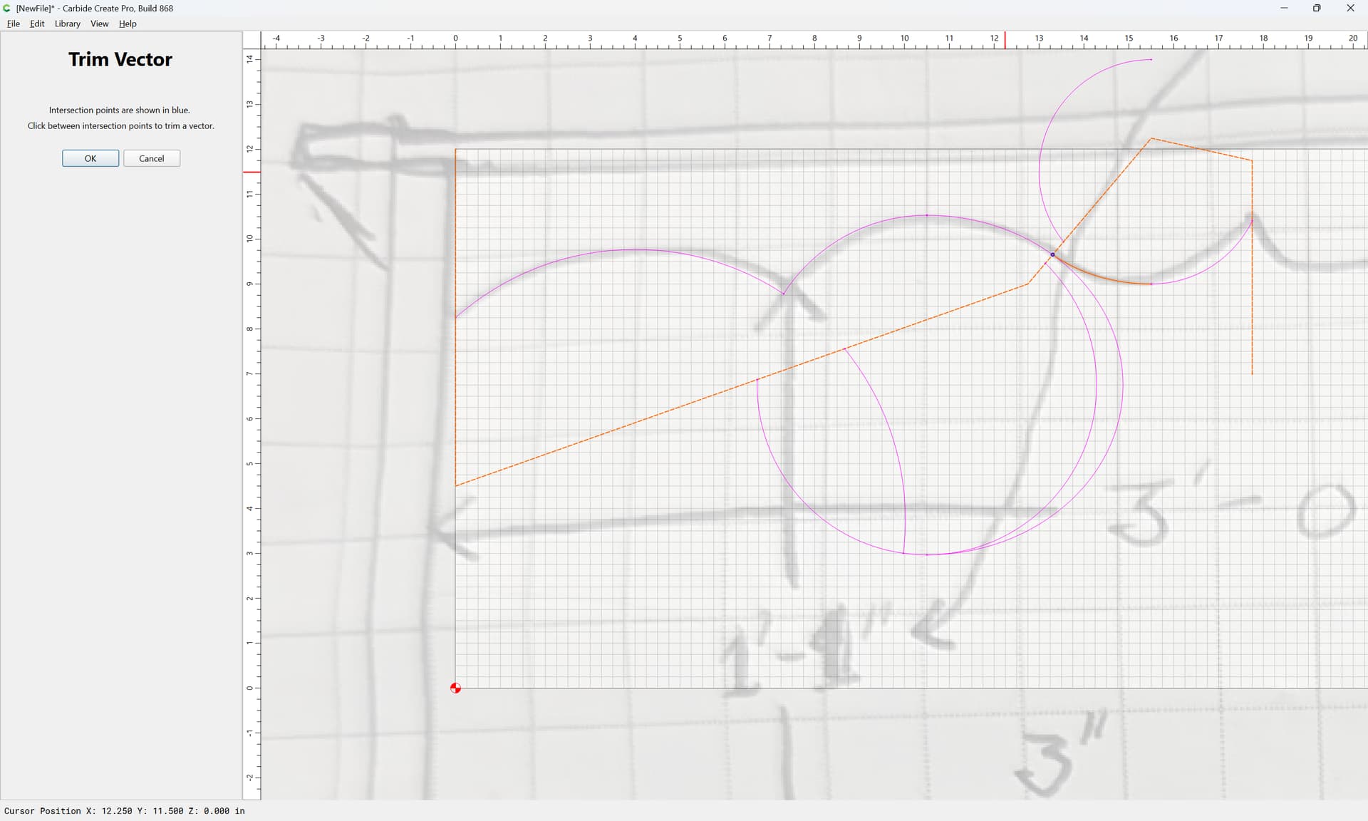

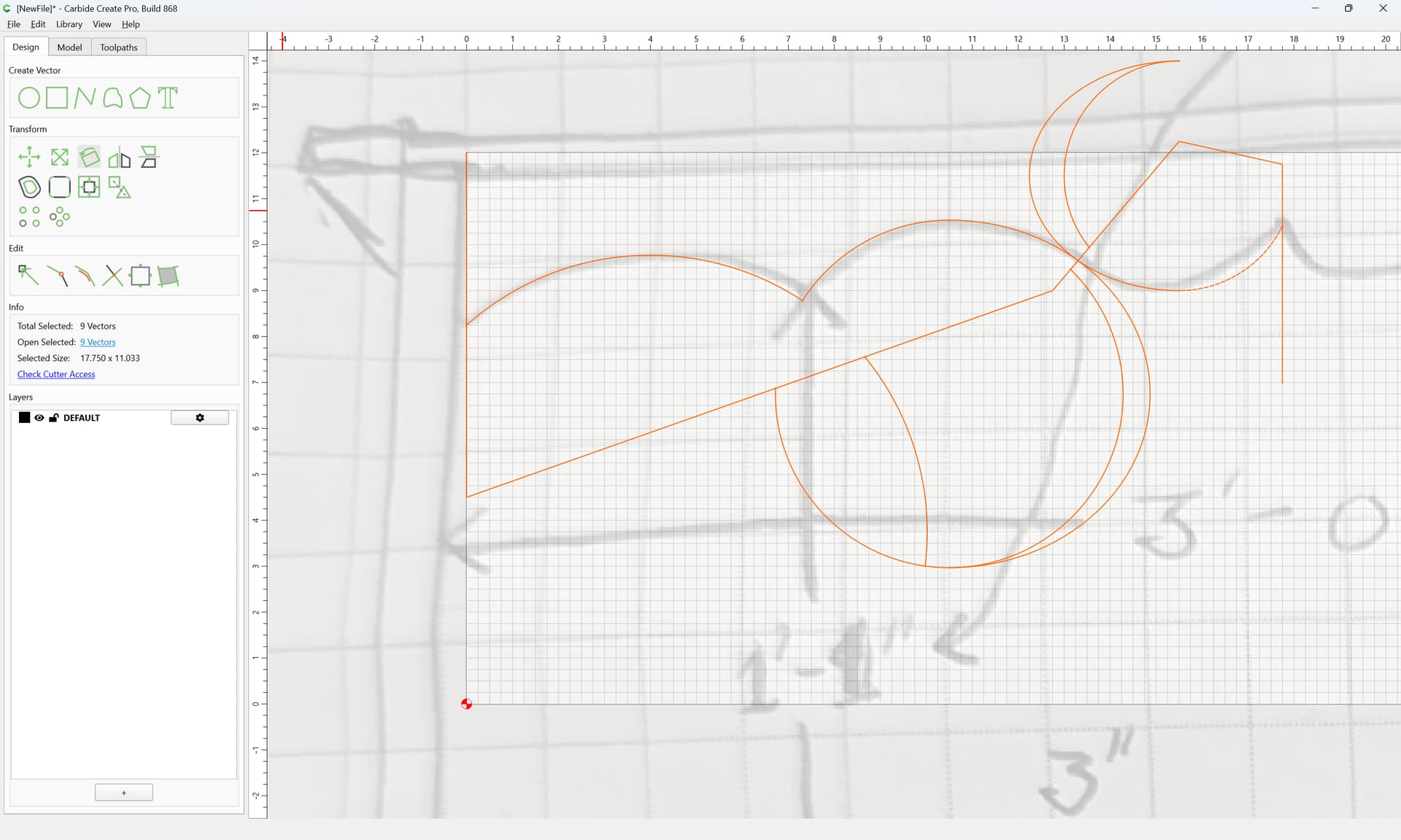

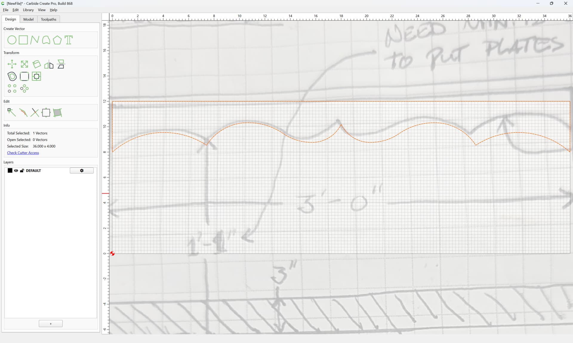

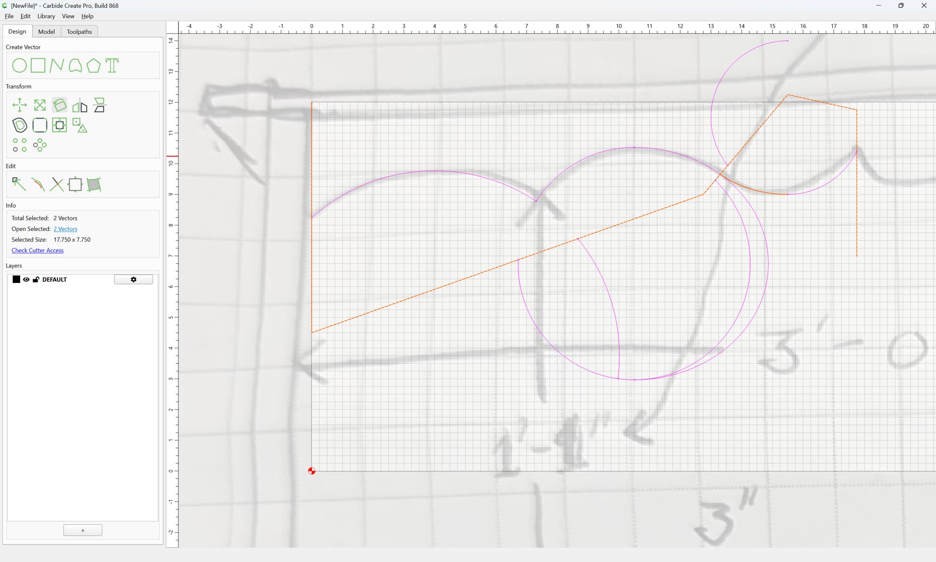

Select everything:
and use Trim Vectors to remove what is not wanted:
Ok
If need be, repeat with a simpler selection:
OK
repeat as needed:
OK

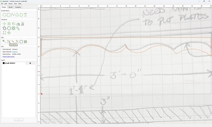

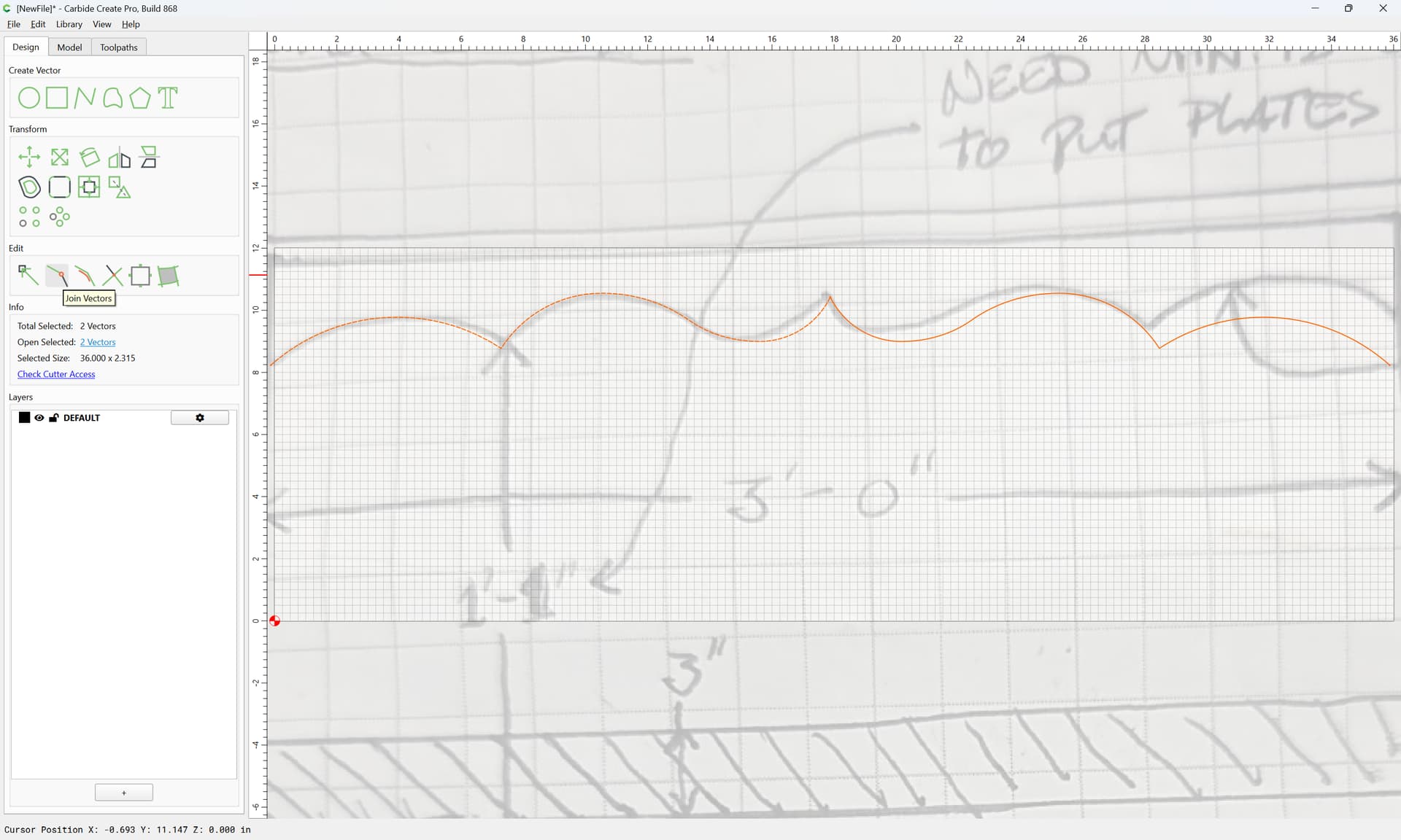

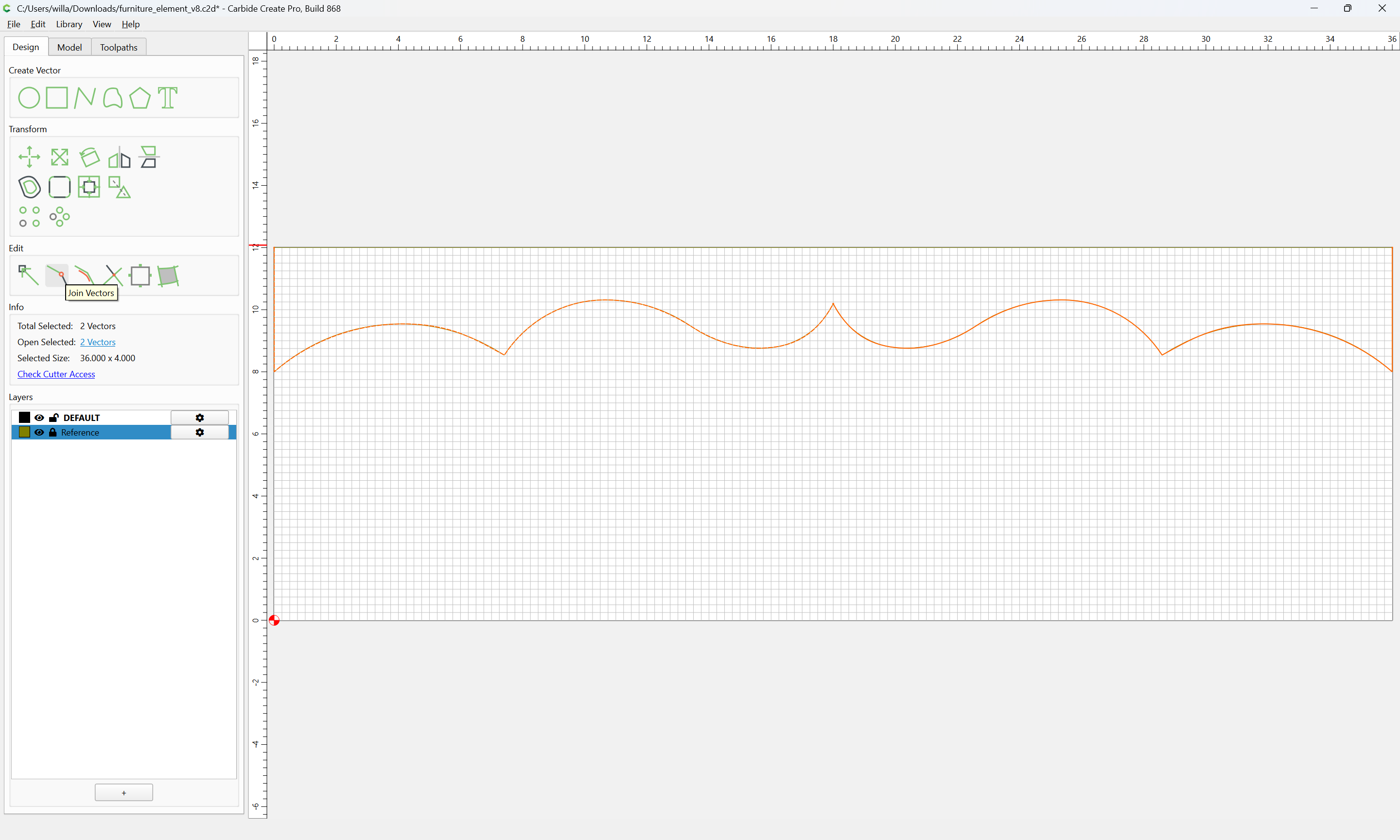

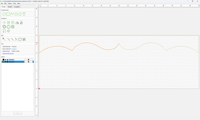

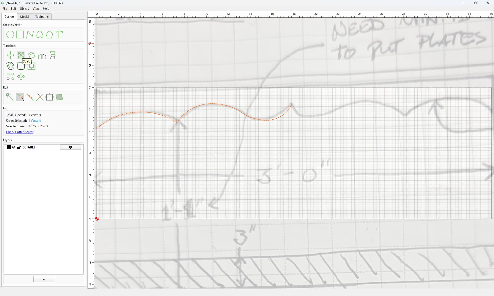

Select the arcs/curves which one wants:

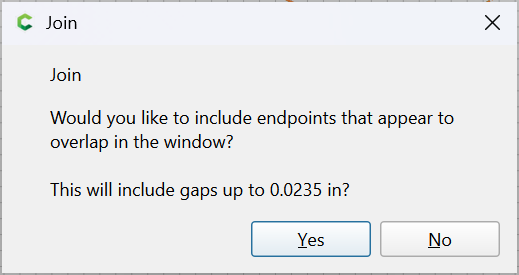

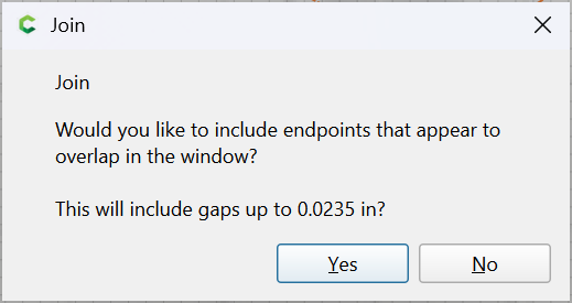

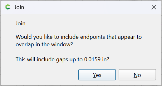

and Join Vectors
Yes
Select the balance:
and delete

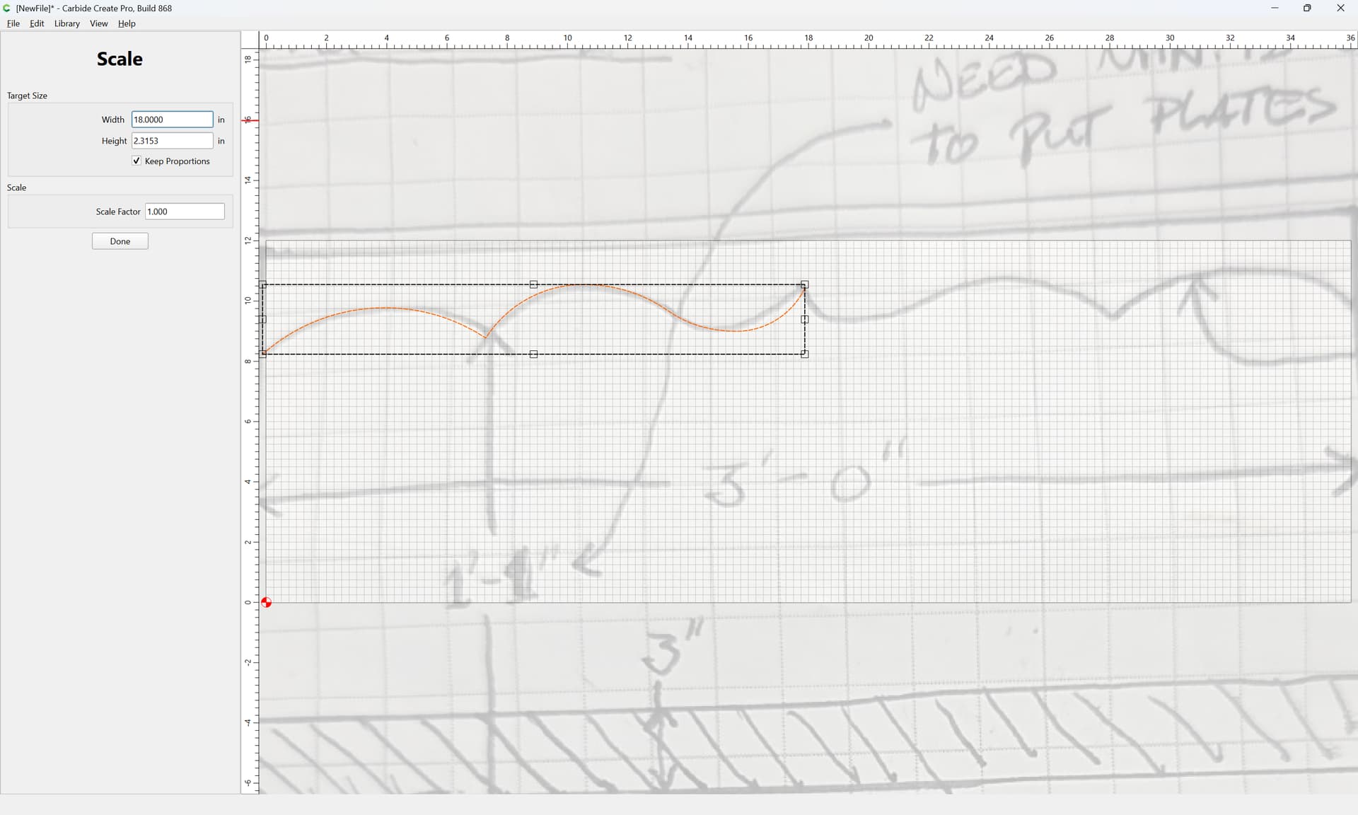

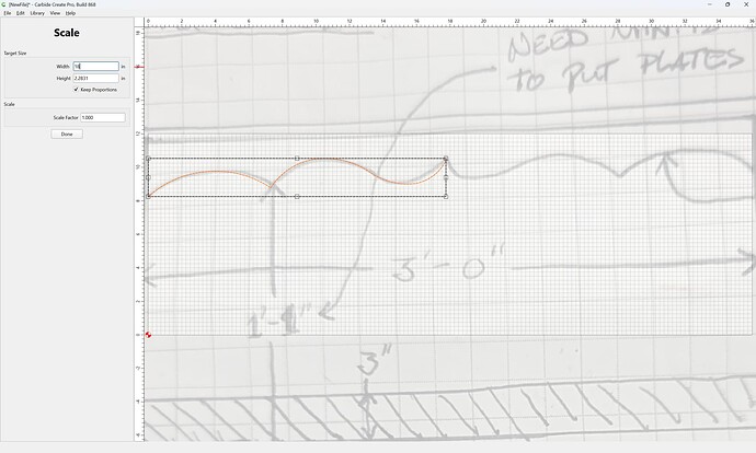

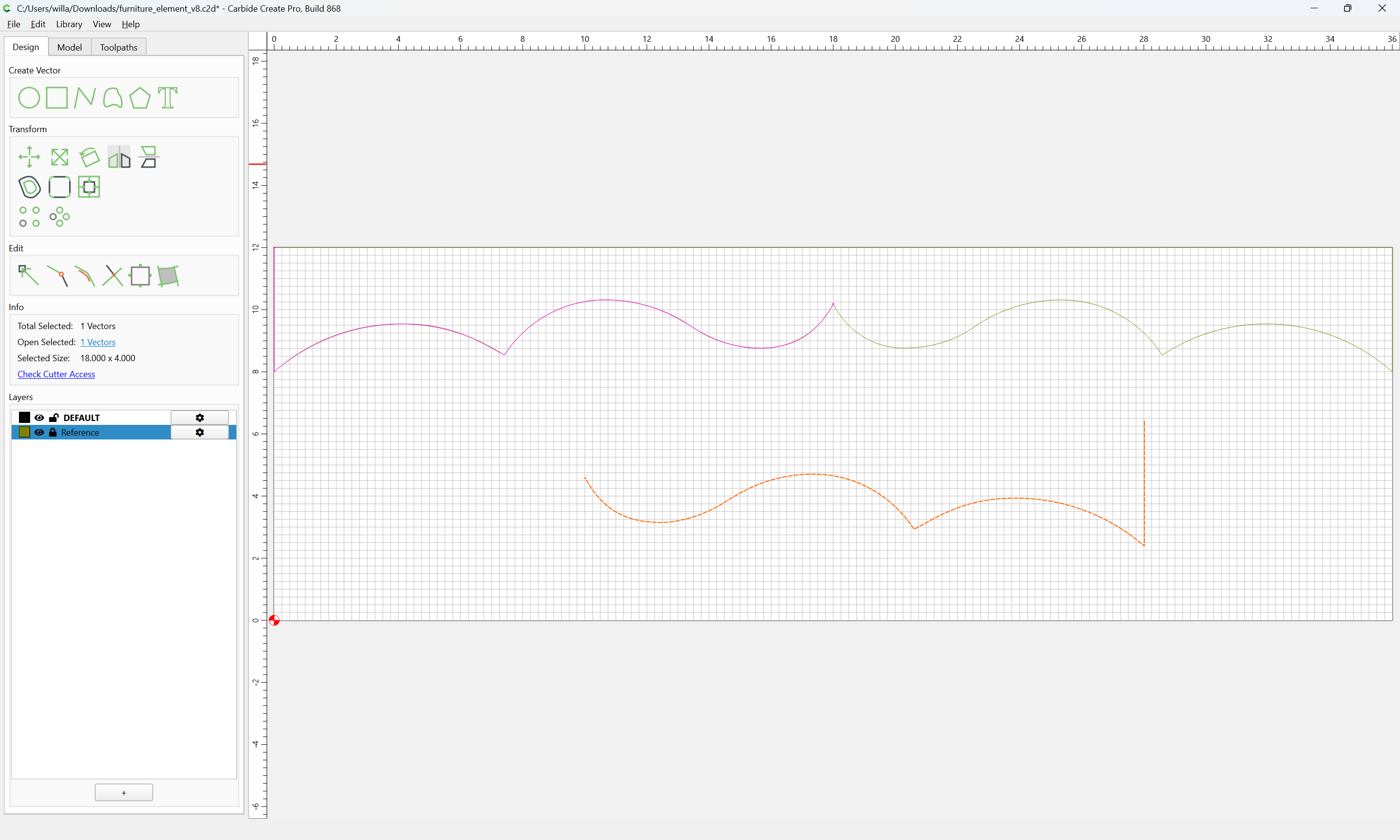

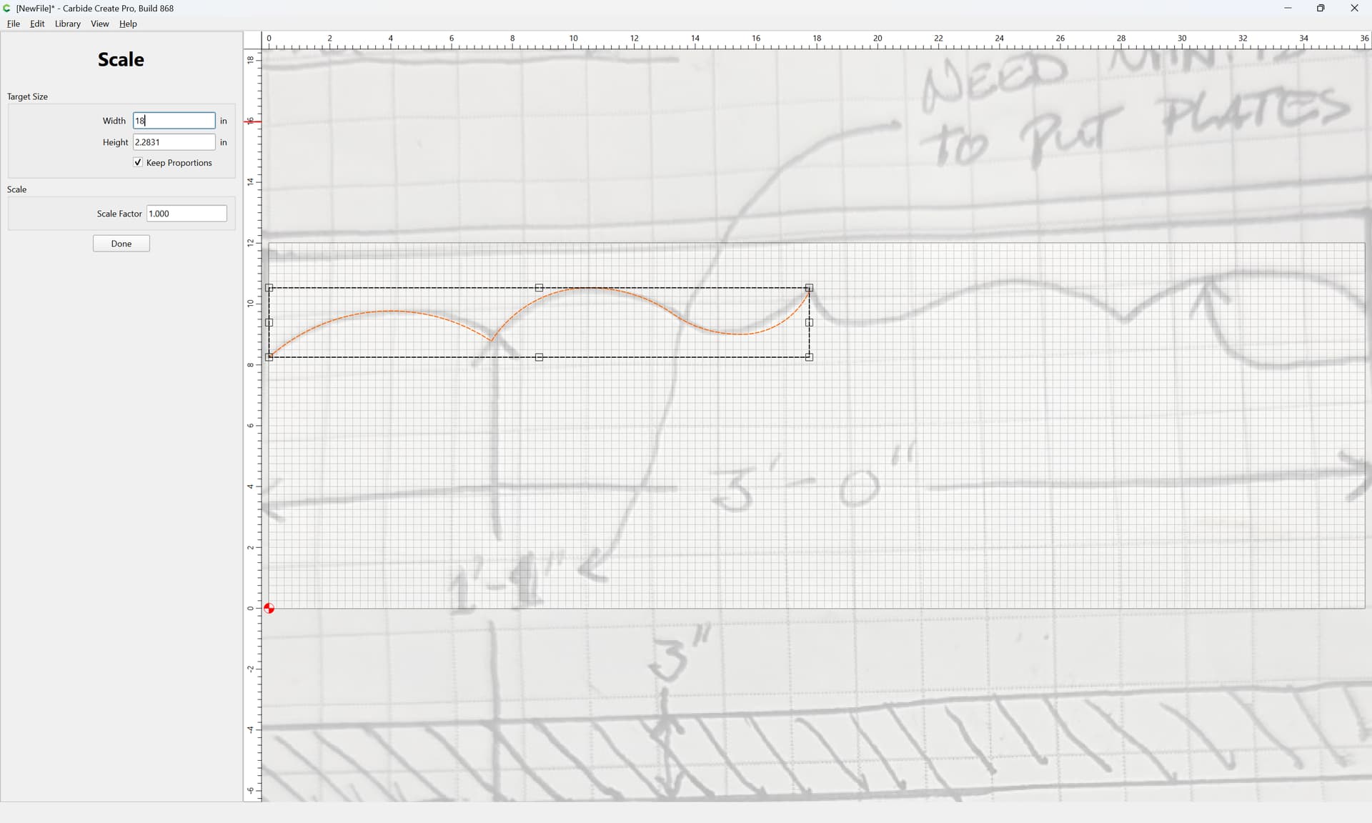

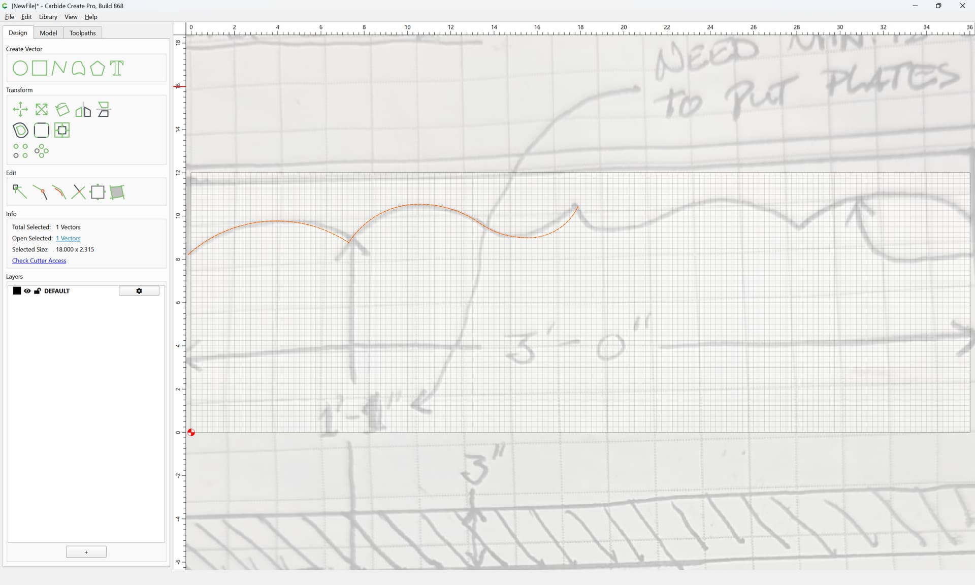

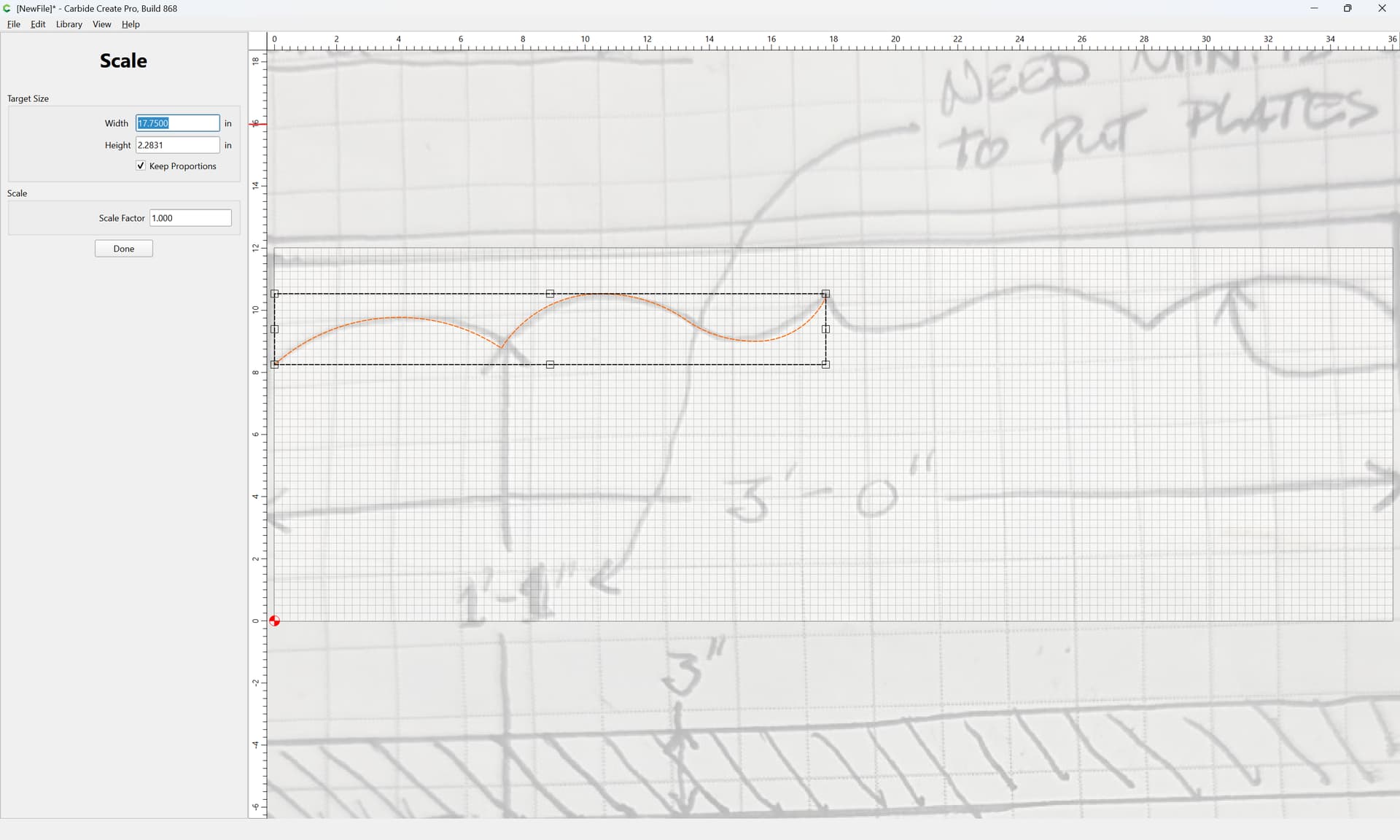

Select the half:
and scale to half the width:
Done

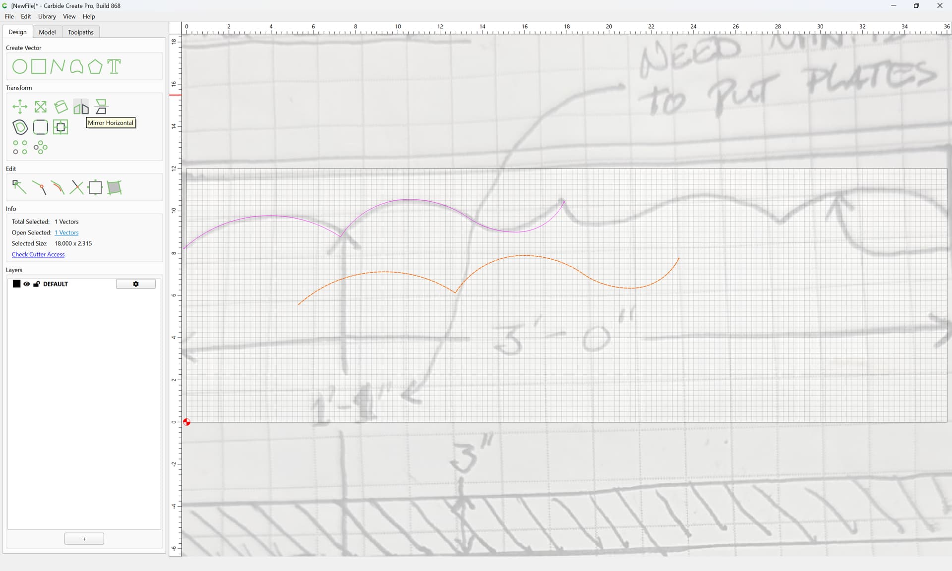

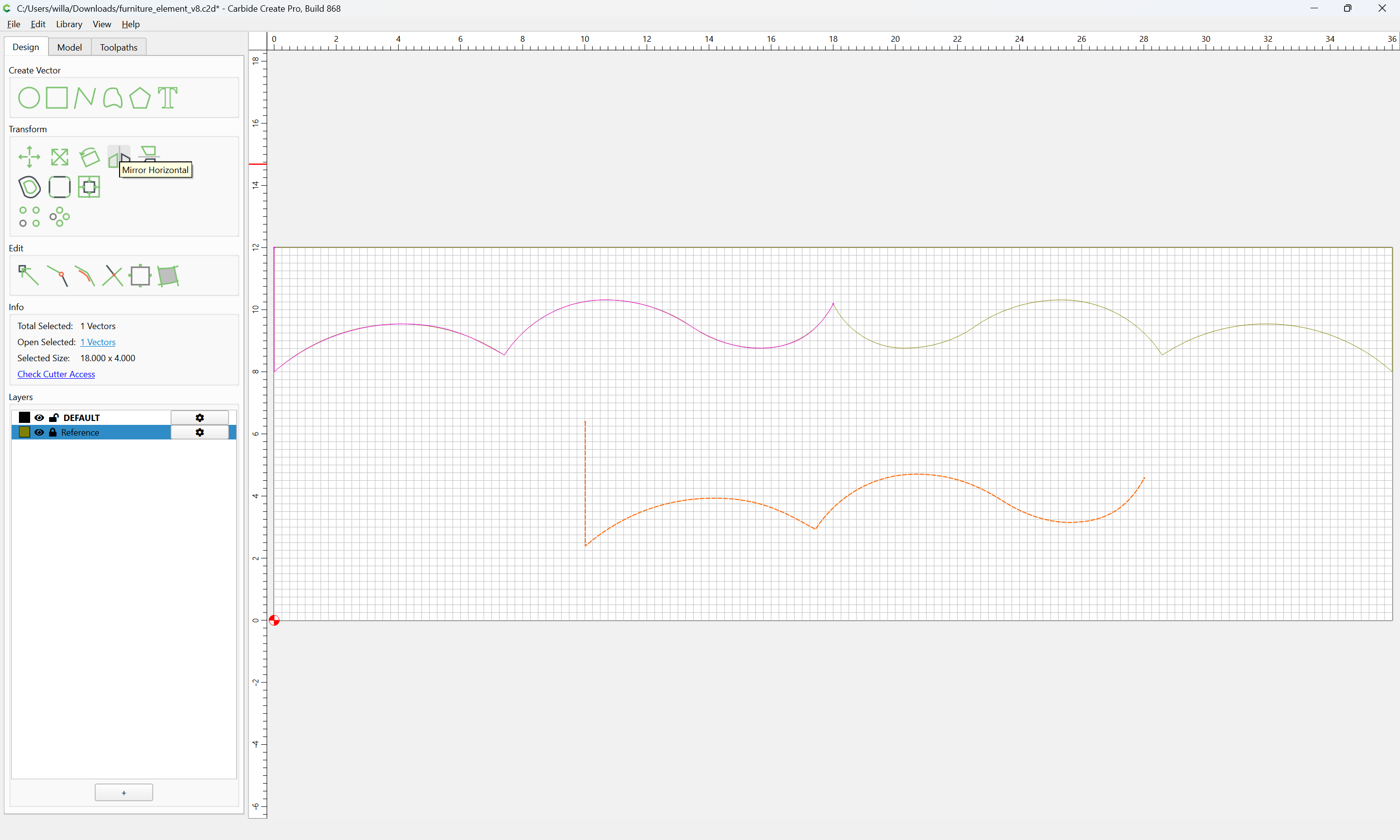

Duplicate:
Mirror Horizontal
drag into registration:

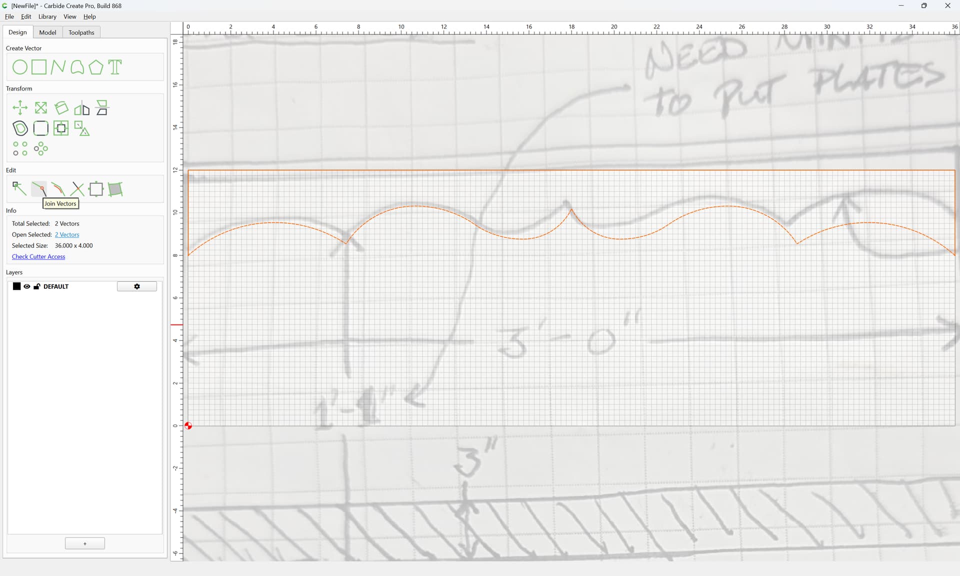

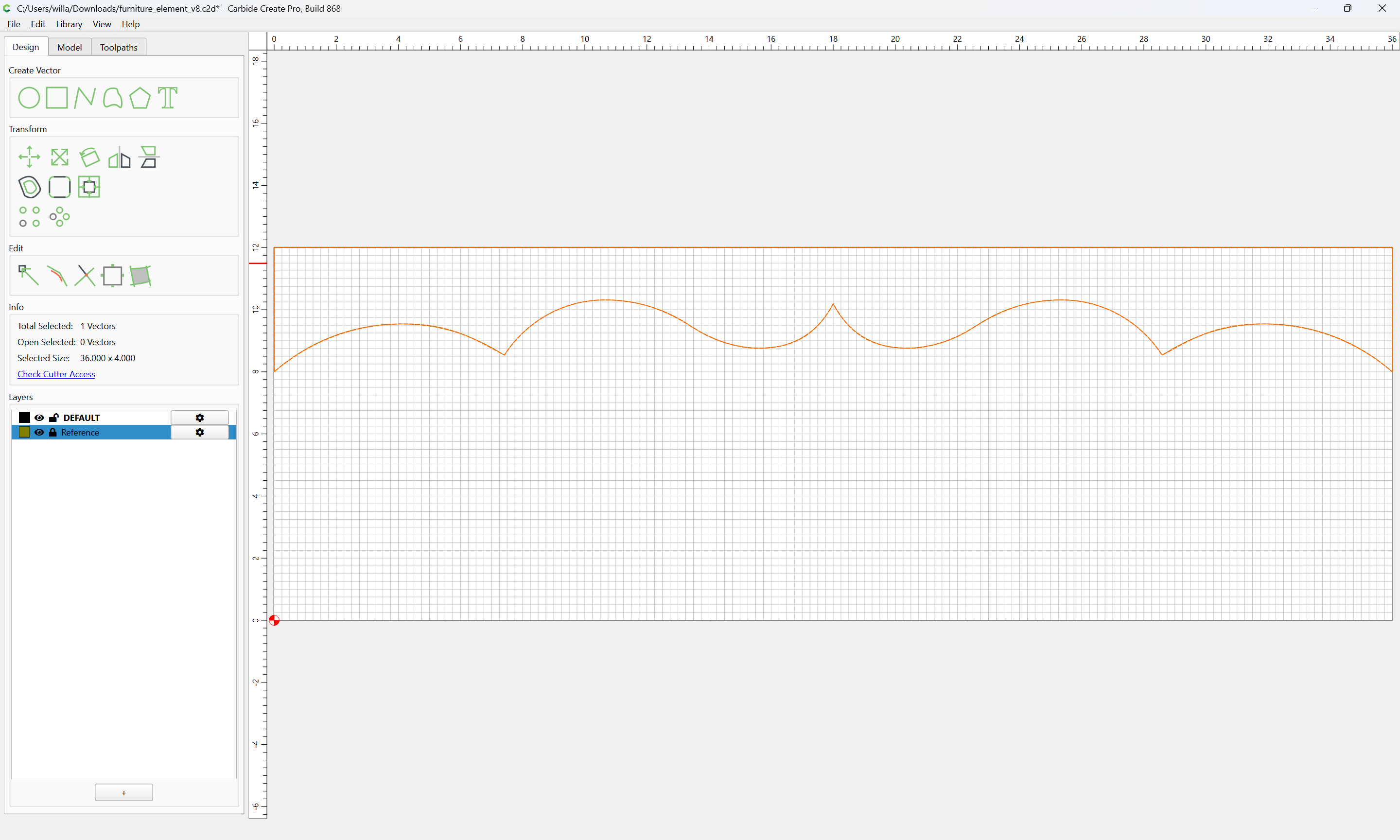

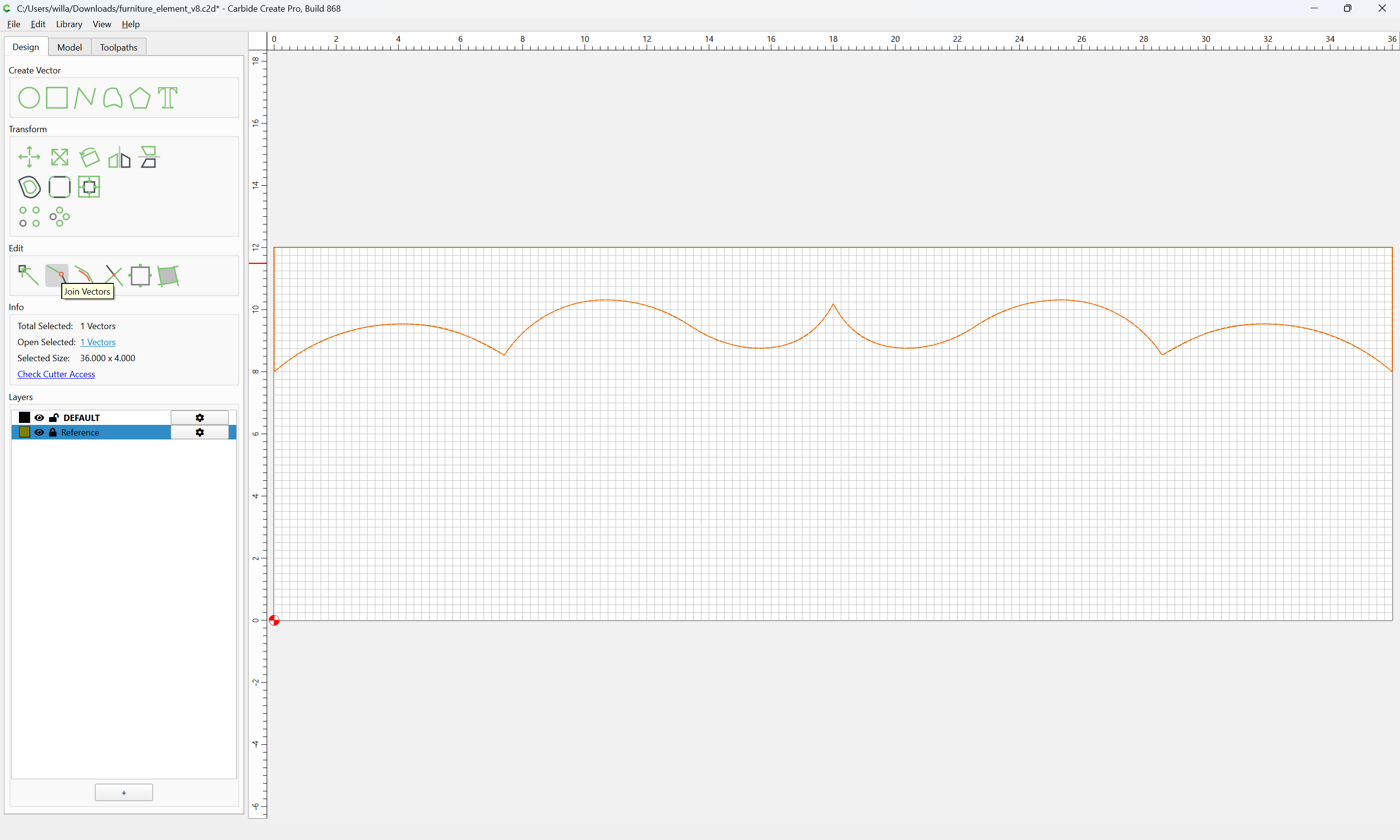

Select both halves
Join Vectors
Yes

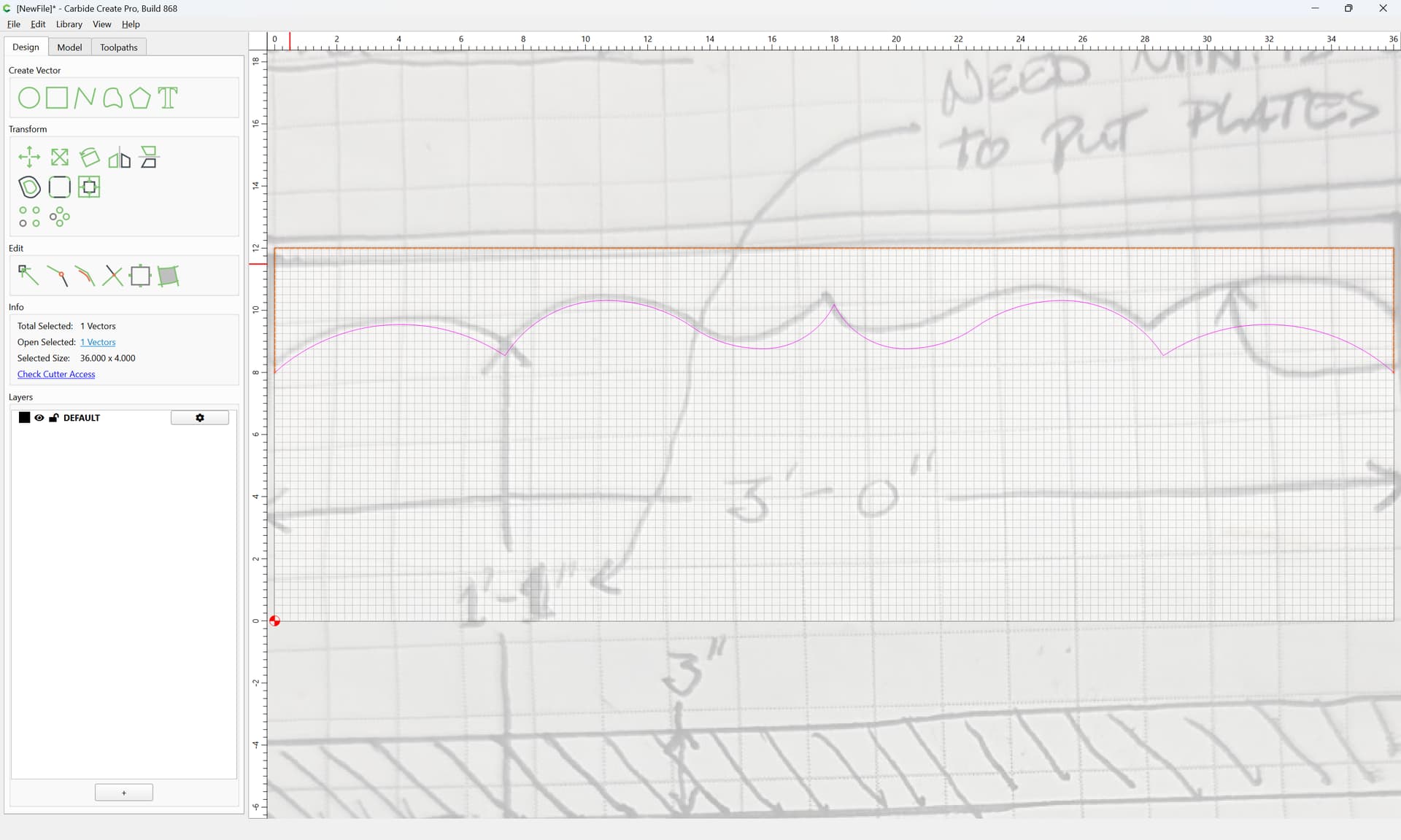

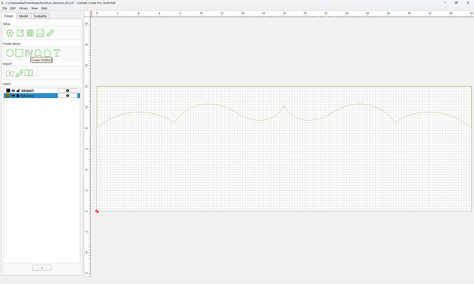

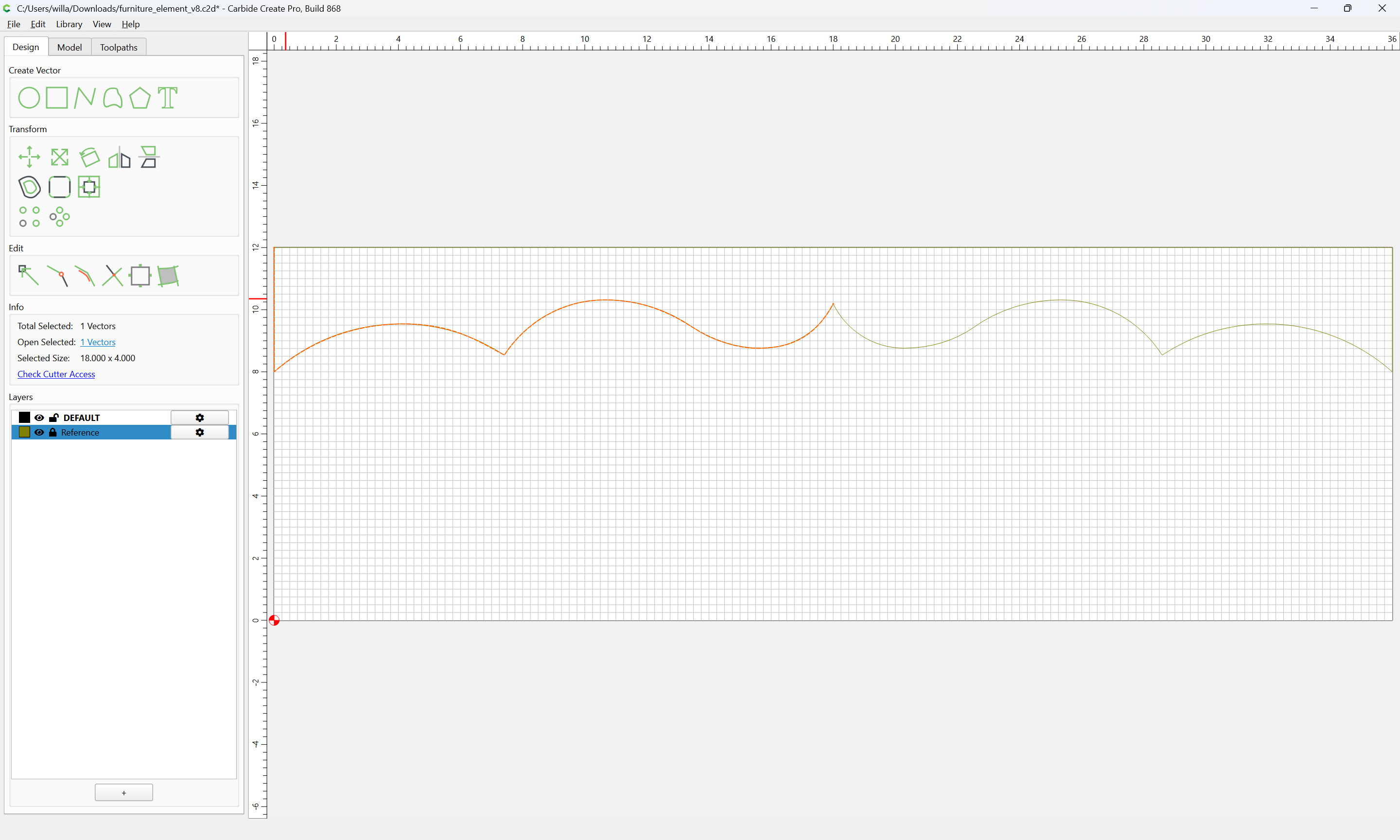

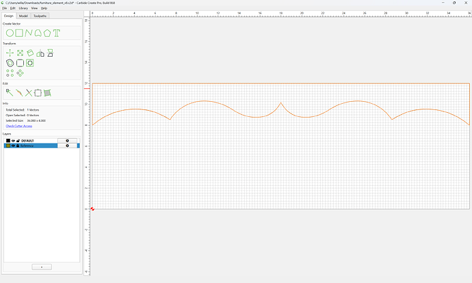

Drag to where desired against the grid:
draw in the balance of the part:
Done
Select all the elements:
and Join Vectors
Yes

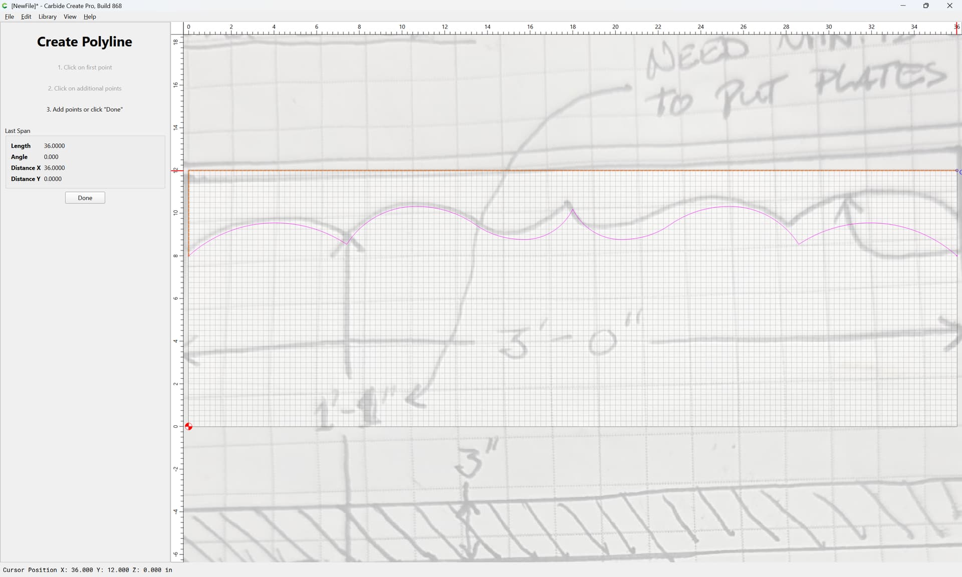

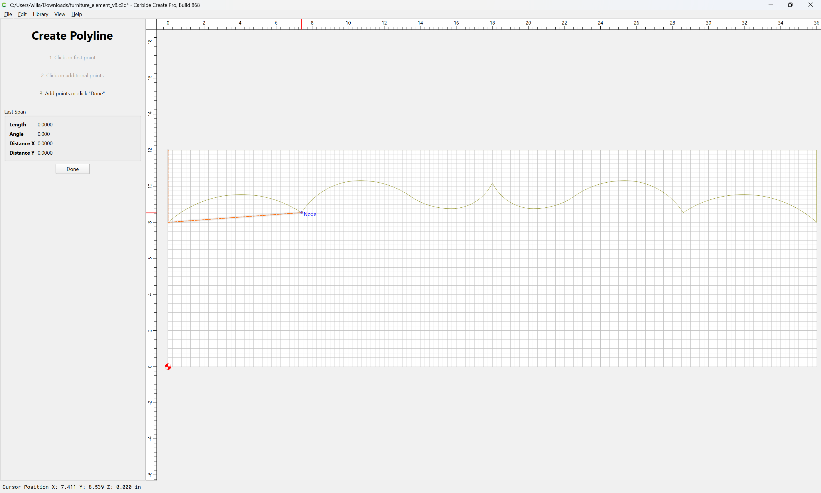

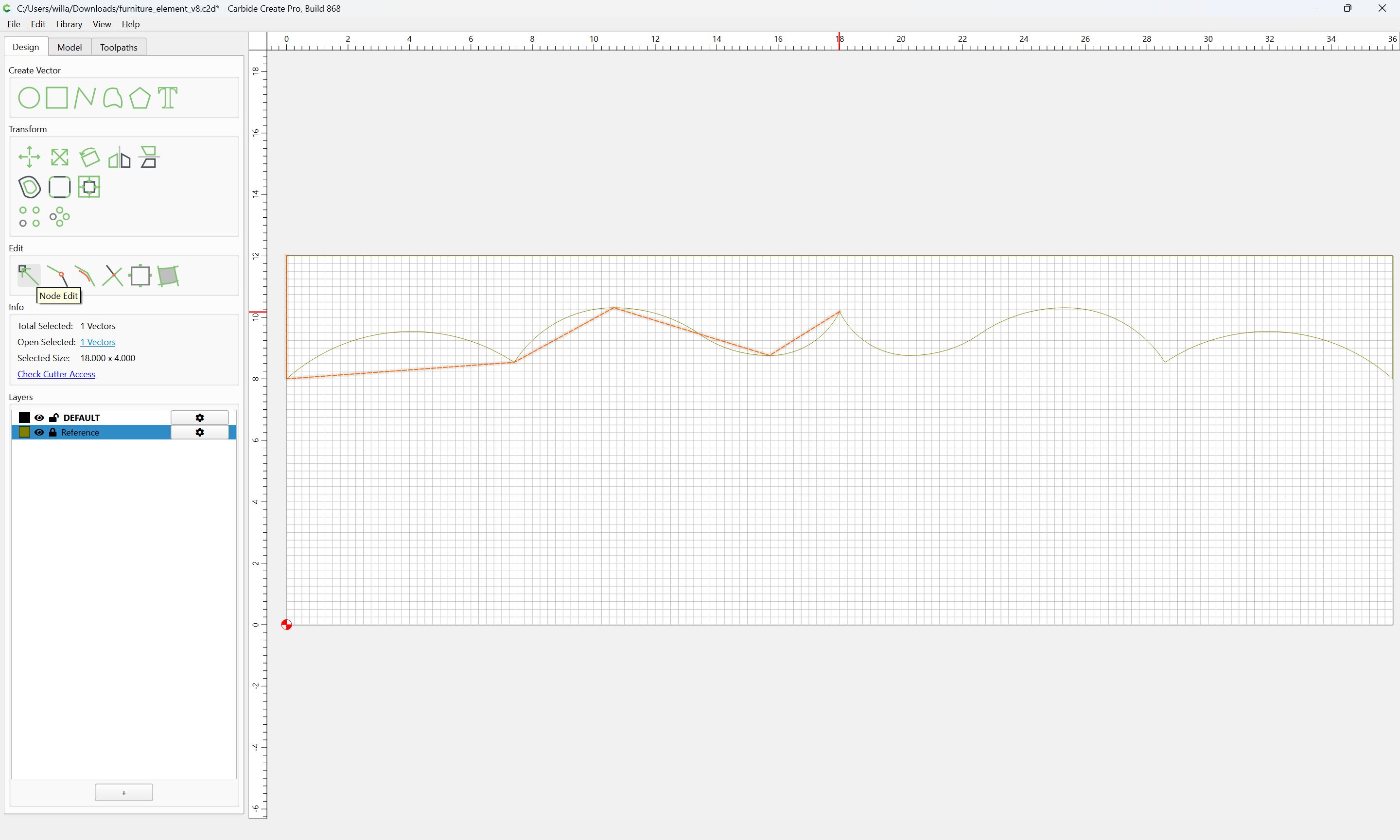

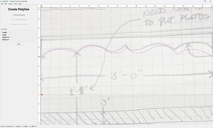

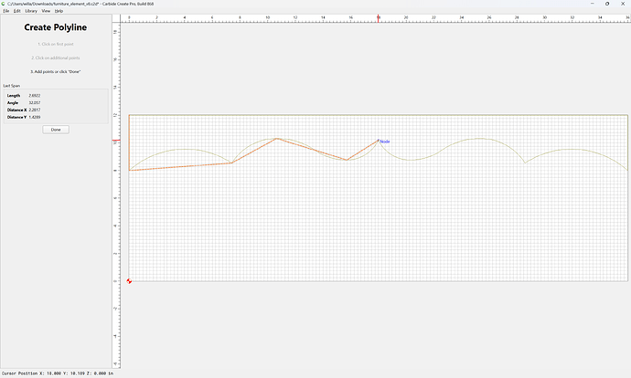

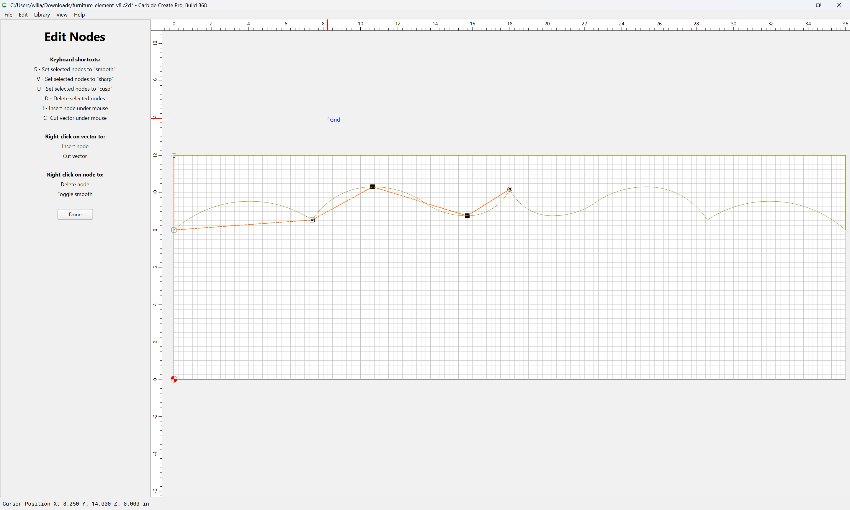

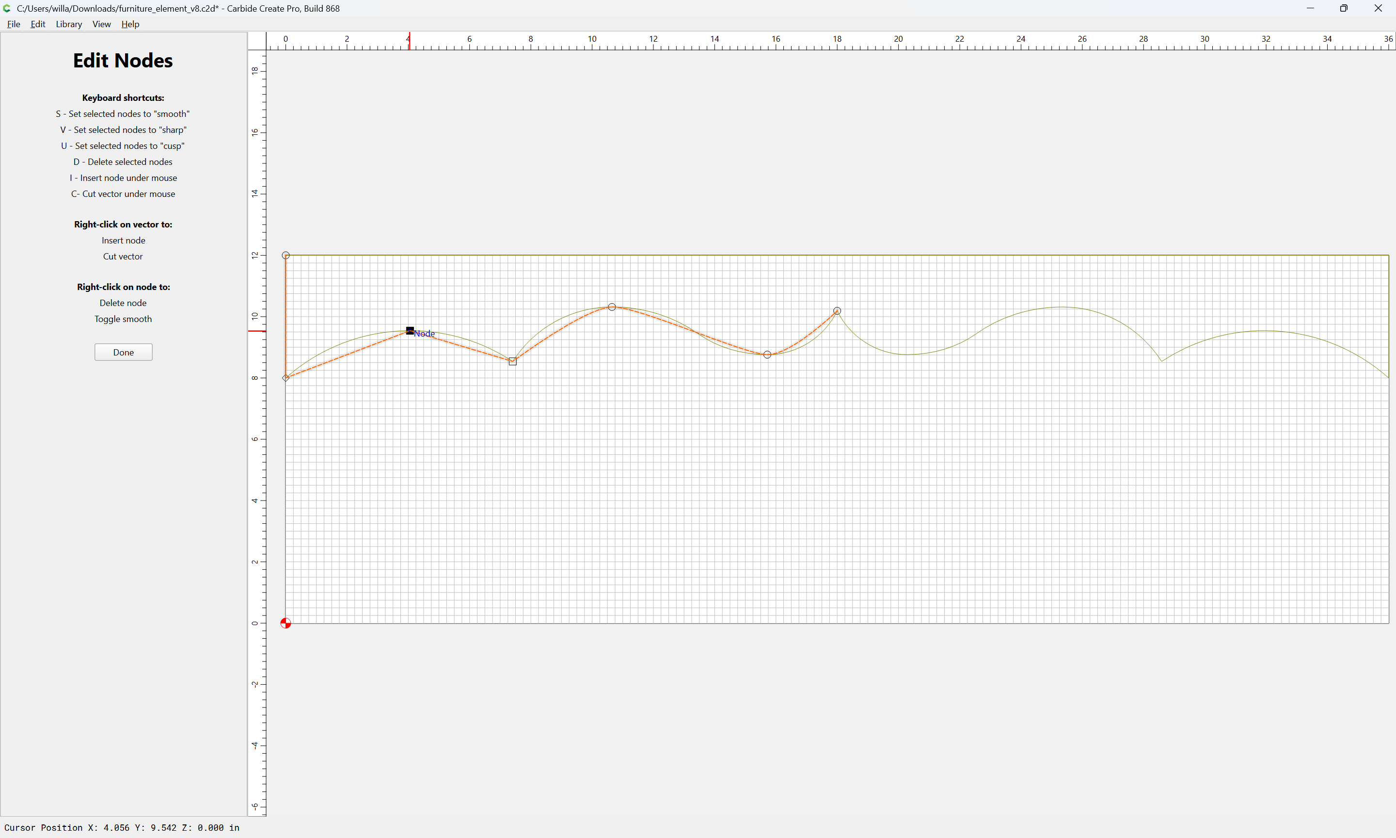

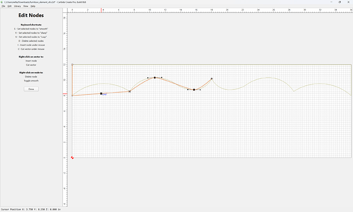

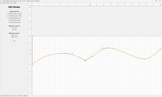

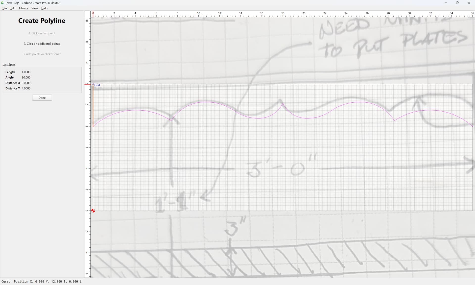

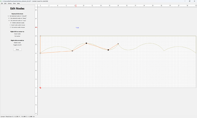

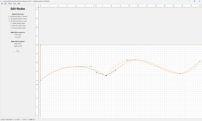

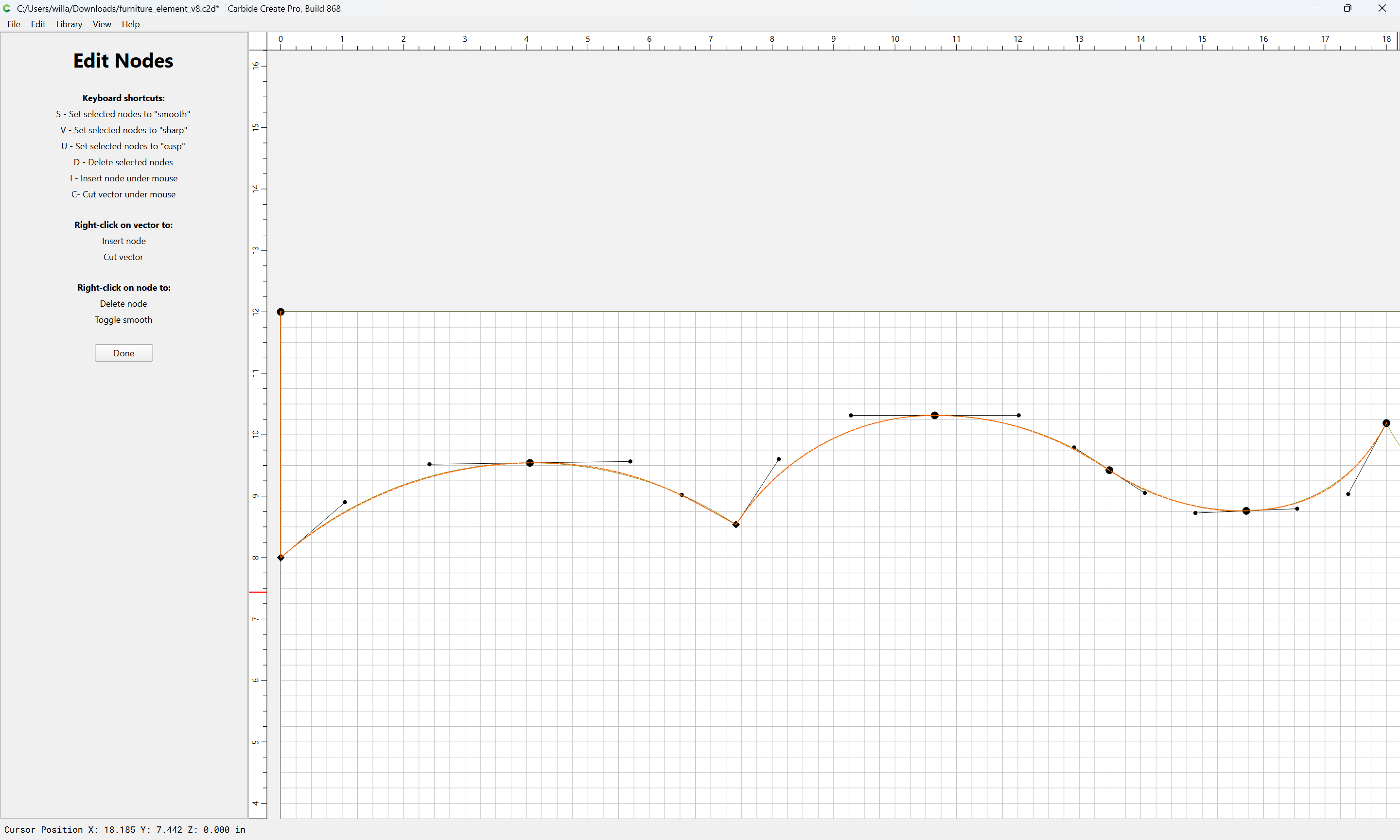

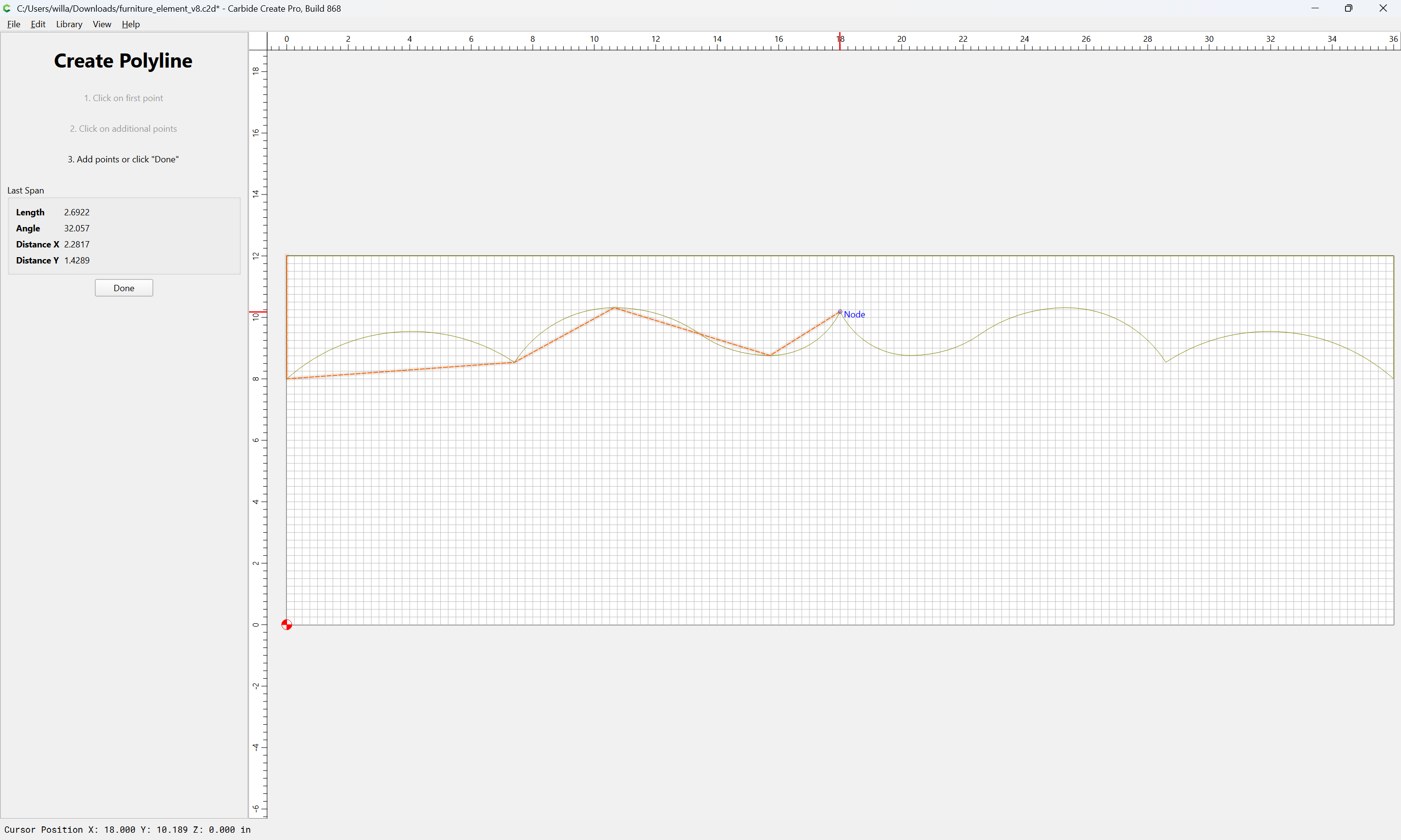

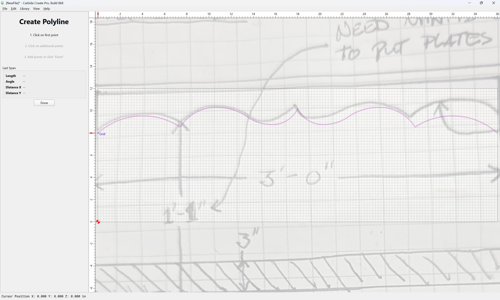

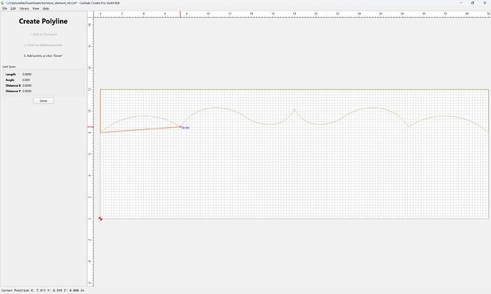

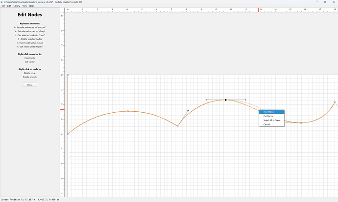

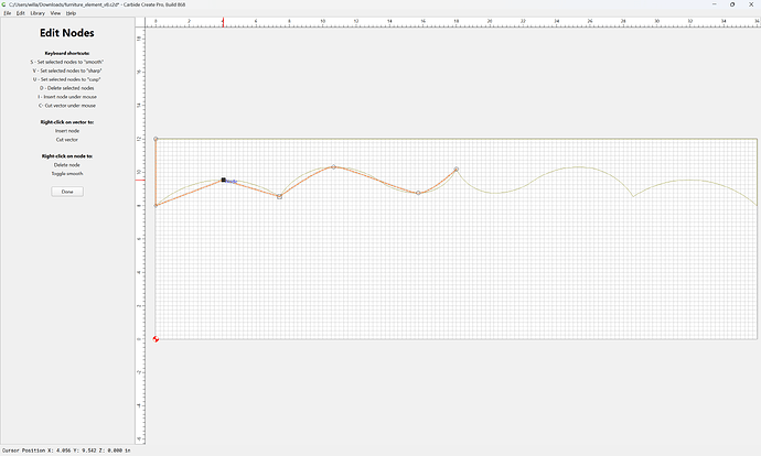

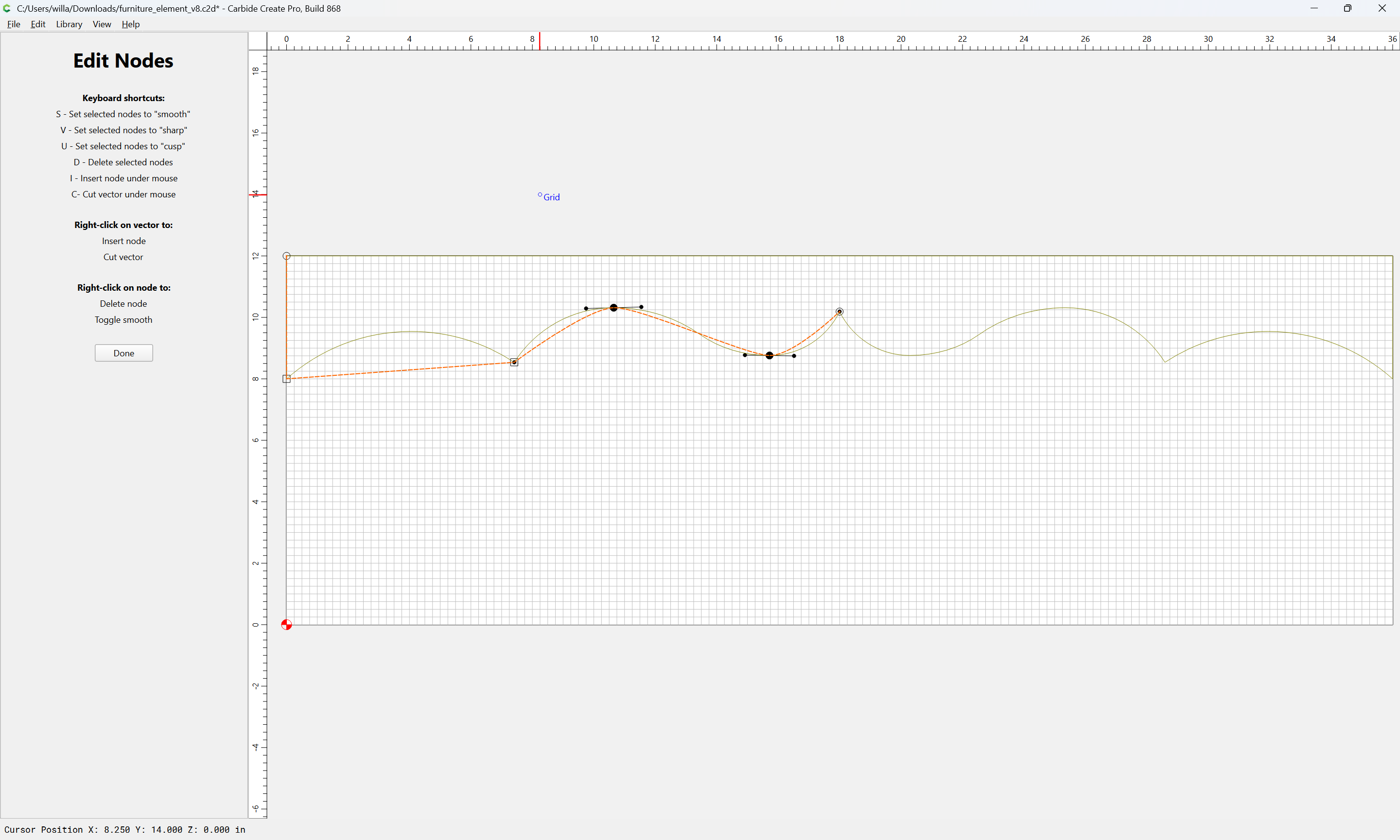

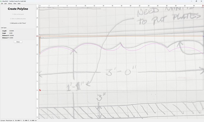

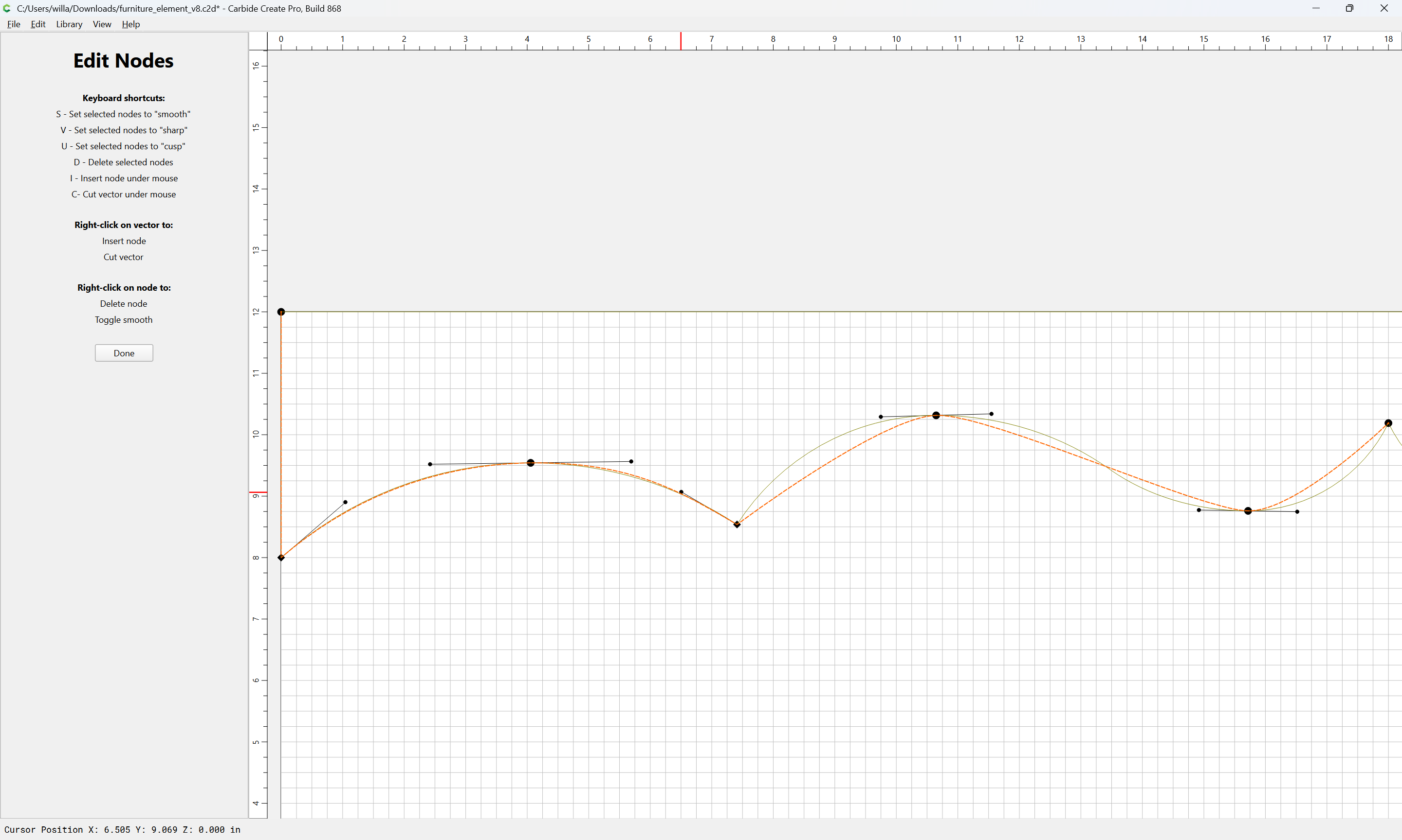

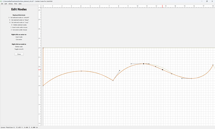

Alternately, one could just draw this:
Use the polyline tool to place the on-curve points:
Done

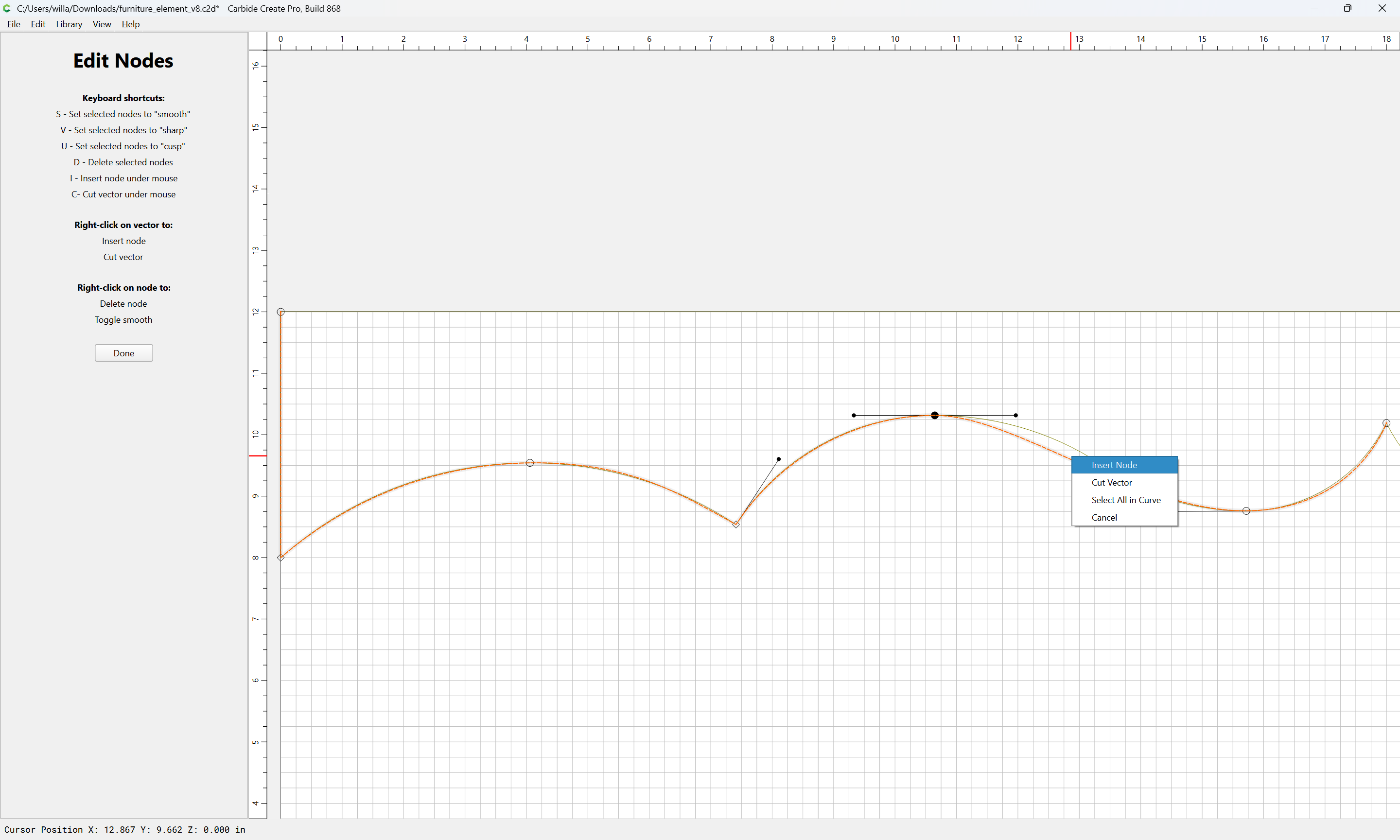

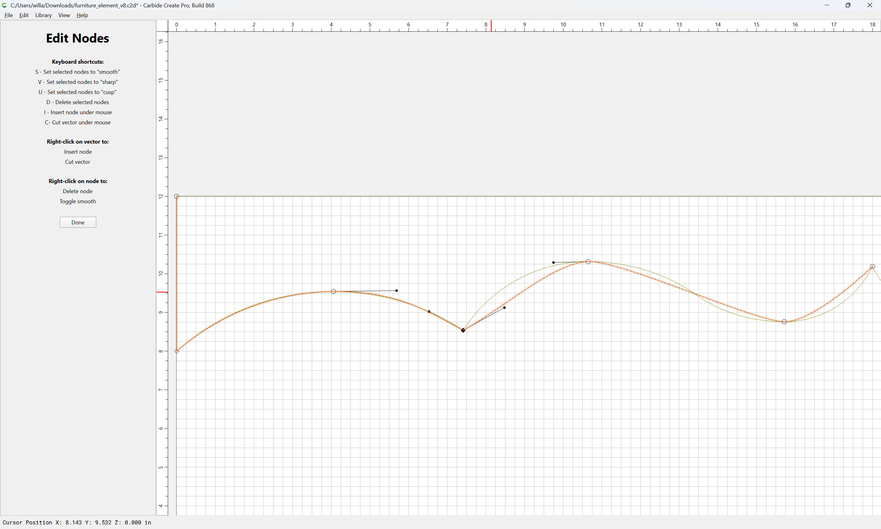

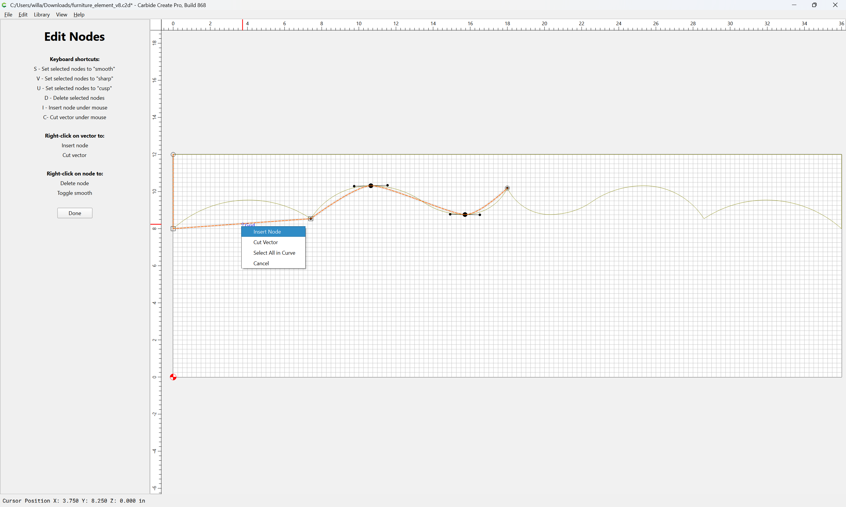

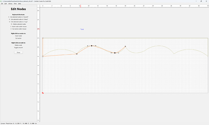

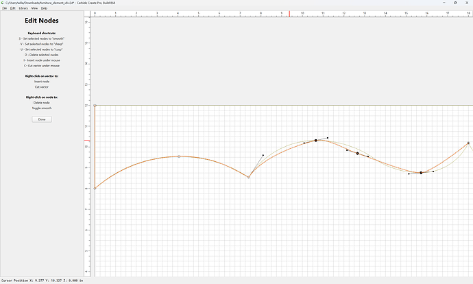

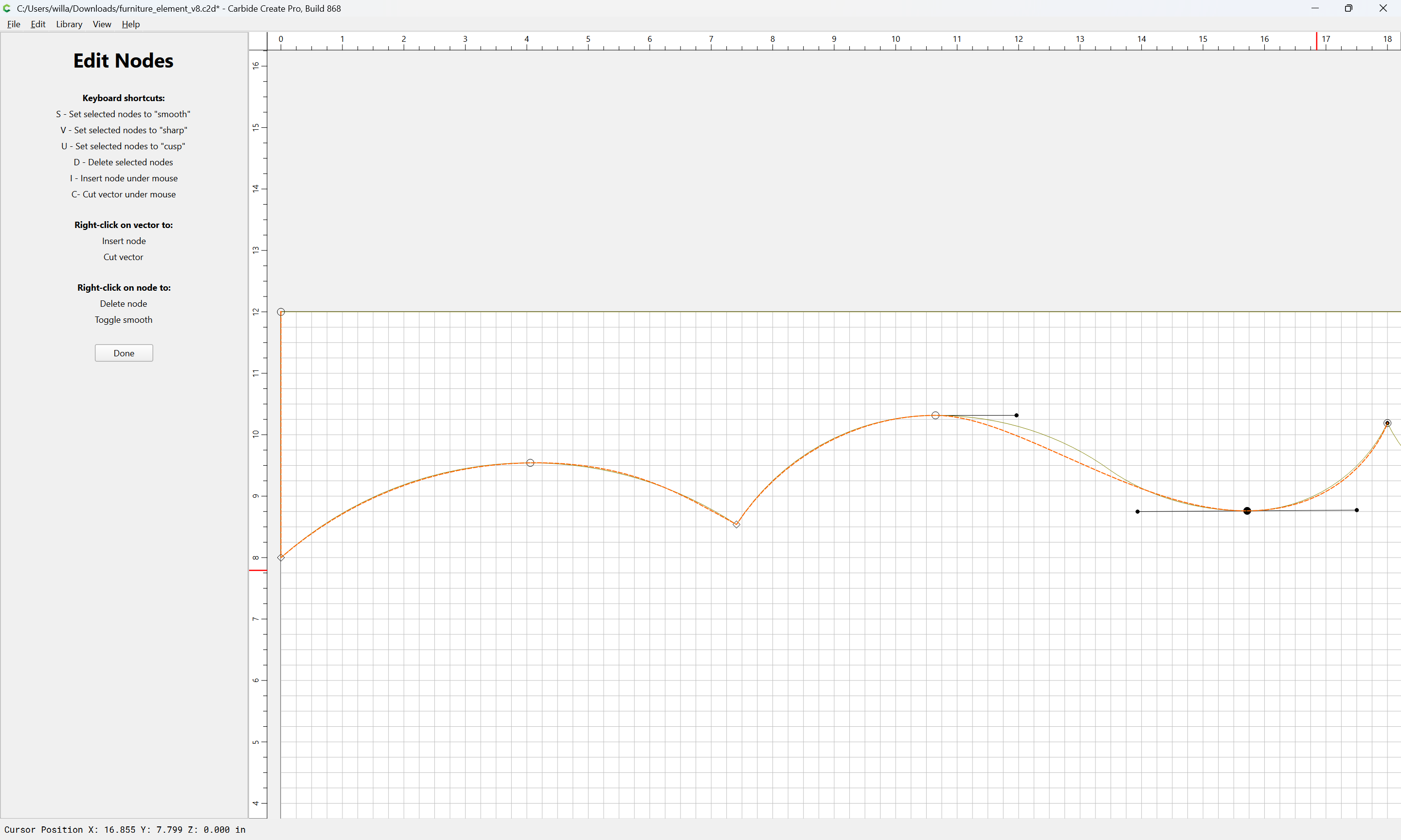

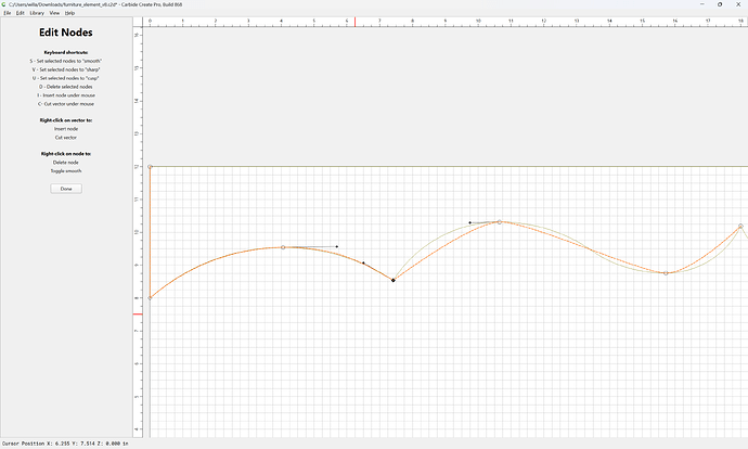

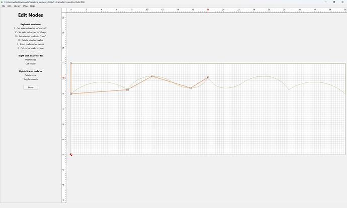

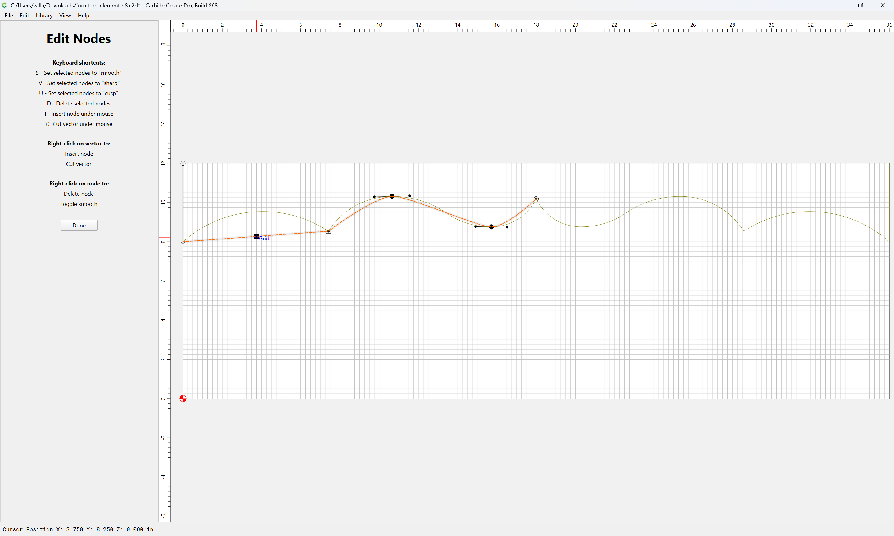

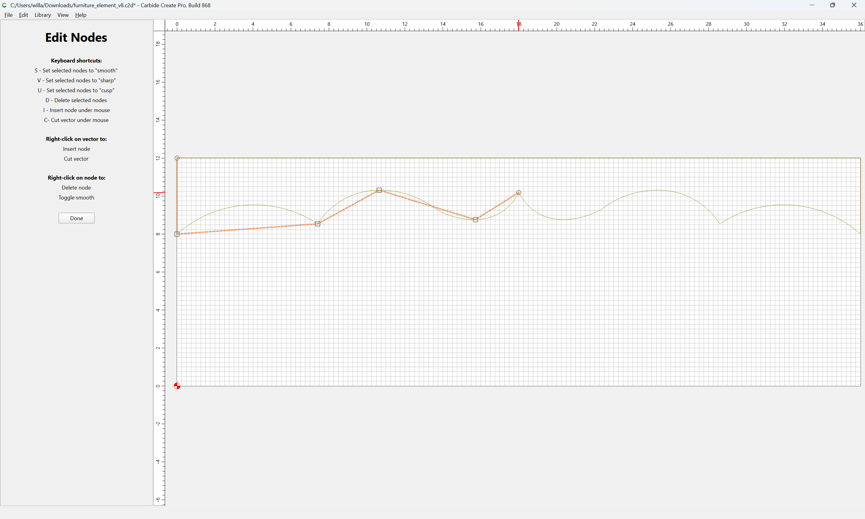

Go into Node Edit mode:
and select nodes and make them smooth:
s
if a node was forgotten, right-click and Insert Node

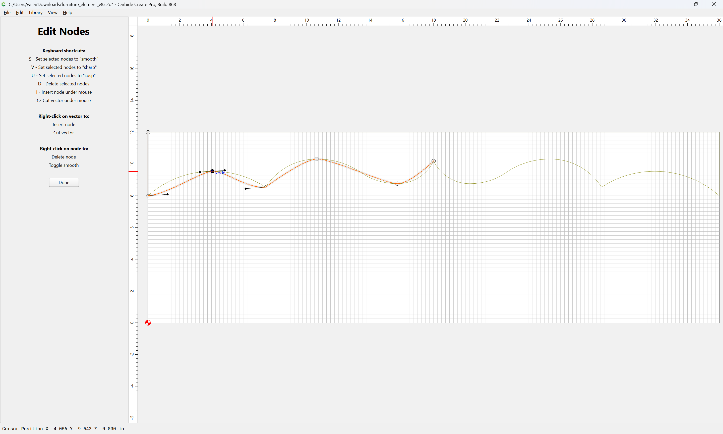

Move it into position:
and smooth it as well, s

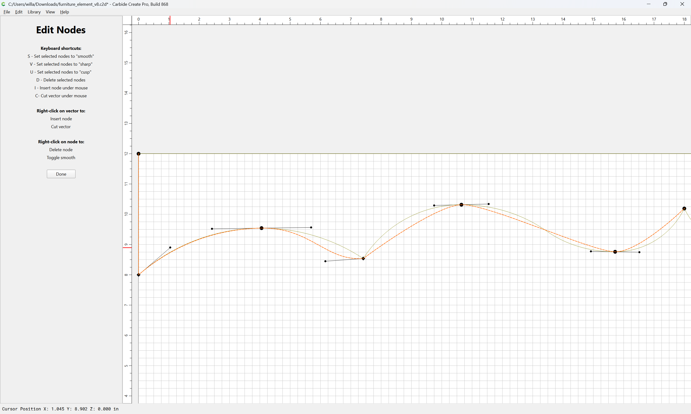

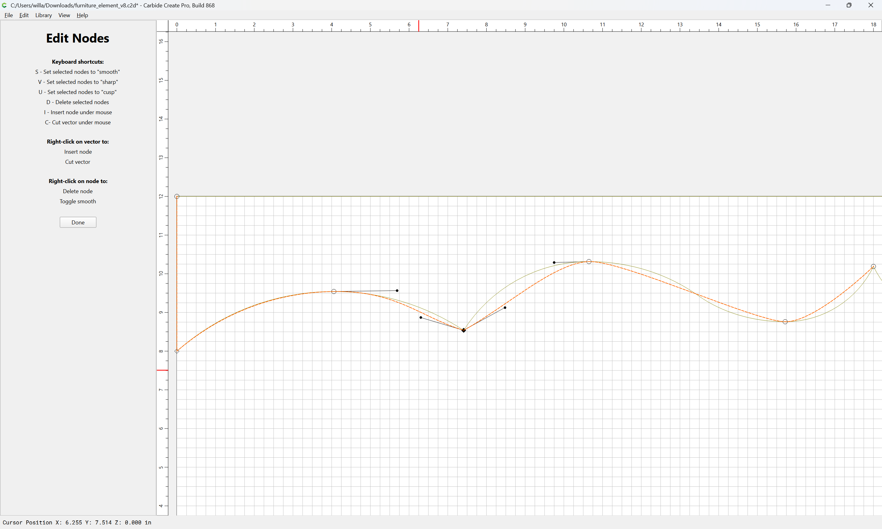

drag and adjust nodes until the desired design is arrived at:

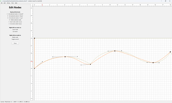

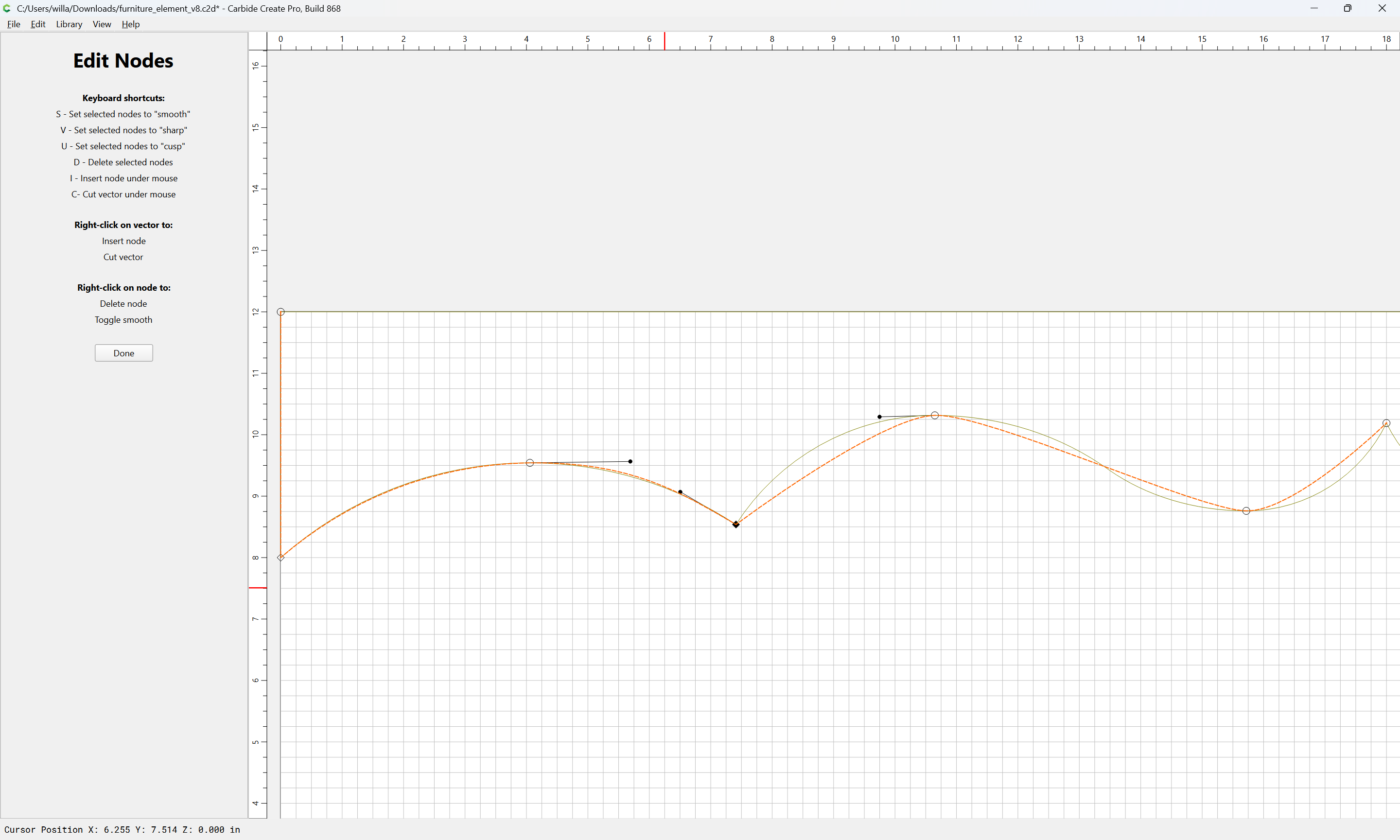

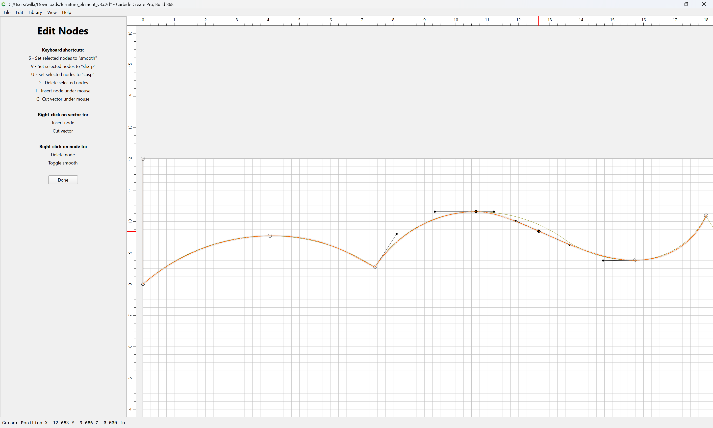

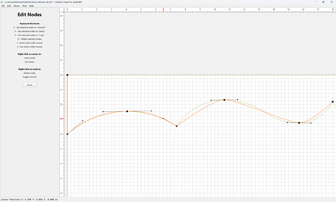

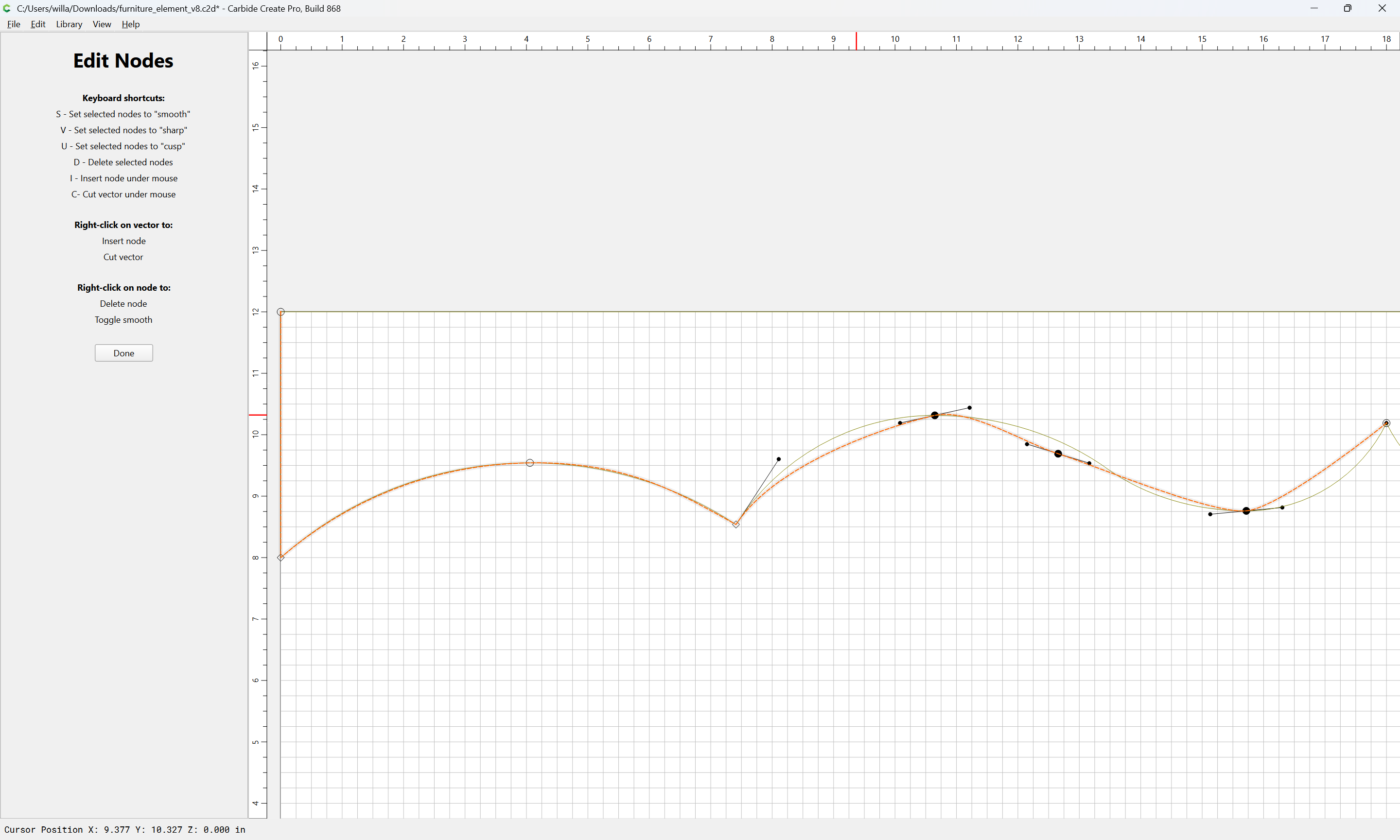

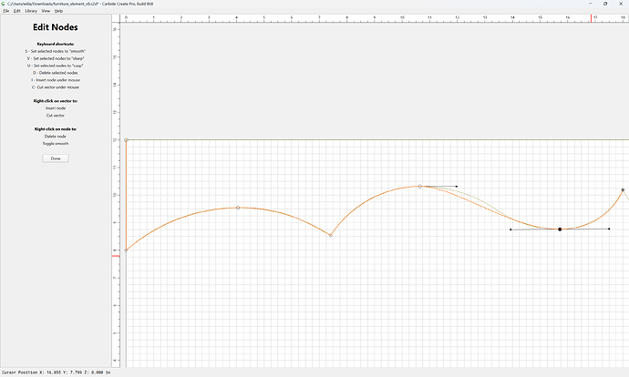

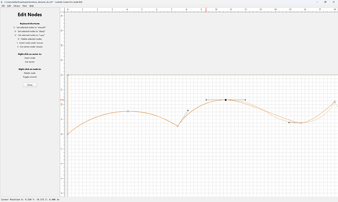

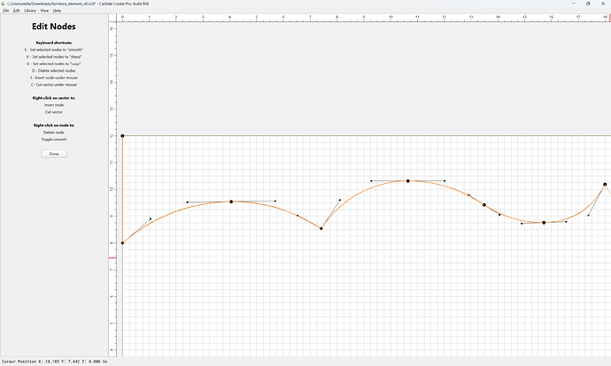

If an off-curve node is missing, select the on-curve node:
and press u to make it a cusp:
If need be, add a node at a point of inflection:
and if desired, make things smooth again:

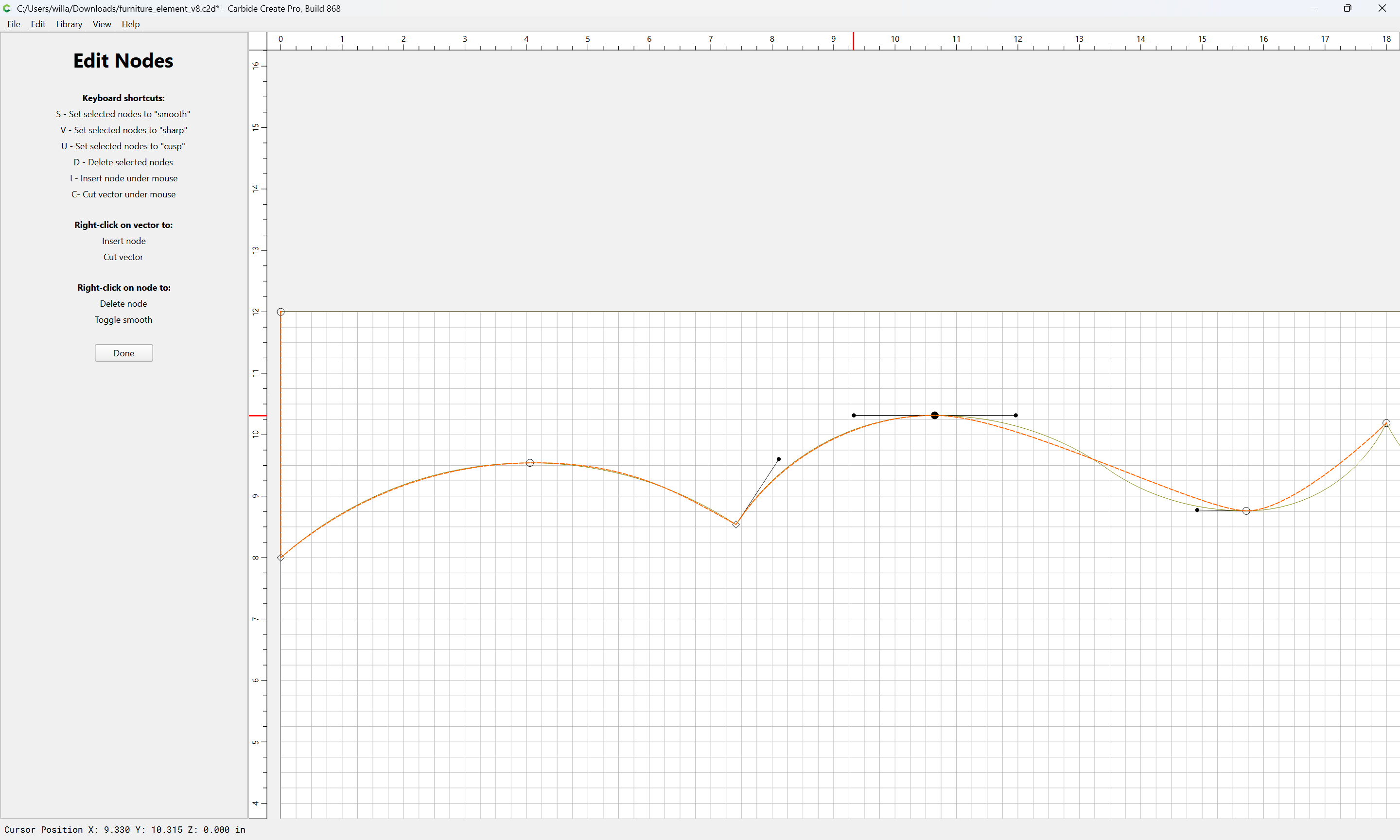

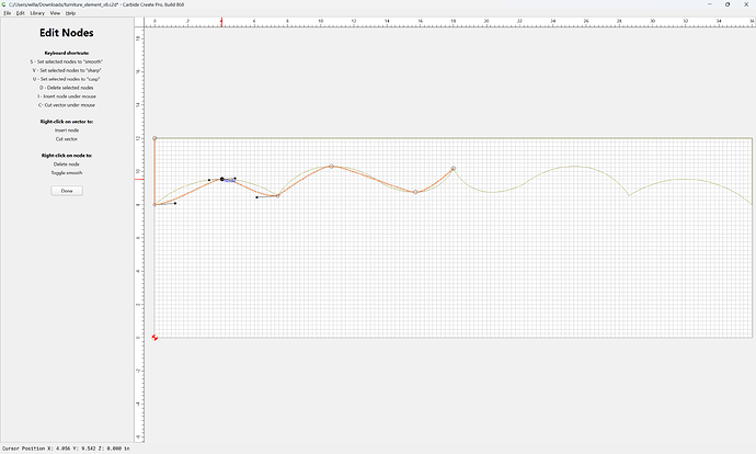

Continue adjusting until one arrives at half:
Done

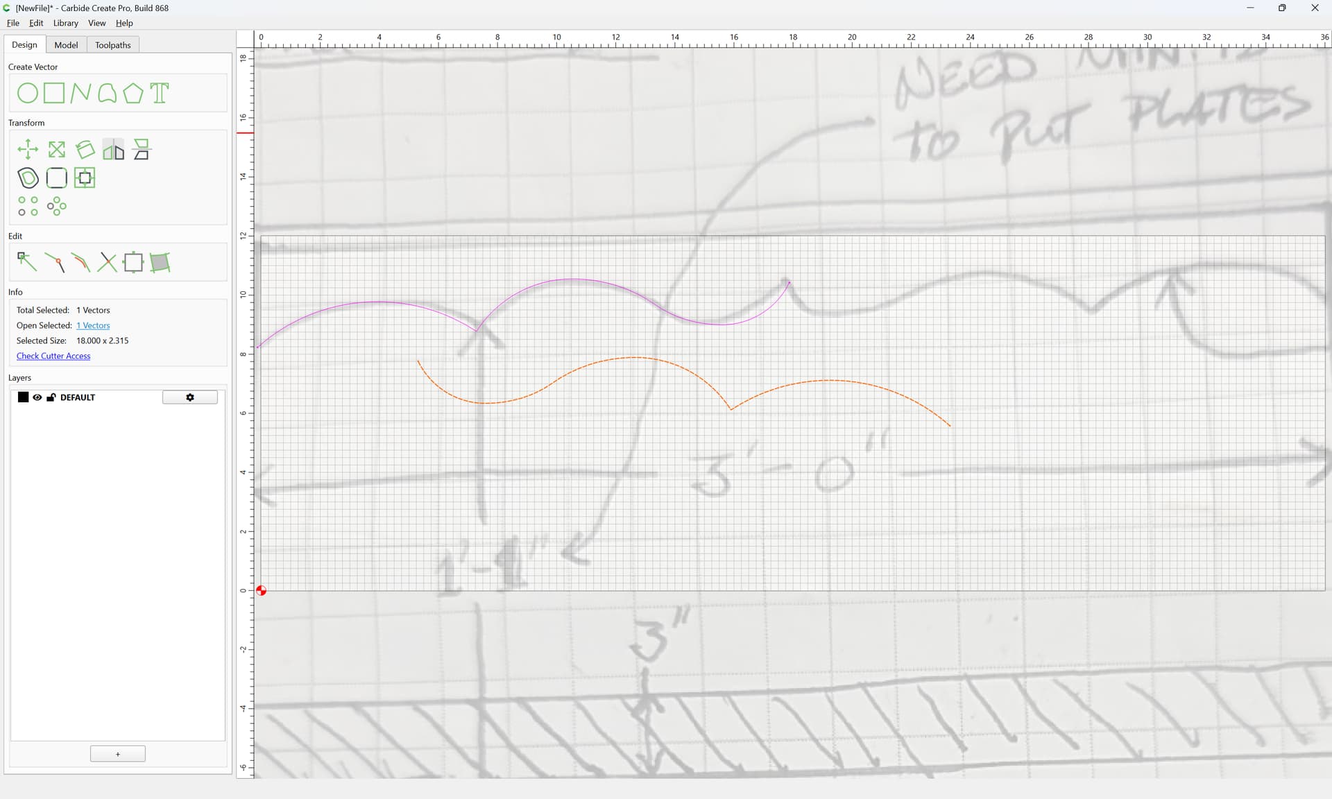

as before, duplicate:
Mirror horizontal
n
and drag into registration:
Select all
Join Vectors
Yes
and repeat to close
Yes
