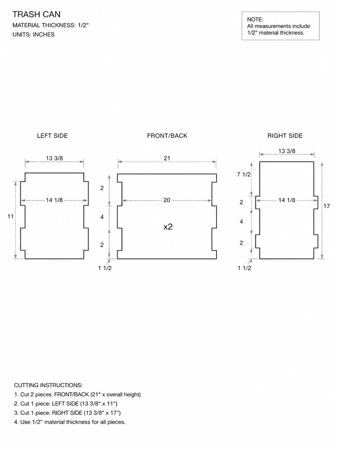

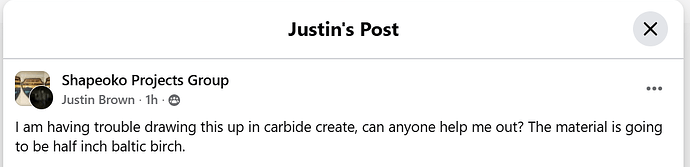

Drawing up a trash can w/ box joints

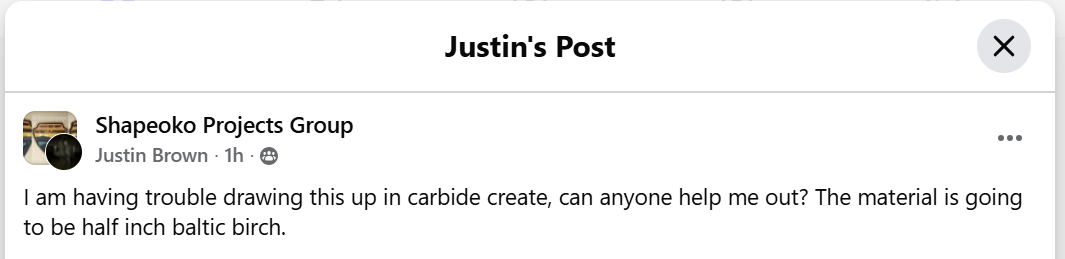

as requested on Facebook…
https://www.facebook.com/groups/122946902437953/

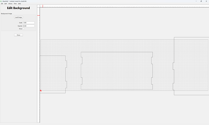

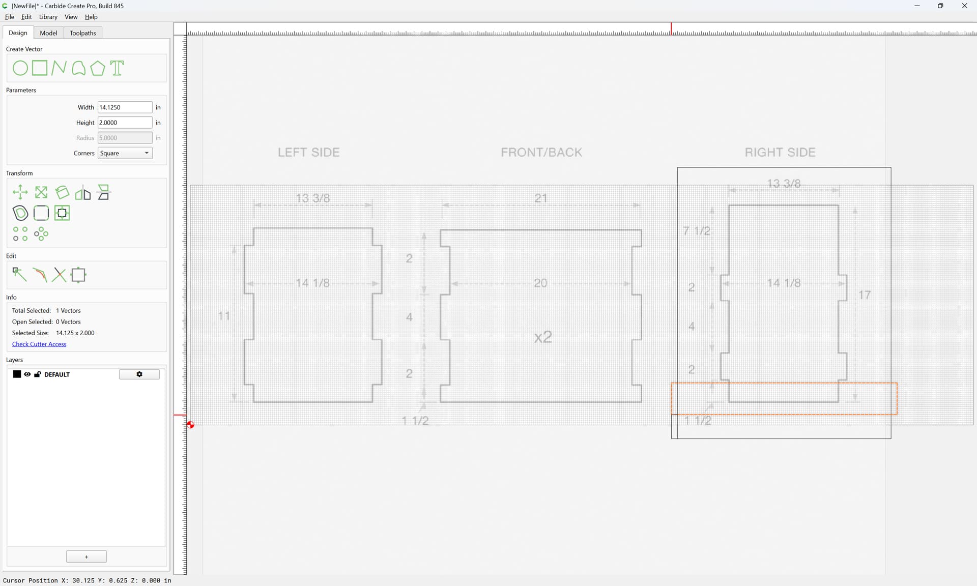

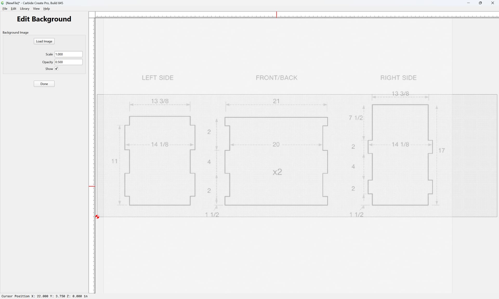

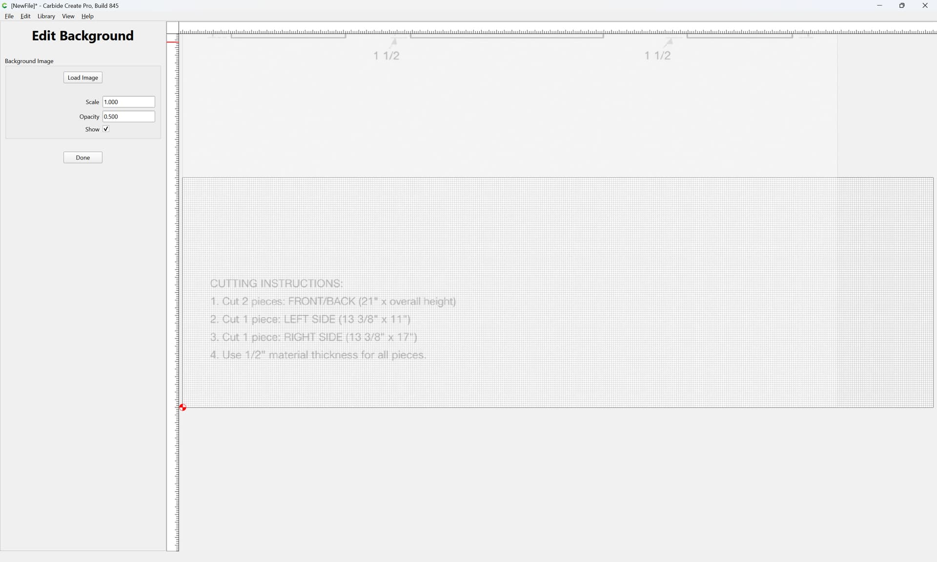

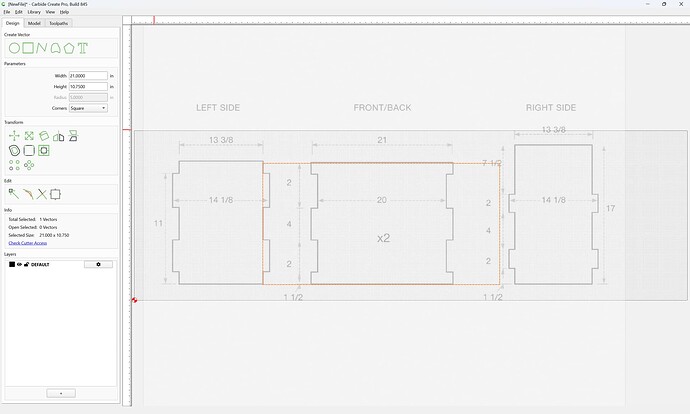

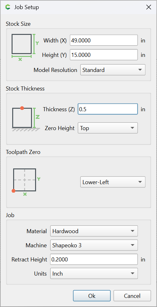

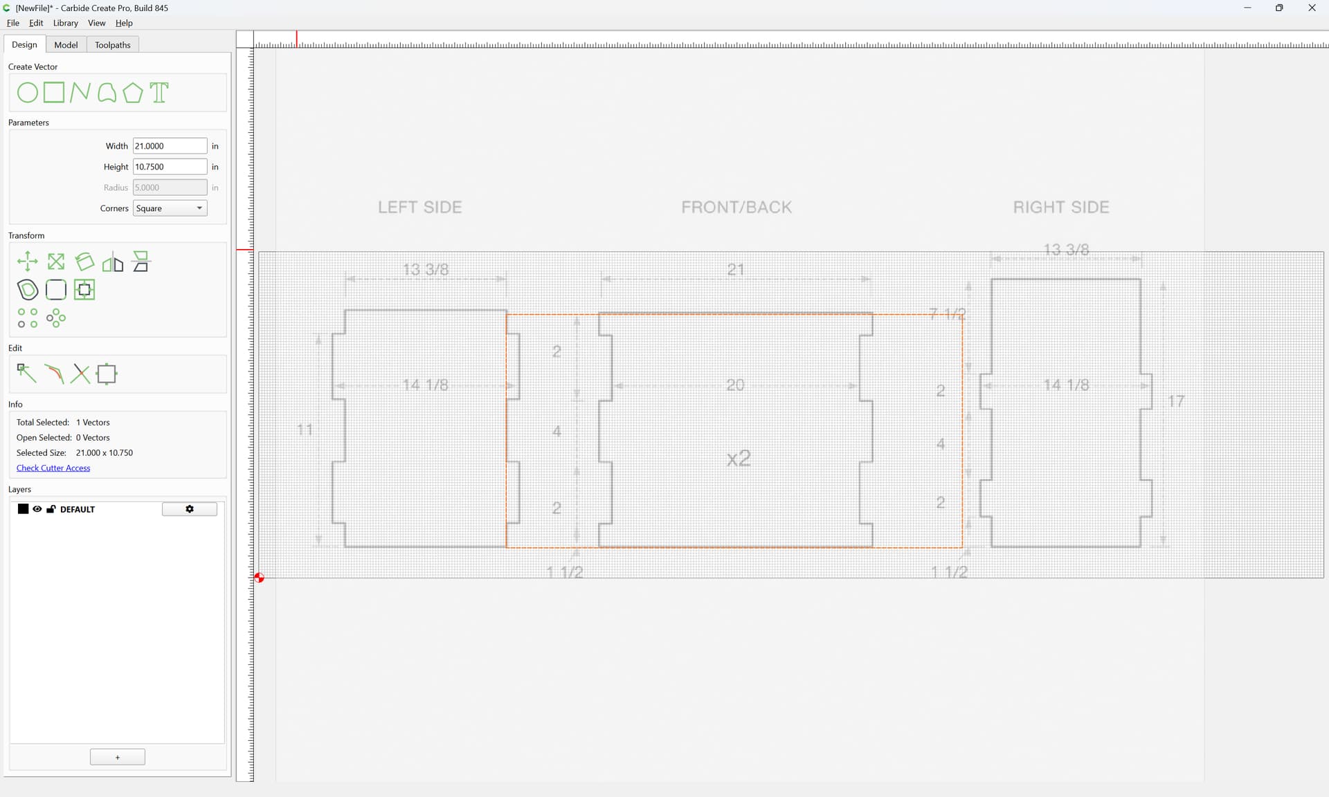

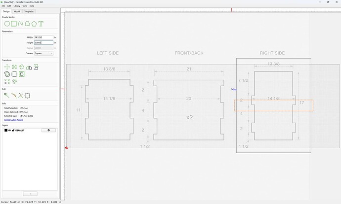

First, Job Setup:

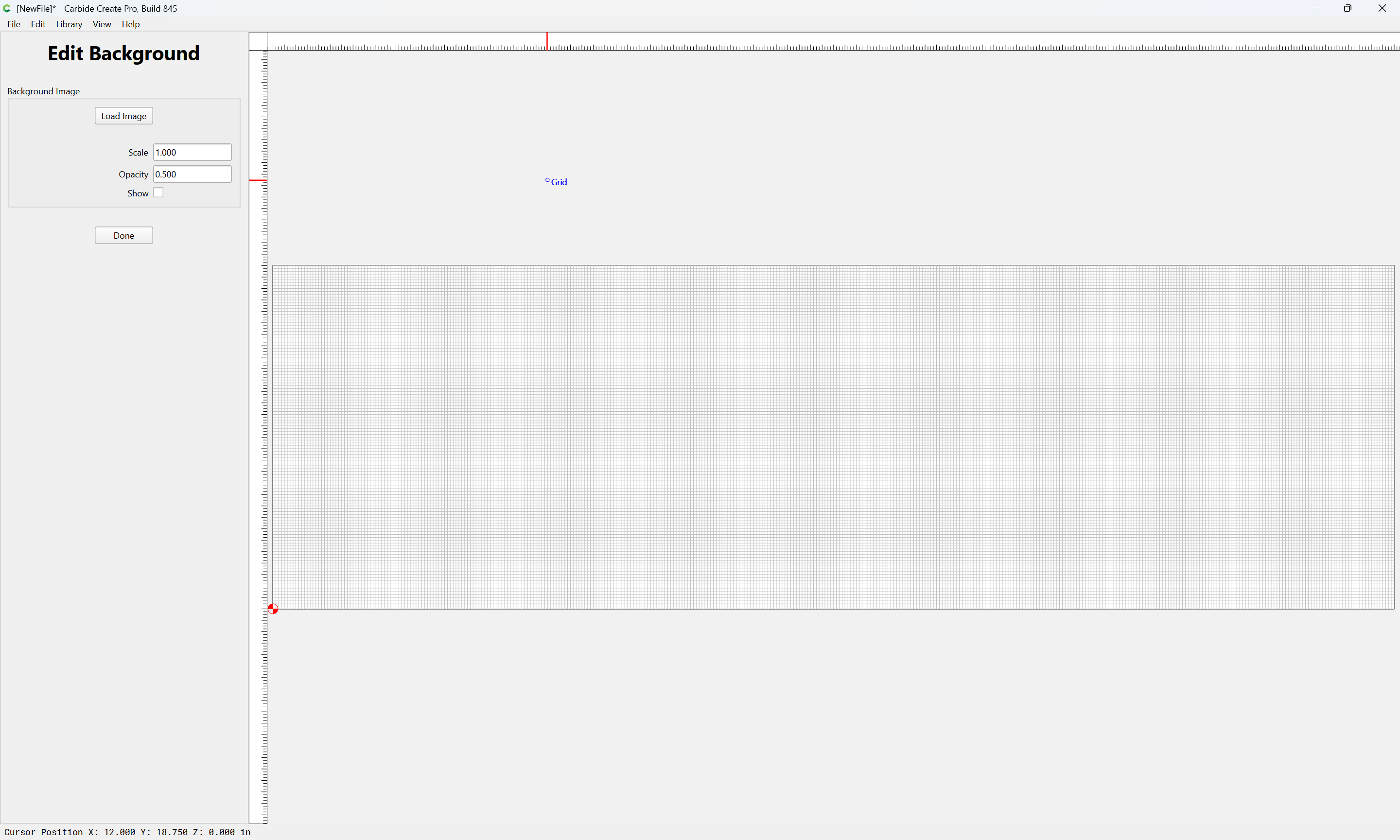

Set Background
Load Image
Drag into position

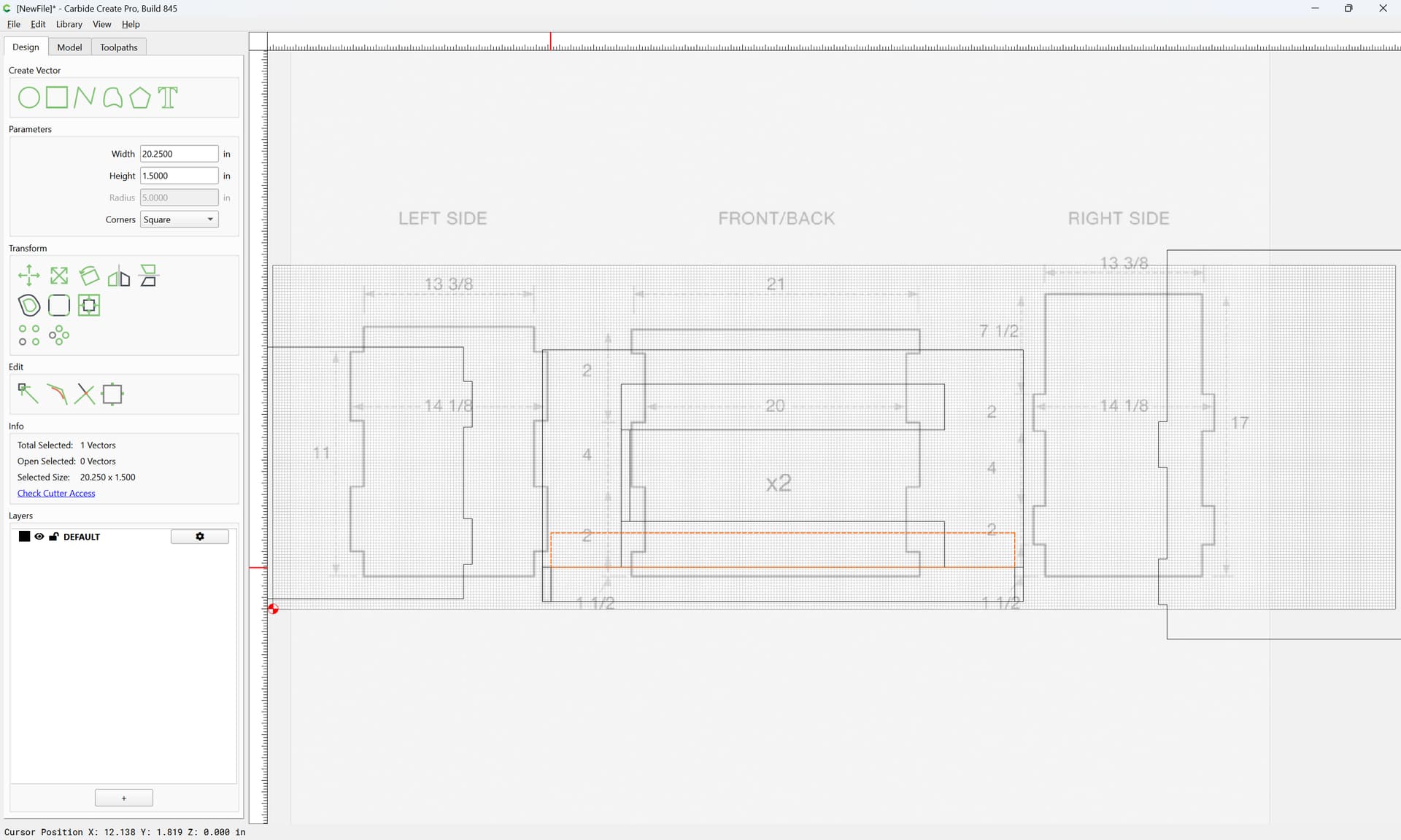

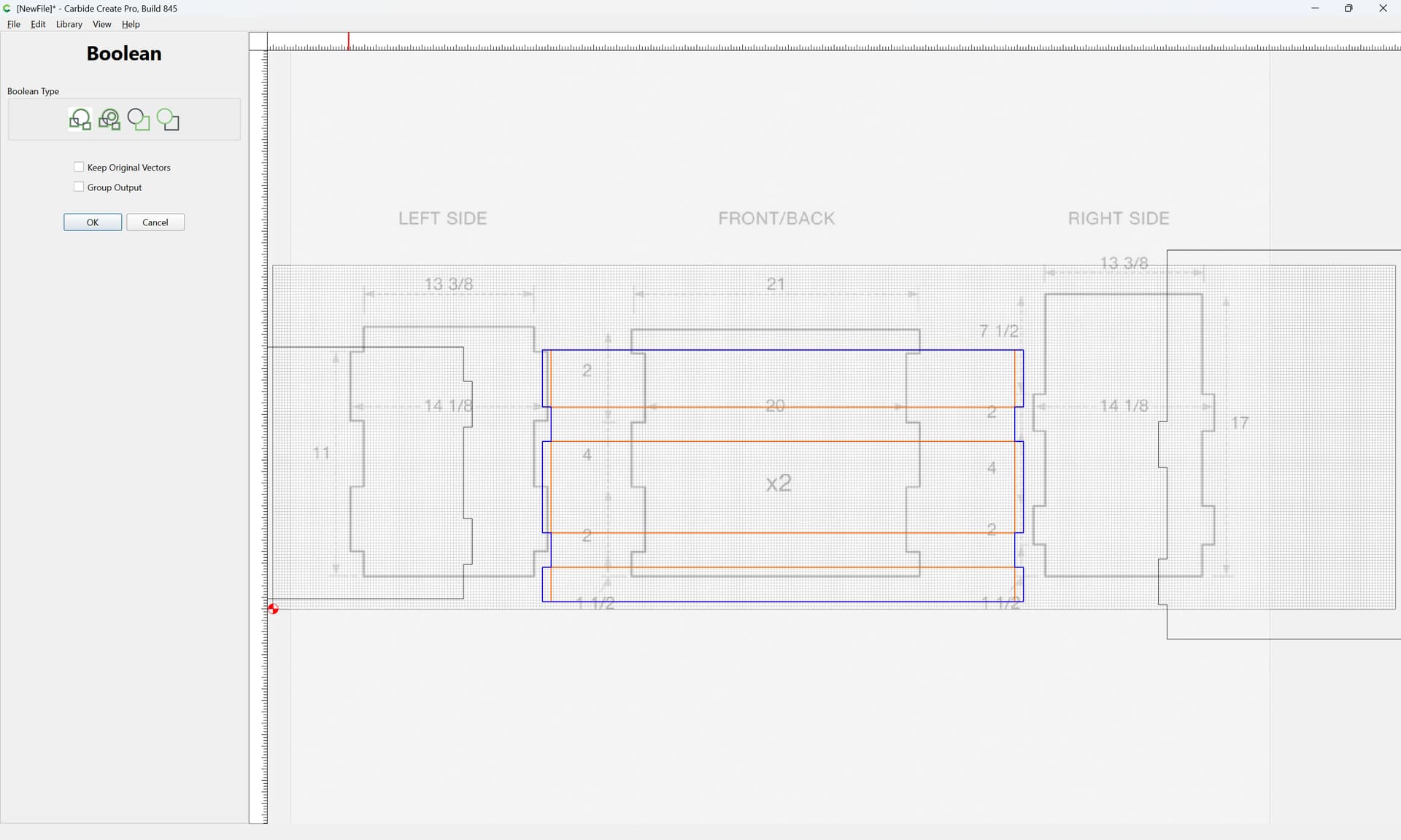

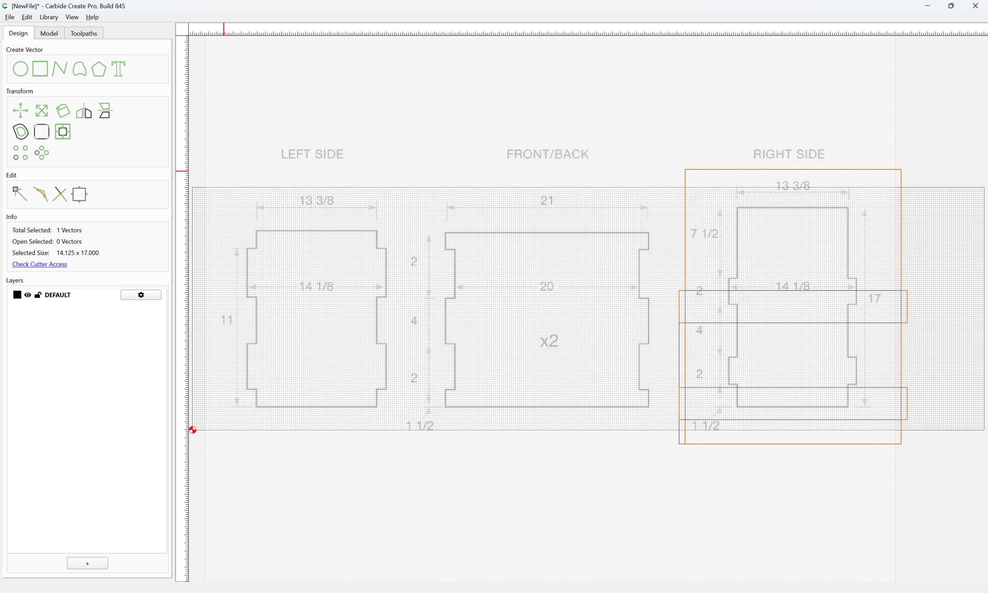

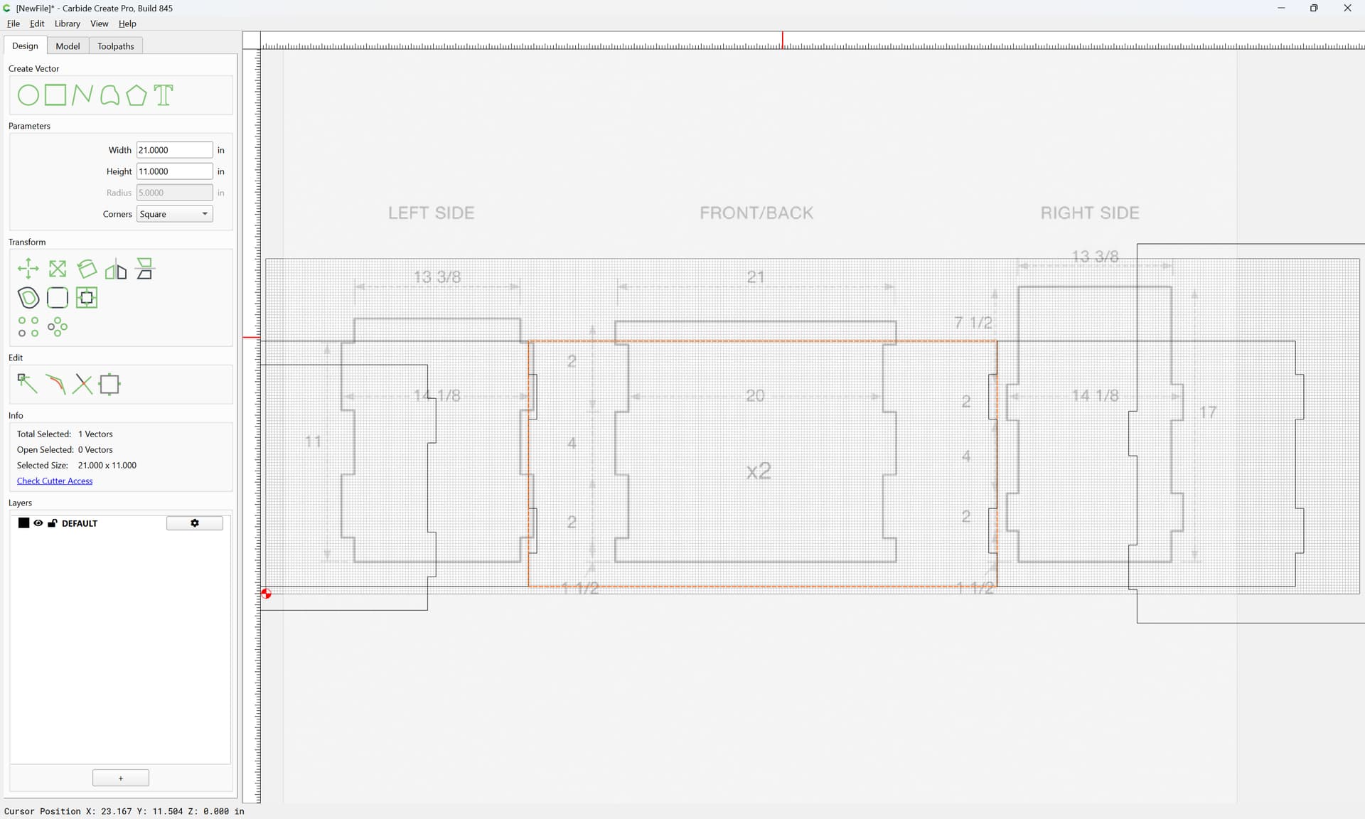

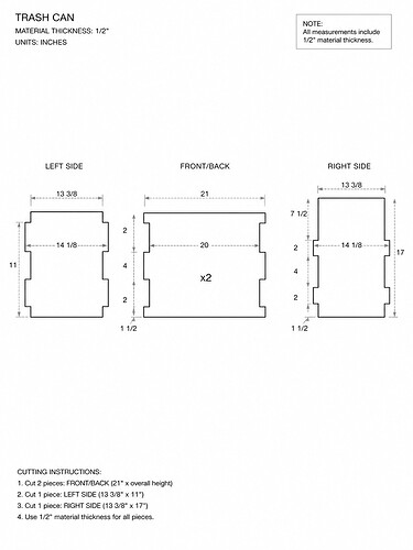

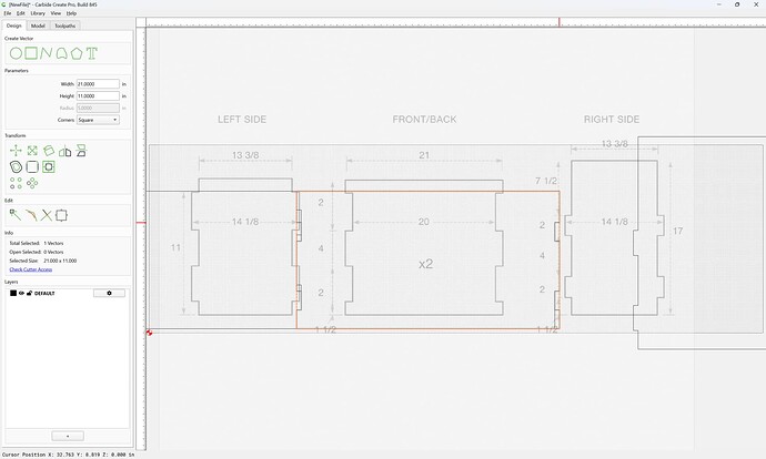

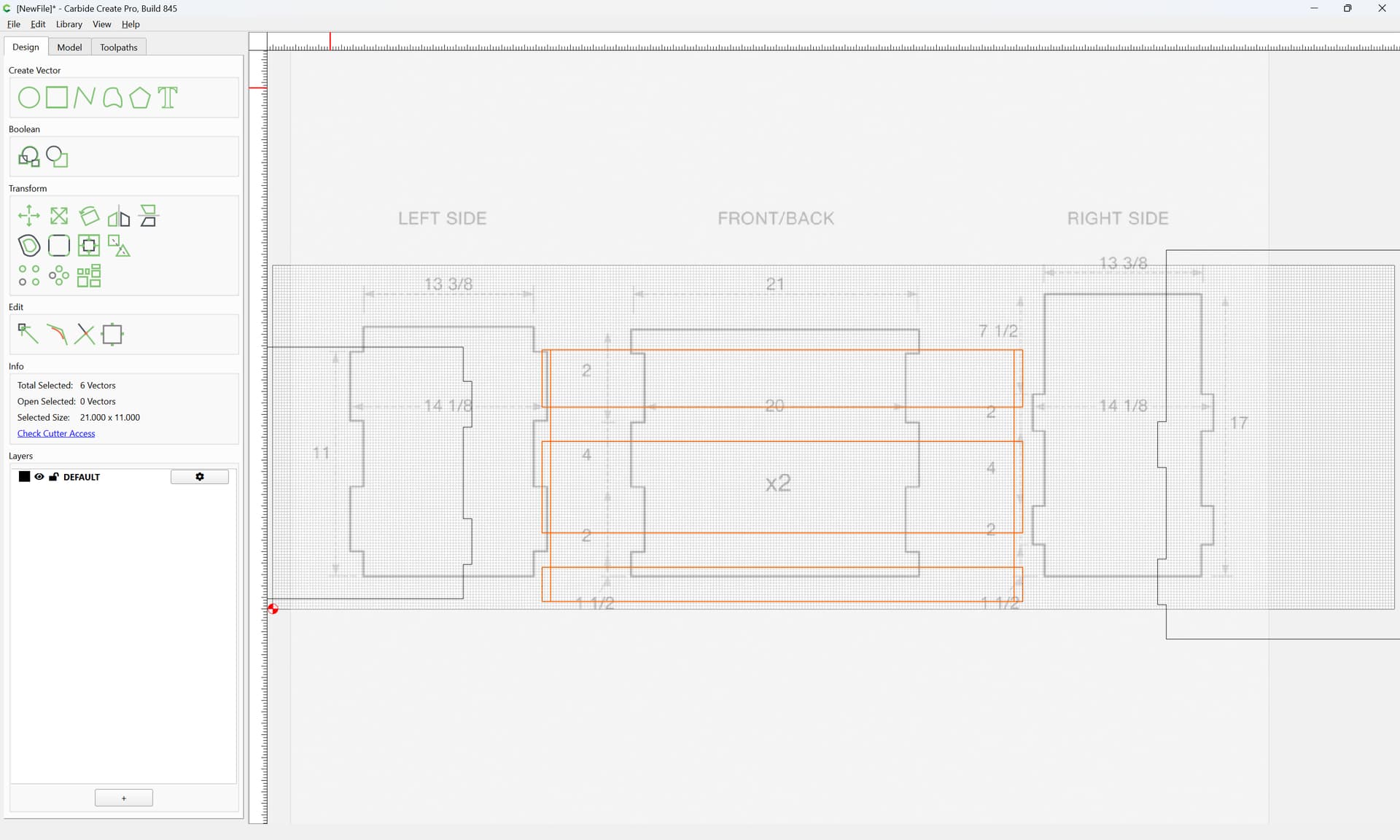

Draw a rectangle of the right size as a size check:

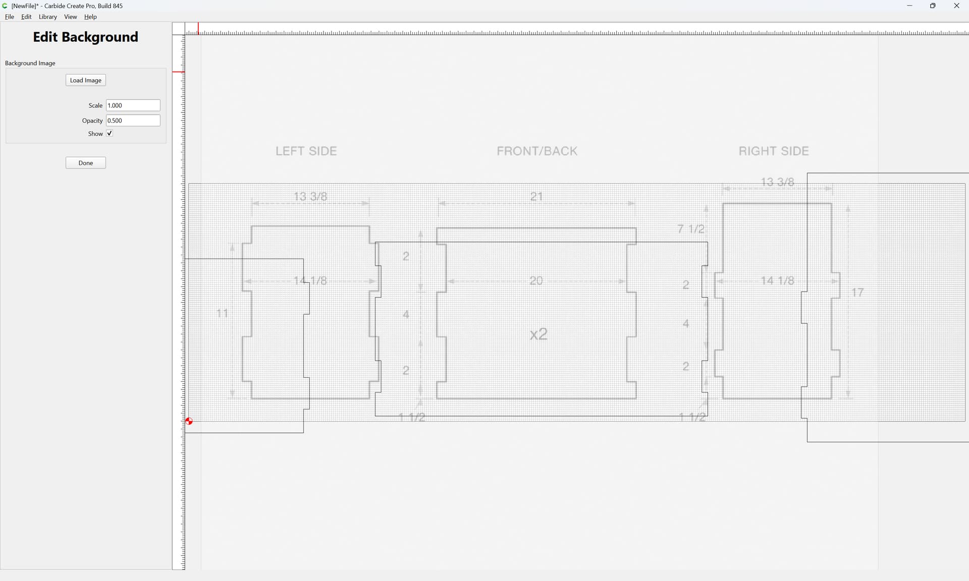

and it’s obvious that the drawing and dimensions do not match up…

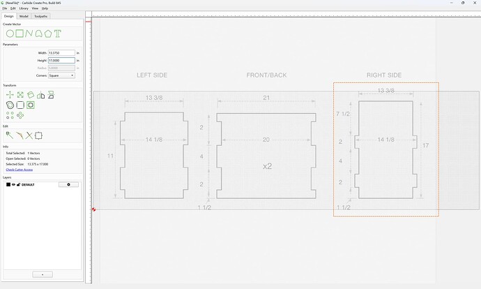

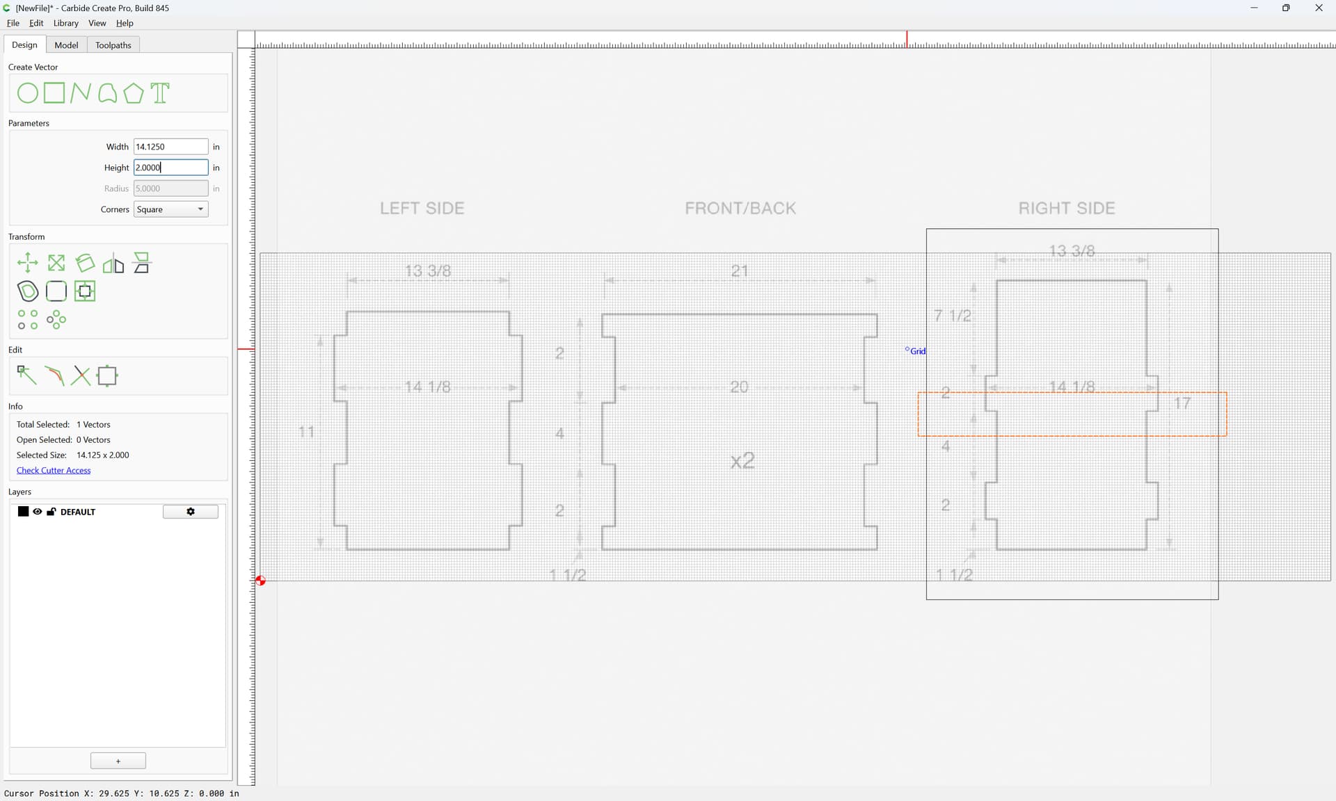

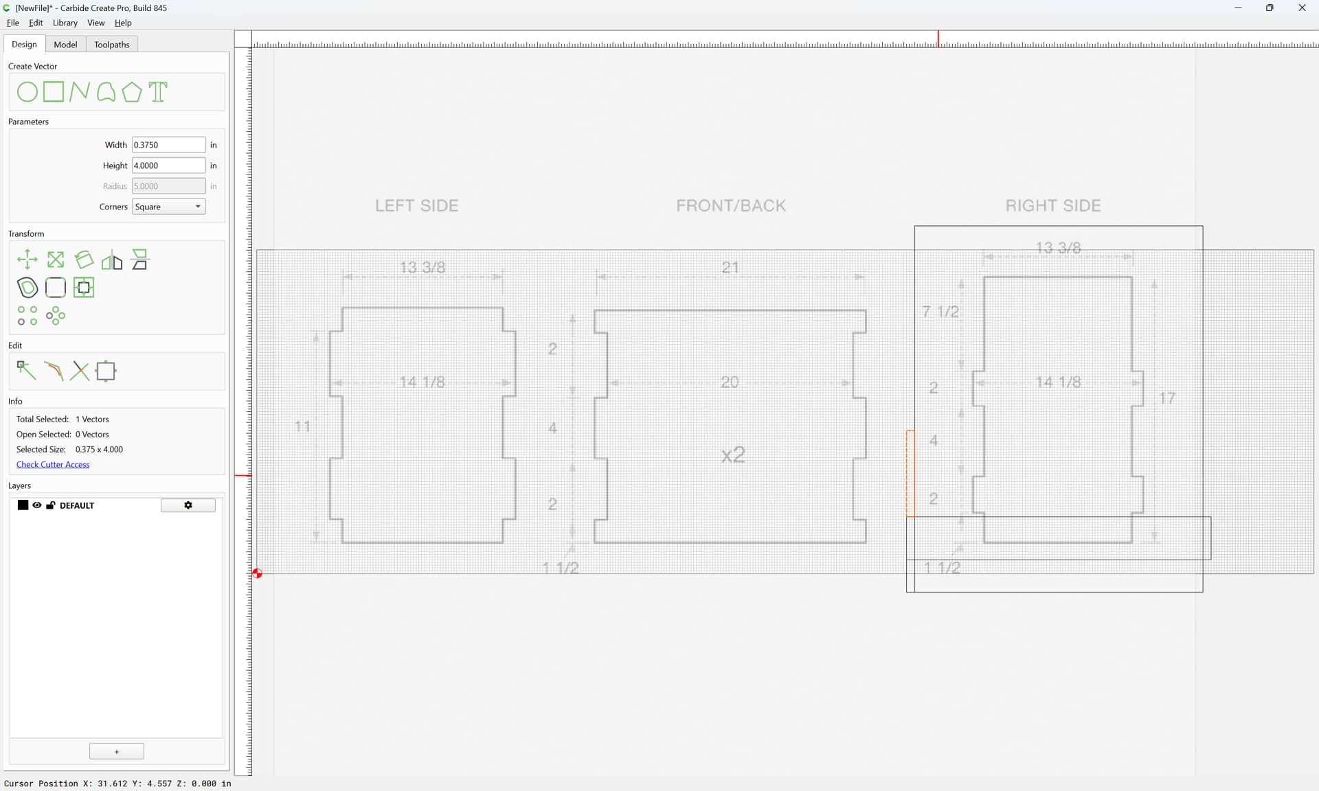

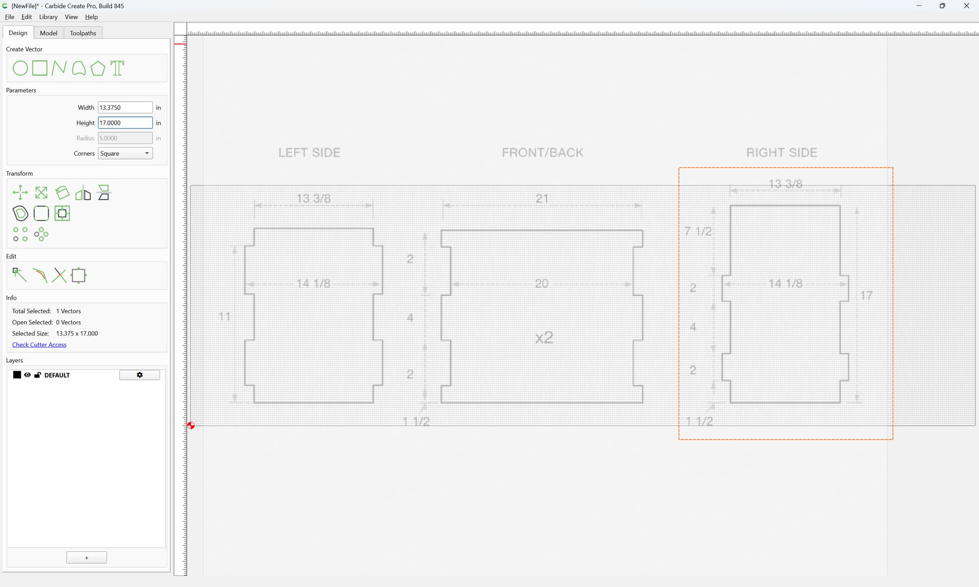

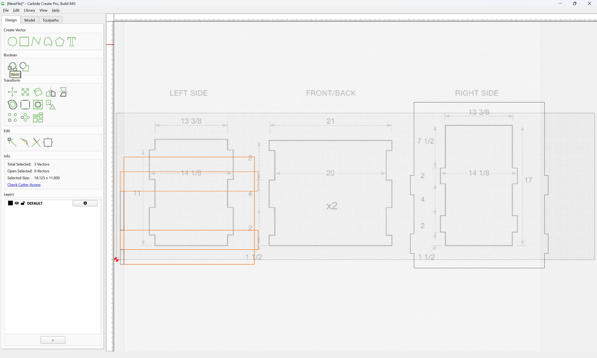

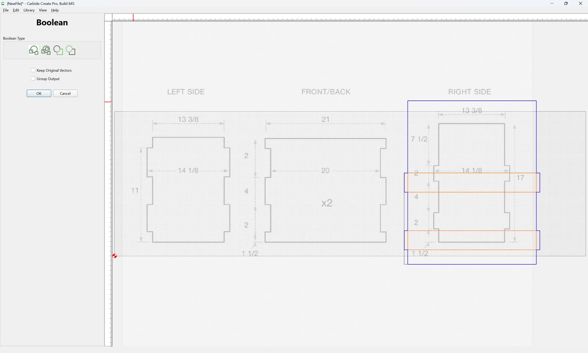

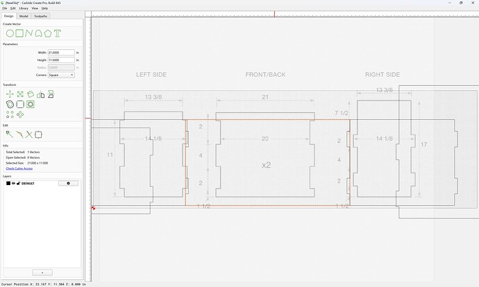

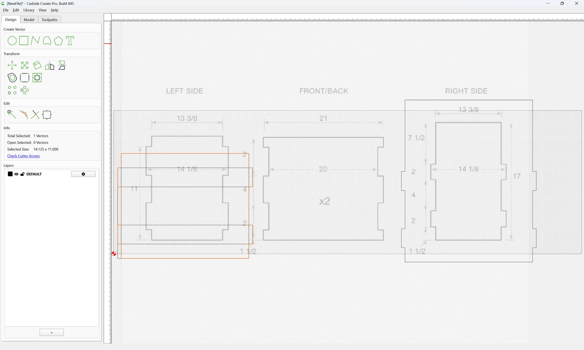

Instead, draw a series of overlapping rectangles using the specified dimensions for each part:

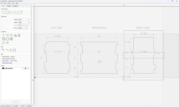

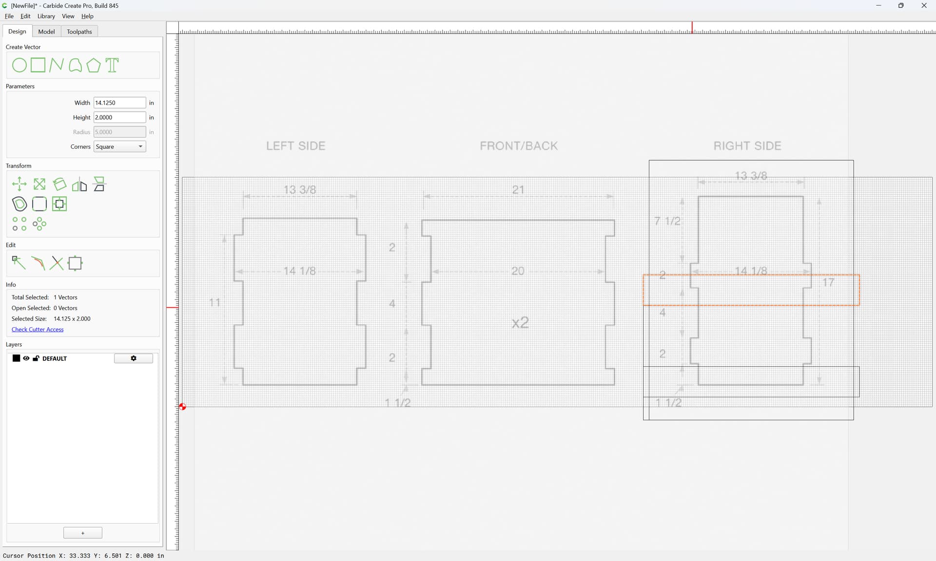

and additional rectangles as needed for spacing:
and positioning:

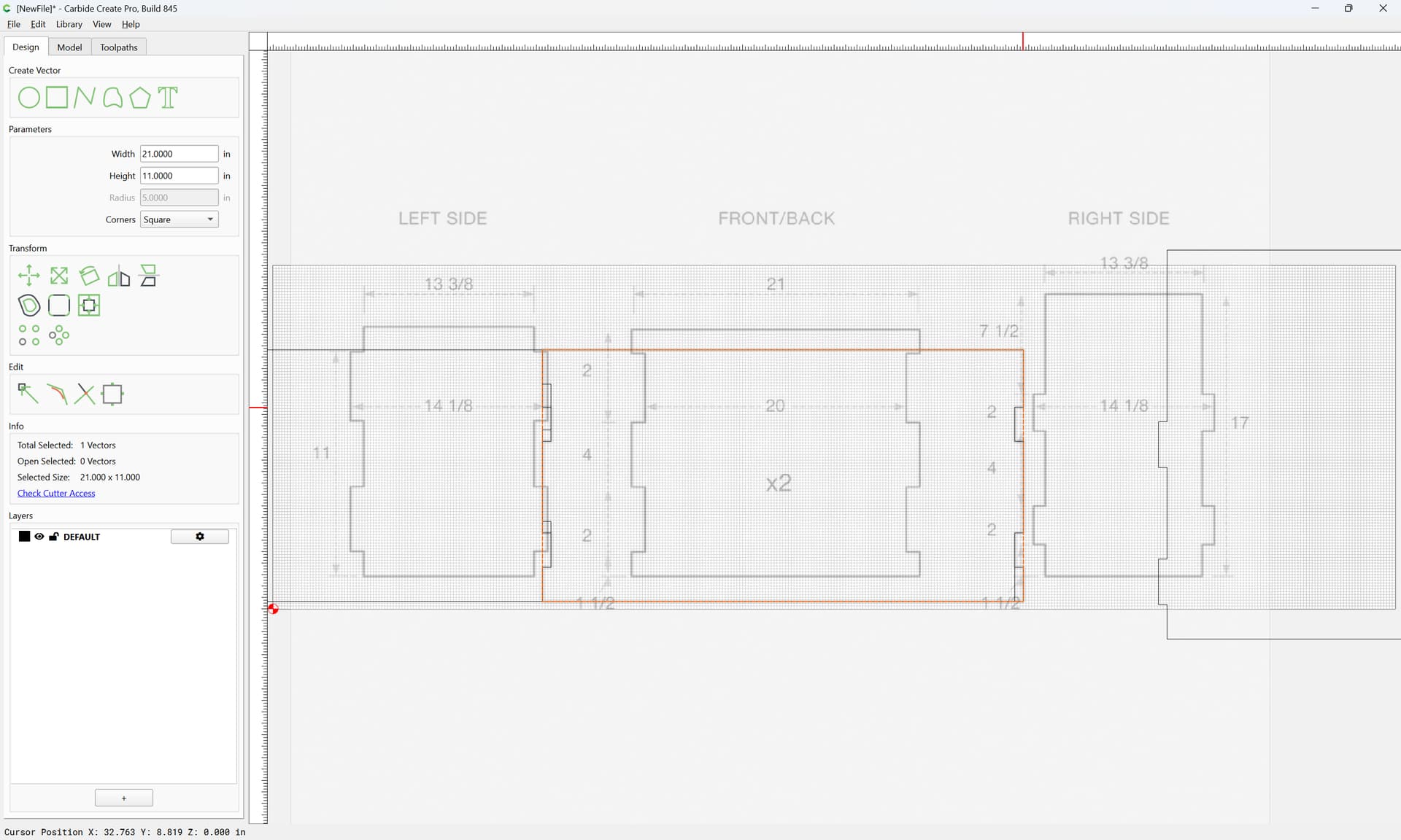

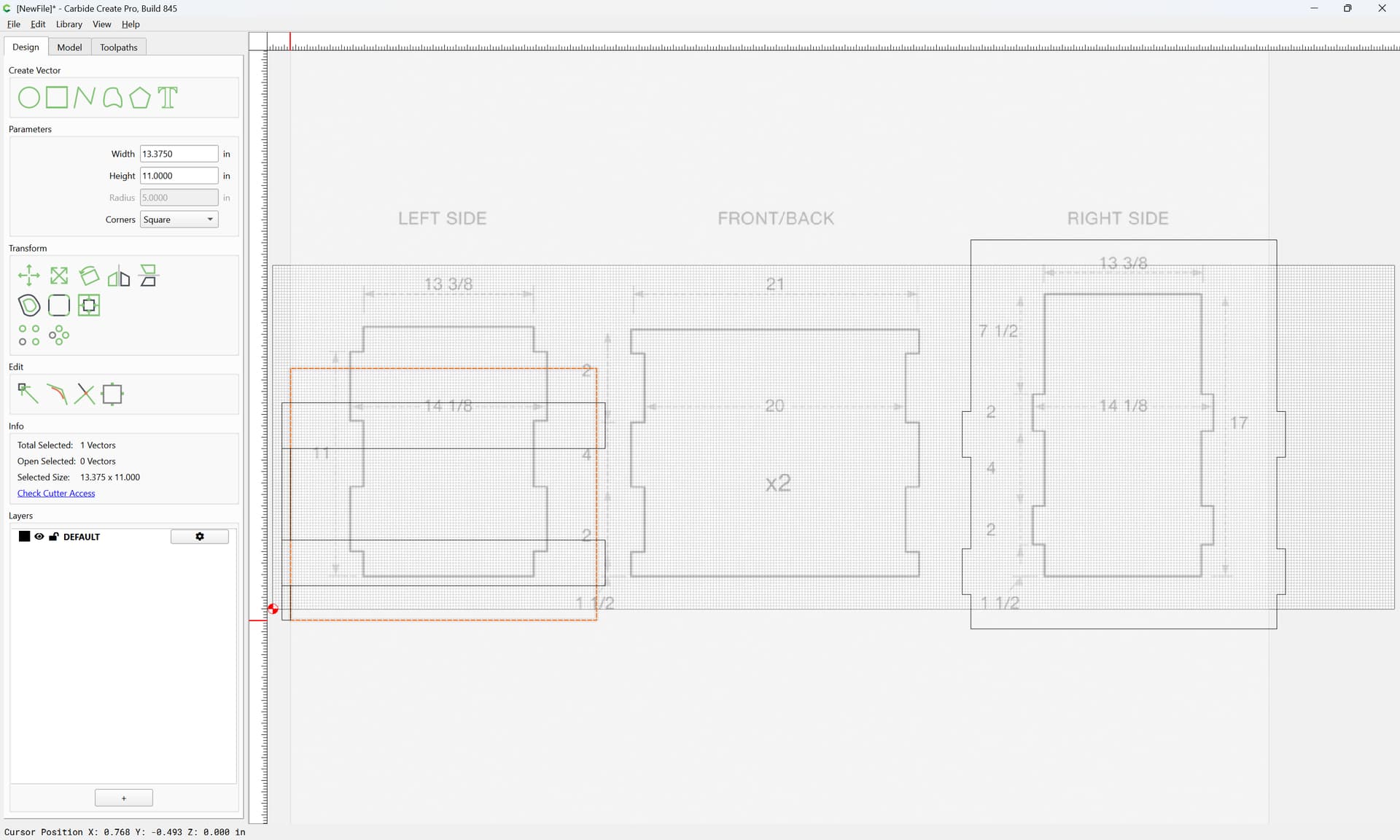

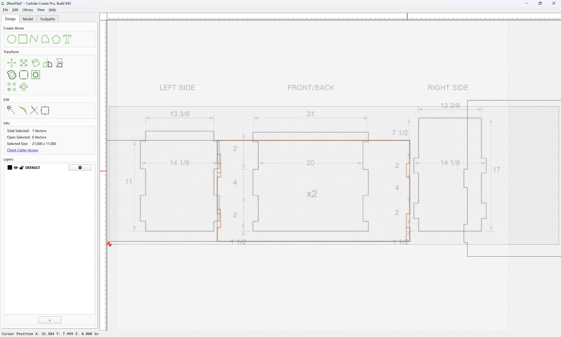

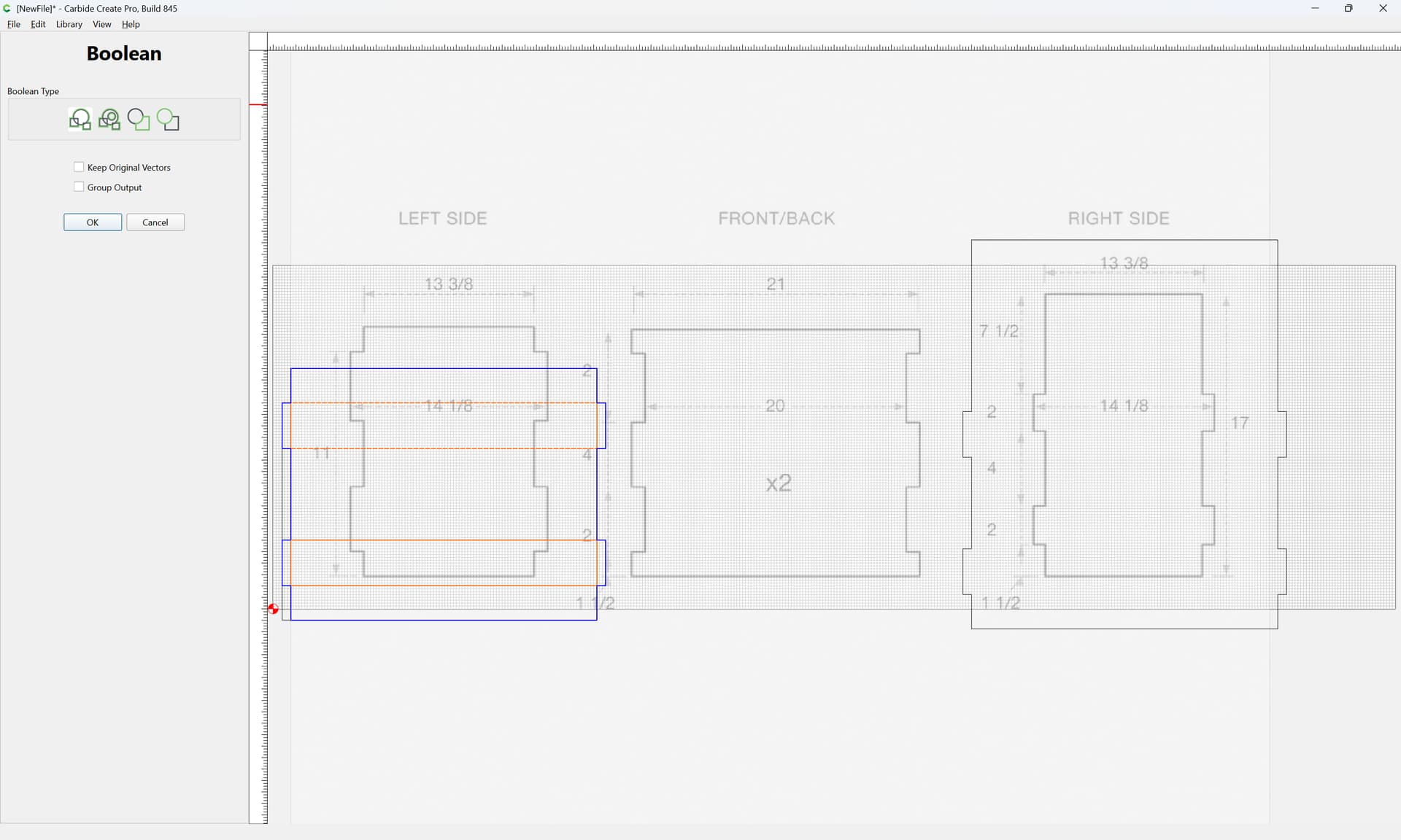

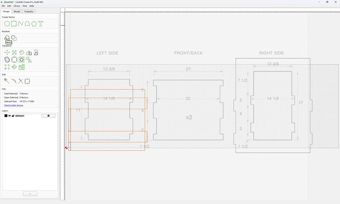

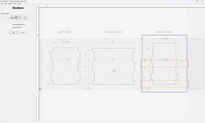

Once all the elements for a given part are compleat, select them:

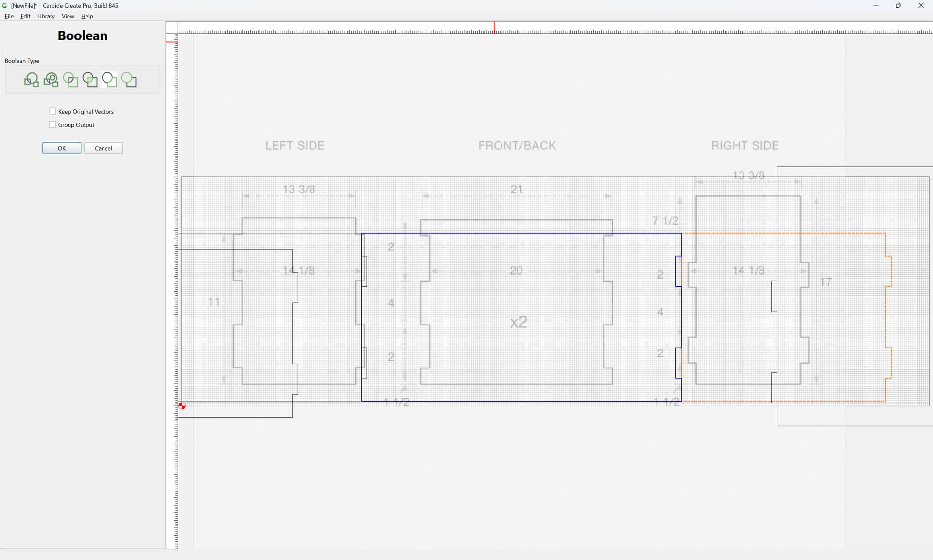

and Boolean Union:
OK
Repeat for each other part.
As one draws, correct dimensions as necessary.
OK

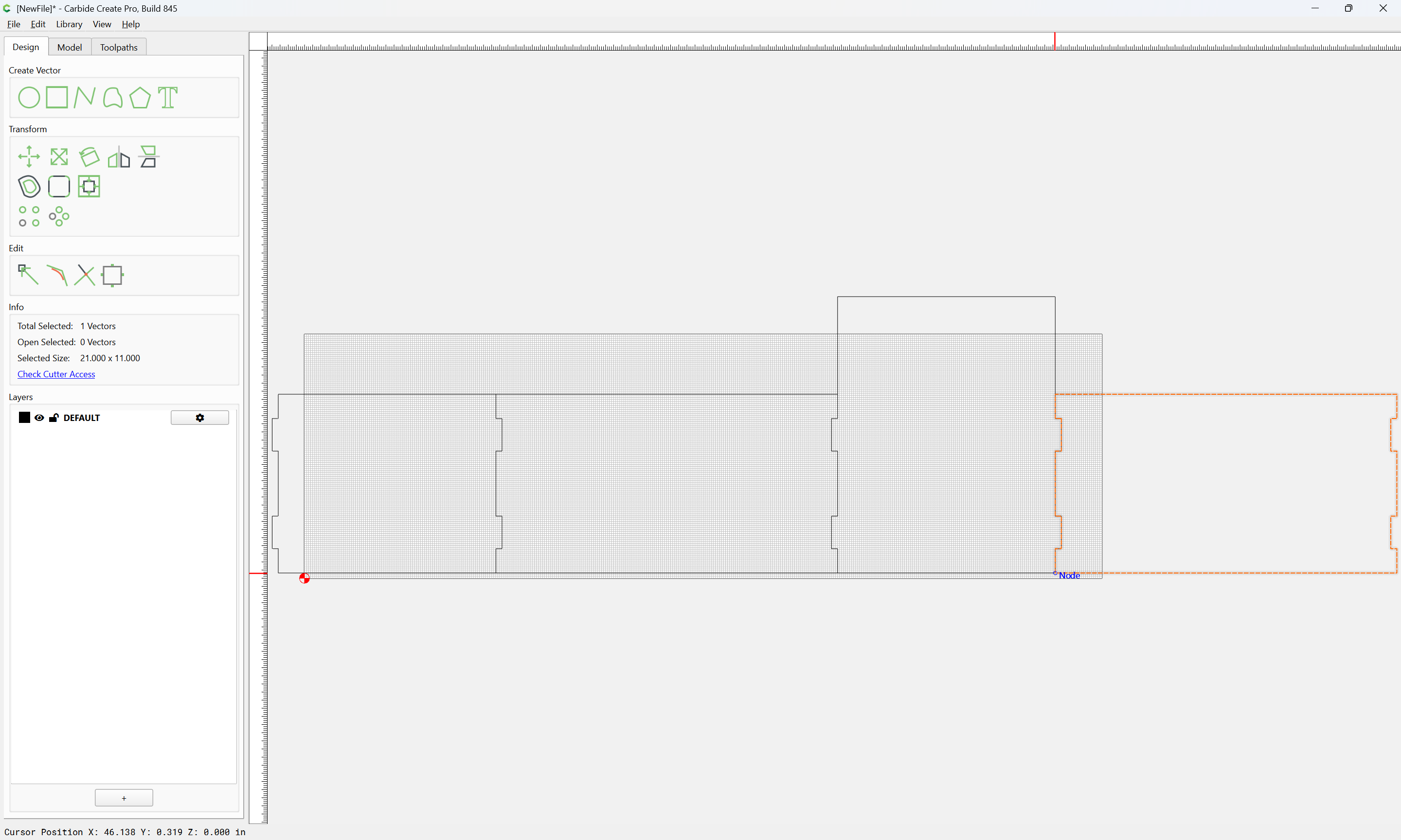

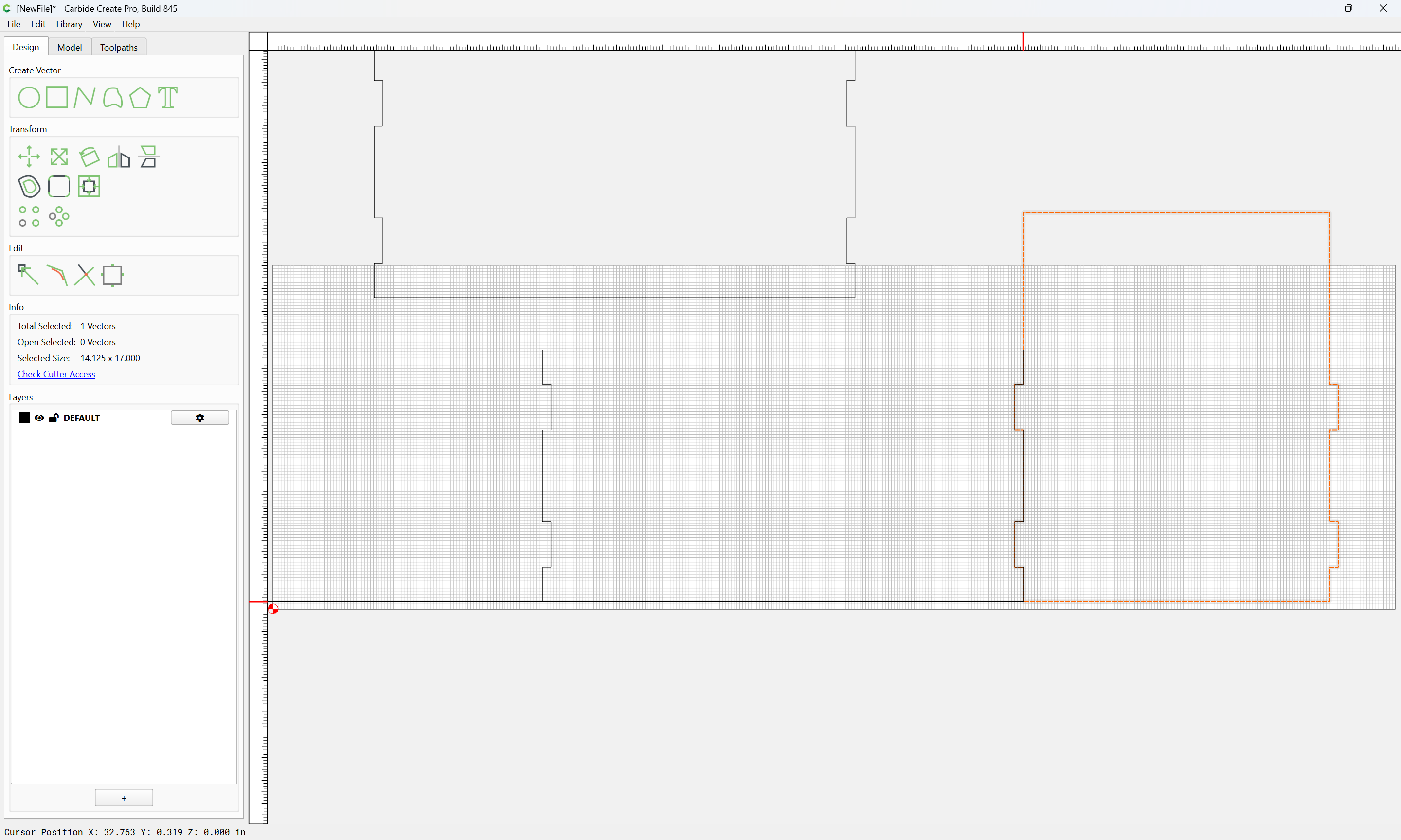

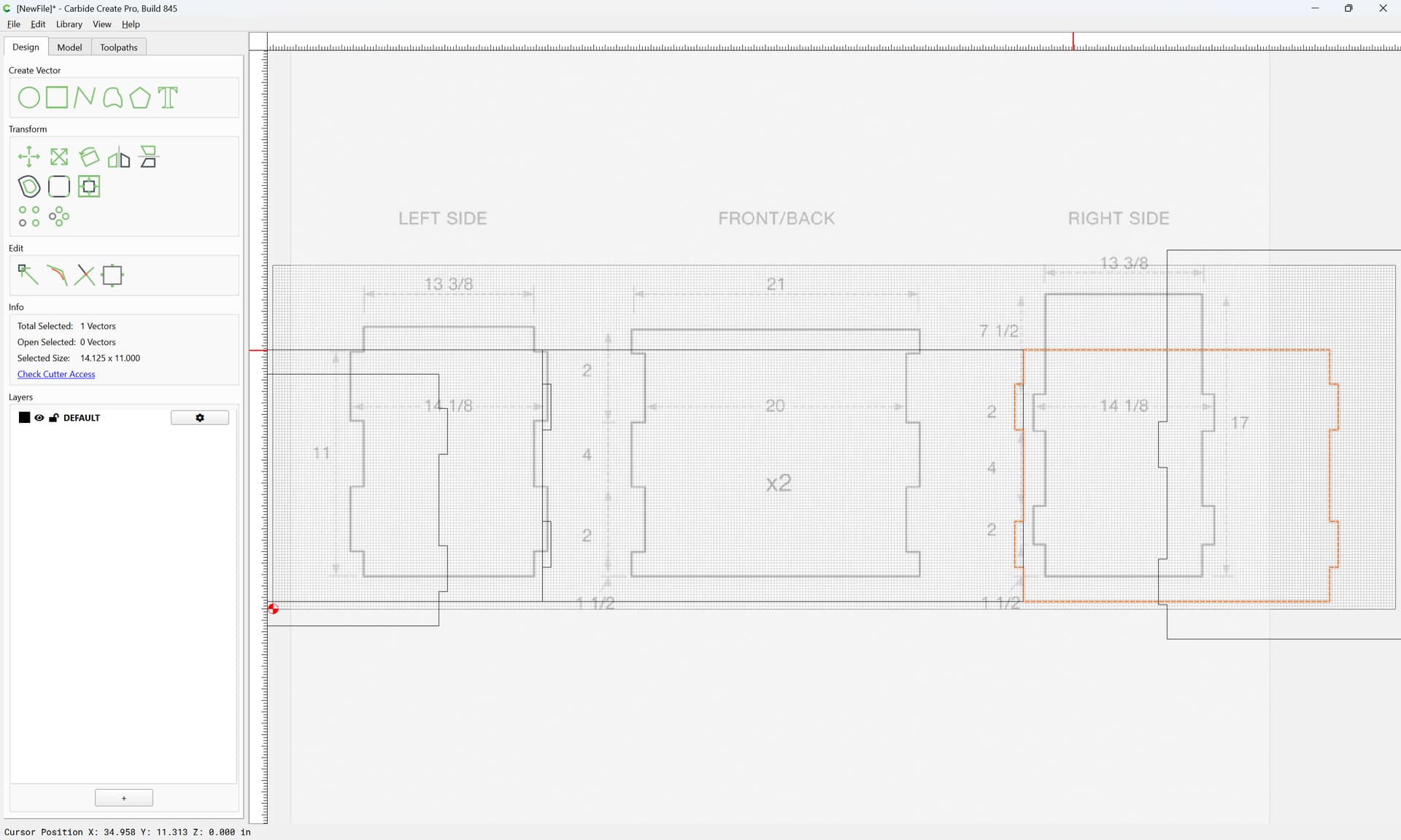

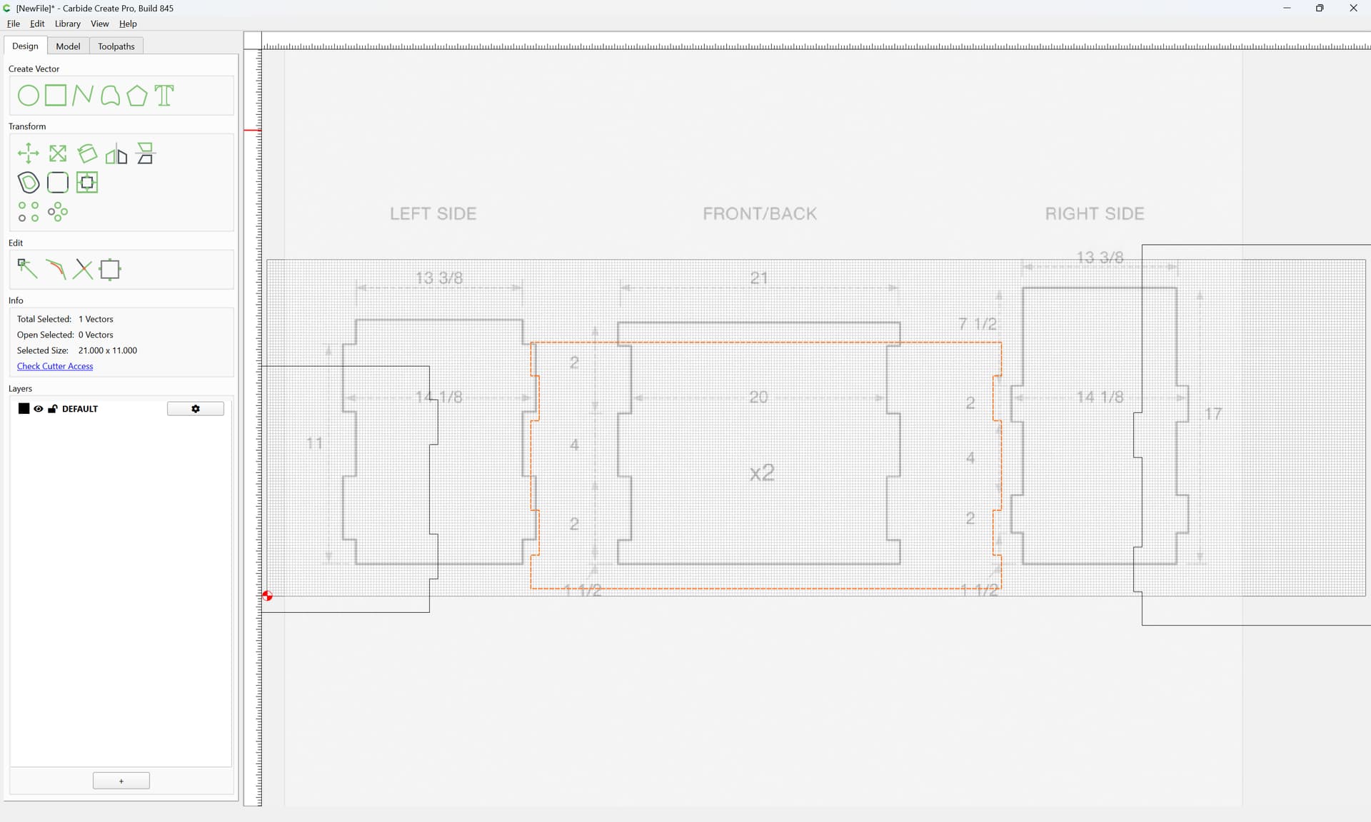

which doesn’t quite line up, so we re-draw the front/back outline:
Delete the wrong construction:

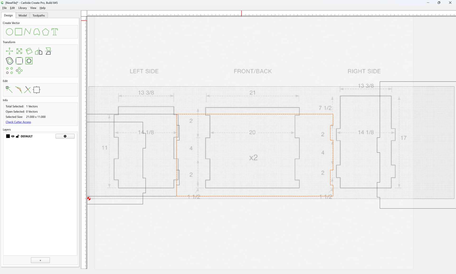

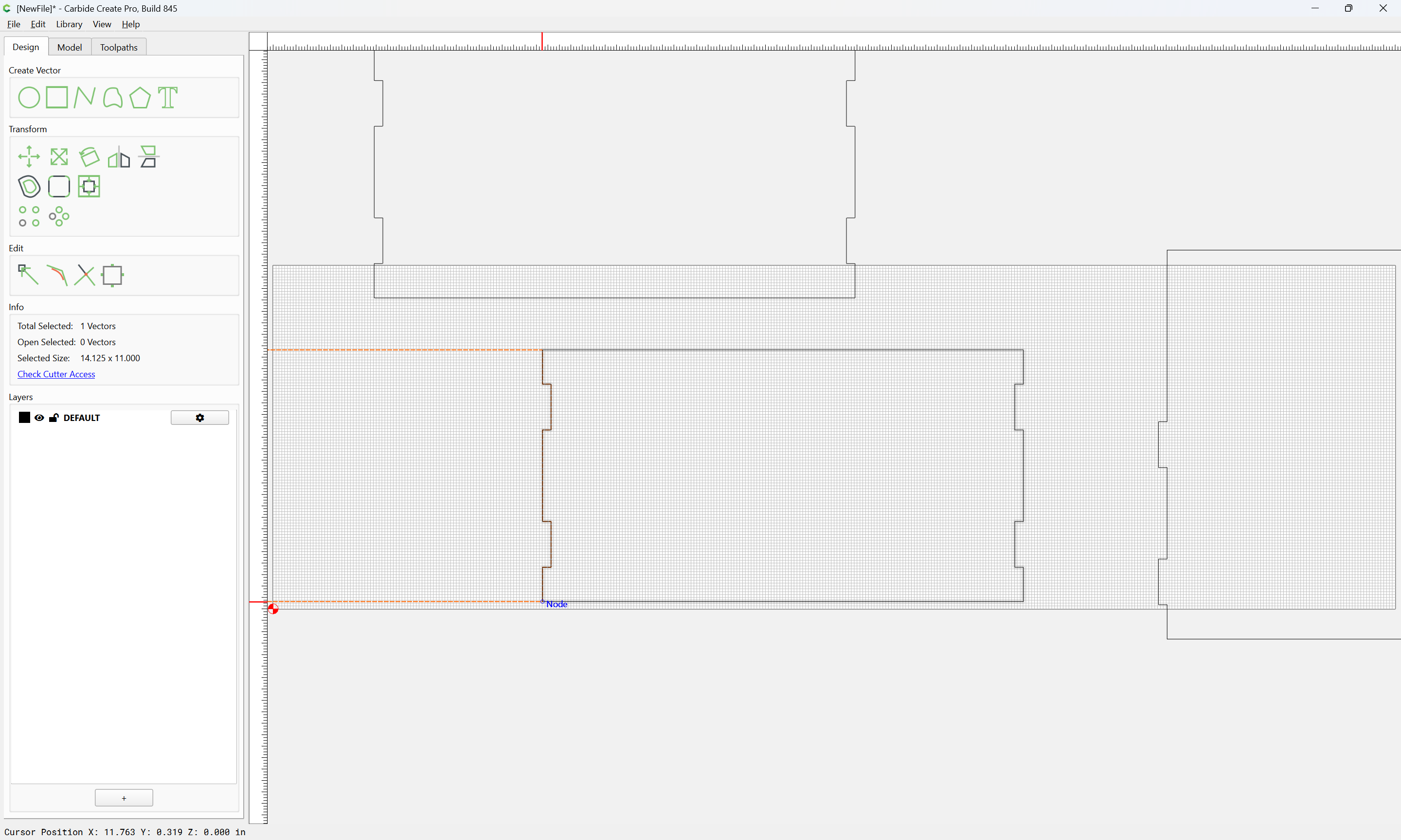

Duplicate the original:
twice

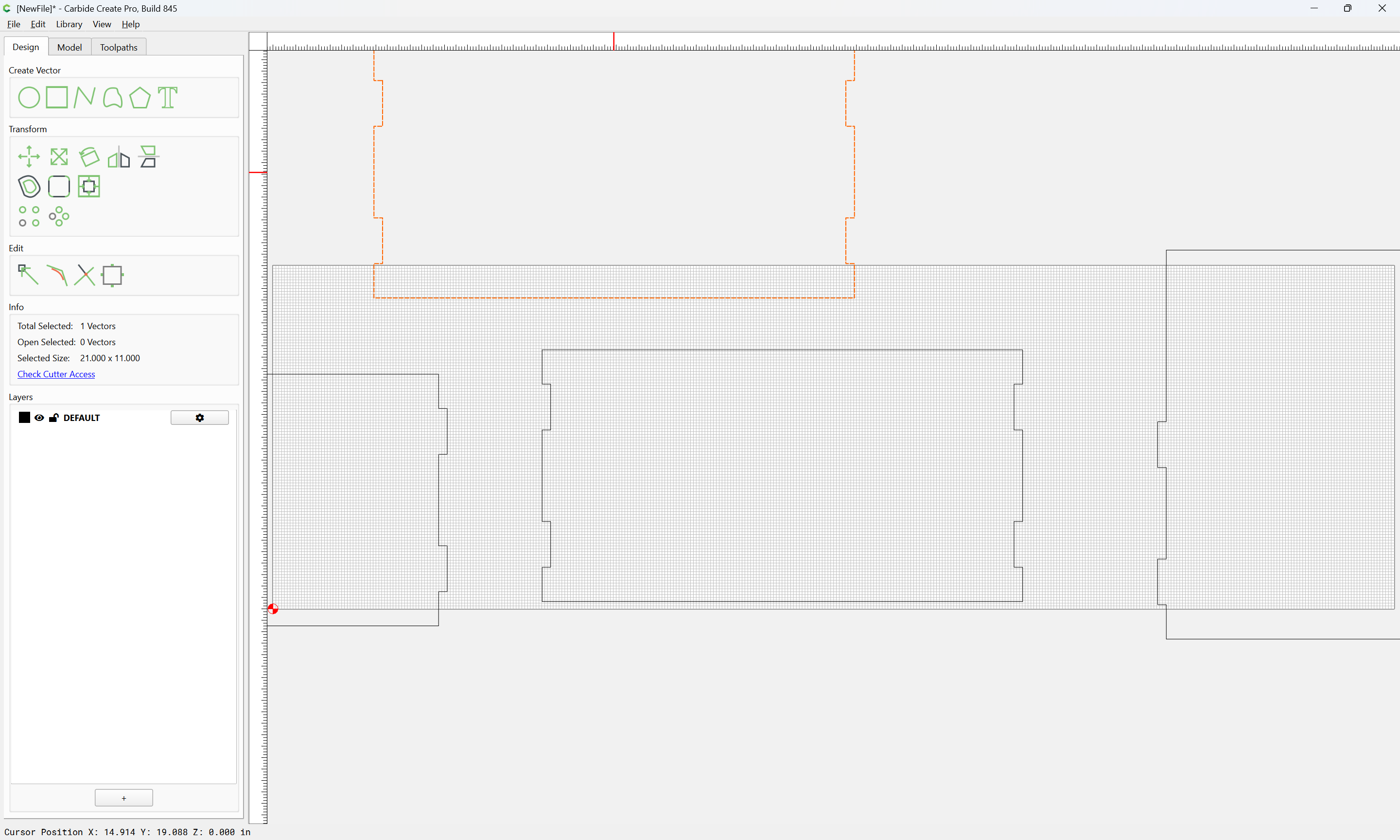

and drag both into registration:

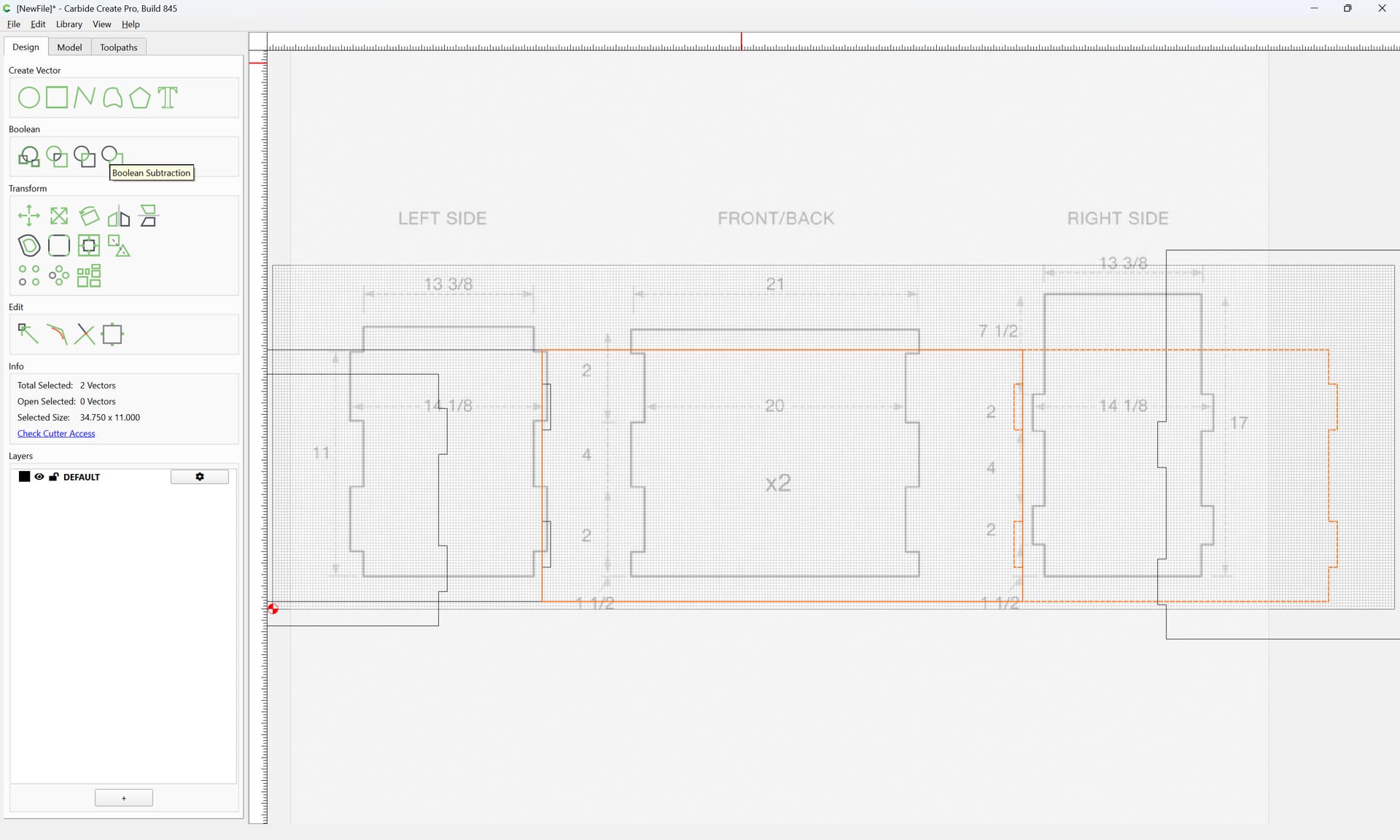

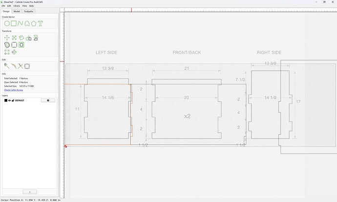

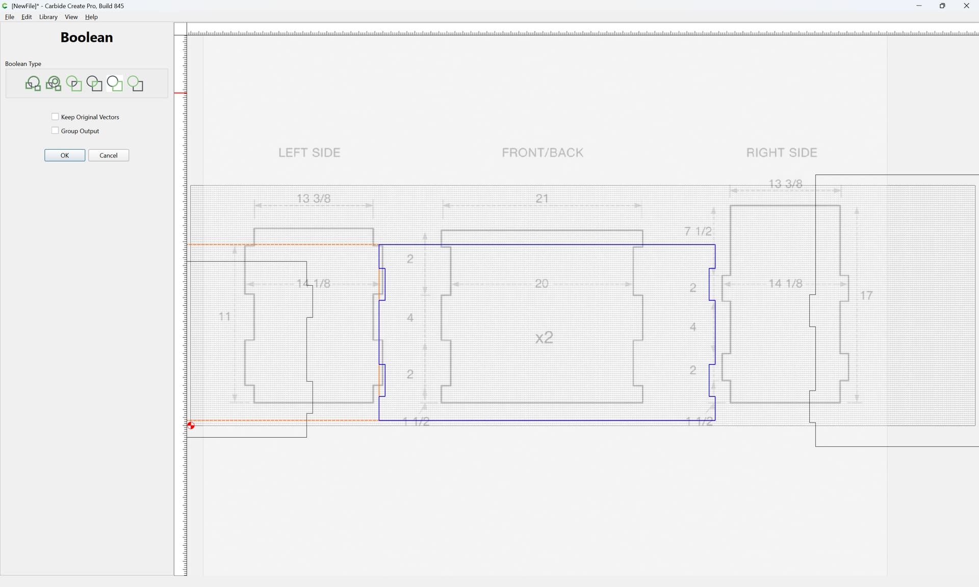

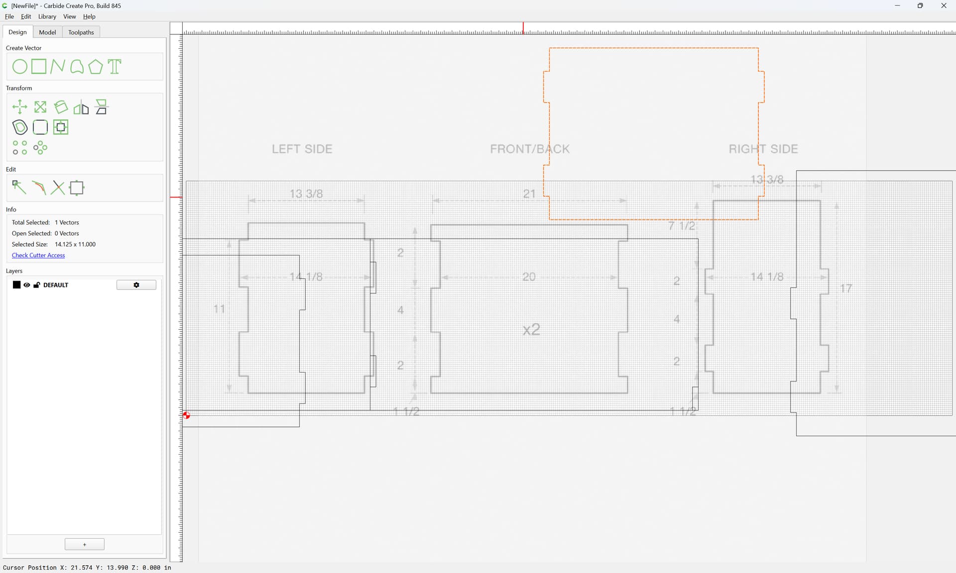

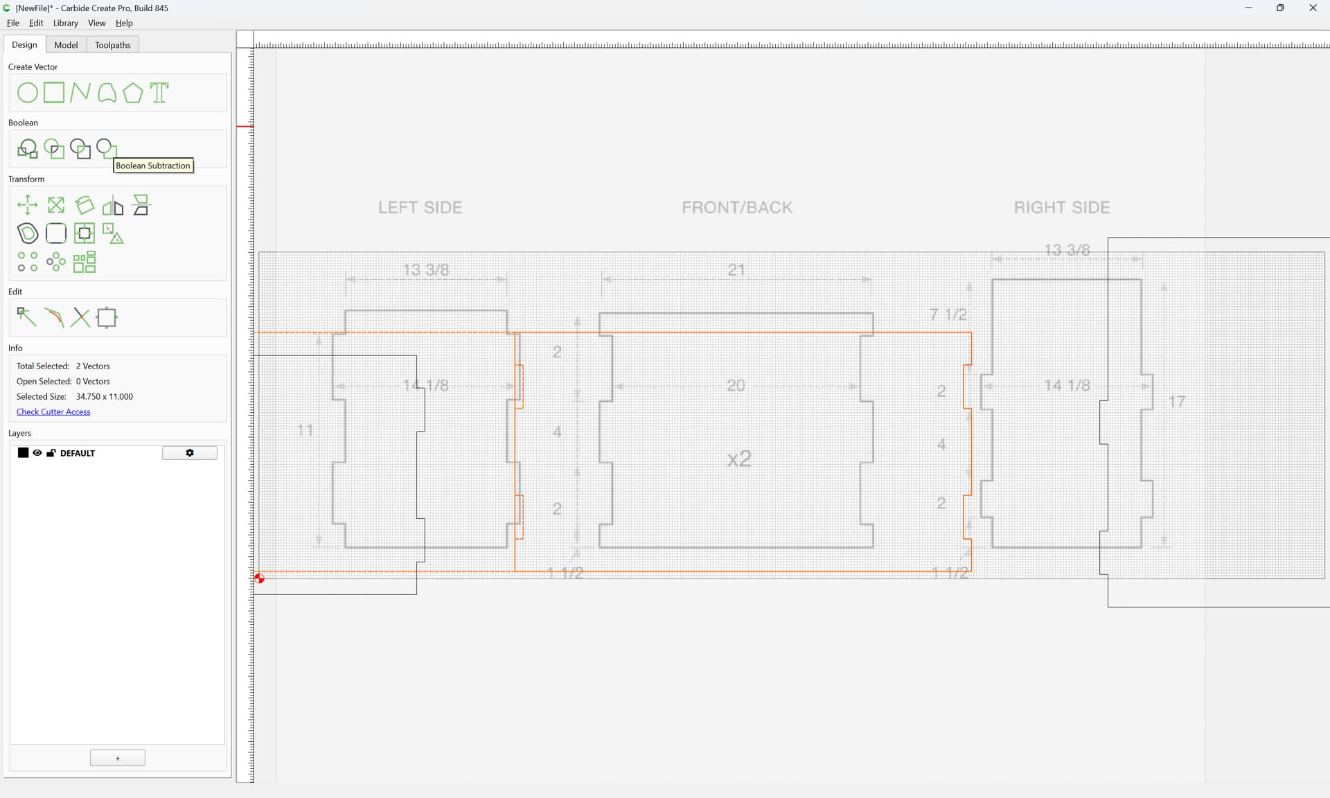

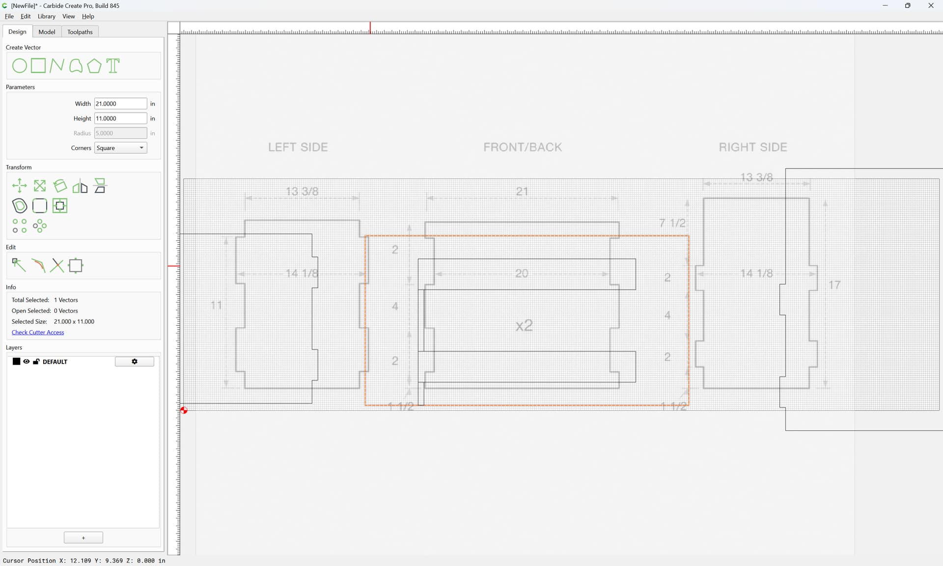

select the re-drawn geometry:
shift-click on one of the duplicates to add it to the selection as the key object (indicated by a dashed highlight)
then use Boolean Subtraction:
to remove what is not wanted:
OK

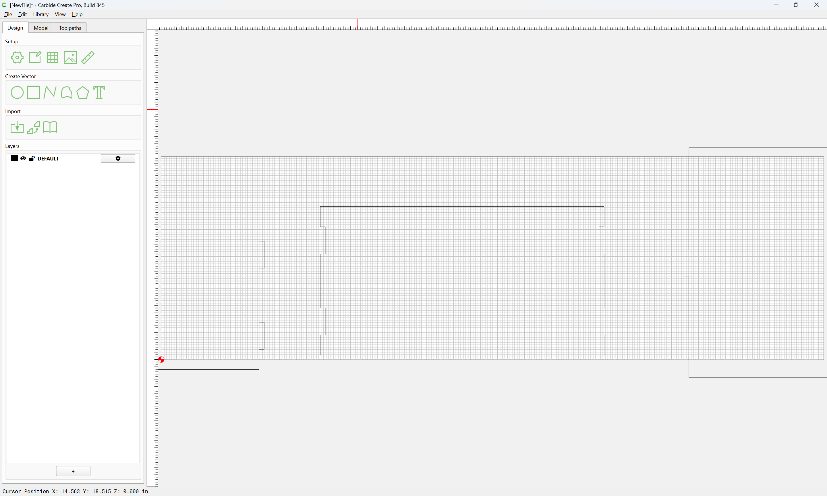

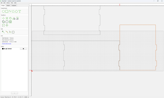

Repeat for the other side:
OK

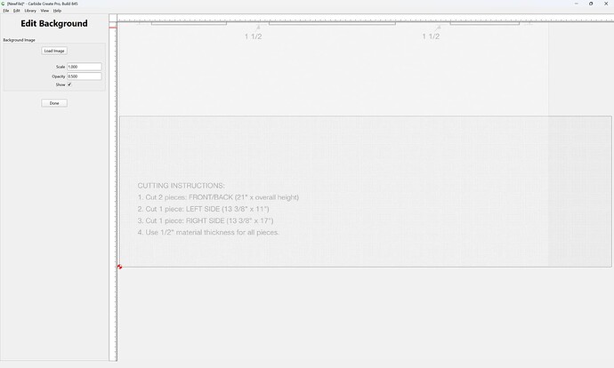

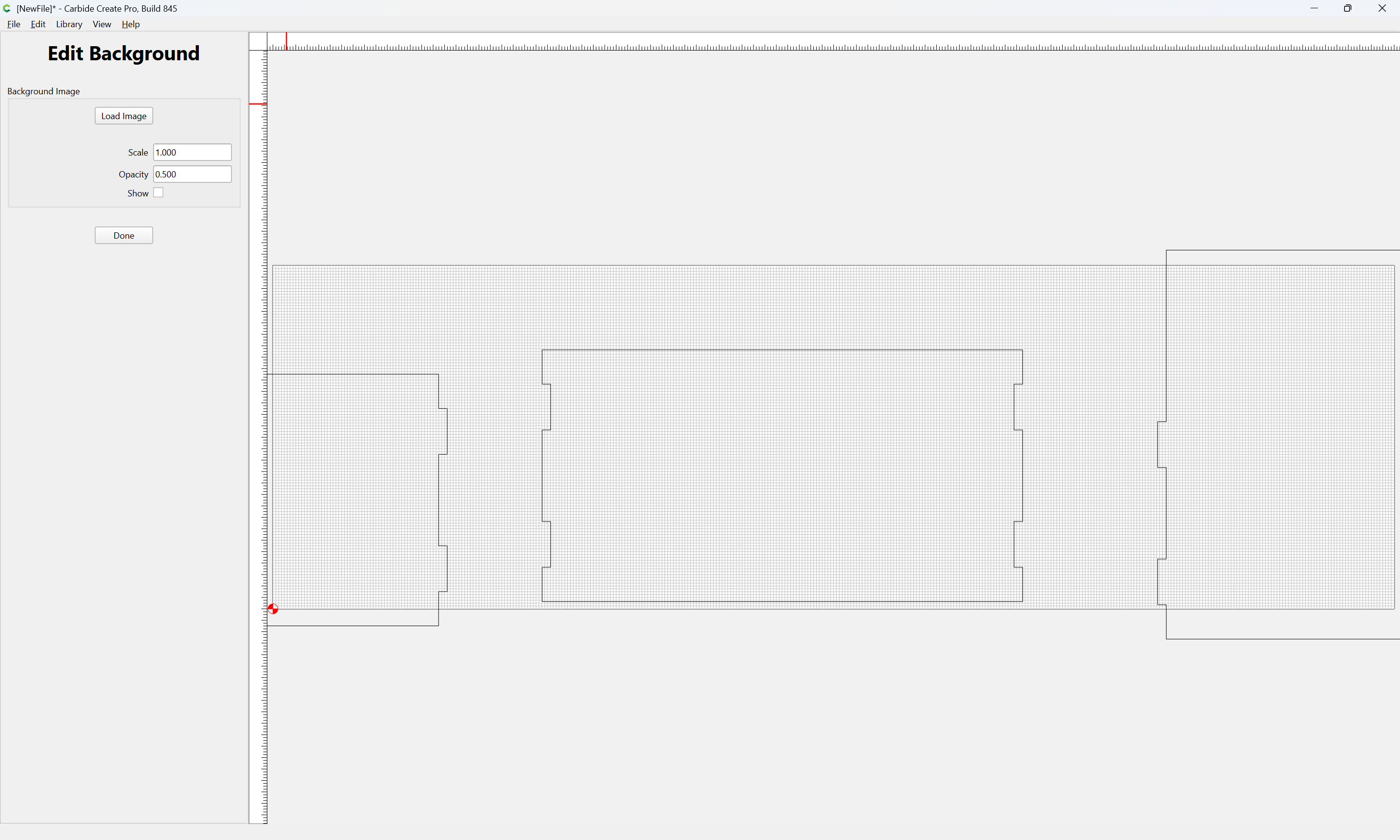

Hide the background image:
OK

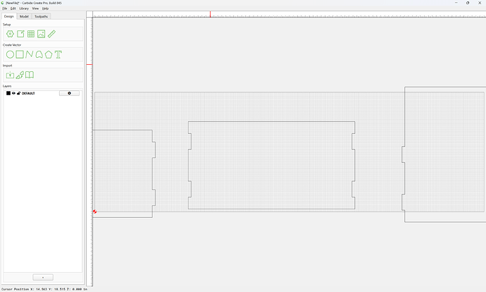

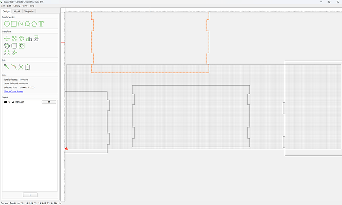

Duplicate the front/back:
Verify that things fit as expected:
Note that either dog bones will need to be added/subtracted, or the tops of the box joint “fingers” rounded off, see:
or, a file used to cut the internal radii square.
