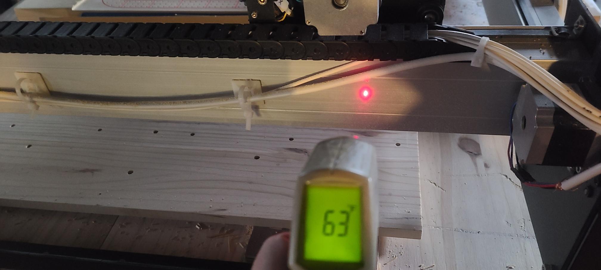

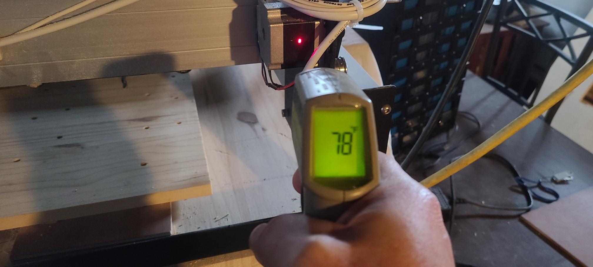

You could use a smaller gauge on the steppers to make it not so tight a fit in the wire chain, but I suspect the heavier gauge is why my steppers stay cool. (let me go check,)
stepper temp Has been powered on for about 5 days…
ambient room (basement) temp

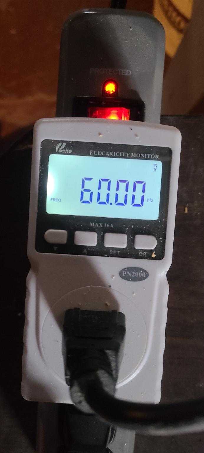

I do not know what the before readings were, but the current (pun) readings,
