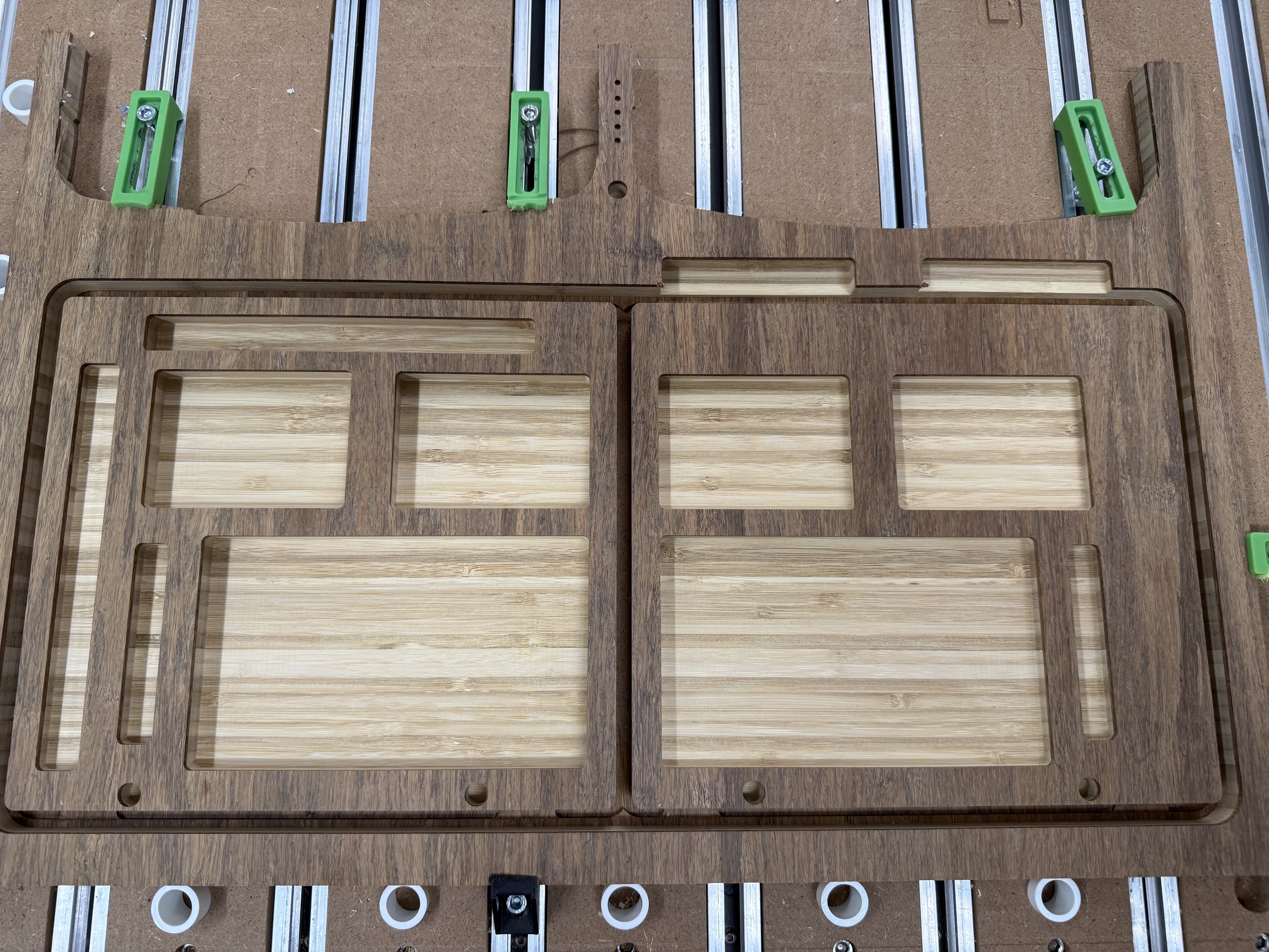

I did an air job this morning and all was good so about to do it for real. If I have issues it may be related to stress on the bit/machine although it did not seem to struggle or lose steps.
I am using the .25” chip breaker compression bit from CIC and the depth of cut is specified as .25” to clear the upcut portion. The cuts look great so far. I am working on a slightly modified version of their Classic Game Set. I will let you know later how it goes.
All good. I will chalk it up to gremlins if it doesn’t happen again.
Still some work to do but all the major cuts are done.
Ignore the junk at the top. Those were tests.
I did not realize that OS is behind the others as far as CM is concerned.
Walnut for material ? Looks awesome.
It is the BamX from CIC Workshop.
This one is walnut (colored) on the outside
