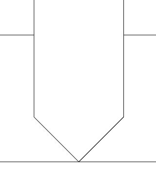

How are you setting Z zero for the drill? Even if programmed & set up correctly, a depth of “t” will only get the point to the bottom. Unless you are setting Z zero using the shoulder of the drill rather than the point.

If your material is 1/4" thick, and you set your drill depth to -.325" to cut completely through including the point of the drill, then that’s how deep it should cut.
If your zero is on Top, the Z value should be -0.325"
If your zero is on the bottom, the Z value should be -0.075"
