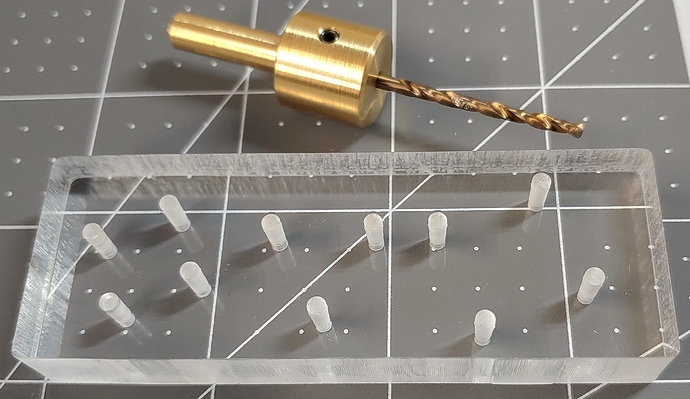

I’ve got a project where I need to drill 64 holes in 3/8" thick acrylic for slotted spring pins. I looked and looked but couldn’t find a 3/32" drill bit with a 1/8" or 1/4" shank to slip into my router. That got me thinking about Dremel keyless chucks. I have several of them. I wonder if one could be modified to be put on something with a 1/4" shank. I’ve seen similar things all over ebay. I know those are meant for high rpms but I’m able to slow my router down to 5k and that is where I have been doing all of my 1/8" and 1/4" drilling in the past.

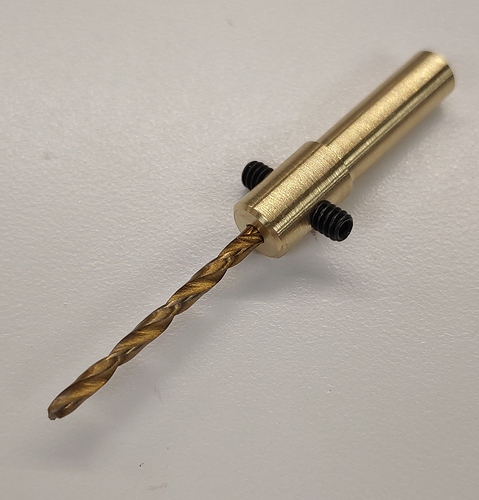

Anyway, I’ve got to have something today so I made a quick-n-dirty adapter. The runout is about .003" which should be fine for my project. See attached image. It only took me about 20 minutes to make. Still, it’s a shame someone doesn’t make a high speed precision chuck for small stubby drilling.

Wasn’t satisfied with the drill bit adapter I made so I made a new one. Bigger collar to sink the fasteners inward. Cut a prototype out of 1/2" thick acrylic. Very satisfied with the results.
