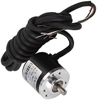

Have you thought about a 600 ppr optical encoder like this one?
Not yet, no. I guess encoders would make sense for real time feedback to the controller, but that would mean changing the electronics completely. And I’m mainly trying to map the very end of the tolerance chain, i.e. the actual position of tip of the endmill, while encoders would “only” help detecting lost steps at stepper level ?
I would think that with an appropriate no-stretch belt (cable), you would actually be able to measure pretty precisely - 2 pulses/degree = 8 edges = .125 degrees/edge. A digital caliper is basically just a linear encoder - convert linear motion to rotary (ie. cable and pulley).
True, but if prototype 1.0 taught me something is that I lack the skills to make something mechanical that is more precise than the shapeoko… :frowning:
I’ll pursue my optical endeavour and see where to go next
