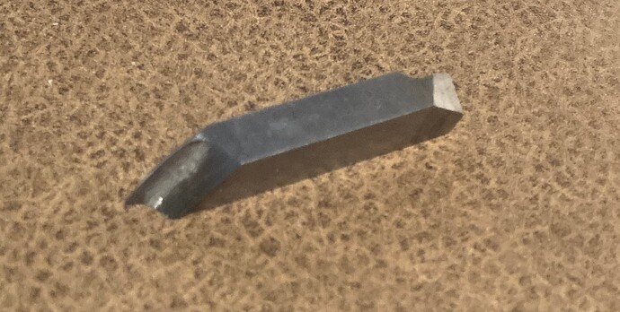

I would first look at reducing the ridges, and getting a better finish from milling. End grain is tricky, but a very sharp high rake cutter should leave these with very little sanding required.
Would a surfacing tool like the McFly work well in this application? It seems like the changeable inserts could be beneficial, though maybe the inserts aren’t as sharp as a more traditional cutter without some modification.
The YouTubers I watch always seem to regrind their inserts razor sharp, trading longevity for results. Is that a skill worth investing in for specific applications like this :thinking:
I’d make a sled with pockets to hold the pieces to be sanded and run them through the drum sander. You could do 20 squares at a time pretty easily.
First though I’d get rid of the ridges so you can start sanding at 120 or so. Something is wrong if you need to go to such a coarse grit.
I’d be tempted to try the McFly with just the bottom inserts (if I had one).
And I would sharpen the leading edge to razor sharpness.
The vertical inserts have zero rake, 90° leading edge. The bottom inserts look to be about a 45° rake.
An actual fly cutter with a high rake insert and even a very large radius would be best.
This mounts in a flycutter head at 45° angle. The slightly radiused cutting edge means no sharp corners to leave ridge marks.
An insert facemill with round inserts may also reduce the ridges.

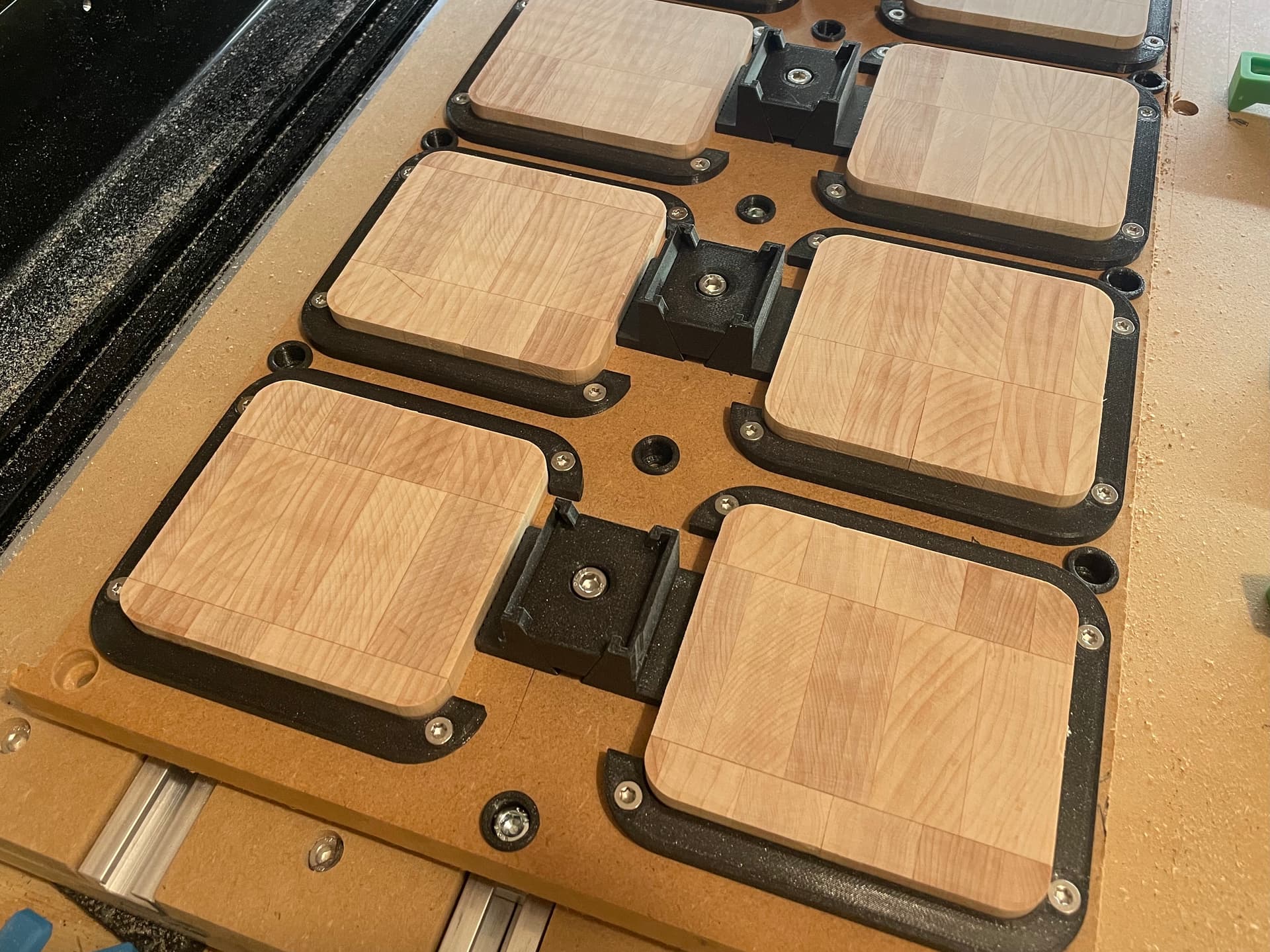

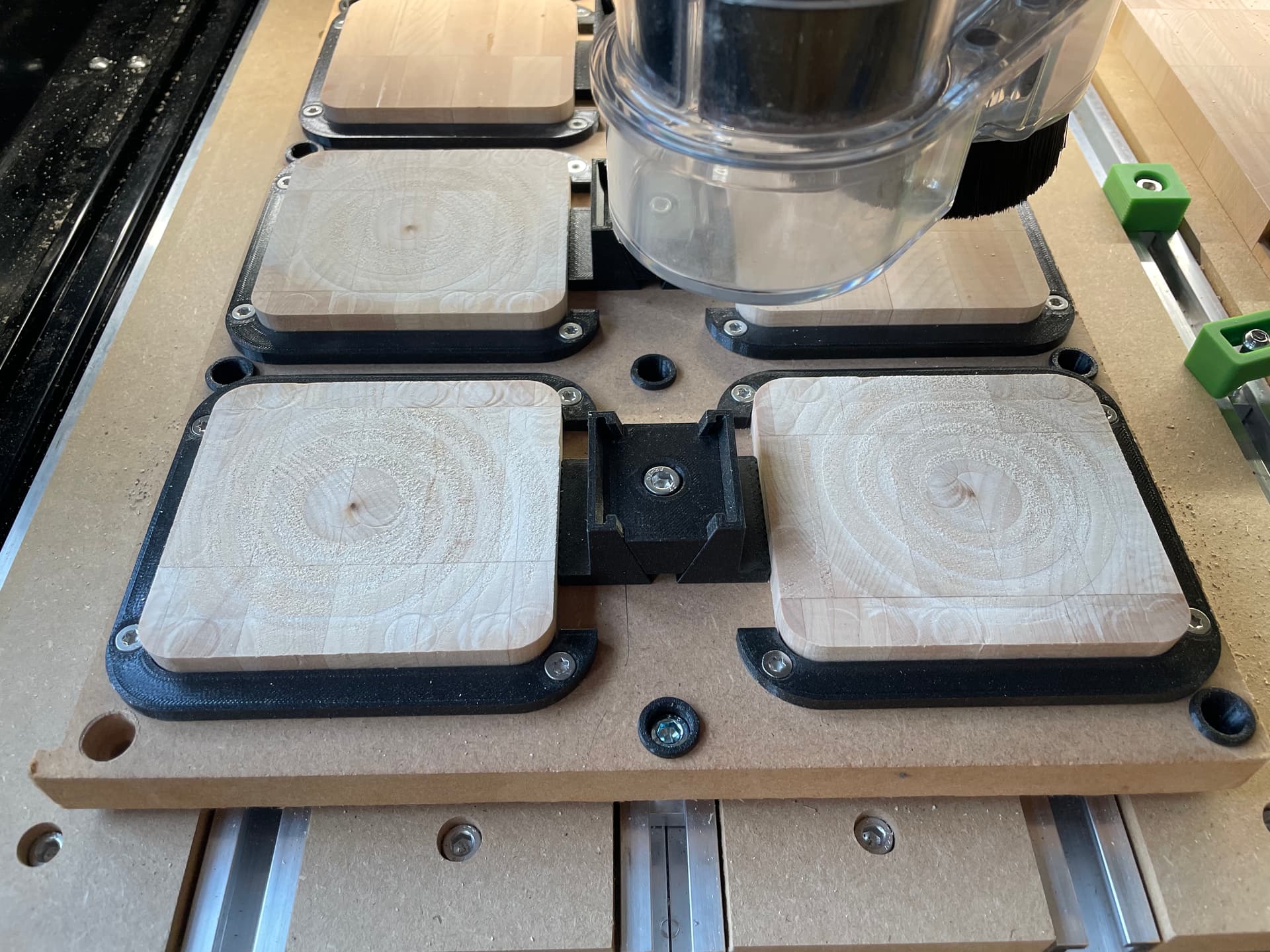

UPDATE (21/Dec/2025):
  • I have checked the tram of my spindle and it’s within 0.025mm in x and y axis.
  • My Jig for clamping them in place is clamped to the shapeoko workbed using the t-track down the center using the lowest torque on my dewalt drill of #1 so not to cause any uneven deflection of the 25mm MDF base
  • I ran for first time on new Shapeoko 5 (as mentioned above) just now @4000 mm/min, 0.25mmDoC and I’m still getting the same issues mentioned.

@tobwhy
That’s a nice clamp set up but I think that’s part of the problem. The endmill markings on the surface indicate the pieces are moving ever so slightly. The repetitive overlapping swirl marks are indicative of this.
After looking more at the photo, you statement of clamping only down the middle I you can see the outer edges are not flat on your spoil board. This will allow the downcut bit to put pressure downwards while over the outer locations and ”relax” the pressure when the bit returns to the midpoint of the jig fixture where it is torqued in the T track.
I have a couple of recommendations for your clamping setup. The way you printed your wedge and spreader clamps has created the layered steps such that when you are clamping the wedge down the layer lines have to snap past each other. If you zoom in on it it’s like two sets of Lego blocks in a stair step fashion having to slide past each other. I recommend reprinting those wedges and spreader clamps on their side so that the layer lines are going up and down the ramp instead of across the ramp.
Also as @Redlander observed, it does not look like you’re mounting board is flat against your spoil board. I would get something like 1/4" thick aluminum plate and make 4" x 1" plates with a hole in the middle for your screw, and add additional through holes for the other t-tracks and thoroughly clamp your mounting board to your spoil board. You are correct that you don’t want to apply so much force that you warp your mounting board, but the other side of that coin is you need to have it flat and tight up against your spoil board.
Edit: also, PLA and PETG are very slippery Plastics. Even with your clamping they may still be moving due to the vibration and cutting forces. It would be worth you printing one more pair of clamping brackets with your 3D printed bracket slightly larger so that you could glue in a really thin strip of cloth backed sandpaper. Even something as fine as Emery cloth would probably provide enough grip.

Thanks everyone for all the advice! Cool ideas all around. All of you are correct that the setup is not the most rigid which most certainly is the core of the issue here.
The Latest Result:
I want to update on my efforts today - I’ve significantly improved the results in the past hour or 2. Thanks @Tod1d for suggesting I could get better results and to continue to focus on improving the surfacing procedure. This has paid off.
  • It is now the flattest it’s ever been: no deep ridges or swirls. There’s ridges but they are very, very minor and could easily sand out in a few seconds. I believe I can start with 120/80 grit instead of 40grit, a VERY significant improvement for repeatability and time saved.
  • I also have noticed for the first time that the upcut leaves a glass-like finish (picture below) compared to downcut (picture in previous message). Downcut was always my go-to to avoid forces pulling the stock out of the clamp or chipping the inlay - I totally had no idea how much it was costing me in terms of surface finish! Thanks @MadHatter @Tod1d for talking about rake angles or I would not have broken out of this silo.

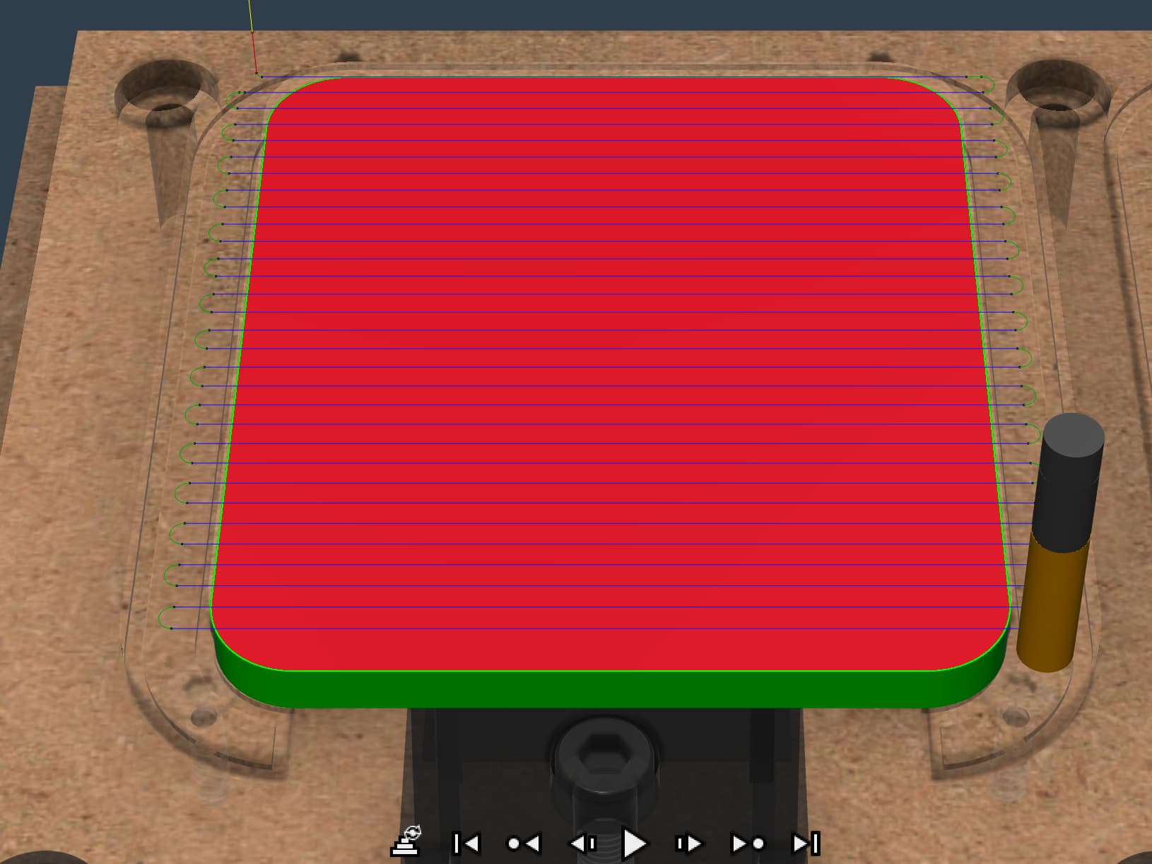

The Rationale behind the improvement:
Thanks to noticing the swirl markings on the surface, pointed out also by @Redlander, it lead me down a road of thought.
  • The wanna-be pseudo-rigid clamping jig setup is enabling some deflection/movement. I don’t want to remake the jig though so I need to try to reduce deflections/movements
  • If so, what is the thing that would cause deflection/movement symptom in a not-perfectly-rigid setup that we’re seeing? Answer: Tool Engagement, as the tool acts as a force on the stock in xyz depending on the direction it’s travelling.
  • I’m seeing deeper cuts in the stock surface in very specific places. What is the common variable relating them? Answer: (a) where the tool plunges the surface and (b) where the tool changes direction while engaged in the material. aka, It’s abruptness.
Therefore, the main enemy of my wanna-be pseudo-rigid clamping jig causing these symptoms was ‘a lack of consistent directional tool force while engaged in the workpiece’, and ‘abrupt engagement into the workpiece’. Therefore, if I follow these rules, I should be able to maximally minimise the issues:
  1. When the tool is engaged with the material, keep the direction of the cut consistently a straight line to keep forces consistent. Do not plunge vertically into the surface.
  2. Therefore, if you disengage the tool from the material, (a) do the moves that change the direction of the cut and (b) avoid plunging vertically opting instead to attack horizontally.
  3. Additionally, outside of this tool marking issue, use an upcut endmill instead of downcut for better finish.
What I Did:
I therefore switched up my 2D adaptive toolpath (which was a directionally inconsistent toolpath of concentric circles) to a simple facing operation (straight lines back and forth engaging laterally from outside the stock boarders) where it does the change in direction off the material. Now, I’m getting a surface which I feel confident could be sanded out fairly quickly with 120grit and above. A massive improvement on my situation before
Only thing now is I need to buy a 1/2" upcut instead as these tests were with a 1/4" upcut
