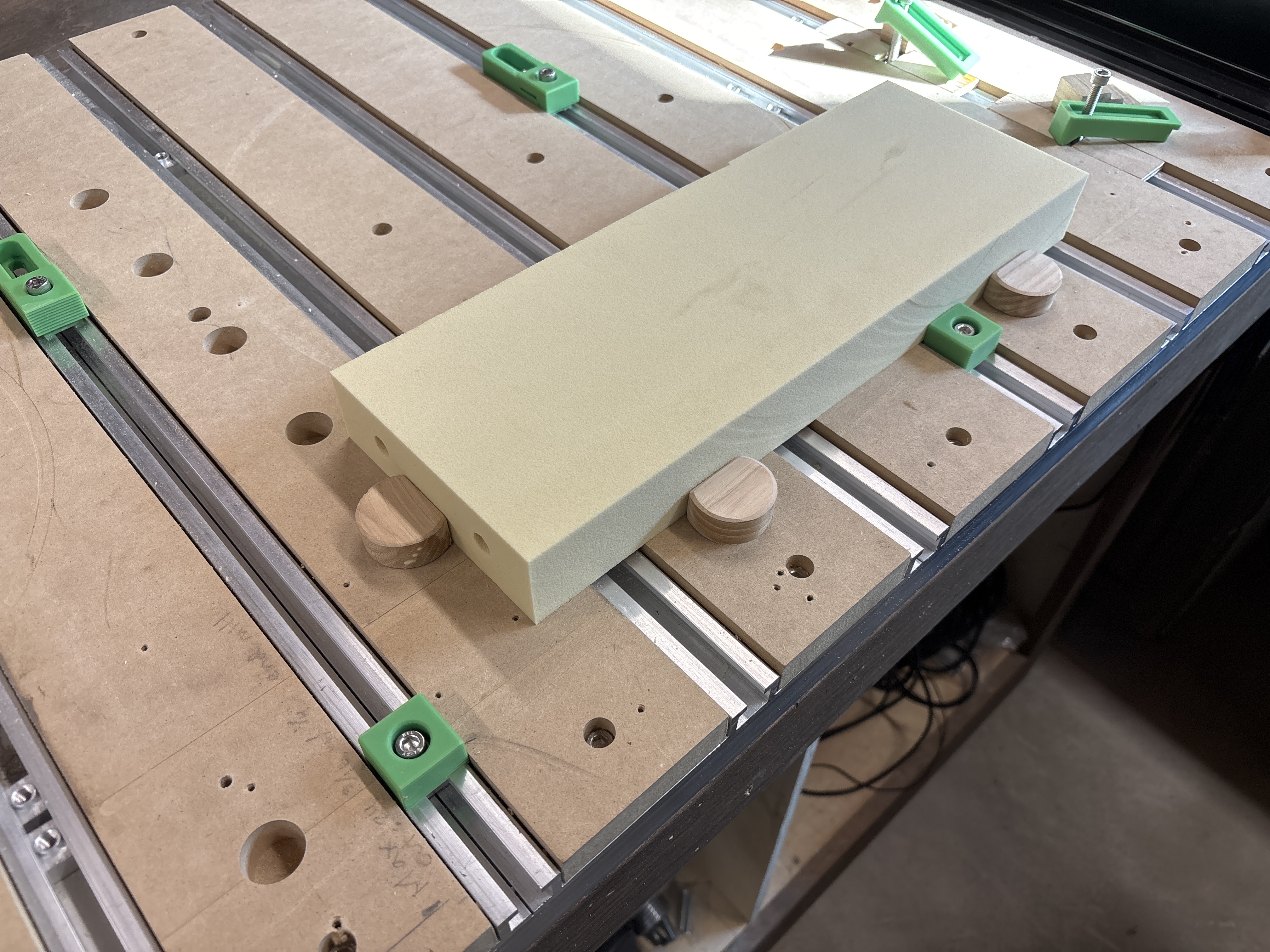

I suggest you use something like this to keep the X and Y in a repeatable location.
https://cutrocket.com/p/jyq3e3mrv18ki
I’m on the “push the run button again” side of this conversation. With a big caveat: you MUST know that the stock is in EXACTLY the same spot. I have a dogs that set my piece square on a side and bottom. Once I run a sign, I flip it over without reinitializing or resetting zero. And…if I’m running multiple signs the same size, I’m able to count on my zeros being correct. As soon as I turn off the machine, I always have to initialize AND set zeros again.
You can see my set up with the dogs here:
Thanks I’m leaning that way as well but with a test piece or two. Thanks!
That’s a fantastic idea and jig. In fact, it’s the one I posted and use. :sunglasses::rofl:
It’s a small CNC world we live in…lol…
It certainly is. Glad you thought it was worthy.
