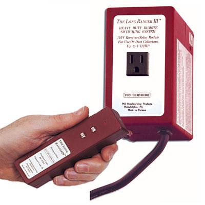

They sell a 110v and a 220v unit. So when I get ready to start a job I just hit the on button and when the job is finished I press the off button. Although not automatic it is not very complicated. Plus I have multiple remote switches that I use on different tools like the tablesaw. I do have to manually move my 4" hoses around but there are solutions for that but they overly complicate your dust collection. If you are only collecting dust from the Shapeoko then this would work great.
I purchased this one that Will recommended and it works very well. The vacuum does not power on until the spindle is engaged which is exactly what I want.
Thank you for all of the great suggestions. This is an awesome community,
I use the 220v Long Ranger for my Oneida 3hp industrial dust collection system and this inexpensive remote switch for my Oneida Dust Cobra that I use to exhaust the CNC (and also my hand tools).
