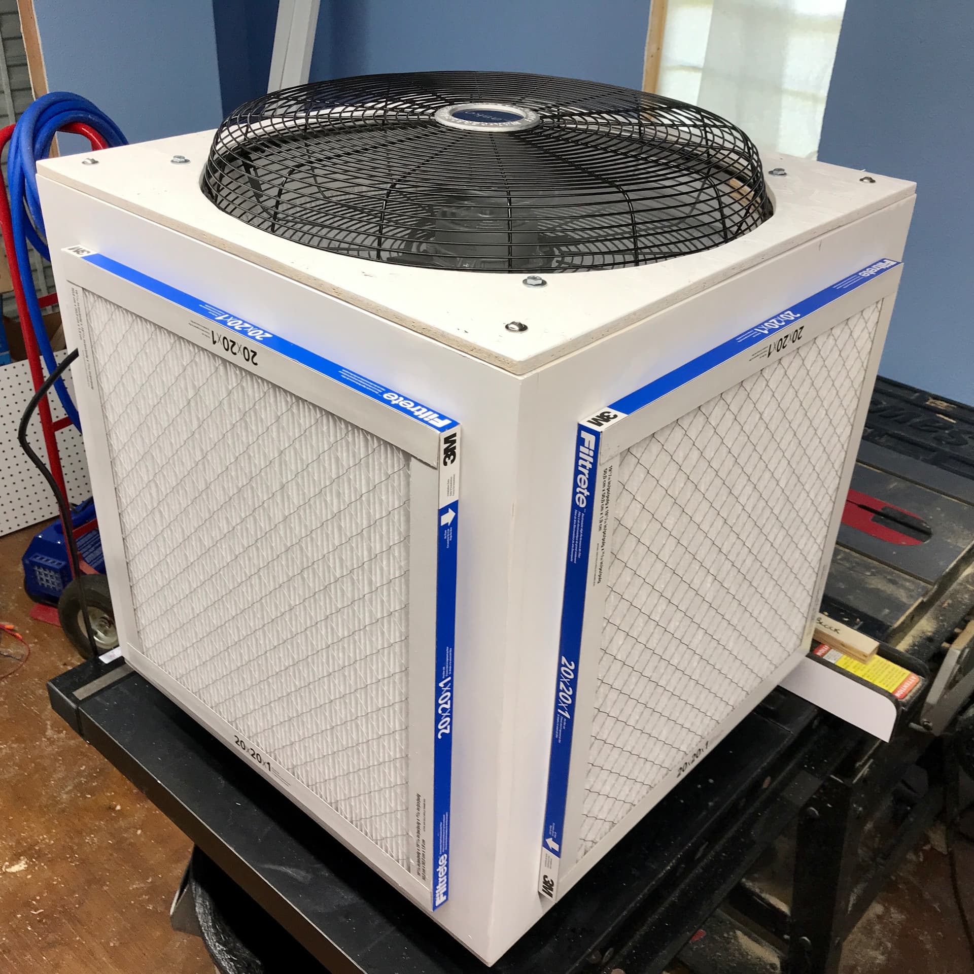

Its more important to get it out of the air, too. I use a fan/filter combo that reduces the airborne particles down to outdoor levels in about 30 minutes.
