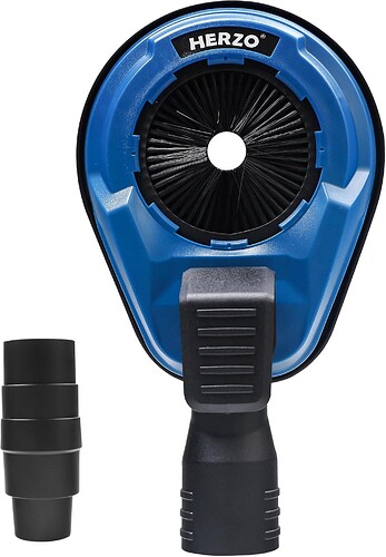

I used horizontal circular brushes before, like for the drill dust collector:

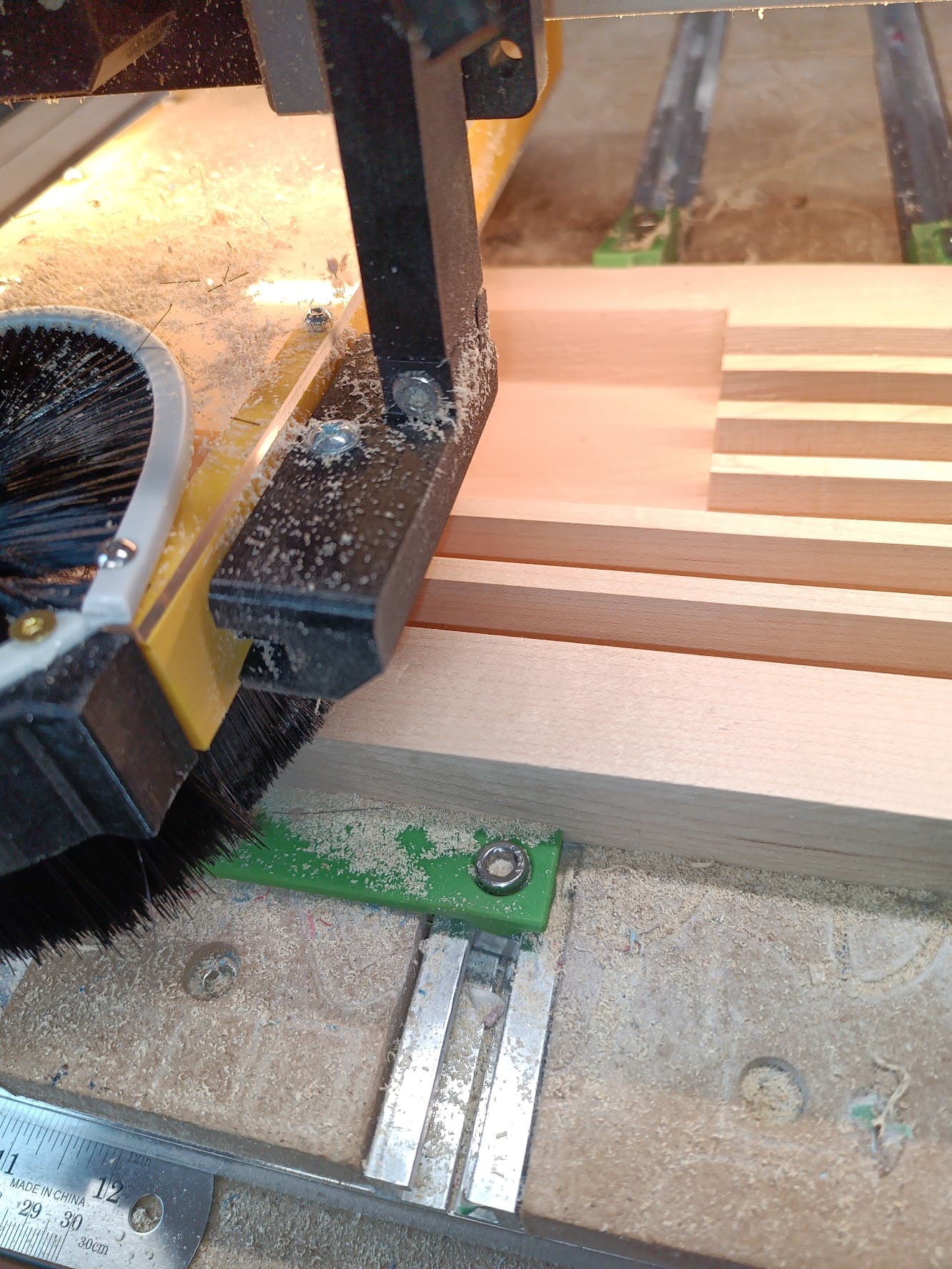

Now I attached one of those to the V9 of PwnCNC, here the dust / chips before the brushes attached:

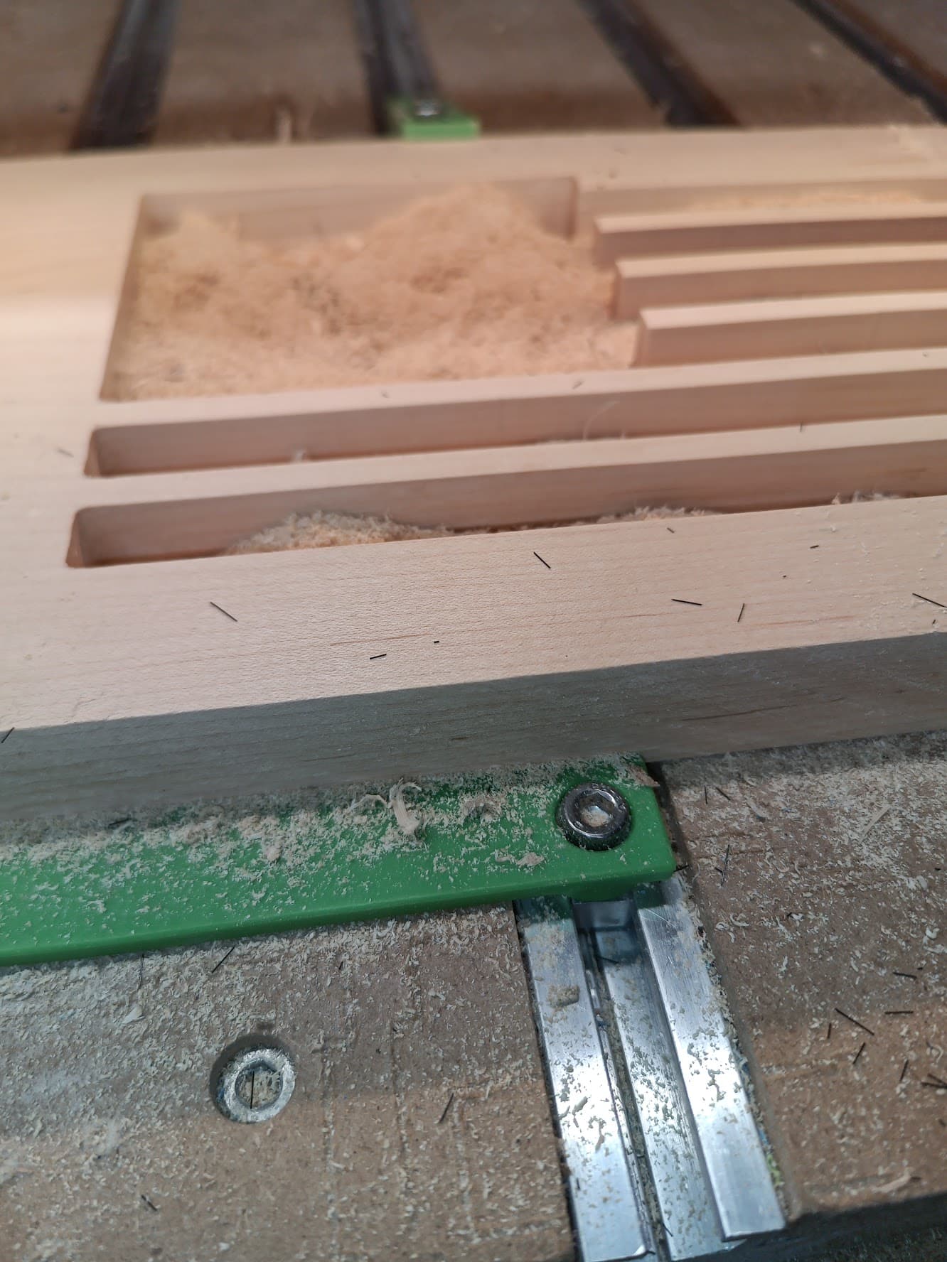

and after:

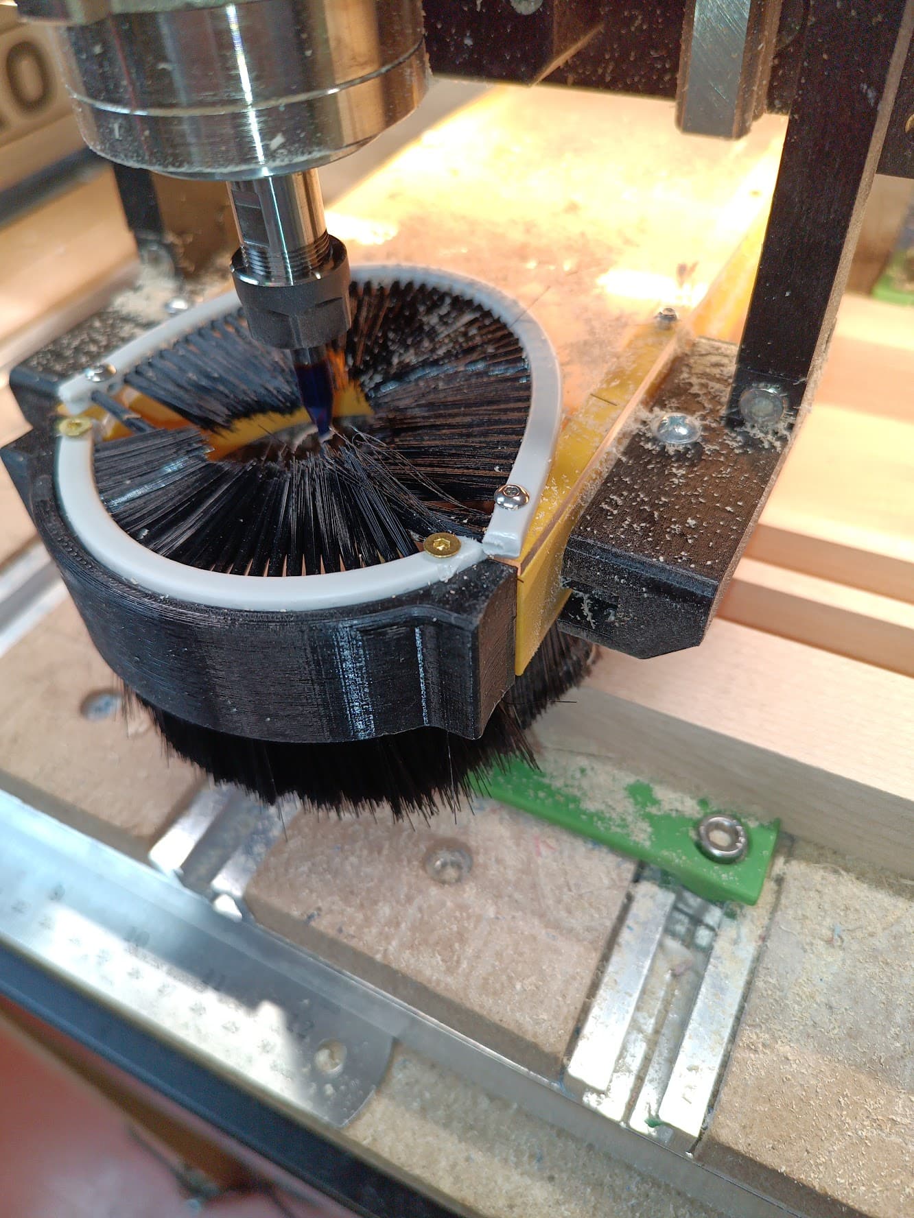

that how they are mounted:

That is a very good idea. My PwnCNC version has the plastic cover in that area, but enough chips are thrown out to notice.
How about providing your source for those circular brushes? I might be able to glue those in to help.

got mine from Bosch 2 Pack of Genuine OEM Replacement Brush Rings For HDC250 - 1600A001NT-2PK
The one from a broken drill dust catcher what I used for another of the PwnCNC pieces could be glued nicely with “weld” glue for acrylic (not cyanoacrylic), the ones I got now are made from a kind of ungluable plastic, hence the screws.
The PwnCNC plastic covers are either too small if one needs a rather short bit, the spindle does not fit in if it needs to dive in further (please do not ask where I know that from…), or are wide and then again there is too much outer air sucked in.
Issue with these horizontal brushes is it is not easy to get some.
