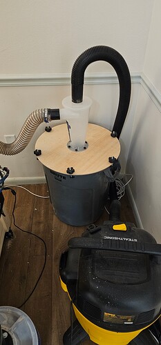

I use a Stealth Sonic shopvac and an Oneida Dust Deputy. The five gallon bucket it was designed for filled up way too often though so I got a 40 gallon trashcan and machined a top for it. There is a weather strip for a window under the top to make a good air seal. The screw downs are 3D printed but you can do the same thing with some hooks, wingnuts, and washers.
