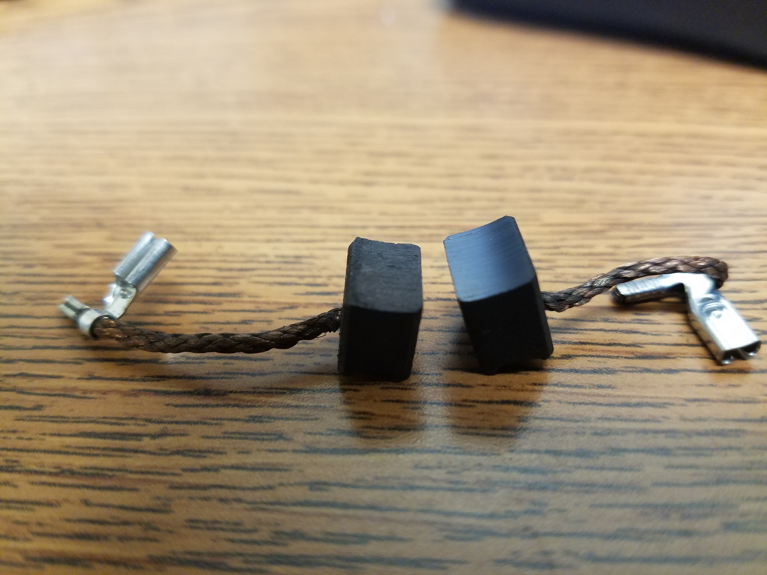

Hi, I have a XL running and was doing great, made an enclosure for it to reduce noise. Today, I did a successfully cut on some Birtch wood, then i noticed it making noises when it was done. Turned it off, checked it, turned it back on and sparks were going on in the motor.
Seems the brushes are already toast on one side of the motor. Unit is 2 weeks old, anyone else have had them go out so fast?
Are you sure they are bad? Did you pull them out and look at them?
Some sparks are normal.
You can also buy new brushes if they are actually bad.
These are large sparks on one of them, I removed them and its squared off now, and 2mm shorter than the other one. I found a 4 pack on order, Its to the point it will not move anymore.

Perhaps you just got a defective brush at the factory - that would explain the progression - big sparks, early death, asymmetric wear.
Good luck.
Picture of both of them… I just got this thing from carbide about a month ago now… as you can see, one is definitely toast.
Yeah, that looks like a bad brush.

Interesting. My first thought was to ask if you are using dust collection inside your enclosure? The particle counts go WAY up when the system is enclosed if you aren’t sucking the dust out. The temperature goes up quite a bit too if you are taking heavy cuts. However, I don’t think that would explain one bad brush. Based on your photo, I think its safe to say you received a unit with a defective unit.
I’m just curios… if you measure the resistance between the connector and the face of the brushes, does one have a much higher resistance than the other one?
Is there any scenario, other than a defective brush, that could cause one brush to pull more current than the other one??
It is enclosed with a vacuum to the outside to reduce noise, but i would expect both the be burnt if that was the cause. I did have alot black dust in the unit when i blew it out, but that could have been the brush. Company just bought another router, ill fix this one for a backup…

I think @gmcbay has a normal router. I think yours has some serious issues. I’ll be interested to see if everything goes back to normal with a new brush. I’m guessing it will. I can’t think of anything other than a defective brush that would cause just one brush to burn.
