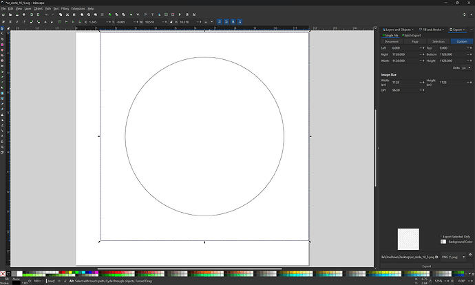

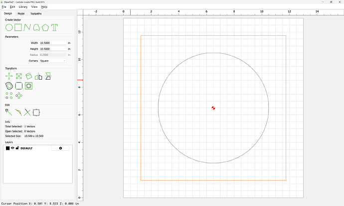

PNG export is only for the 3D model.

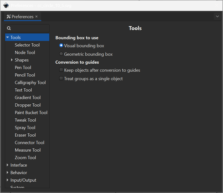

SVG export should be dimensionally accurate (just remember to turn off the stupid setting in Adobe Illustrator where stroke width is included in a dimension).

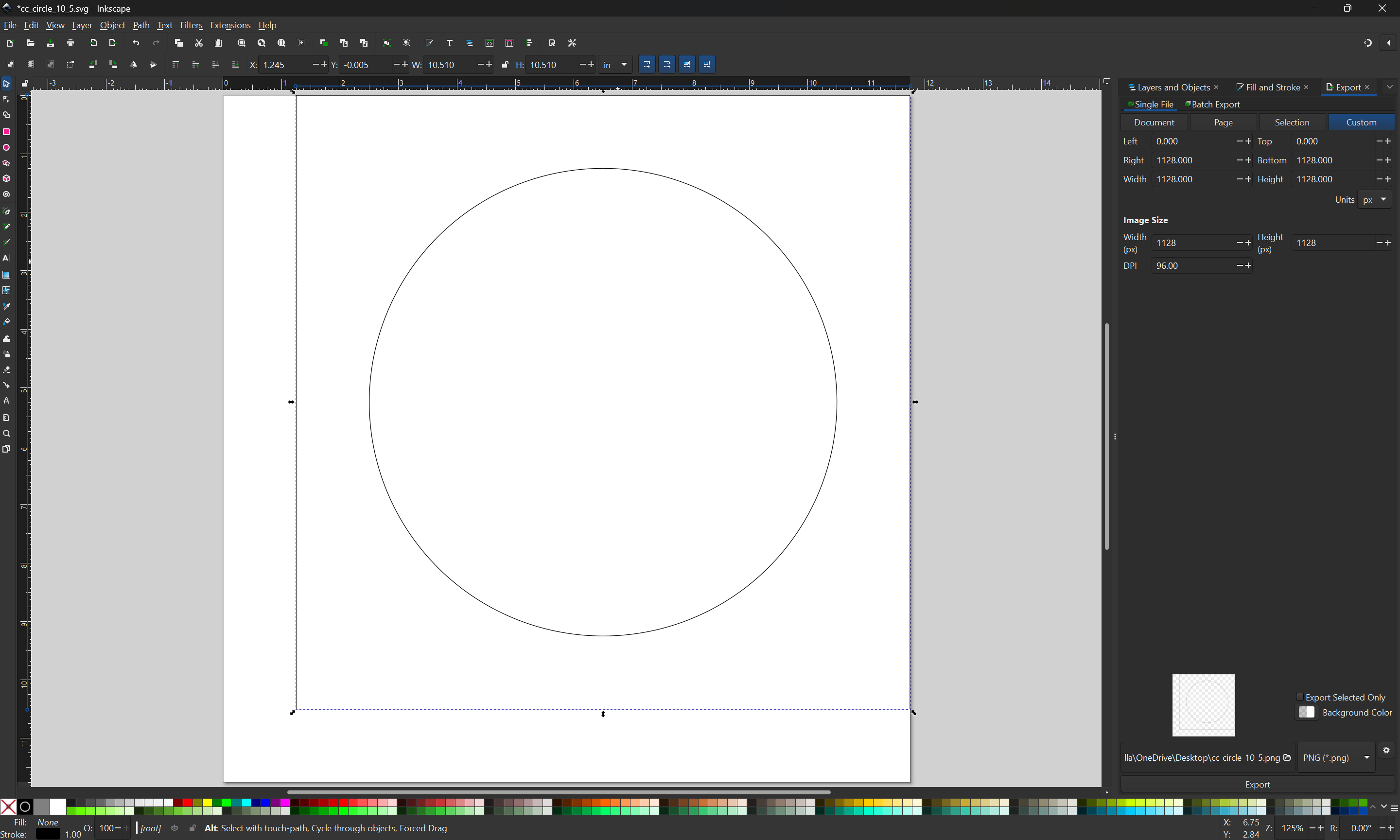

e.g., in Inkscape:
but if one toggles:
in Edit | Preferences:

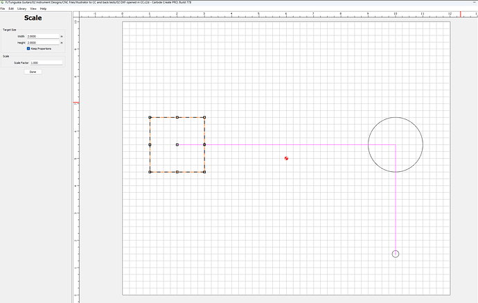

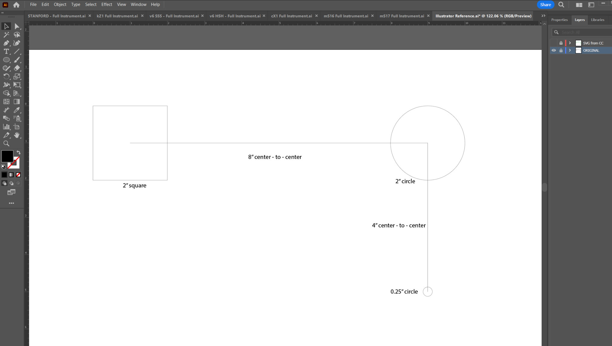

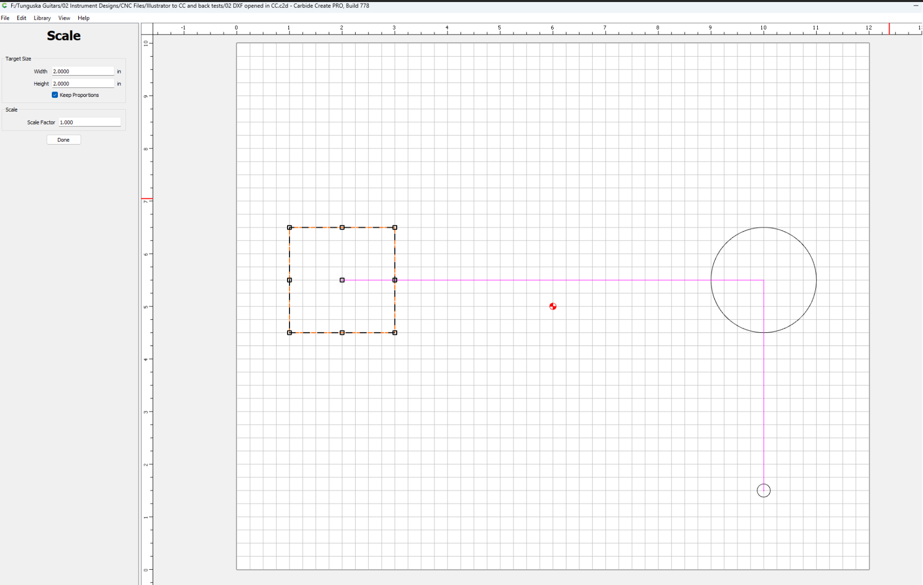

This is so weird. Here’s what I’m getting (oh, and I checked, that scale dimension setting is turned off in AI).
Original drawing in Illustrator:
Then exported a DXF and opened it in CC. All measurements are what they should be:

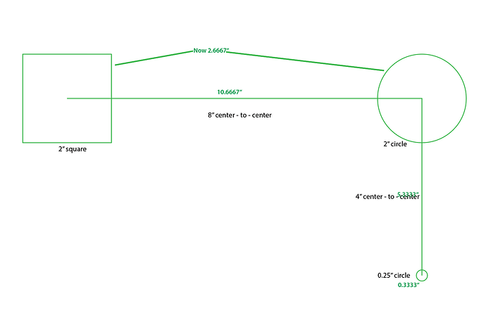

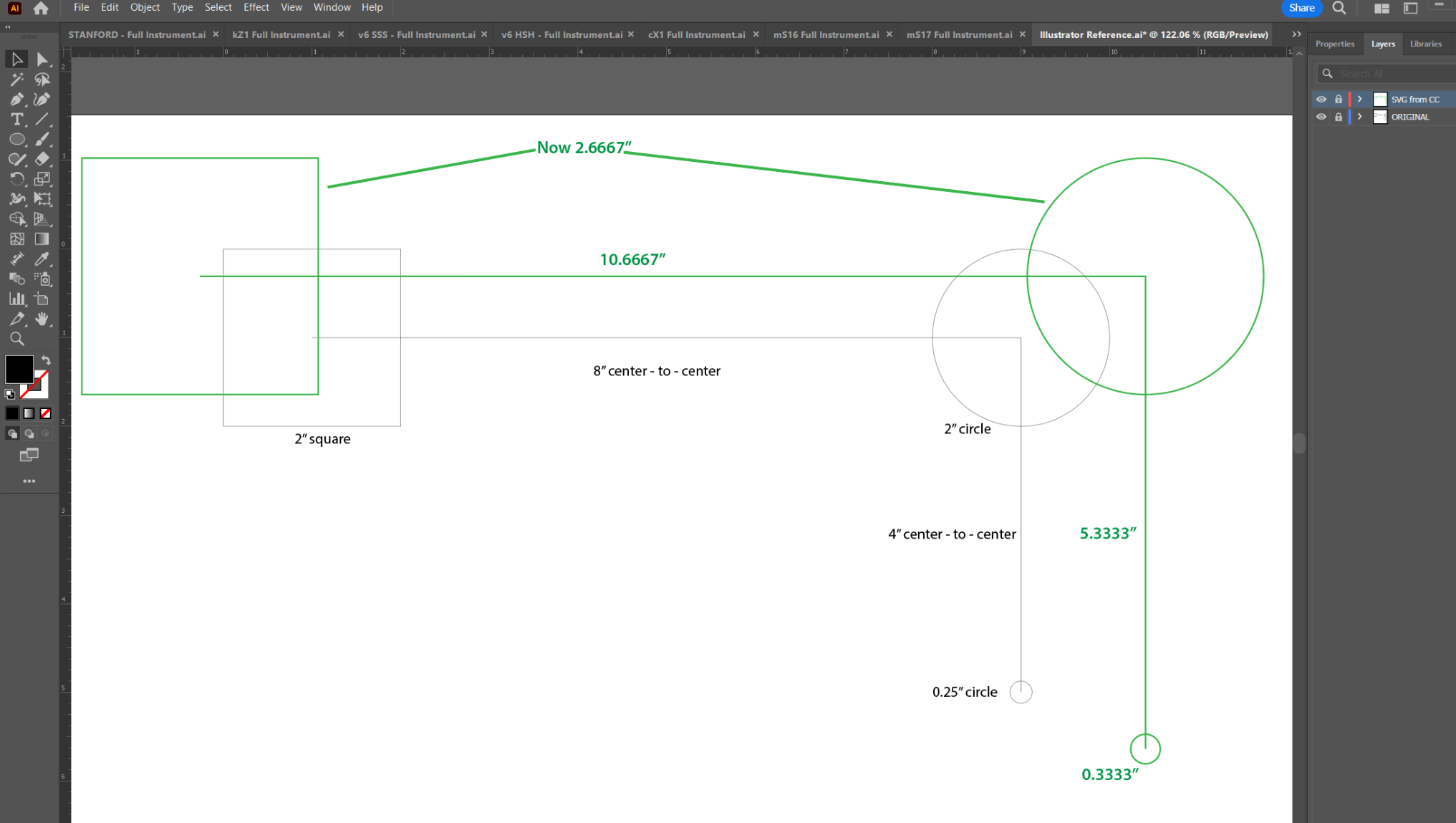

Finally saved an SVG from CC and placed it in the original Illustrator file:
Something is clearly amiss, I’m just not sure where the problem lies. I’ll keep poking around, it’s got to be something crazy simple, and almost certainly in Illustrator.
Ok - still no clue why or where to find a way to make it import perfectly - but I found a workaround.
If you select all the elements imported via SVG into Illustrator and scale them exactly 75%, it appears everything is correct:

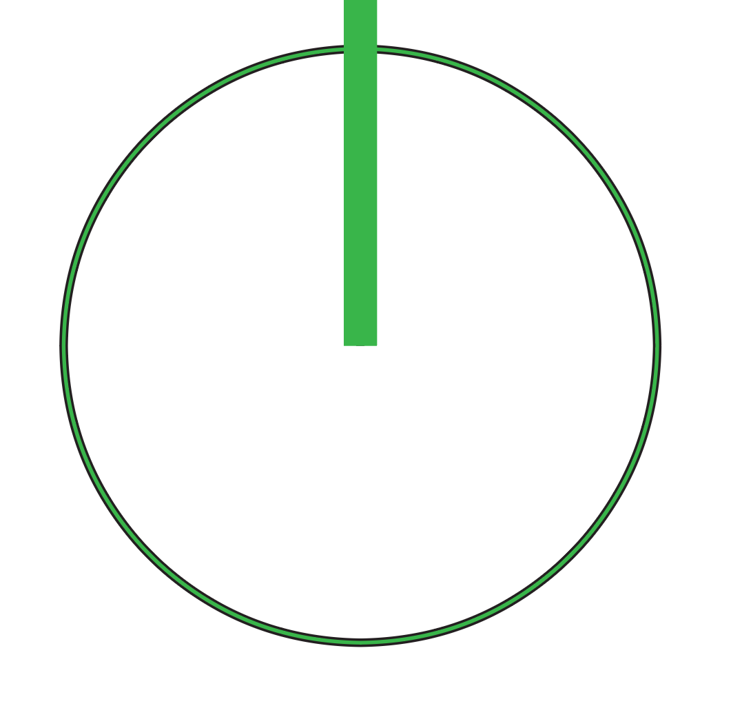

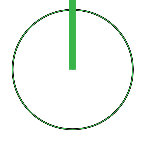

Here’s the 0.25" circle enlarged and I set the stroke to 0.1 to see the original underneath:
Clunky, but probably servicable. I’ll try it with the issue in the guitar designs and hopefully can move forward.

As noted at:
AI defaults to 72ppi, as opposed to the 96 ppi de facto standard which Inkscape (and pretty much everyone else) uses.
You could open the SVG in Inkscape, re-save as a PDF, then open the PDF in AI.
Yep. And 72 is 75% of 96.

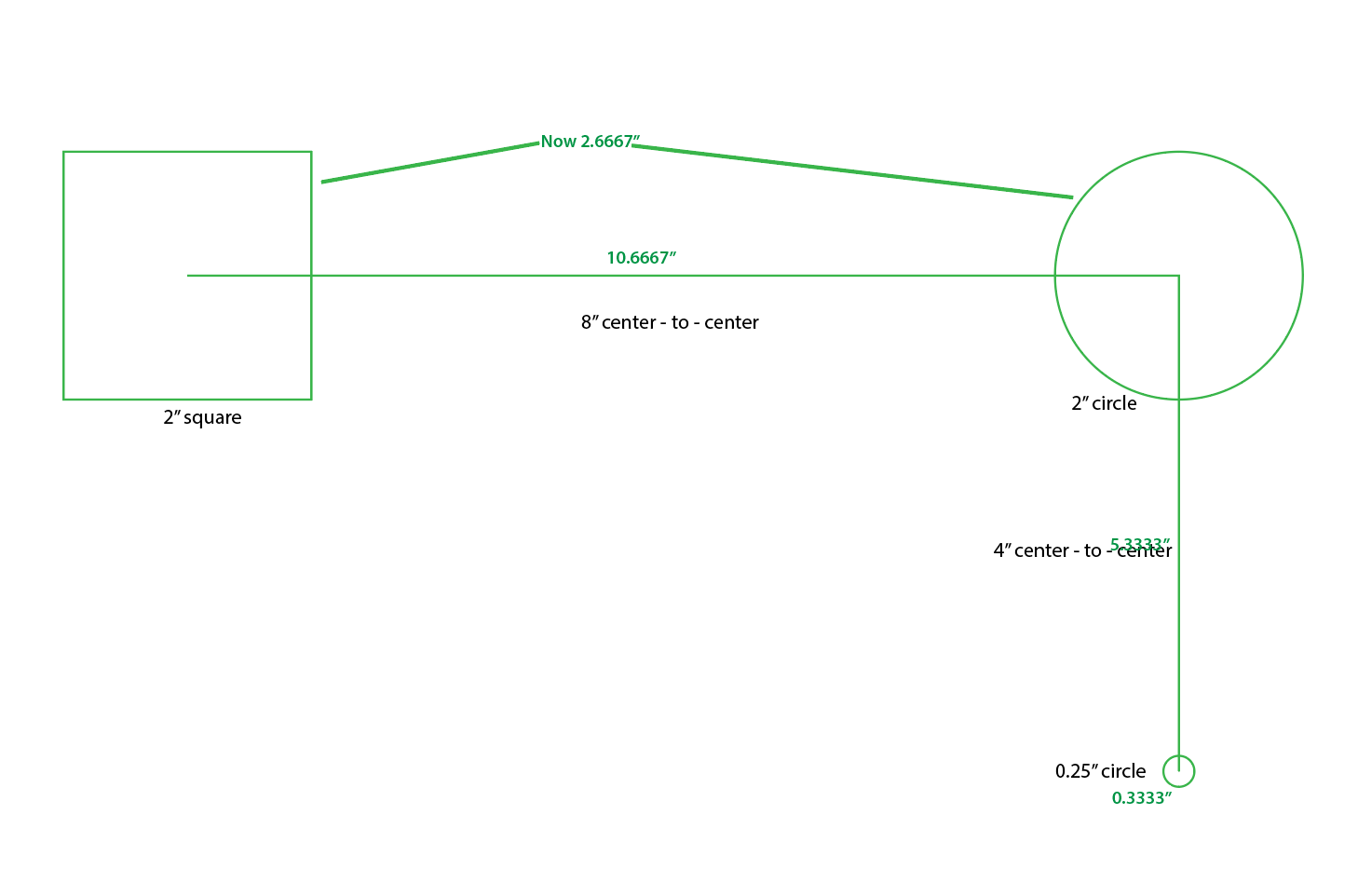

Ok - a little more info. I was able to get the “Effect/Document and Raster Settings” to work. I may have neglected to set the SVG file to 96 in AI when I opened it (I thought it would be a universal setting, not per file). Doing that appears to work, but it’s not perfect.
My Alignment Holes in the design are set to 0.251", which is what’s in the CC file and when I open the SVG and do the 75% scale, also is 0.251"
BUT - if I do the Effect/Document and Raster Settings dance and copy/paste or place the SVG into my designs, those same alignment holes are now 0.2491". Not much of a difference, but a difference.
