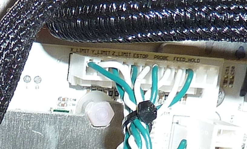

@fonts, you can do a basic mechanical check to get electrical connections removed from the equation.
This is the top right of the Carbide Motion board that is plugged into the Arduino in the electronics box
You might try unplugging and re-plugging that long connector that has all the switch wires coming to it. While it is unplugged you might make sure that all the terminals are fully inserted into the plugshell. If one is not, poke it in fully with a skinny tool. There is a locking tab on the upper (in the picture) face of the plugshell that you can verify is engaged.
While you are at it, make sure that the CM board is fully seated onto the Arduino headers. You might try unplugging and replugging it itself. It is possible that the contacts might have oxidized somewhat.
I don’t remember if single-axis homing was enabled in 0.9, but you could try sending $HX, $HY and $HZ to home a single axis at a time. If that works, you could possibly narrow down the homing problem to a single axis.

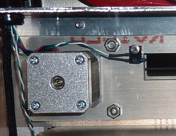

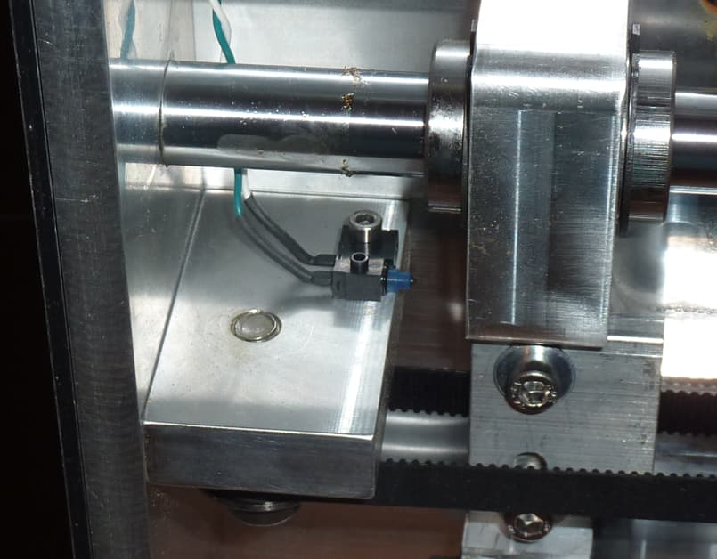

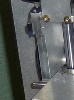

BTW here are the limit switches in their immediate surroundings:
Y under front of chassis:
Z at top left of head:
X in rear of chassis:
But I’m sure you have identified them by now! :grinning:
