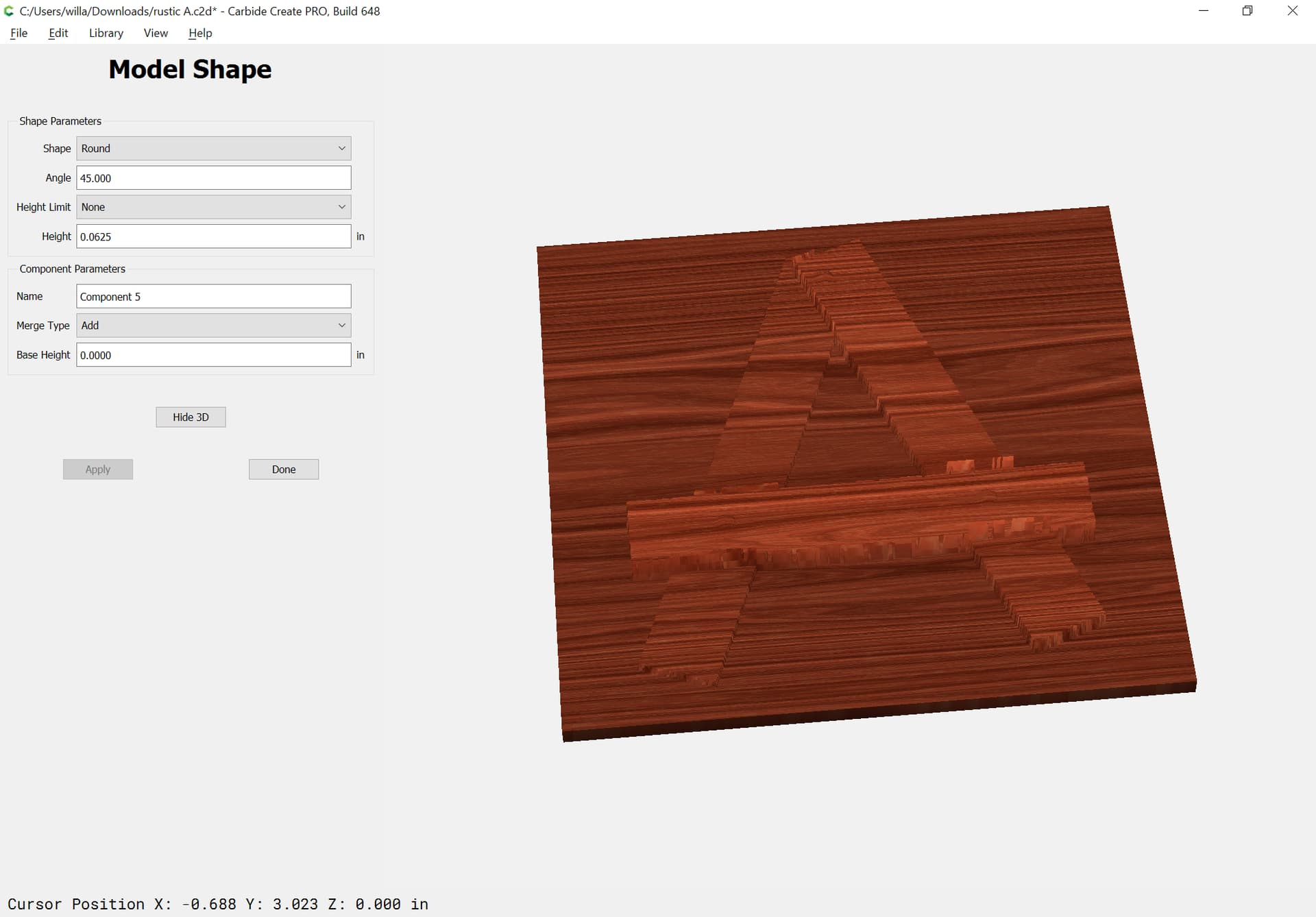

Alternately, if one has Carbide Create Pro, modeling this in 3D is pretty straight-forward — there are two ways to work:
  • additive — add each element
  • subtractive — model a large block and then remove from it
To do this in an additive fashion, select the surrounding geometry and add it to the lowest depth:
Select each set of objects for each layer in turn, and add a suitable thickness:
we then apply 3D toolpaths:
First, there has to be a roughing toolpath to clear out the bulk of material:
then a succession of finishing toolpaths using smaller endmills:
which previews as:
Attached.
rustic A 3D.c2d (69.2 KB)
